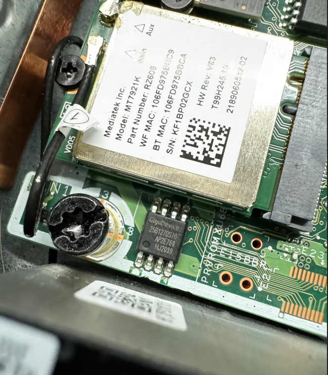

    Hello everyone, I am looking for help as I am struggling to remove lost BIOS Admin password on an HP EliteDesk G6 800 series desktop. I wanted to reset the vPro remote control IP kvm for homelab use.

    BIOS/IC chip seems to be Gigadevice 25B127DSIG located next to WIFI m.2 slot (see photo).

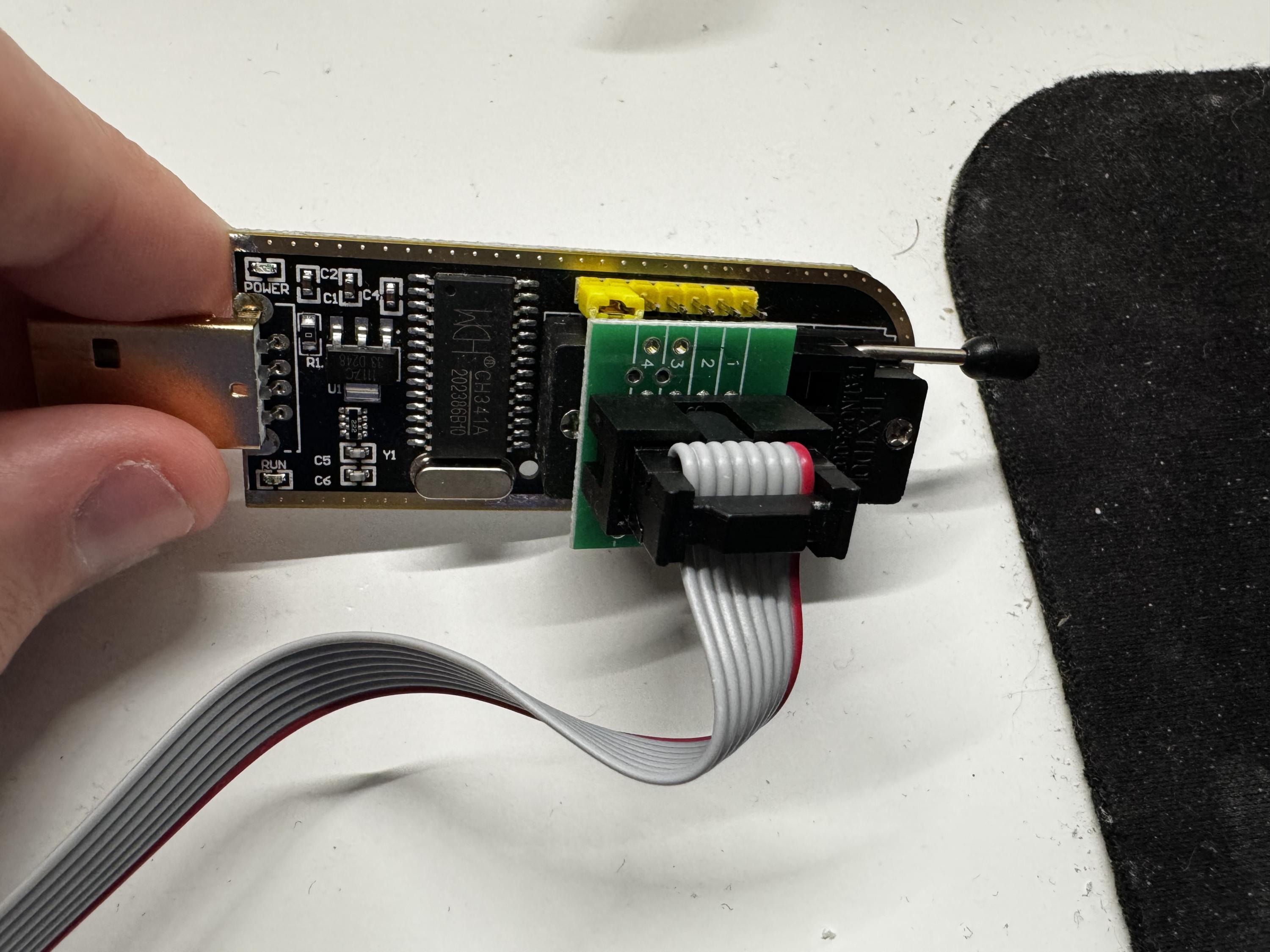

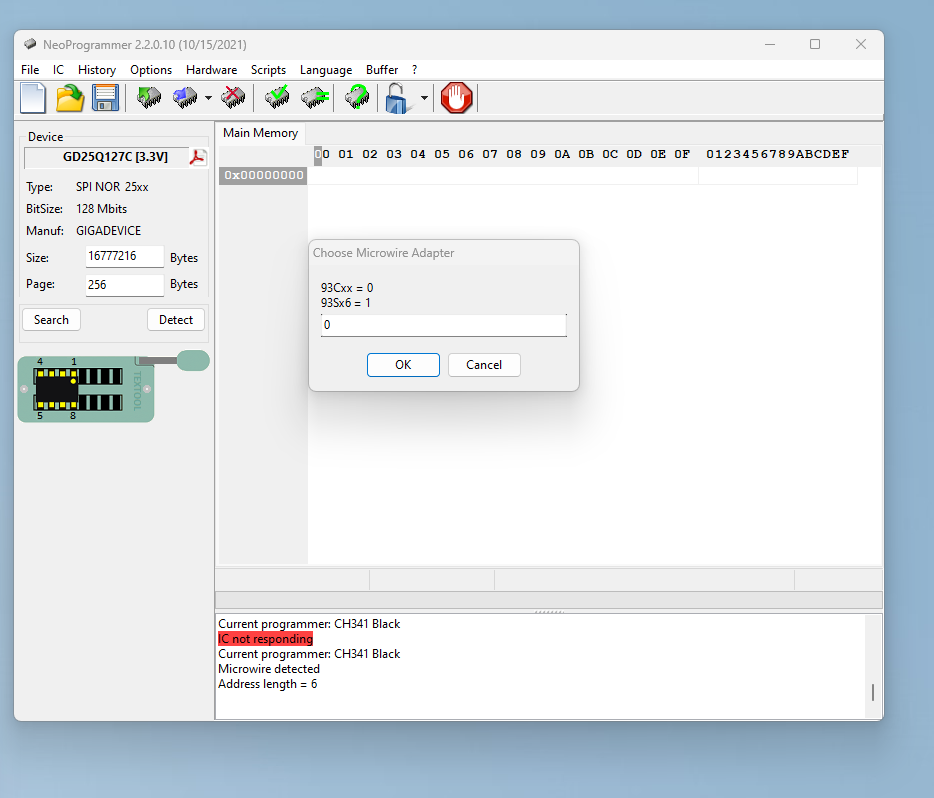

    - I have attempted to access the BIOS with CH341a (black) programmer, using SOC8 clip and multiple different programs attempted but failed. The programs I have tried: AsProgrammer 2.0.4, NeoProgrammer v2.2.0.10, CH341a v2.2.0
    - I did attempt to do CMOS reset via button + battery pull out but that only achieves 'bios defaults' reset and no BIOS Admin password removal.
    - I don't have any soldering skills or tools. If this will be my only recourse, please share some advice on cheap aliexpress essential tools needed for this job?
    All my attempts with the CH341a to read BIOS result in either:
    - IC chip not detected
    - NeoProgrammer message asking for "Choose Microwire Adapter" (this is weird as this chip isn't microwire? but I am a noob so can't tell 100% see photo of programmer setup).
    - NeoProgrammer detects a chip but it is FFFF or some random id that seems inaccurate (no specs on the chip are shown, just an id)
    - All my attempts to read BIOS chip are done with motherboard disconnected from power, BIOS CMOS battery still on the board.
    While I have read that my progammer CH341a (black) can be sending 5 volts to data pins, I was still expecting to be able to "read" the IC chip in some way with this programmer. So far unsuccesful and not sure why. I just ordered a newer CH341a v1.7 model which has a voltage switch: https://www.aliexpress.us/item/3256804266379696.html need to wait 2-3 weeks for arrival not sure if it will make a difference.

    Some questions:
    - Can I trust the only BIOS dump I was able to do via `flashrom -r backup.bin` regardless of the warnings/errors, or is the backup incomplete if I were to buy a brand new IC chip to program outside the board?
    - Does Gigadevice 25B127DSIG shutdown and prevent reading if CH341a (black) sends more than v3.3 on its data pins? In other words would my newer CH341a v1.7 possibly fix my IC detection and read problems (anyone tried new version of the CH341a)?
    - On boot screen this computer claims it has "HP Sure Start" BIOS protection mechanism: http://h10032.www1.hp.com/ctg/Manual/c06216928 - is this the reason why my programmer is unable to read IC chip without desoldering (or am I making wrong assumptions)?
    - If the Gigadevice 25B127DSIG is hard to detect or uncommon, can I easily replace this with a more common or easy chip like Winbond and simply restore the backup.bin from flashrom and expect this to work without the controller/hp sure start bricking the board?

          Answering my own question. My CH341a programmer was faulty. I obtained another CH341a programmer and using the same clips it worked at reading and flashing.
          Had to use RCUnlocker after to remove the password. Thanks everyone
