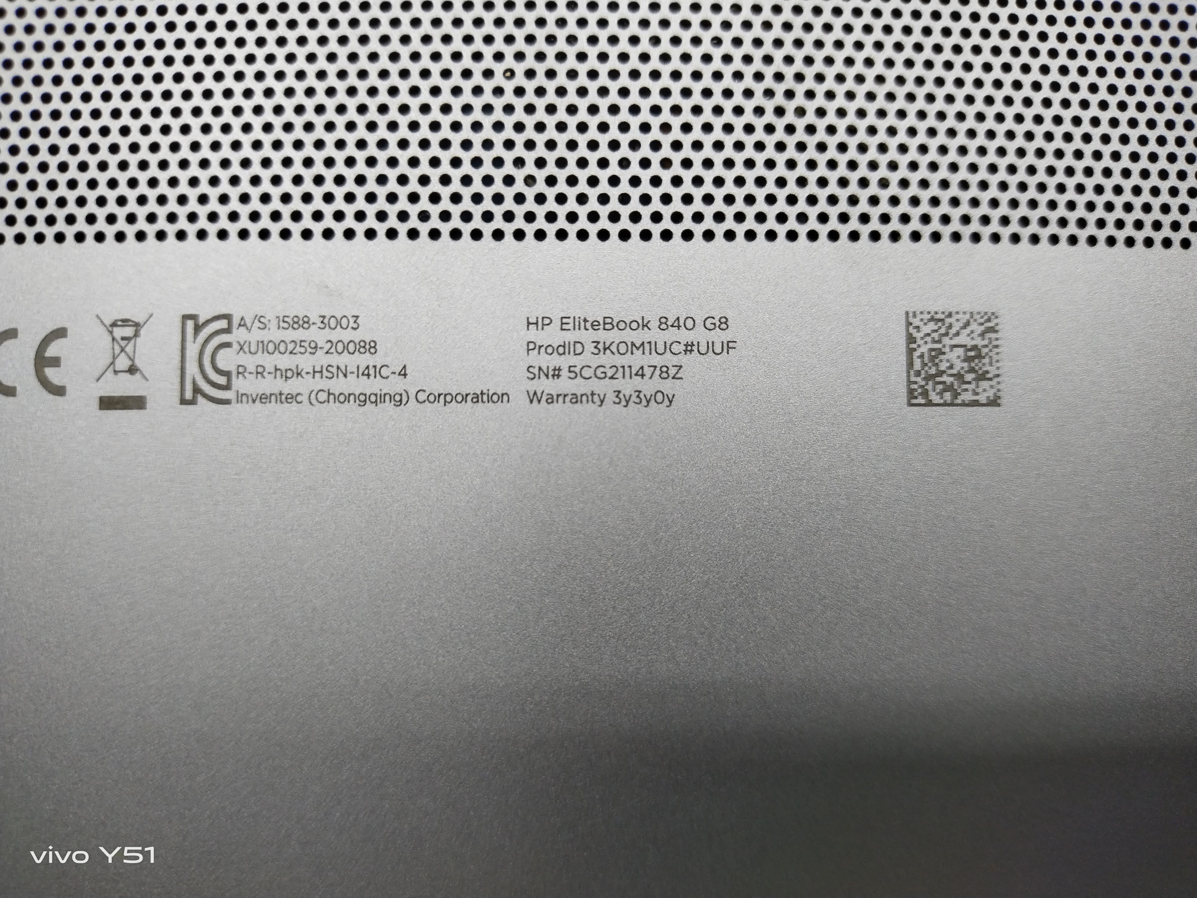

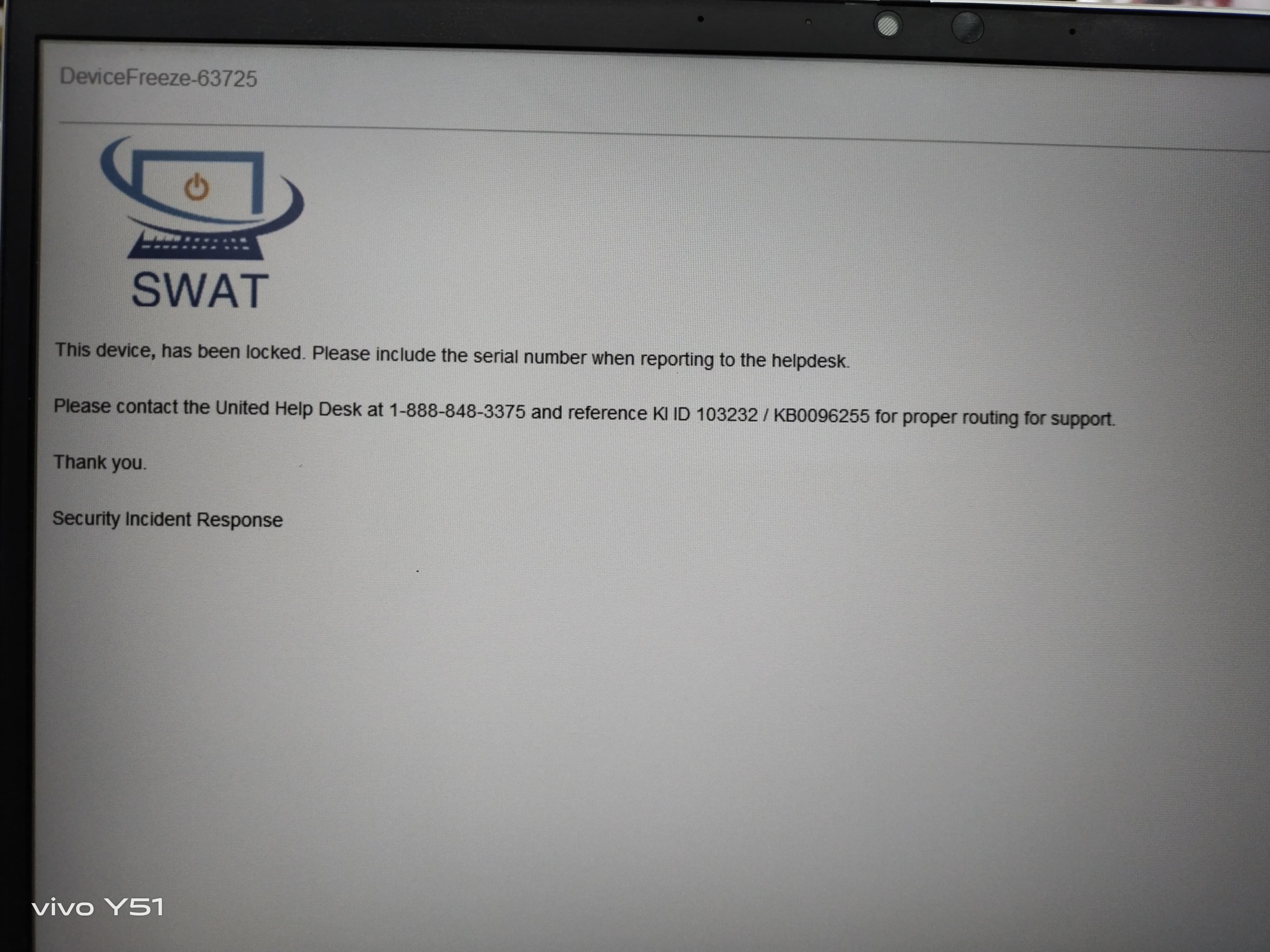

                          #612
                          fix this error plz.
                            SMDFlea commented
                            Editing a comment
                            Read the rules,post the laptop serial number
                        • Muhammad Faizan
                          • Mar 2022
                          • 32
                          • 000
                          #613
                          SERIAL NUMBER
                          • rex98
                            • Feb 2023
                            • 1299
                            • Mandaue CEBU, Philippines
                            #614
                            Originally posted by Muhammad Faizan
                            fix this error plz.
                            only flash this main do not touch the EC.
                            first boot press f10 reset bios to factory defaults and exit, 2nd boot reset security settings to defaults.
                            you can permanently disable absolute in BCU. Use BCU to fill these DMI info:
                            Serial Number: 5CG211478Z
                            Product #/SKU: 3K0M1UC#UUF
                            CT Number: PQSNL00WBGE77Z
                            Description: HP EliteBook 840 G8 Notebook
                            BuildID: 21WWCVET601#SUUF#DUUF
                            Feature Byte: 3X476J6S6b7B7H7M7Q7W7m7saBaEapaqauawbUbhcAdUdpdqfPguhKhkjhk8mEmwn7nVngpD.4g
                            MAC Address : 60:6D:3C:CB:E8:AD​
