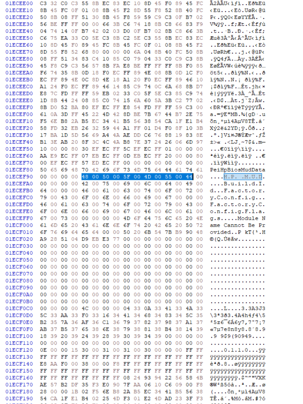

                                AA 55 3F
                                to
                                AA 55 3C
                                NOT UNDERSTAND

                                  do you know how to use the program HxD ??? enter the bios in the program and search in "HEX-VALUE" .... 48 00 50 00 5F 00 4D 00 55 00 44 ..... and in that region you will find ... AA 55 3F .. where it replaces with AA 55 3C ... this is an example ... you have to replace everything that is written in the notepad..after you modified the bios you write it on the bios chip ....
                                  • Bsolution
                                    Banned
                                    • Oct 2021
                                    • 73
                                    • punjab
                                    Re: Extract bios password from EliteBook 840 G8 Bios dump, possible?
                                    I dont find aa 55
                                    • peste
                                      • Dec 2016
                                      • 14025
                                      • ROMANIA
                                      Originally posted by Bsolution
                                      I dont find aa 55
                                      press F3 and move on with the same value, if you can't find it there ..
                                      • Bsolution
                                        Banned
                                        • Oct 2021
                                        • 73
                                        • punjab
                                        i dont find anything.i upload files plz help
