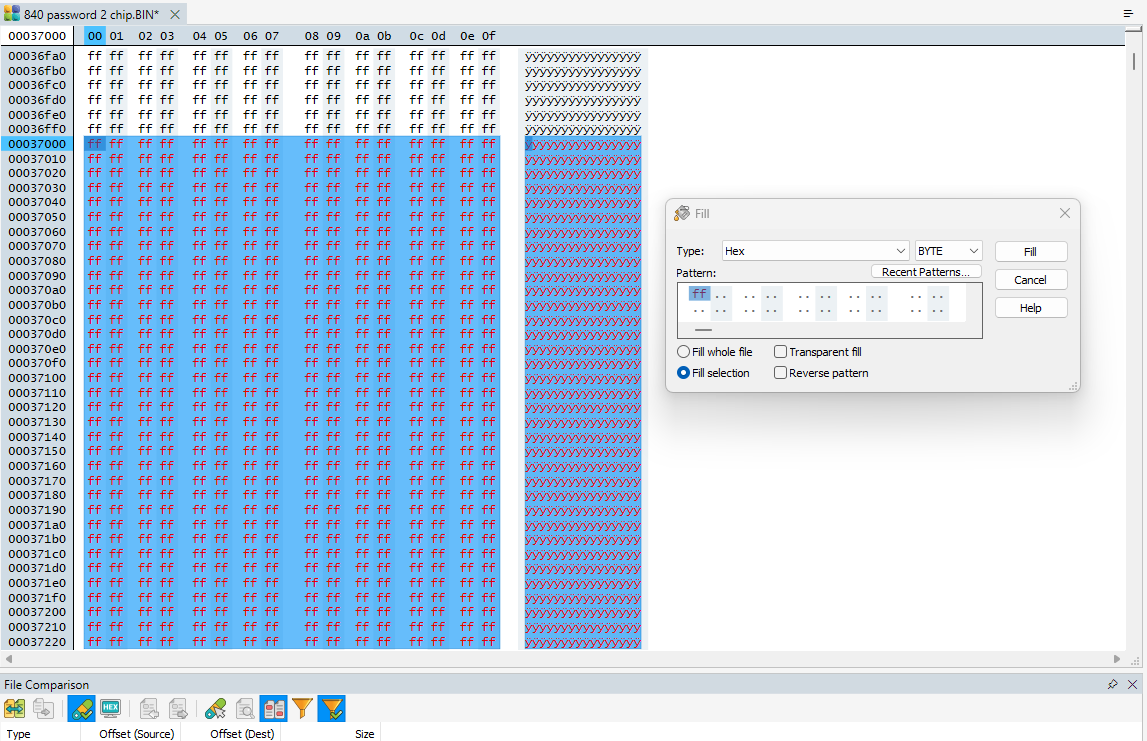

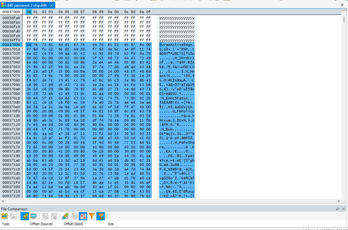

                                • hyditech
                                  • Jun 2012
                                  • 272
                                  • nigeria
                                  #516
                                  Re: Extract bios password from EliteBook 840 G8 Bios dump, possible?
                                  i am sorry,but i still want to get it right... i just flash the the main bios now and pass word is still there...
                                  wen i run 440 g8 unlock,it will run well and it will bring back another 32mb.bin.bak...
                                  i dont know if it should write unlock before i know it has work well... because it doesnt write that..
                                    • 21620
                                    #517
                                    You should not run the script on the main bios,did you read the warning
                                    This must ONLY be used with the 32MB EC NOT the main bios !!!!
                                    Post your main 32MB bios and someone will help.
                                    • hyditech
                                      • Jun 2012
                                      • 272
                                      • nigeria
                                      #518
                                      here are the two bios Main and EC
                                      Thank you..
                                      • rex98
                                        • Feb 2023
                                        • 1289
                                        • Mandaue CEBU, Philippines
                                        #519
                                        Thank you..
                                        S\N 5CG2157WVT
                                        flash only this EC 2nd chip. it will promt endpoint security controller just ignore it enter. it will disappear in next boot.
                                        next time use any hex editor fill with ff in this offset 00037000 to 000379df
                                        • hyditech
                                          • Jun 2012
                                          • 272
                                          • nigeria
                                          #520
                                          Originally posted by rex98
                                          S\N 5CG2157WVT
                                          thank you so so much... Password cleared.....Please can you guide me on how you did it...i will want to do it myself...Because i still have 3 more that i need to do and i dont want be asking much...
                                          but thank you i really appreciate...
