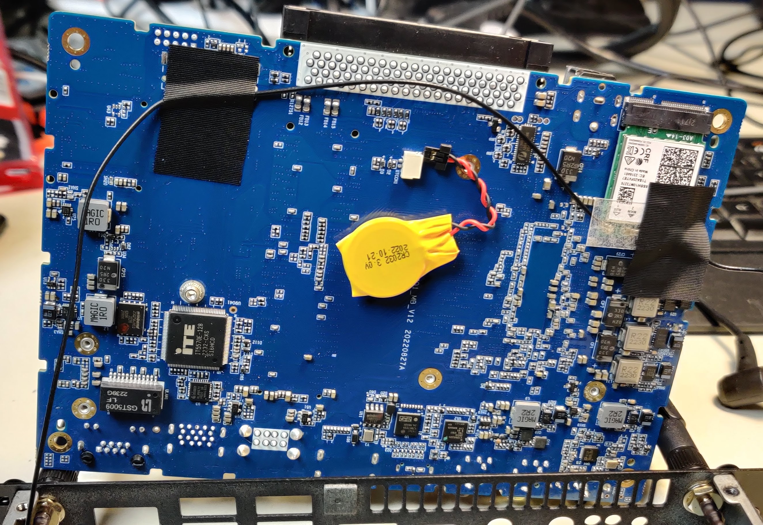

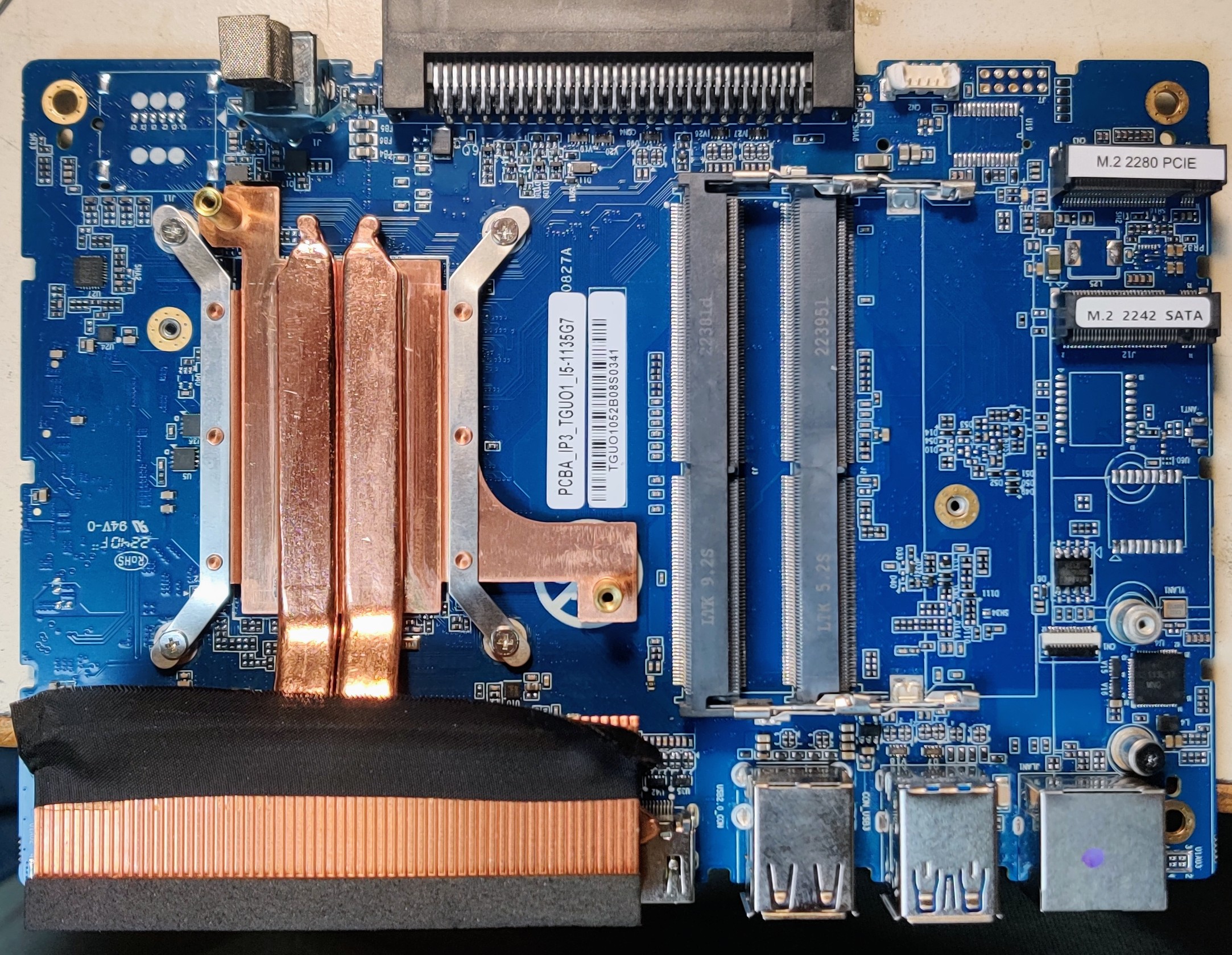

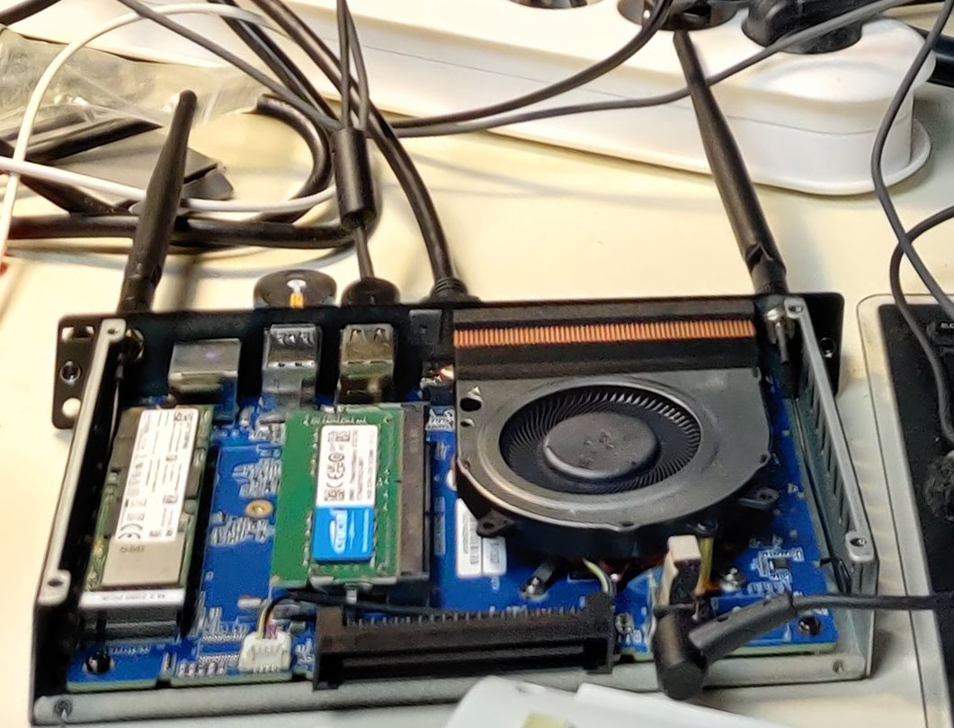

              • Buzzfuzz2k
                • Nov 2023
                • 29
                • france
                Re: Bios password removal on a Unowhy dump
                of course, here are some
                Premium supporters get full download access and other benefits.
                • volinakis
                  • Jan 2021
                  • 3289
                  • N/A
                  Your bios chipset is marked with red square, dump that chipset.

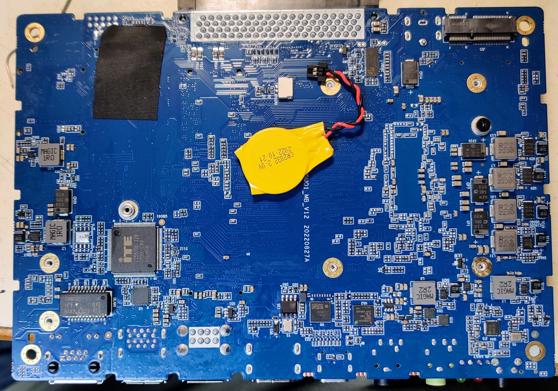

                      • Buzzfuzz2k
                        • Nov 2023
                        • 29
                        • france
                        Here are often better pictures

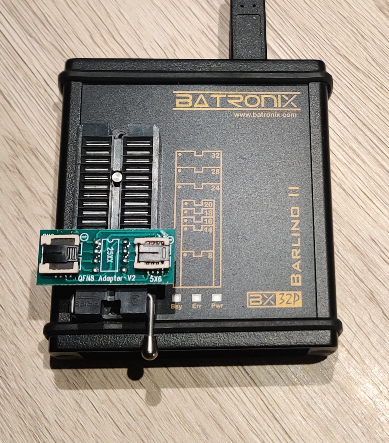

                          What model is your bios programmer, you`re not using a sop8 clip with it are you ?
                          • Buzzfuzz2k
                            • Nov 2023
                            • 29
                            • france
                            It's my barlino 2 bx32p
                              I managed to read the chip ... Programmer reconized the chip as
                              W25Q256 FV
                              W25Q256 JW
                              W25Q256 JV
                              It's written on the chip "JV" but when i read, file is empty. If i select "FV" or " JW" i get the same file, the good one.
                              I have modified it but when i try tu burn again the chip, i have an error with all the 3 chips selection
                              error is "Time uor error at adress 0/0h" when sotware is trying to erase the chip...
                              May be i should try with another software? What do you propose as software to read and write the chip?
                              thanks
                                • 25735
                                Could be the adapter thats the problem,the batronix ones are QFN to DIP8 but what are the extra pins for ,just for support ?
                                https://www.batronix.com/shop/adapter/wson-adapter.html
                                https://www.batronix.com/images/gene...-White-min.jpg
                                  • 32067
                                  the problem is going to be poor connection because your putting what looks like an soic package into a chinese (xgecu?) WSON adaptor
                                    • 25735
                                    The chip is WSON
