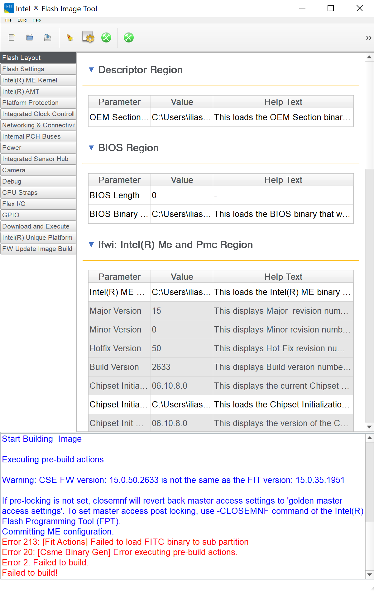

                                    #819
                                    How To Clean Me Region Bios 11th ntel Flash Image Tool
                                    • shiyab
                                      • Sep 2023
                                      • 1603
                                      • india
                                      #820
                                      post backup file and snid
