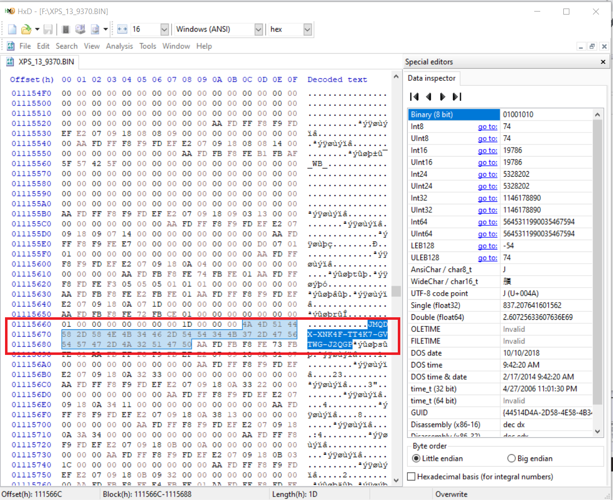

                      • sect-sin
                        • May 2022
                        • 104
                        • Hungary
                        #31
                        Re: Dell Xps 13 9370 bios
                        I have a Dell 9370 (board version CAZ60 LA-E671P), the symptoms are: it turns on, keyboard lights up, fans spin, but no post, and it turns off after 20 sec or so. I checked the board, visual check OK, no shorts, MOSFET's measure fine, memory + CPU resistances OK, there is correct voltage on all rails. So I guess it is a BIOS issue.
                        I am not good with ME cleaning/BIOS repairing, could someone help me with fixing this? I prefer the newest BIOS version with DMI info transferred. I have attached a BIOS dump.
                        I thank you very much in advance for your help!

                        • hoaca388
                          Badcaps
                          • Jan 2022
                          • 12527
                          #32
                          Cheers,
                          sect-sin
                          Your XPS 13 9370

                          • hardware1
                            • Sep 2021
                            • 2951
                            • N/A
                            #33
                            Cheers,
                            sect-sin
                            I see two strings in your dump looks like service tag (SVCTGG1-DGKXNQ2), but non of them give me result in dell site.
                            Anyway try this and let me know.

                            • sect-sin
                              • May 2022
                              • 104
                              • Hungary
                              #34
                              I tried hoaca388's BIOS first, and it worked marvelously!!! Just so other people know, first it dropped a blink error code for low CMOS battery (which is already a very good sign, as with the corrupted BIOS there were no error codes at all). After changing the CMOS battery, it dropped a blink error code for wrong memory installed, which was weird, as it comes with soldered-on memory. After a power down-power up sequence it POST'ed and works like a charm though, so I guess it was only adjusting memory timings.
                              I thank you very much both for the fixed BIOSes, you are both very great!

                              • sect-sin
                                • May 2022
                                • 104
                                • Hungary
                                #35
                                Hoaca,
                                I have a small problem with your BIOS file though. There should be a Windows 10 key in the BIOS, I am missing that, and the Dell site does not automatically identify my notebook for driver download based on the service tag (this is not such a big problem).
                                Could you tell me whether there is a Windows key in the DMI of my old BIOS? Is it possible that your fixed BIOS does not have DMI information?
                                I thank you very much in advance for your reply.
                                Cheers,
                                sect-sin
                                • volinakis
                                  • Jan 2021
                                  • 2888
                                  • N/A
                                  #36
                                  hoaca,
                                  i have a small problem with your bios file though. There should be a windows 10 key in the bios, i am missing that, and the dell site does not automatically identify my notebook for driver download based on the service tag (this is not such a big problem).
                                  Could you tell me whether there is a windows key in the dmi of my old bios? Is it possible that your fixed bios does not have dmi information?
                                  Cheers,
                                  sect-sin
                                  jmqdx-xn****************
                                  • hoaca388
                                    Badcaps
                                    • Jan 2022
                                    • 12527
                                    #37
                                    Hoaca,
                                    Cheers,
                                    sect-sin
                                    DMI and windows key are already in that file.
                                    ​https://www.badcaps.net/donate
                                    • sect-sin
                                      • May 2022
                                      • 104
                                      • Hungary
                                      #38
                                      This is strange, Windows should detect the integrated key, but it doesn't. And I am not getting any kind of Message from BIOS that manufacture mode is active. Thank you anyway for the info, I will add the key manually.
