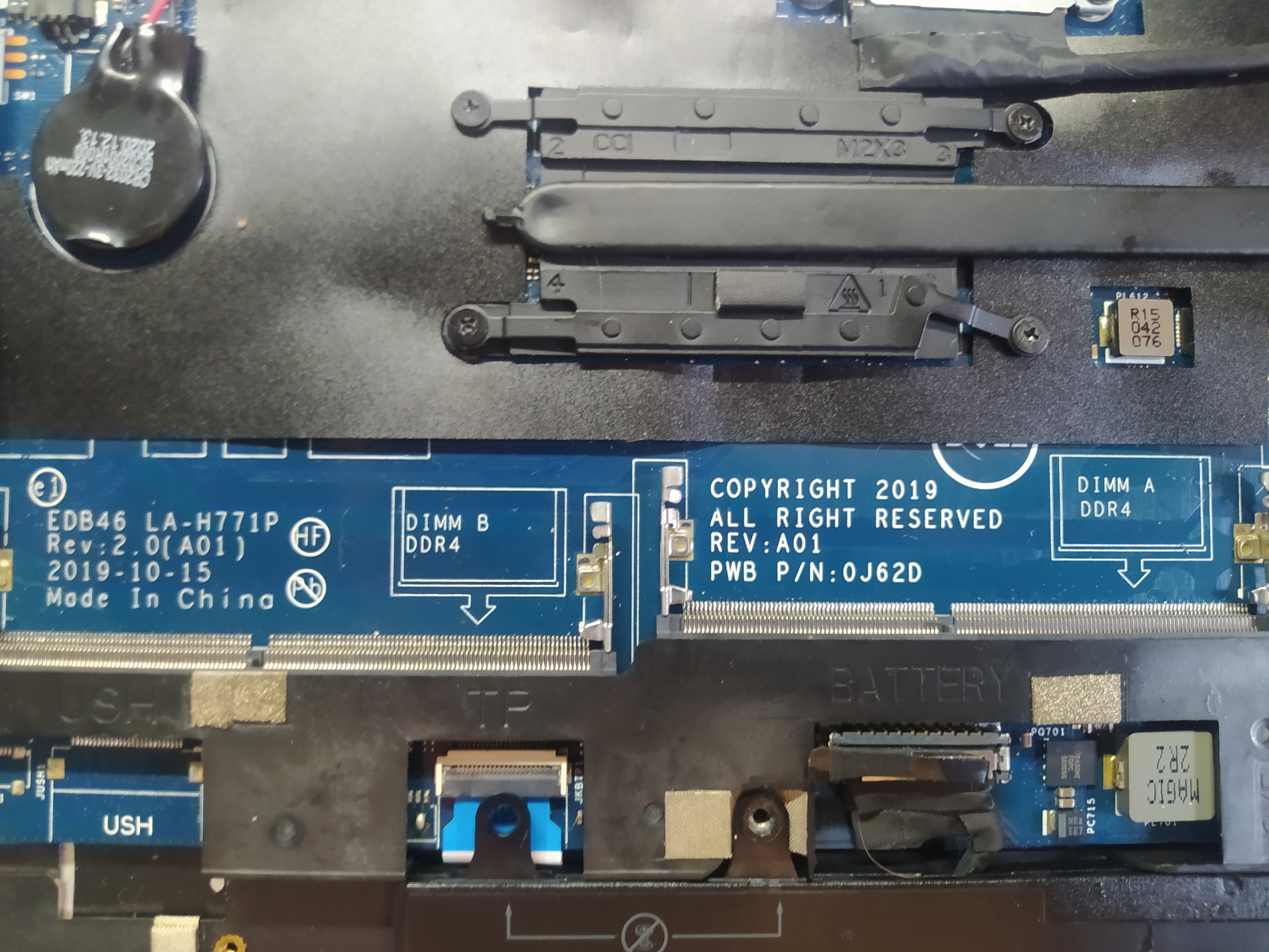

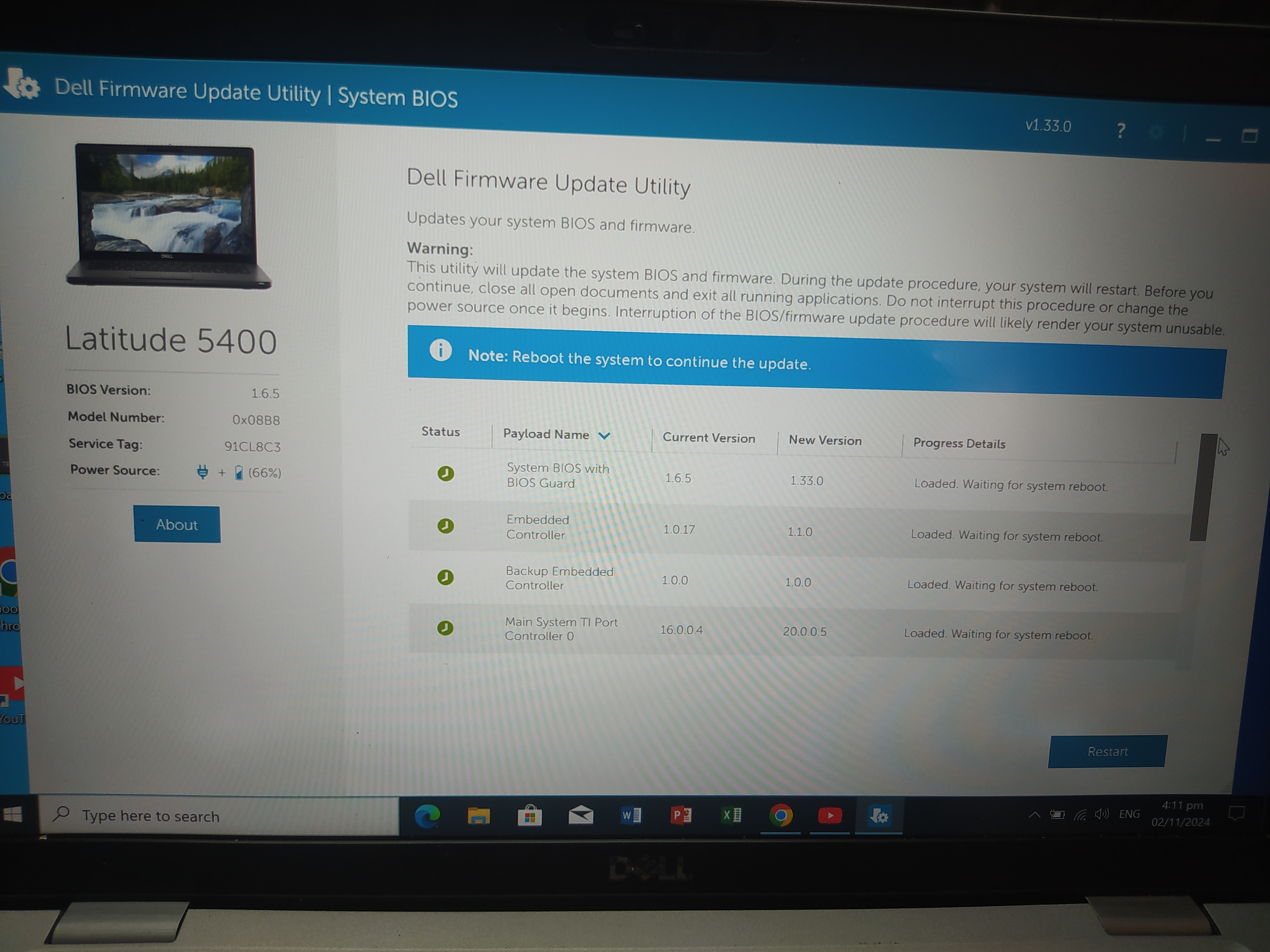

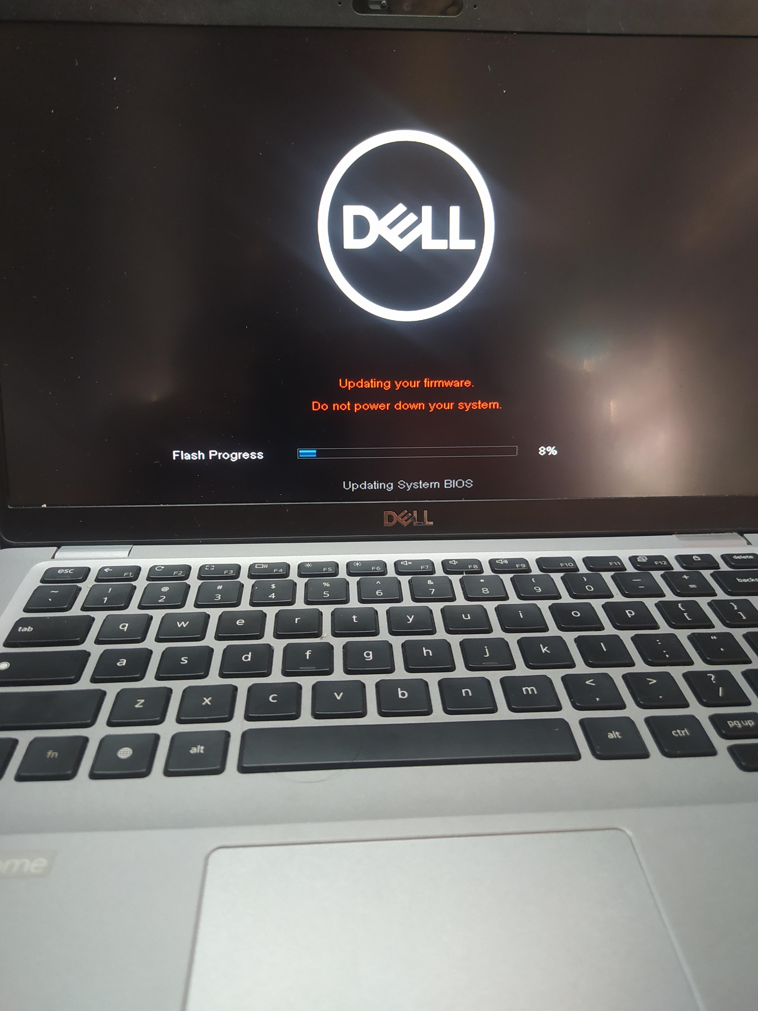

    Hi there masters, recently i got a dell 5400 chromebook and wanted to install windows, i searched the internet and i found out other people also wanting a UEFI bios for this model, i searched there is a R/W legacy, but there are bugs like keyboard/trackpad not working, and hard to install.

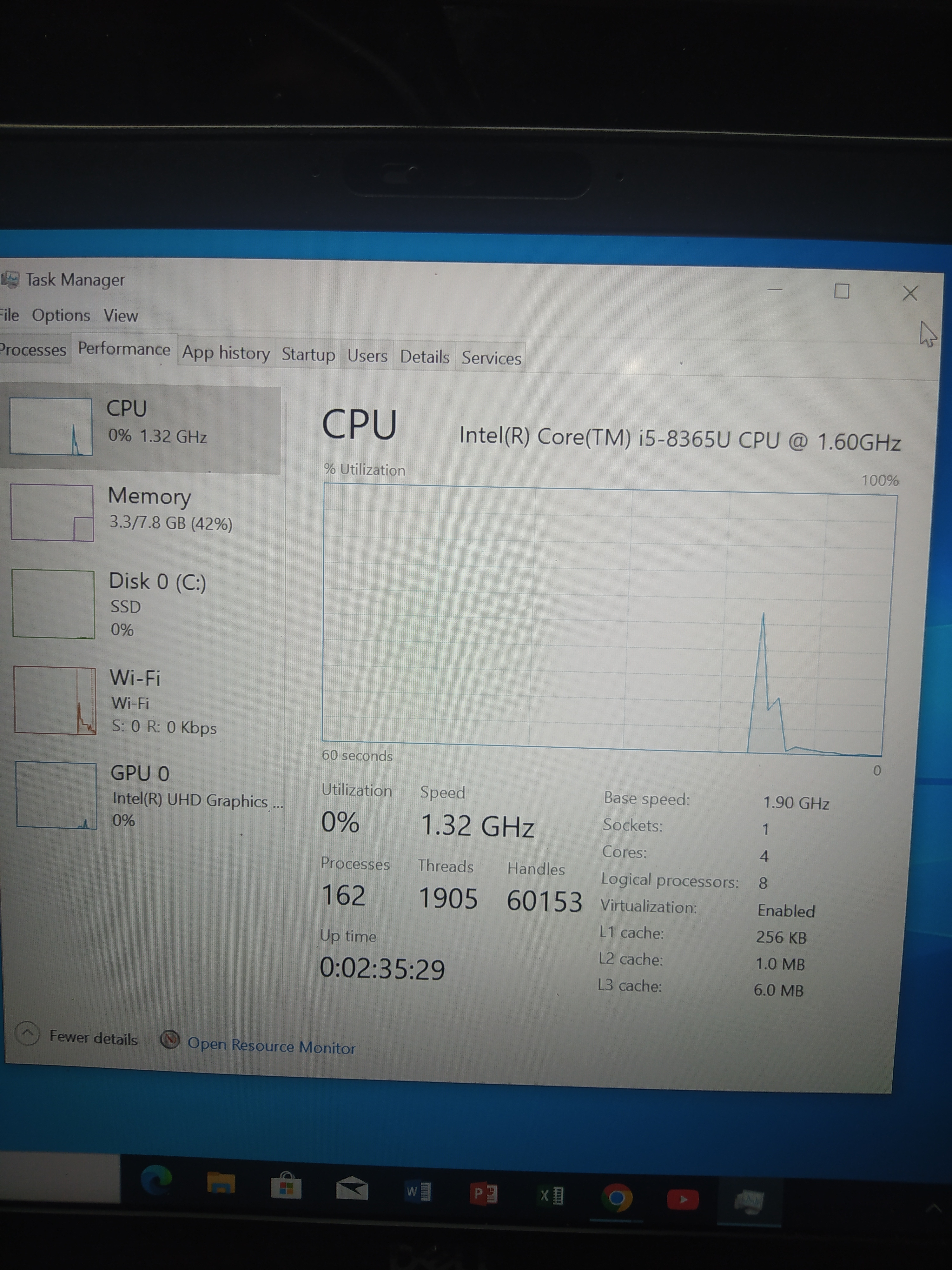

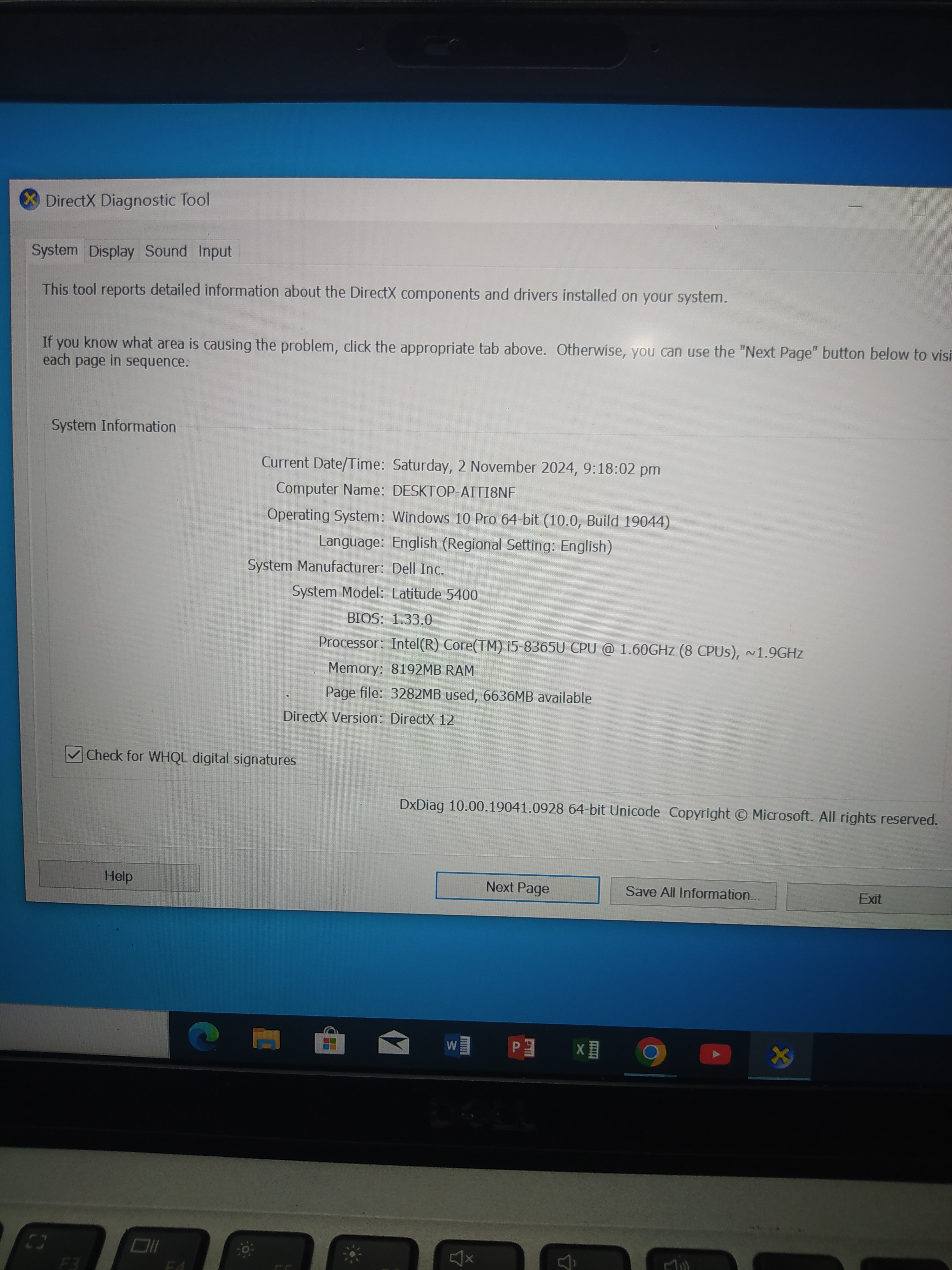

    so i decided to try to port one, this bios is based on dell 5400 windows version, i am testing this bios for a week now an found only a little to no bug at all in windows 10, or only a minor issue
    in windows 11 sound driver compatibility, but overall its ok, for me i can deal with it, 😅😅😅
    known issues:
    realtek alc3204 audio driver in win 11 compatibility issue i think

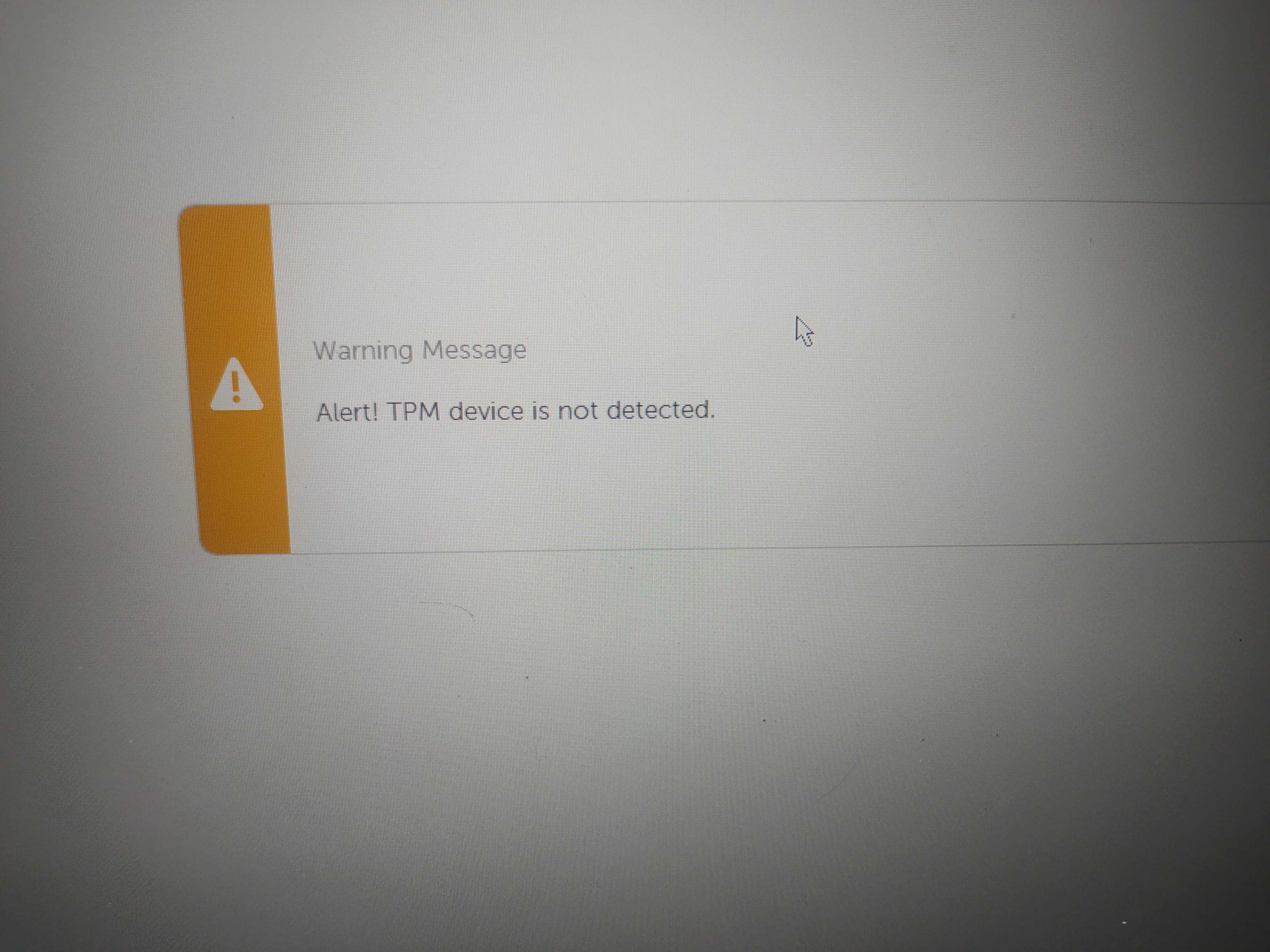

    TPM device is not detected at boot, (everytime you boot) no option in bios to disable it
    bluetooth device not working as it is not detected in bios
    the device boots about 20sec. to display dell logo everytime
    F2 is not working in windows but you can remap it
    type c port is not working, download updated bios in dell 5400 windows version website to work
    (i updated bios 5 times for testing) so i think its safe
    other than that its usable
    note: write down your service tag as you will enter it in bios in first boot
    my board code is
    EDB46 LA-H771P REV. 2.0 (A01)
    PLEASE dont ask me anything about fixing issues as this is my first time doing this
    you can also edit this bios to fix this bugs
    try at your own risk, i`m not responsible for anything if you brick your device
    backup your bios before flashing.
    ec is not needed to flash as it came in the main bios
    but you can also flash it

        • jhanra
          • Aug 2020
          • 51
          • phillipines
          bios only is fine, send feedback if it works for you
          update the bios to the latest version in dell 5400 windows version website to make the usb type c working

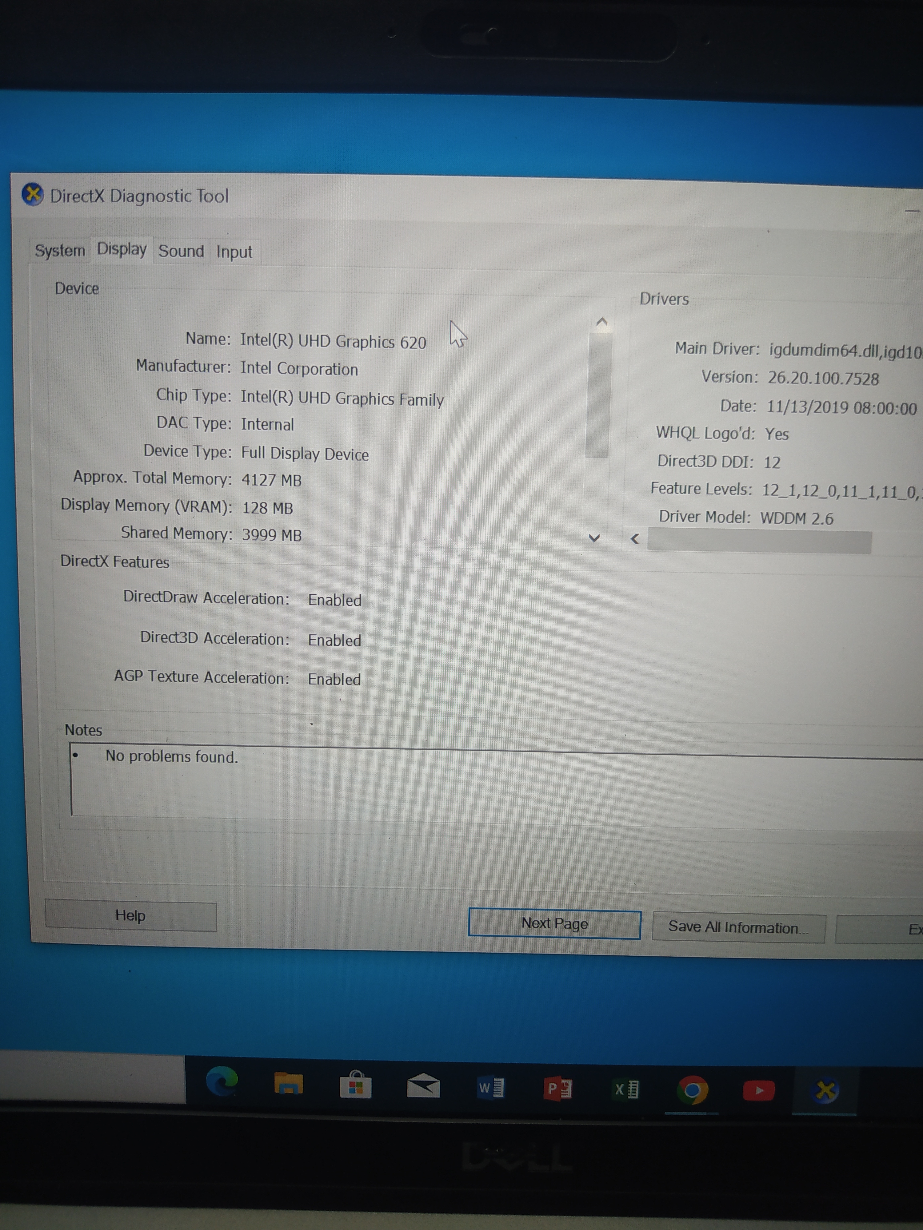

                            What problems does this ported bios.bin file cause in Win10?
                            • isio503
                              • Jun 2024
                              • 16
                              • El Salvador

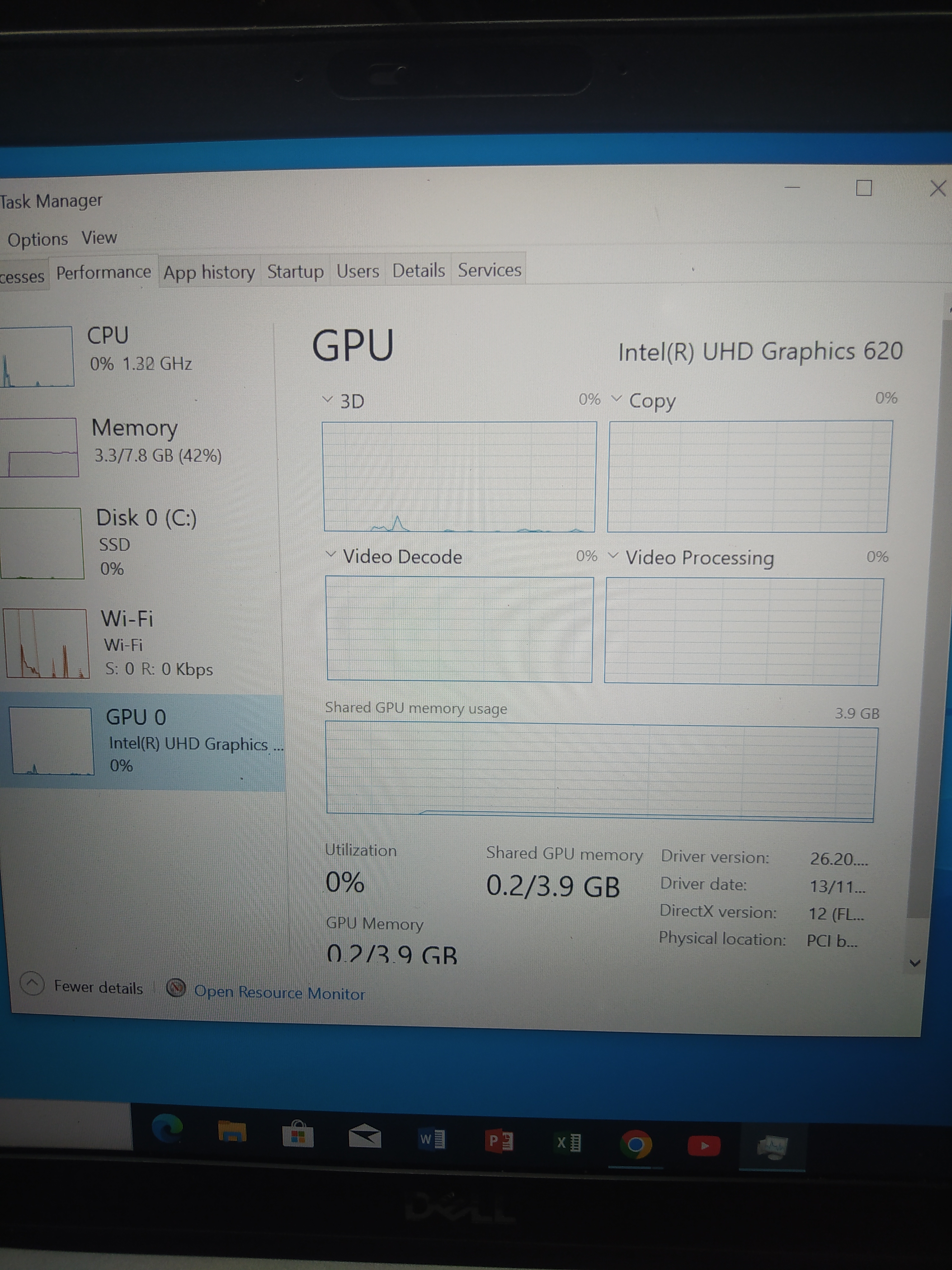

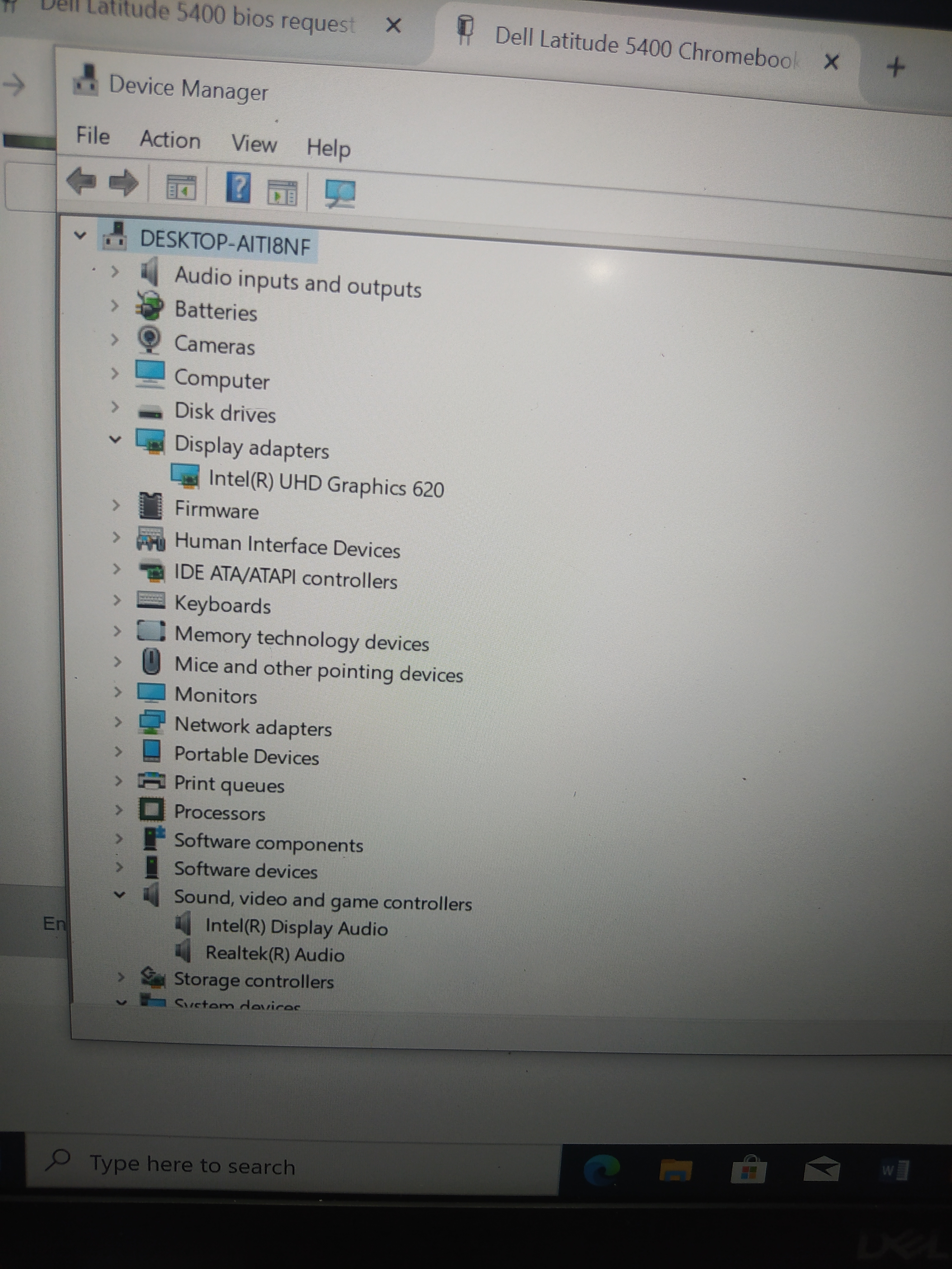

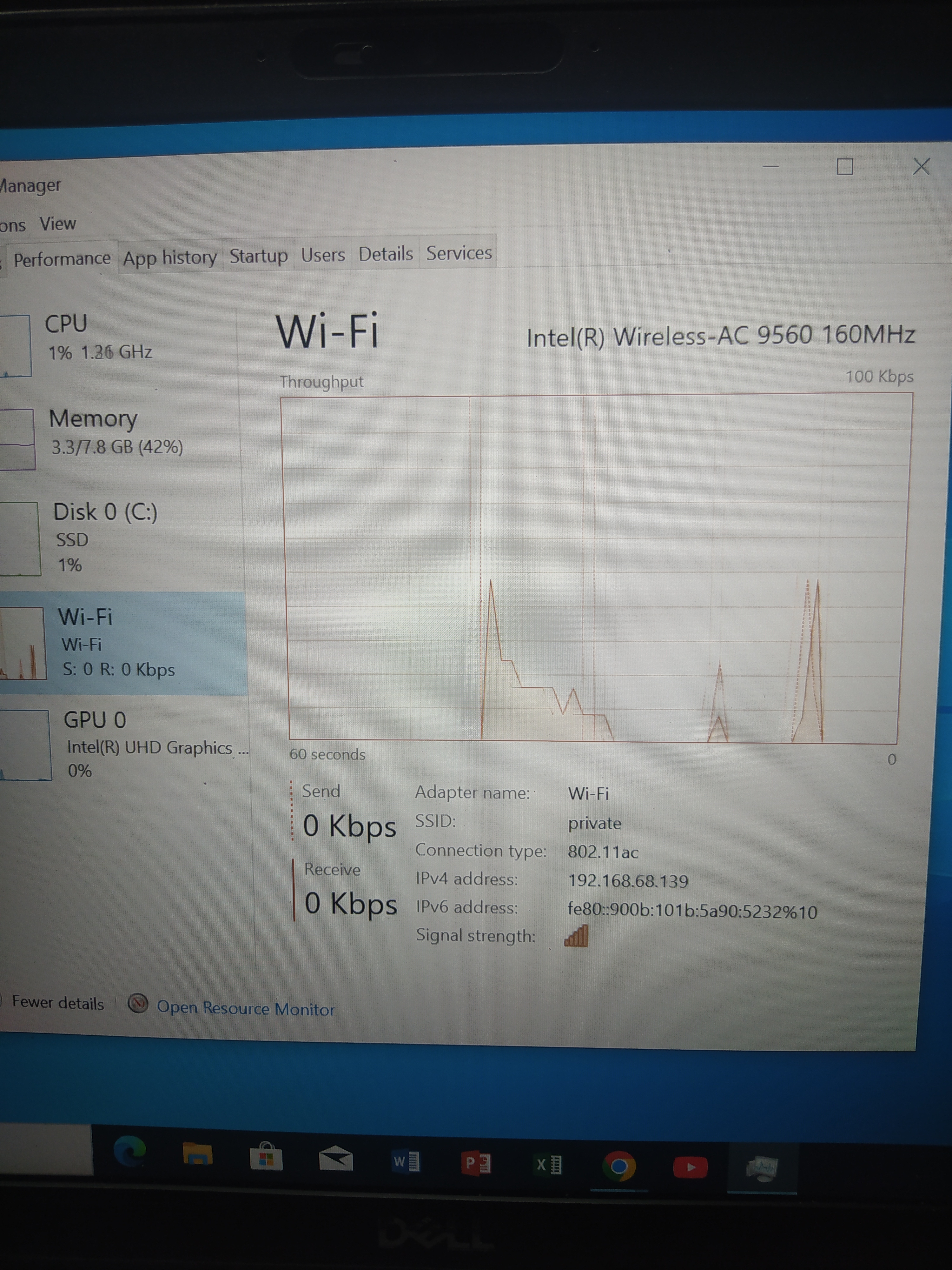

                              Flash com CH341 bios.bin then install FastOs Win10 and then update drives the only thing that doesn't work is bluetooth I imagine because of the wifi card that can be replaced from there everything works even Intel 620 drives

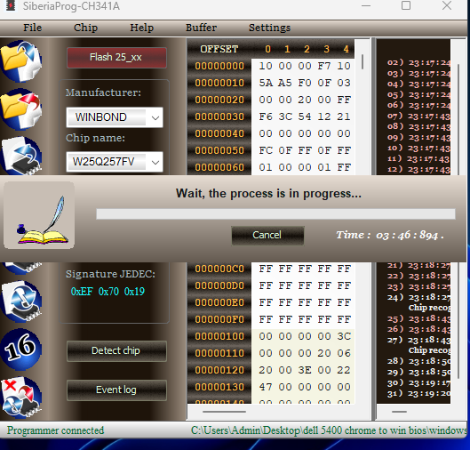

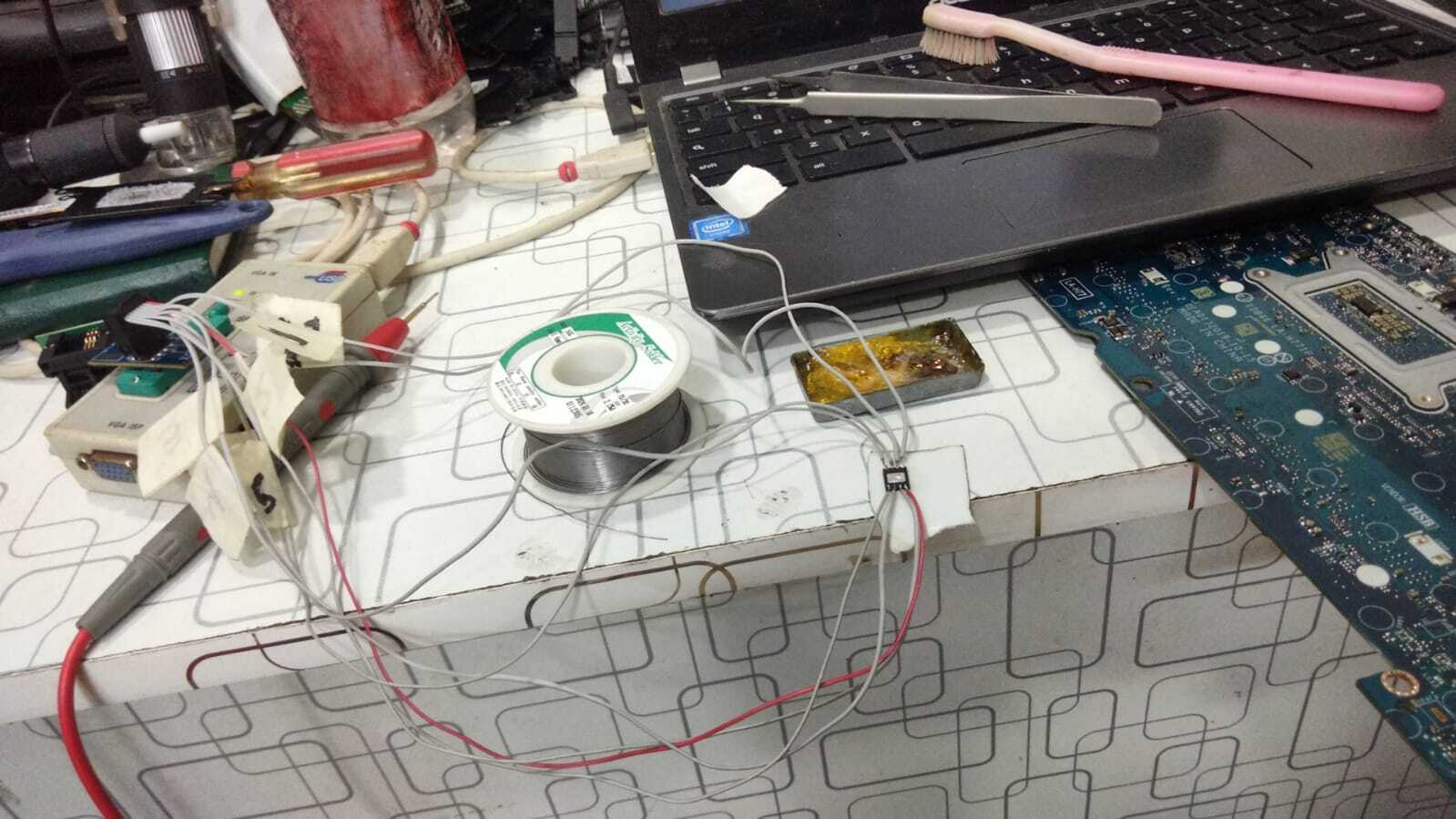

                                  i try to flash using SiberiaProg 1.45 because in this model It can detect the winbond w25q257fv but unfortunately i cant write the bin file. please refer to image

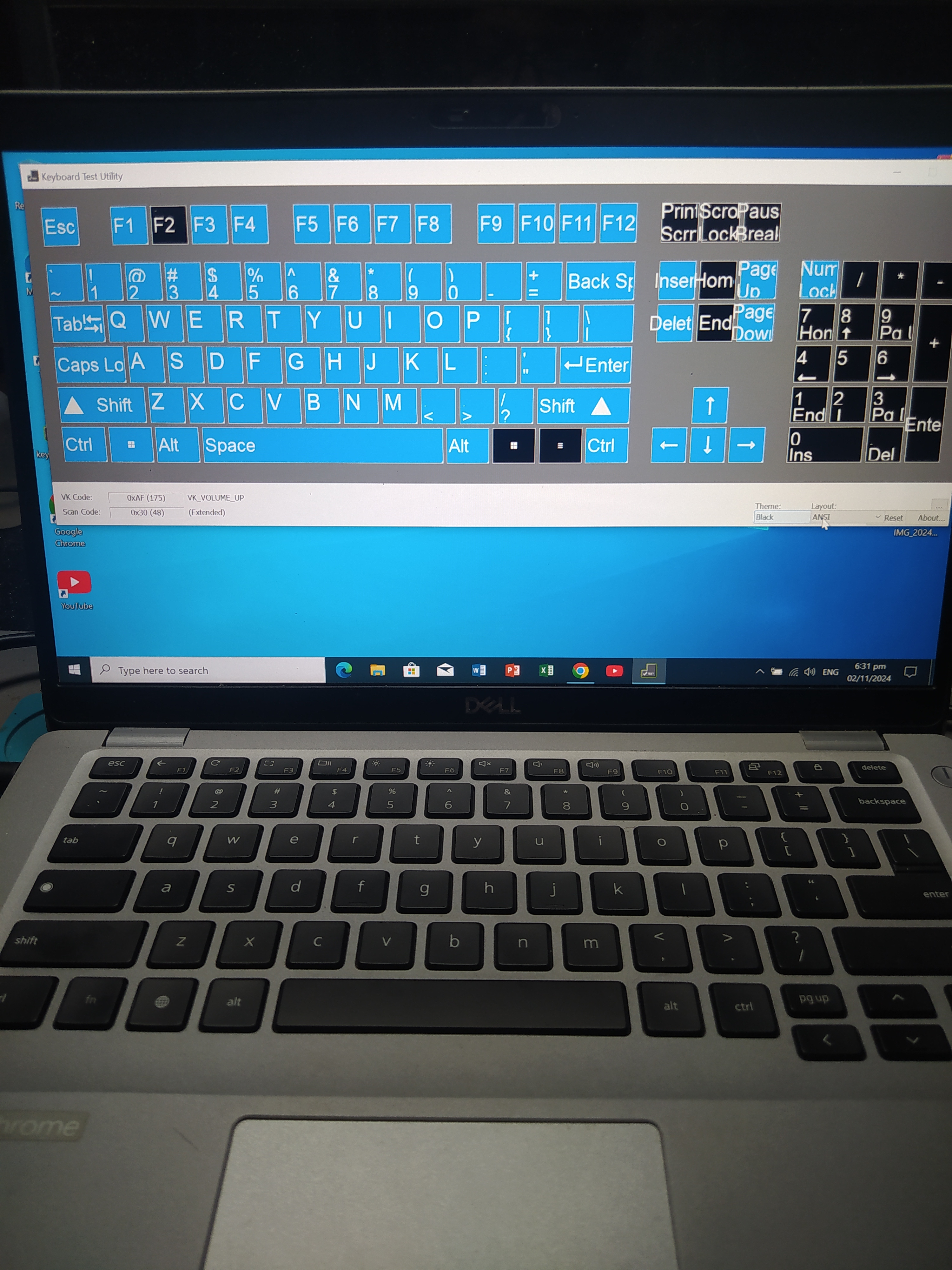

                                    • Aries Molinar
                                      • Jan 2024
                                      • 12
                                      • Philippines
                                      thanks for the file. it works on windows 11 audio is good but the problem is some keys like number 3 will output 123 . will figure this and update once I solve it.

                                        TPM poping out but thats fine....
