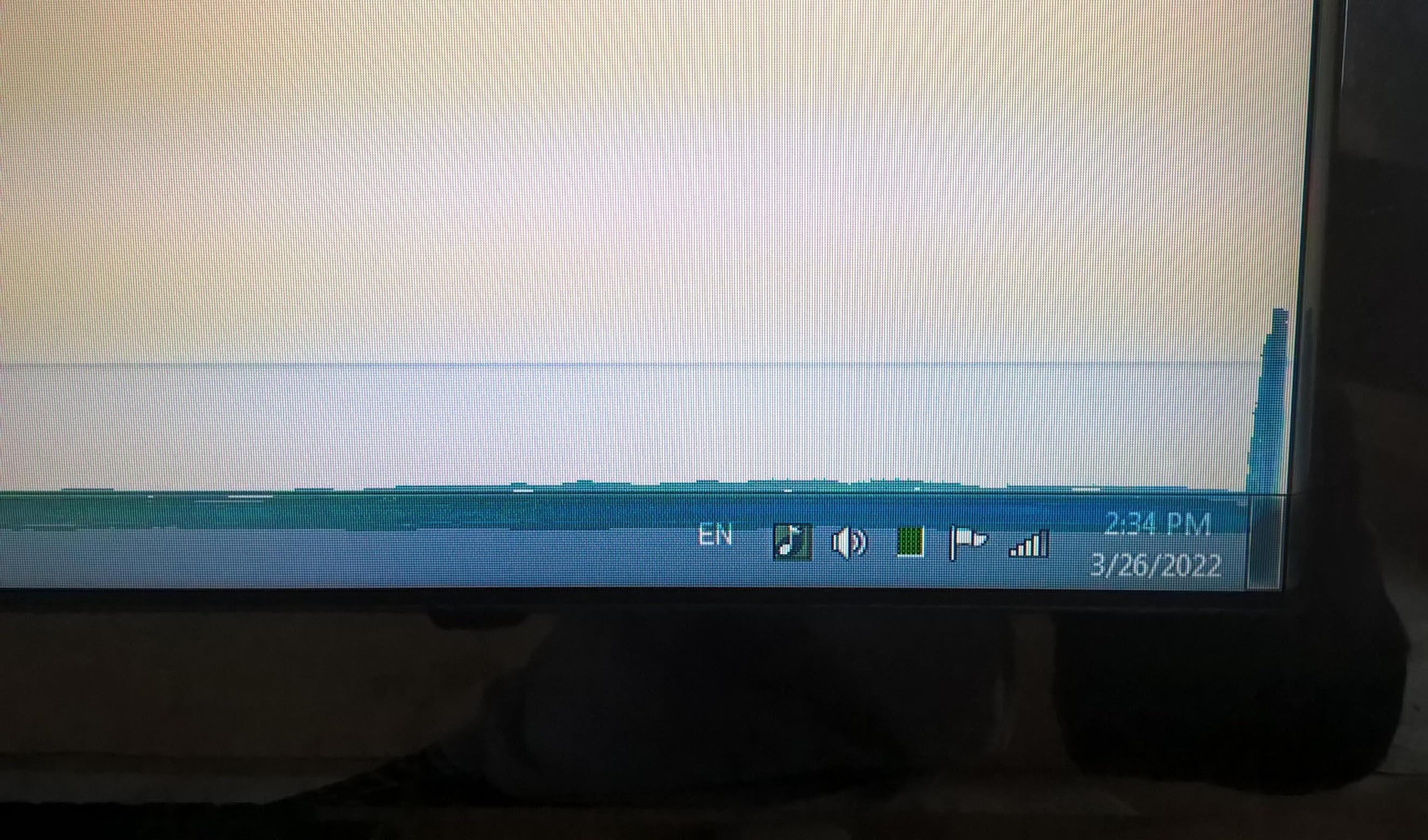

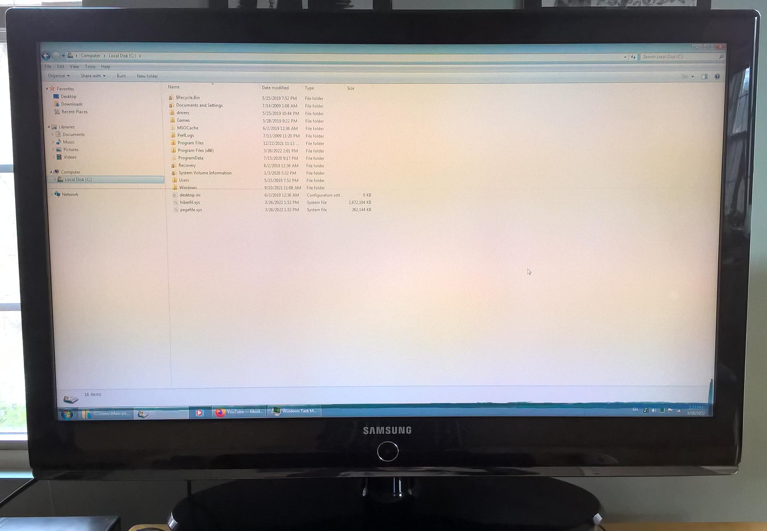

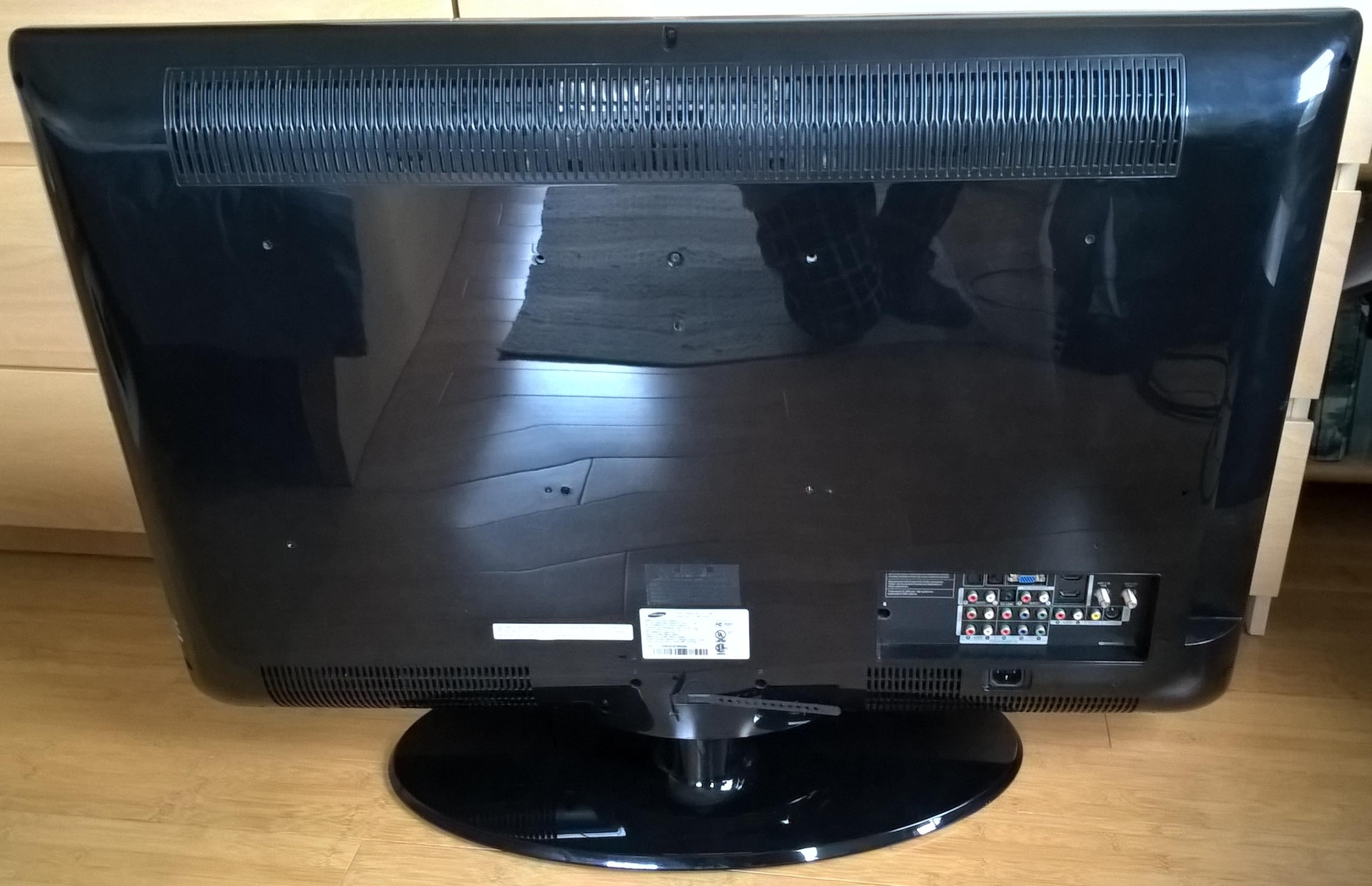

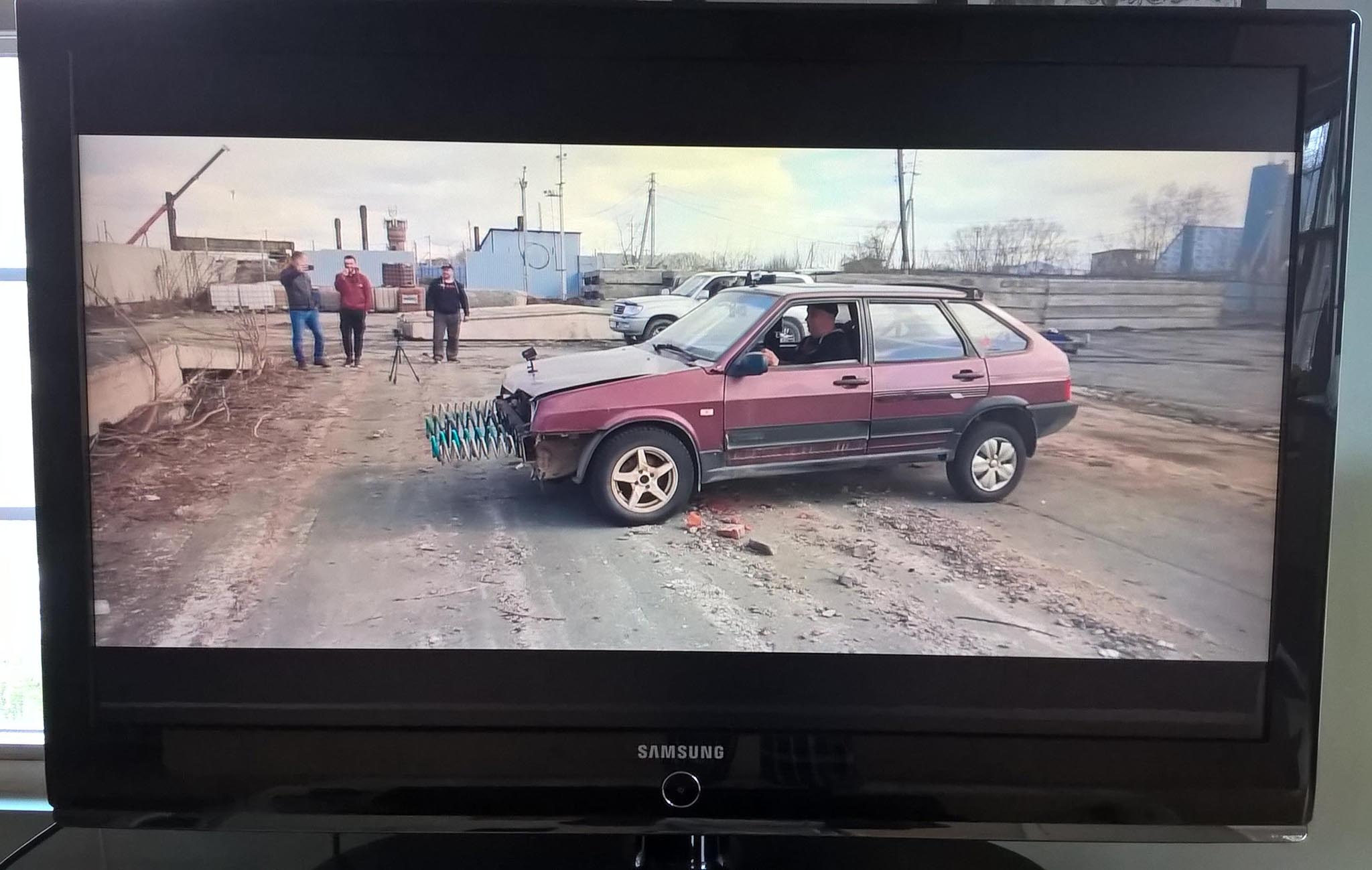

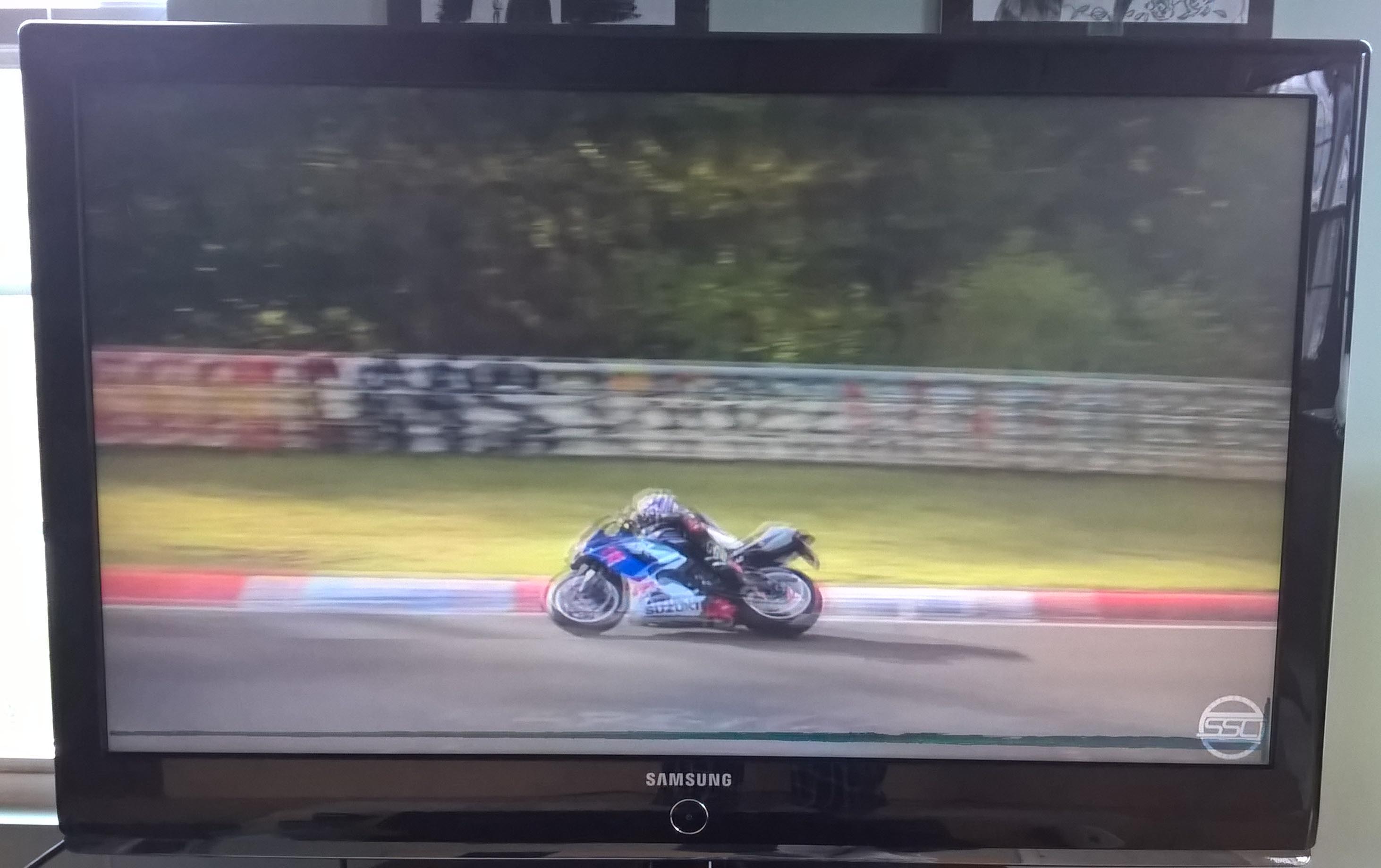

                                Samsung LNT4061FX-XAA 40” TV
                                As usual, I’ll start with a bit of a story. I picked a Samsung LNT4061FX-XAA 40” TV up in December of 2021 from next to a dumpster near a condo in my area that I pass by on my way to one of the grocery stores. We had rain forecast for the evening, but I left the TV sitting there, hoping someone would take it (besides, I was skeptical if that condo was clean or not in regards to roaches and other pests.) However, no one did and I returned for it later in the evening. By the time I was there, the TV got rained on a little. But figured I’d still pick it up. Worst case, I’d pull the boards and scrap the rest.
                                Once I got it home, I wiped the moisture from it and then put it outside again, covered with a trash bag to prevent it from getting rained on more. The next day after the rain stopped, I pulled it apart and inspected it - no roaches or anything else indicative of pests hiding in there. However, the TV did have a thick coat of dust with very strong scent of air freshener (probably one of those households that has an air freshener plugged in every socket on every wall, LOL.)
                                Upon opening, I immediately spotted a bad cap on the PSU – a SamWha WB, 25V, 1000 uF.
                                However, I decided to test the TV as-is, just to see what it did and if the screen is OK. Interestingly, the TV worked, despite the failed SamWha WB cap. The bad news is that the screen wasn’t exactly good… though not broken either. It was this:

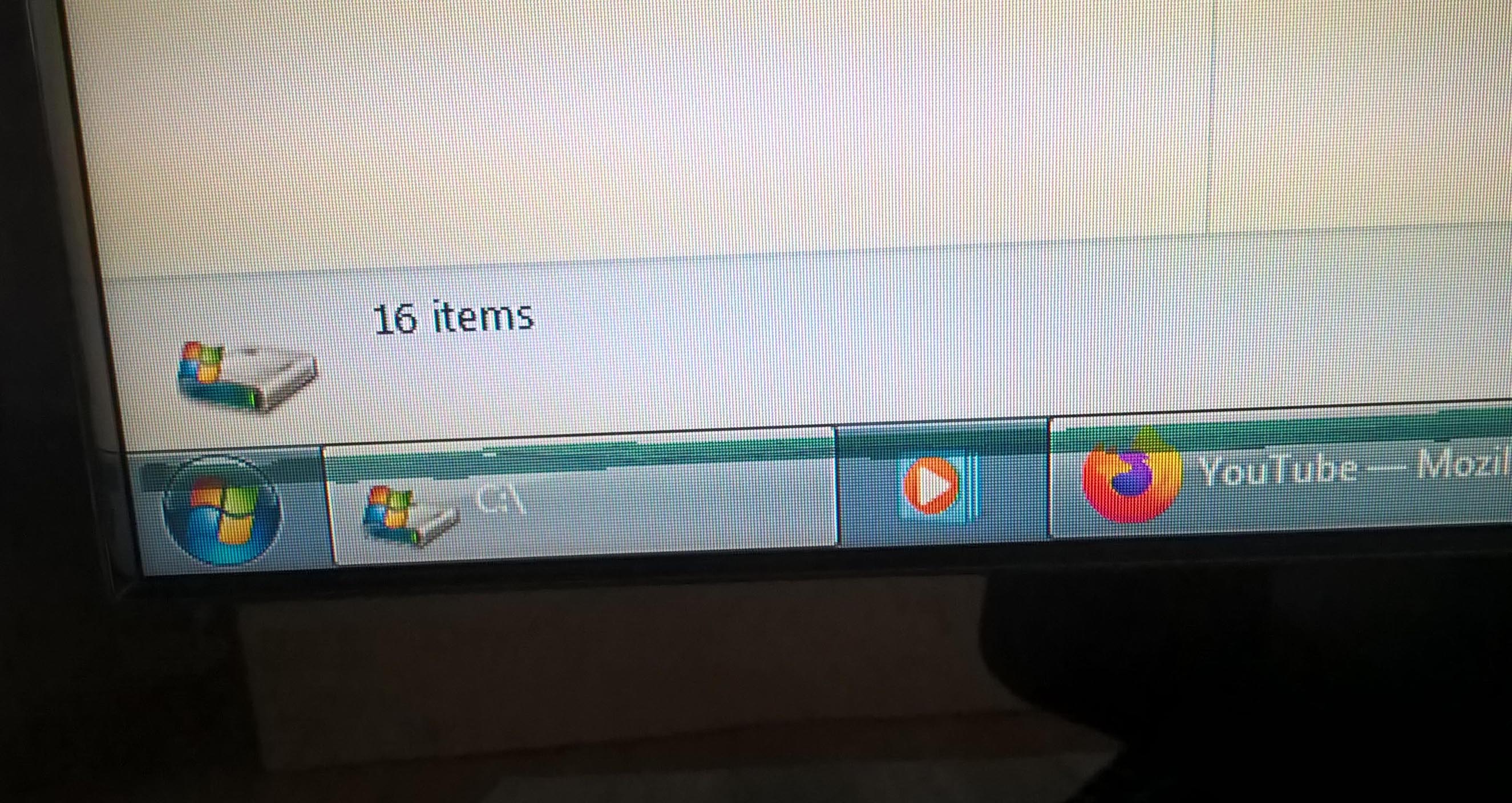

                                … basically a thick row of dead / dying / dark pixels on the bottom of the screen. Shame, because it is a 1080p TV, despite being older, not smart, and only 60 Hz refresh.
                                More pictures of the issues with the screen:

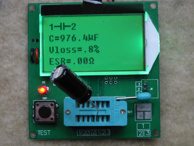

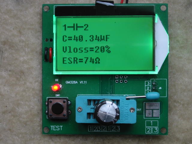

                                At first, I though I’m not going to waste any good-branded caps on the PSU board. Just replace the one failed SamWha cap, take pictures, and donate the TV as-is (well, jury’s still out on that.) So for a test / quick fix, I replaced only the single failed SamWha cap above with a Jackcon LHK, 25V, 1000 uF that I bought back in 2017 for cheap when I worked in MicroCenter (was going to use this cap along with a few others to fix a recycle bin –rescued LCD for my workbench there, since I couldn’t take the monitor with me… but I ended up not having enough time before I left that place.) Believe it or not, this Jackcon cap was still showing good ESR and capacitance after 5 years of storage and never used (not that I’m making any claim here for Jackcon to be considered good or even OK, but just worth noting they can be used as a temporary/test fix.)
                                And here is what the failed SamWha WB cap read like:
                                With the SamWha cap replaced, I then finished the TV by cleaning / wiping all of the plastics to get it ready to give away. And again, it’s a shame about the screen defect, because otherwise look how clean the TV came out after cleaning:

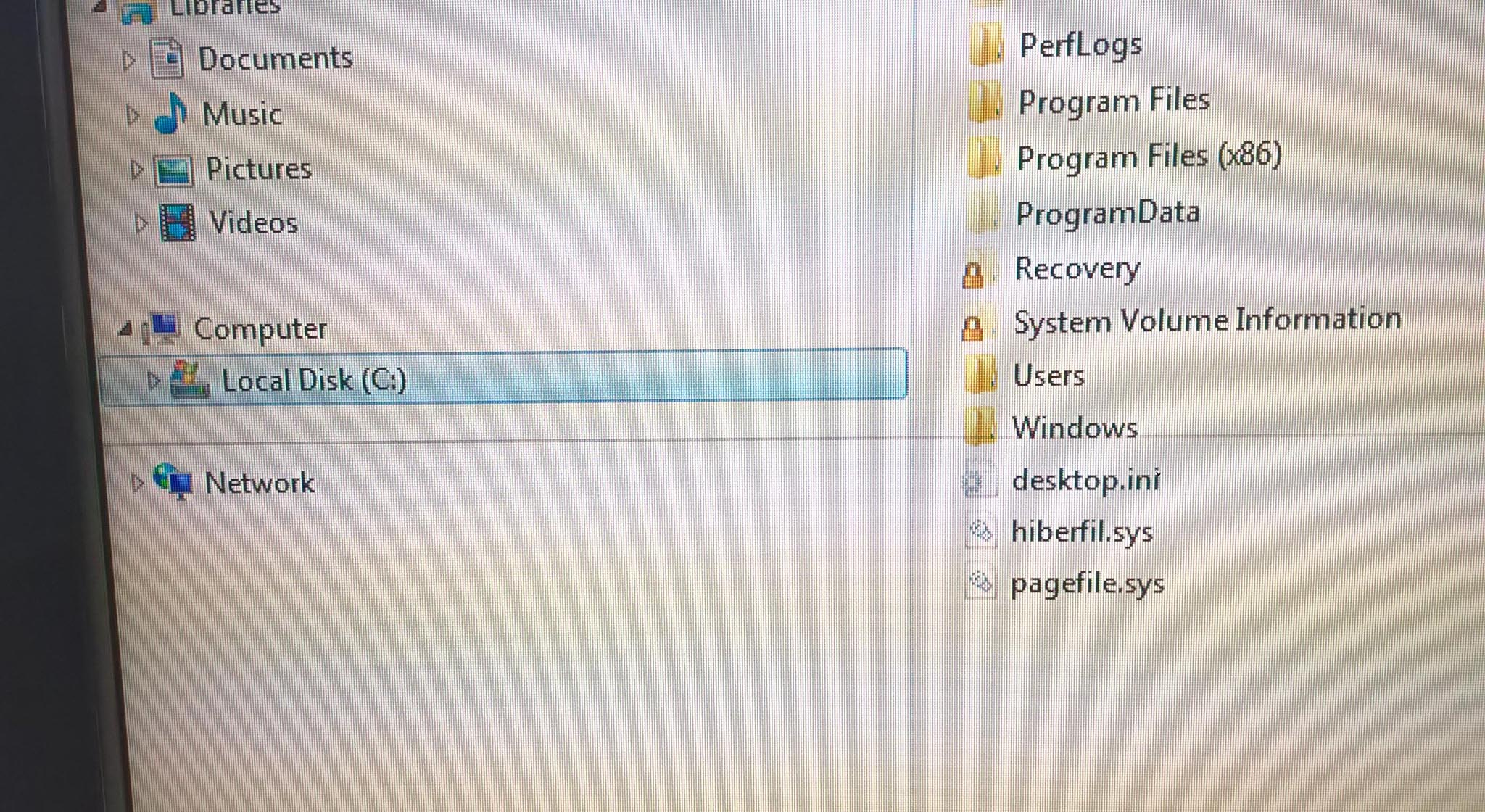

                                What’s even a bigger shame is that I saw a ton of working 720p and 1080p TVs being given out for free (or as little as $10-20) in the last year, all the same size or even bigger than this Samsung, with no screen defects. Many came with remotes, too. I guess no one cares about 40-50” TVs in my area anymore. Looks like they fall in a size that is too big to be a kitchen TV and too small to be a main / living room TV. Mine being without a remote and with a screen defect seemed just not possible to even give away for free. The most ironic part is that I don’t even watch TV! (And I have plenty of 19-24” LCD monitors, which is my preferred size, so not much use as a monitor either… but jury’s out on that as well. )
                                Then one boring rainy day last spring, I thought, “Ah, what the hell!” - in for the penny, in for the pound / dollar / [insert your currency here]. I decided to do a more extensive recap on the PSU board, since I already had some of the values in stock.
                                And I did. The repair is posted in the thread below (figured I’d split it in there, since I put some cap info and whatnot.)
                                https://www.badcaps.net/forum/showpo...55&postcount=6
                                So what am I going to do with this TV? No idea yet. Don’t think anyone will be interested in it, but will see / try again. I bought a used remote for it for $6, so it’s a complete set now (I guess that’s the nice thing about older Samsung TVs – remotes are abundant and cheap on eBay.) The TV is currently set up as a monitor with a spare PC I have. It doesn’t see much use, as I use that PC only for testing software or burning DVDs once in a while. The TV also doesn’t look too bad when used for watching extended wide screen content, such as shown below, where the screen defect is not visible at all:
                                So all in all, it’s usable. At least for a little while longer, I guess that would be another TV saved from the landfill. Good enough for me.
