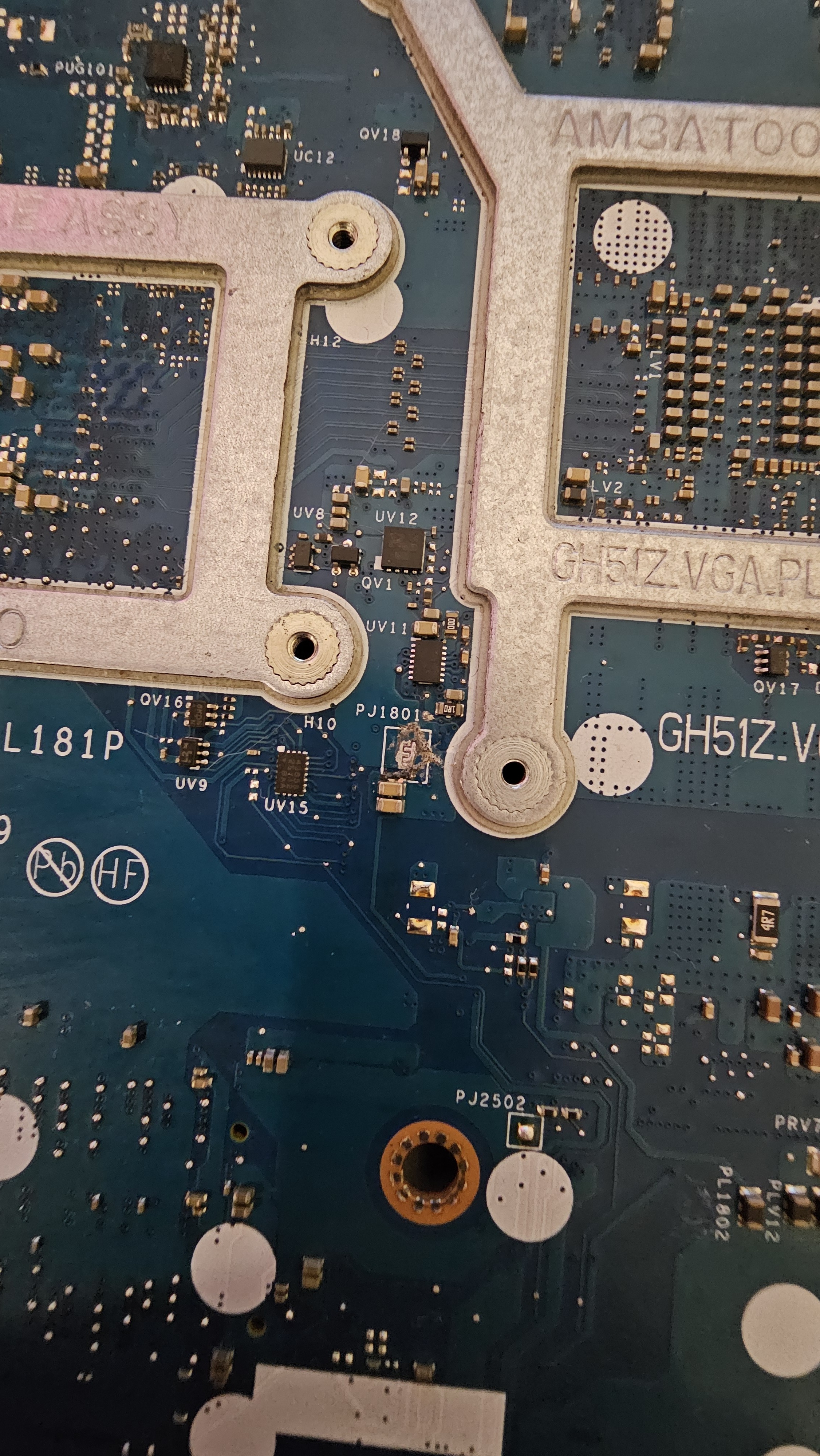

    I opened the jumper PJ1801 (as per the schematic) to isolate the circuits. The short on the +1.8V rail disappeared. This leads me to believe that the issue is on the +1.05V rail?

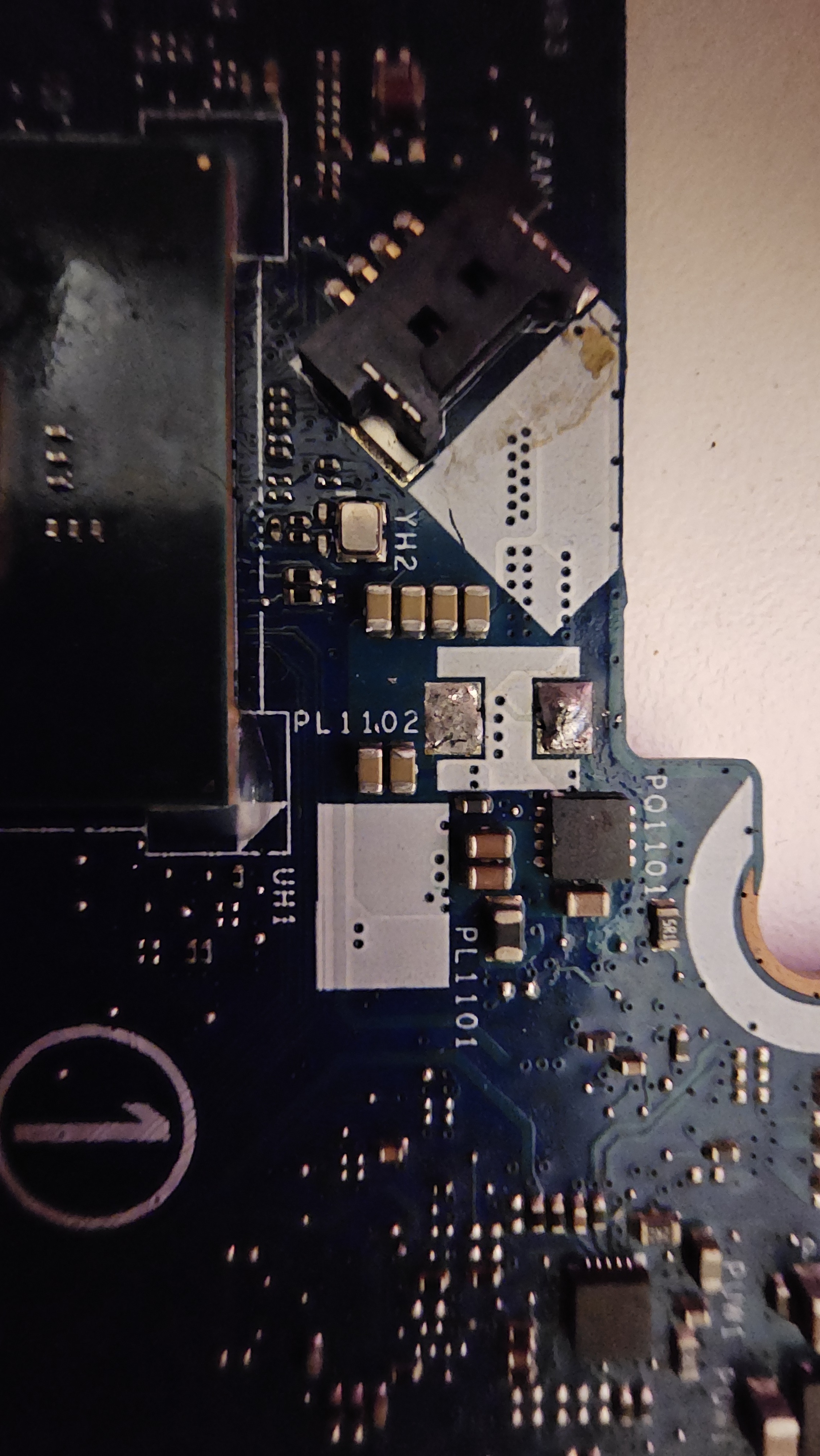

    When investigating the +1.05VALW circuit, the schematic is a bit confusing. It mentions a jumper PJ1101 which is not physically present on my board; I wanted to open it to further isolate the short.
    I couldn't find direct references to a voltage named +1.05VALWP. I interpreted this rail to be +VCCIN_AUX_PCH. Is this correct?
    The coil for the +VCCIN_AUX_PCH rail (which I believe is the +1.05V rail) is shorted to ground.
    Since there's no jumper to isolate this section, I removed the coil to check if the short was on the power delivery side (before the coil) or on the PCH side. (I'm not sure if removing the coil is the ideal procedure here, is it?).
    After removing the coil, the short remained only on the PCH side pad.

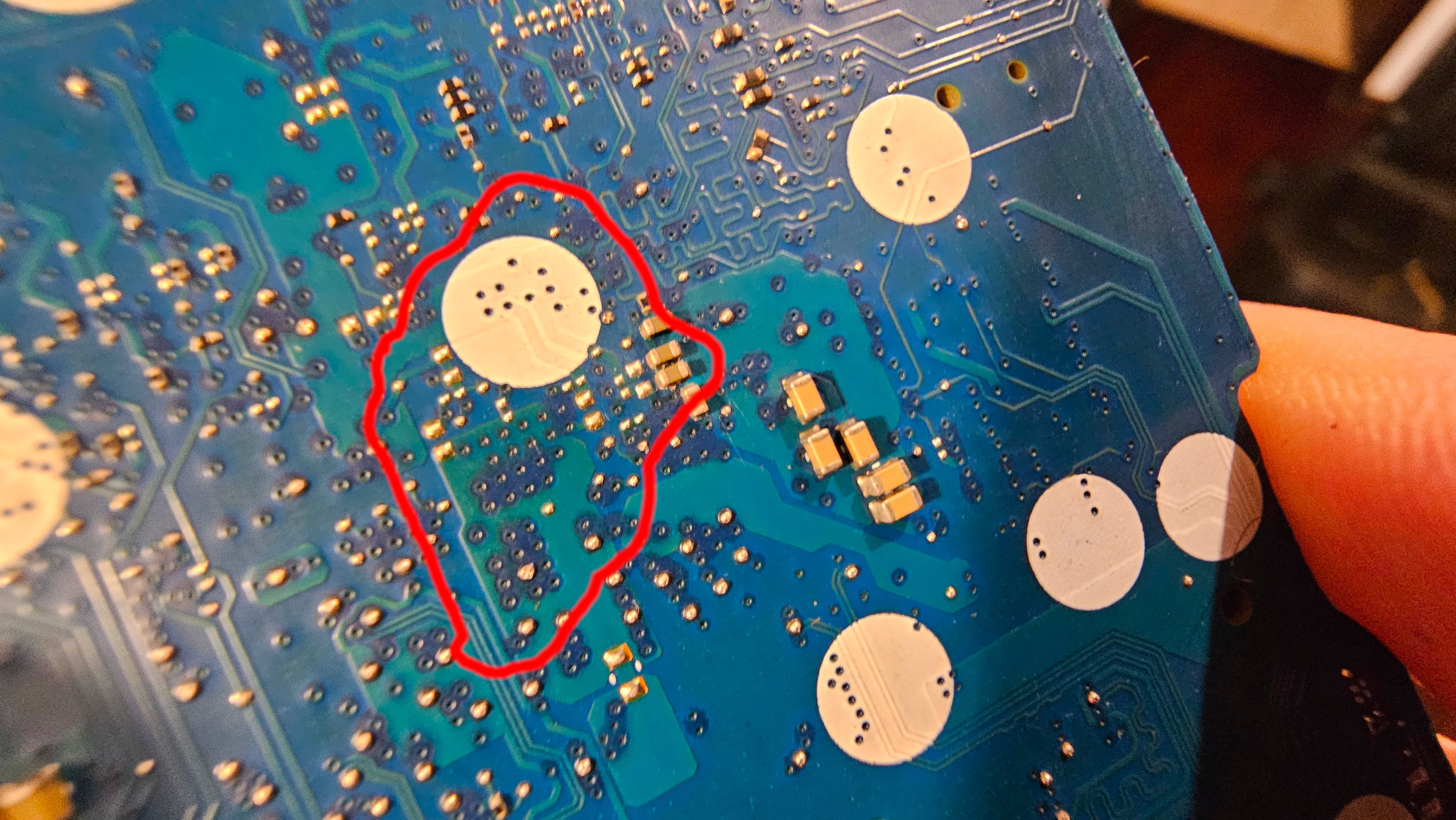

    OH! I noticed a slight yellowish discoloration on the PCB, directly underneath the PCH. Could this indicate overheating and be the cause of the problem? I've read online that on some Nitro models, the PCH can overheat and fail due to heat from the NVMe SSD positioned directly above it. Does this make sense? I used this laptop with two NVMe SSDs and one SATA SSD, often performing heavy, simultaneous file transfers between them for hours (Python scripts processing and moving images).
