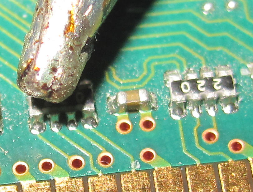

      Re: Post your worthless and/or pointless repairs
      What solder tip should I use to solder a wire to the middle pins of this 0805?
      (Getting lucky to use the via or pads is not that lucky, there are none on the other side...)
        • 31197
        #63
        the smallest you have
        i would either use the ILS 0.2mm or a blade/knife style tip.
          Pictured is the smallest I have at least for conical.
          Not sure if I have a wedge tip that could heat just one of the middle pins.
            Originally posted by eccerr0r
            remember 0805 4-pack resistor... so basically four 0201's next to each other!
            I did something similar on an old P3 motherboard, shown here. The resistor array there was the slightly larger size, so that's why it was easier in my case to go with 4x individual resistors.
            But these small ones on the RAM modules - I don't think they could be easily done with individual resistors and hand-soldering. Perhaps with hot air? But then might as well replace the whole array.
            With that said, here's a new idea :idea: : why not scratch off some of the solder mask from the upper trace and solder one side of a small SMD resistor there. Then, to the other side of that resistor, solder a really thin wire to go to the via or trace on the other side of the broken resistor. I've done something like that multiple times - particularly fine trace repairs and/or video cards that lost a bunch of small SMDs on the back from mishandling (not by me, though. )

              #66
              :o
              Yeah, replacing the whole array is probably easier for these for 0805 4-packs with hot air.
              I think I could try 1208's with 4x0603's, but putting in 4x0201's for an 0805 ... But not sure at this point what to put in, as I have no idea where to get 22 ohm resistors of any type. Putting in two 10 ohm ¼W resistors does not seem like a good idea.
              BTW, only one resistor in the middle of the pack is open, and I have no idea how it got destroyed with the outside ones just fine, as well as the size of this thing.
                If all you have is through-hole resistors, then clear solder mask on traces on both sides of the broken resistor and solder fine wires to that (i.e. forget about soldering directly to the array resistor - you will more than likely bridge connections on it... I've done it more times than I care to remember, but I do remember enough that I don't do it anymore.) Then, solder the other end of the fine wires to your resistor(s) (if all you have is 10-Ohm ones, then two in series should be more than close enough.) Otherwise you can get such small low-values SMD resistors on junk motherboards (next to the RAM area) or video cards (behind/near RAM chips.) I imagine anything from 20-47 Ohms will probably work.

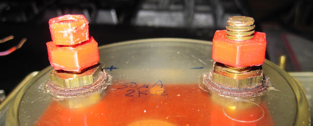

                              Not sure if this is worthless, pointless, ghetto, or simply dumb:
                              I have this old analog meter that has ¼" posts for connecting wire to it. However it seems both standard NC 20TPI and NF 28TPI nuts do not thread - it appears to be 24TPI...
                              So I printed plastic ¼" 24TPI nuts on a 3d printer...
                              They thread on tight enough so that I can attach a wire to the post at least. Fortunately there is a metal backing nut so the plastic nut only needs to push up against the metal one.
                                • 31197
                                #75
                                and then you find it's metric thread!
                                  metric? What's metric?
                                  (The meter is an RCA 50µA meter from the 1950s that appears to have been part of a multimeter, probably not VTVM. It has 4 mounting screws that are 6-32.)

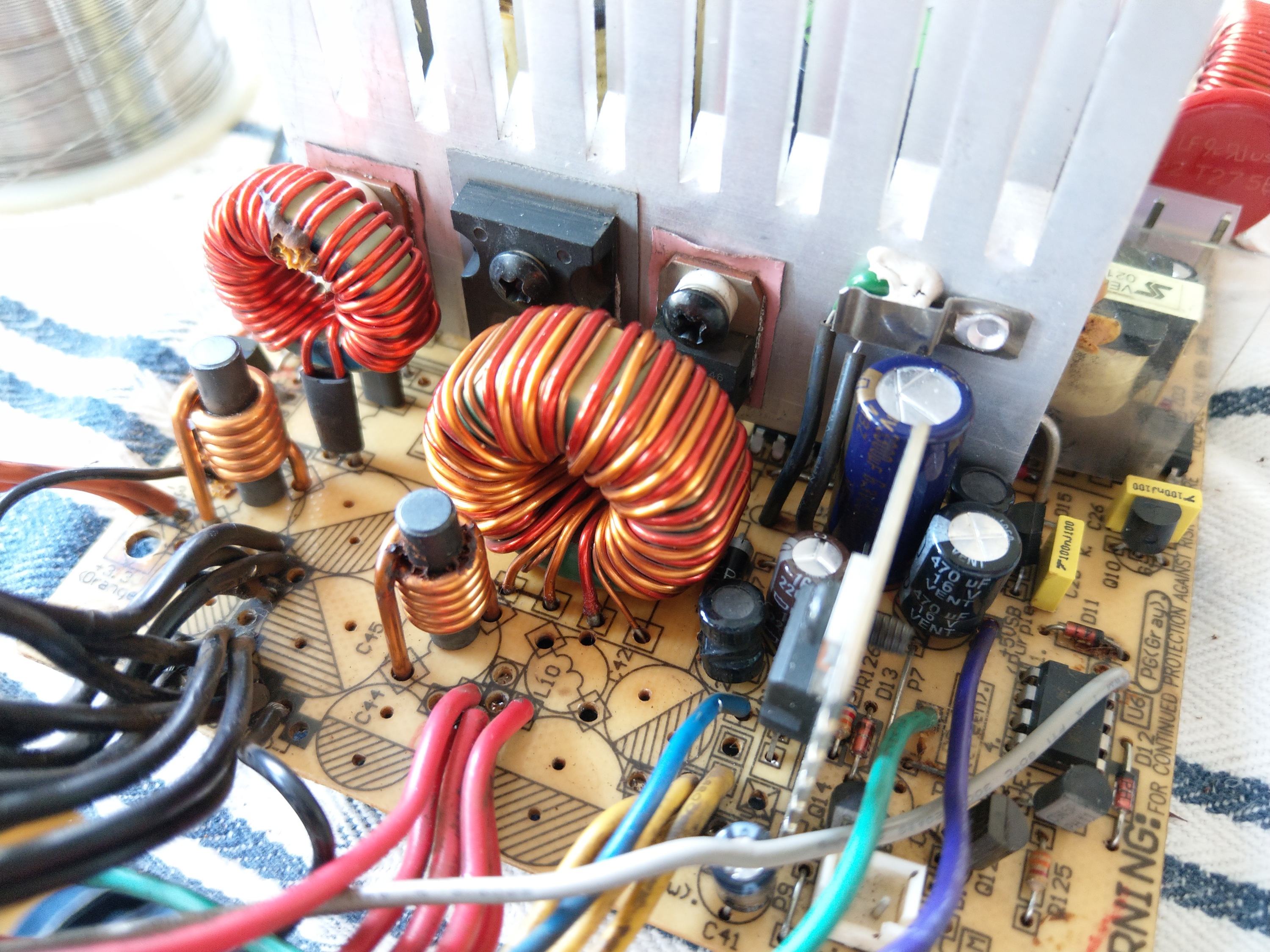

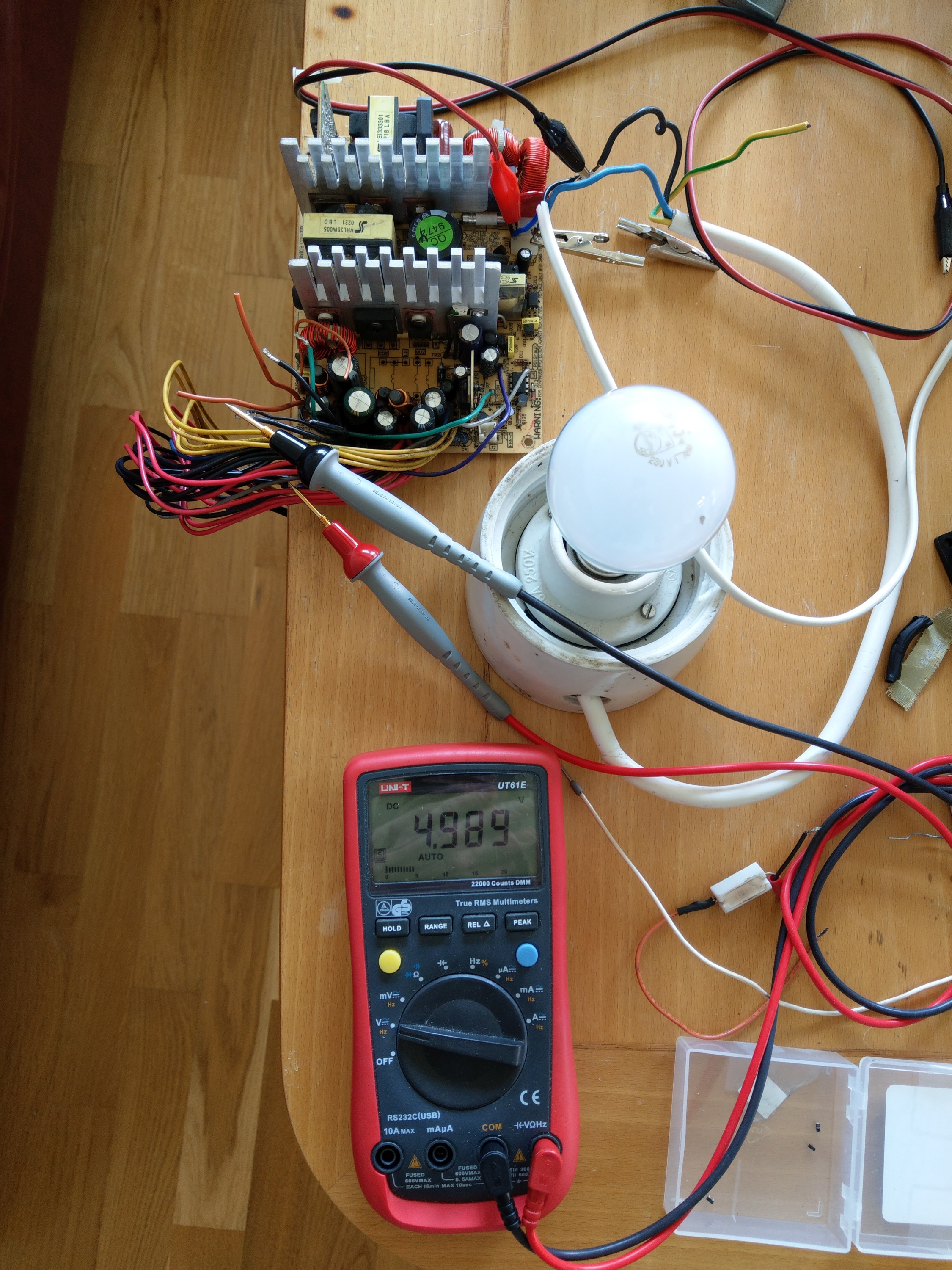

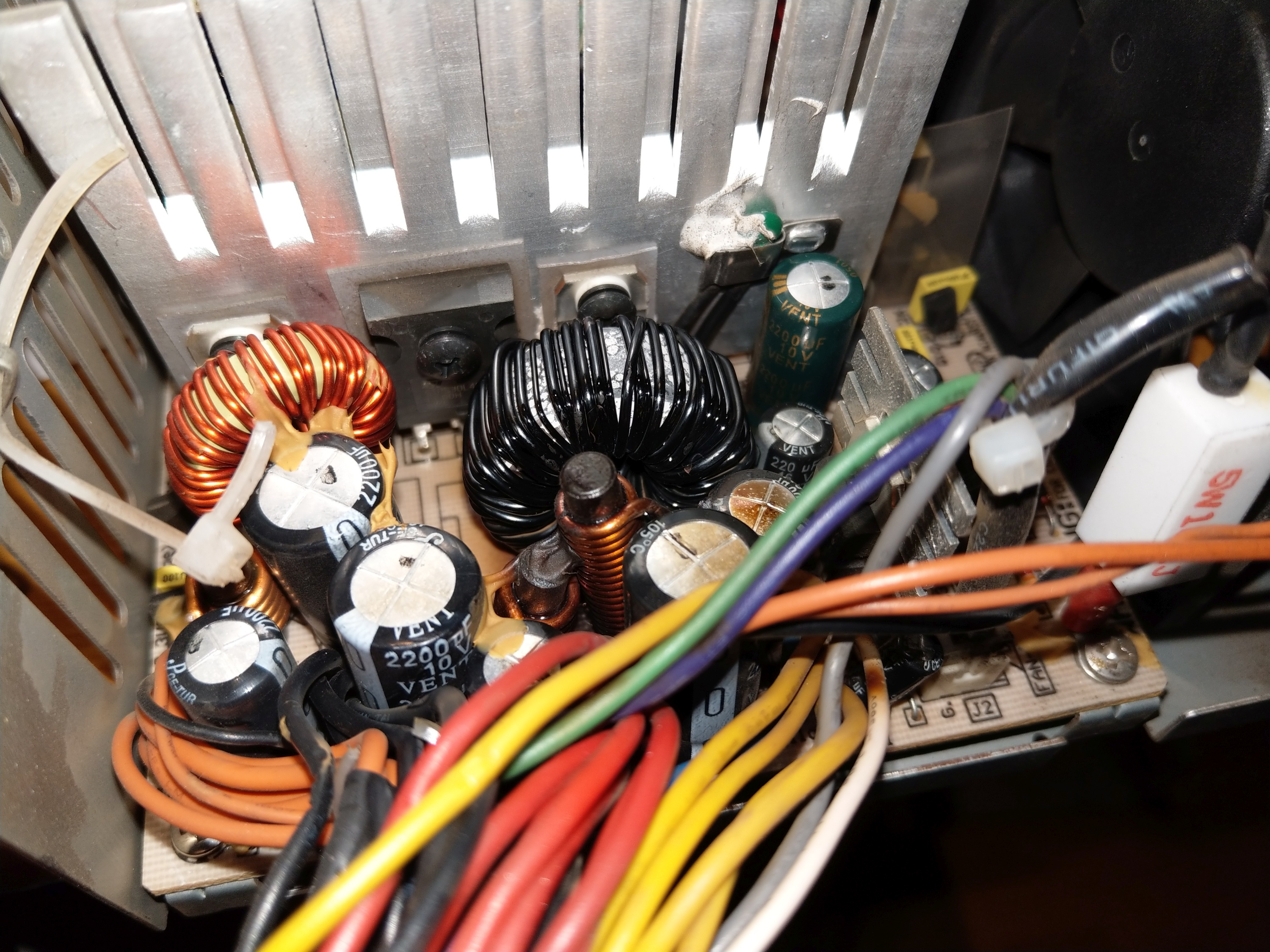

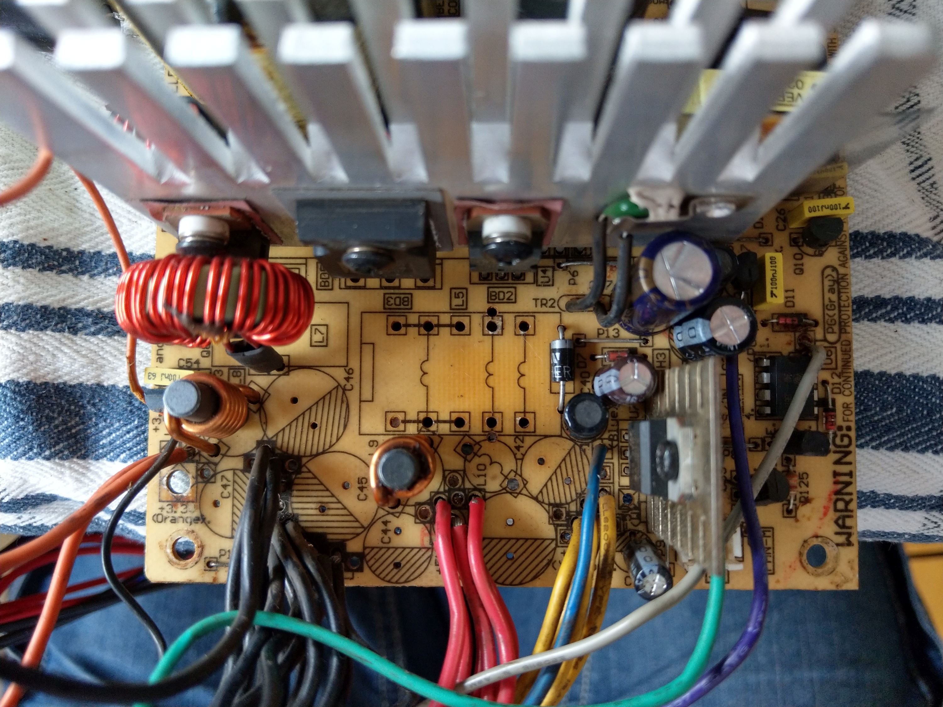

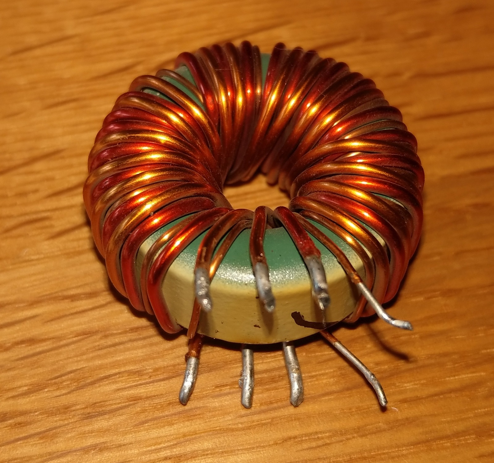

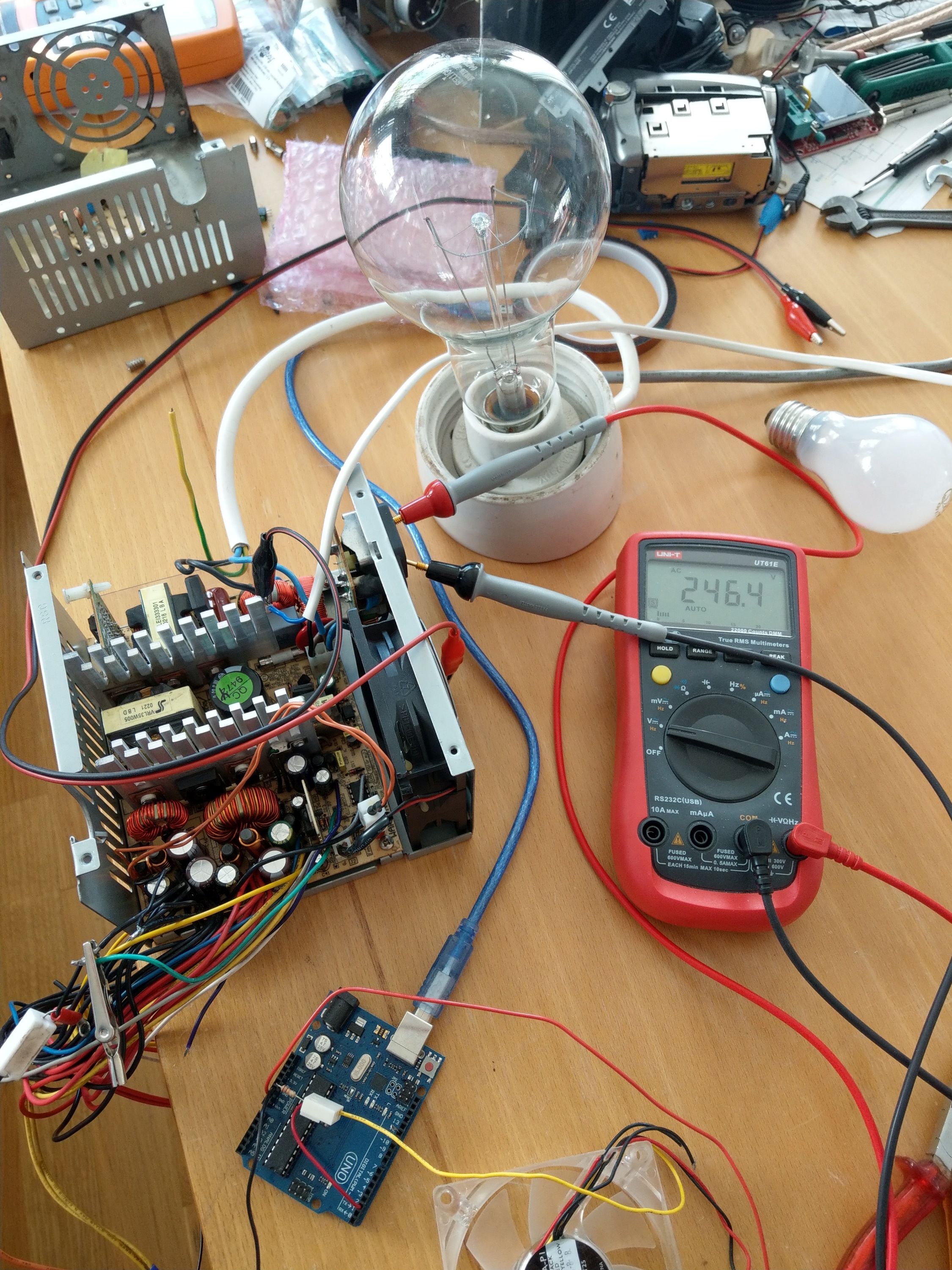

                                    I have used the PSU mentioned in this thread as a parts PSU since, well, you see the date on that thread...
                                    I also have another Seasonic SS-250FS that I got a few years later but with a burned up secondary coil that I was meaning to fix up.
                                    But instead of fixing that later found PSU I decided to do the first one, since the PCB had also sustained allot of damage.
                                    That was a quite fun job to find all the required parts and make sure I did not forget anything after all these years
                                    First I powered up the 5VSB though a 75w incandescent light bulb: it fired right up with no problems!
                                    So I then put the coil I had desoldered to use in the other PSU back in, and replaced almost all capacitors except for the primary that measured good.
                                    I tried it again on the limiting light bulb but it lit up full and the PSU hiccuped.
                                    Not feeling content on bringing this APFC PSU up without a current limit I used my toaster (LOL) and it worked a treat!
                                    I then gave the seized fan a few drips of my favorite fan oil: Castrol Edge Professional Long Life 0W-30 and it spun like a bought one
                                    Finally I found a Swedish website selling 300W incandescent light bulbs so I got one.
                                    And that allows me to test the PSU even with two hard drives as load and it works fine!
                                    Oh, and the Arduino seen in the last picture is part of testing a fan failure detection circuit, but that will not belong in this worthless thread
