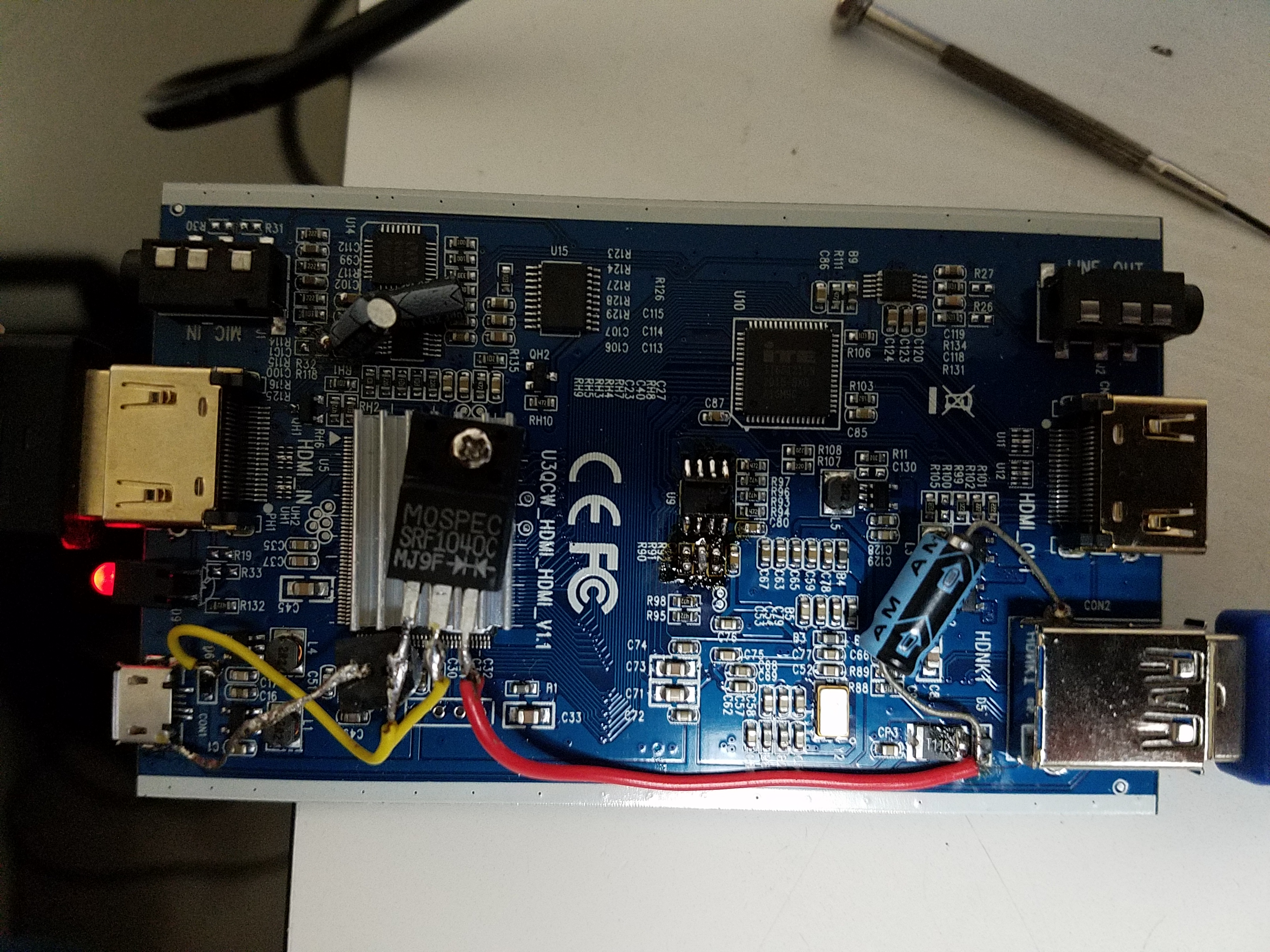

                    I have an ongoing pointless repair/mod (something that never worked properly, just like the last one). It's one of those "USB 3.0" HDMI capture devices that actually uses USB 2.0. The hardware is capable of USB 3.0, and someone found one that actually uses USB 3.0 and dumped the firmware.
                    https://github.com/ArsenioDev/USB-Ca...Card-Reversing
                    Those dumps are the wrong size, but it looks like the chip is mostly empty. I want to see if that firmware also fixes the audio problem I'm having. The captured audio skips ahead by a small period of time (a few milliseconds). It just sounds like a click or pop.
                    The design of this thing is goofy. It converts the audio from digital to analog and then back to digital just so they can mix in a microphone input (and forgot DC blocking caps), and the HDMI output is split from the output of the video scaling chip. The output is always scaled to 1080p, but it also means that the output has HDCP stripped.
                    So far, I have improved stability by replacing the diodes in the power input stage (a simple diode-OR circuit) with diodes that have a lower forward voltage.

                        The capture device firmware update fixed the audio. Unfortunately, it still won't connect at USB 3.0 (Windows says that it's USB 3.0 capable now, so it's probably a bad cable), and the compression quality is even worse (a good USB 3.0 cable should allow me to disable MJPEG compression).
                        I also have a cell phone picture of what the board looks like now. I added the extra caps on the input of the WM8960G (between it and the CS4344 DAC next to it) and screwed the new diode (replacing D5 and D6) onto the heatsink.
                        By the way, the firmware I had was identical to the 4MB file on that Github link. It's a 512kB Flash chip, so there are eight identical copies of the data in that dump. The 64kB file was the one that worked, and the rest of the chip is blank.

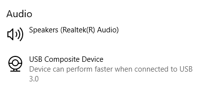

                                I finally got a USB cable for that video capture box. It still used USB 2.0 only, and then it died completely ("device not recognized" error).
                                Also, the sample frames I posted earlier don't show how bad the video quality really is with the "USB 3.0 capable" firmware when it falls back to USB 2.0.
                                If this worked, I would have attached the firmware dumps.
