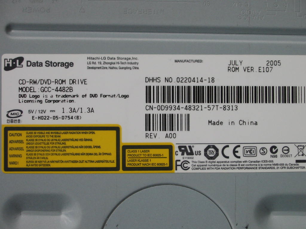

    As I’ve done optical drive repairs on Xbox 360s and PS3s before (as well as a few PC optical drives too), I decided to crack this one open and see if I could figure the issue out. I was hoping maybe there would be some bad caps.

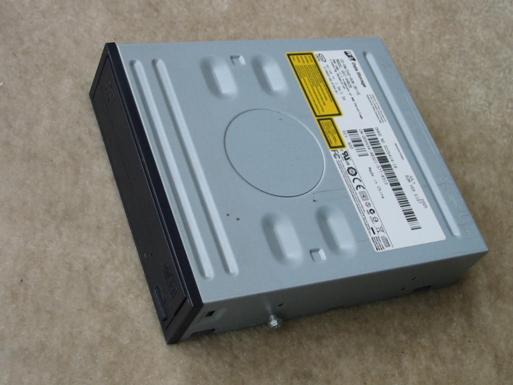

    And so here is the CD-RW/DVD-ROM drive: a Hitachi-LG Data Storage (HLDS) model GCC-4482b.
    Label:
    https://www.badcaps.net/forum/attach...1&d=1500859375
    Upon opening it, nothing seemed obviously wrong. I reseated all connectors and tested by powering up the drive with an ATX power supply, but it was still doing the same thing with the LED. So clearly there must have been a faulty component on the PCB. Speaking of which, here are the top and bottom pictures of the PCB:

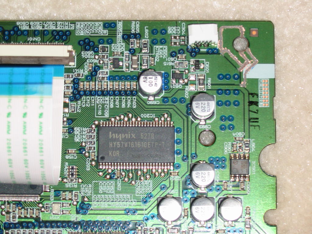

    After seeing all of the SMD caps, I wasn’t too excited about removing them to test. The first idea that came to my mind is solder some caps in parallel to see if that eliminated the problem. To do that, I started checking how the caps are connected (i.e. which voltage rails).

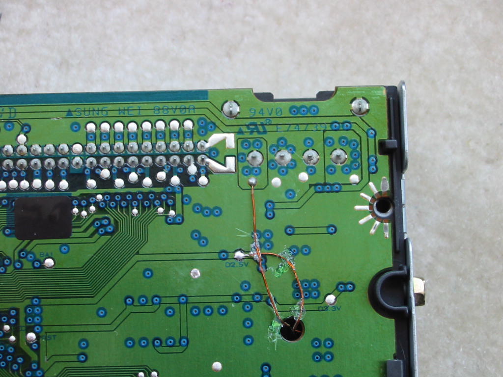

    While at it, I noticed a few more things: the bottom of the PCB had all kinds of test points marked on it. On the right side, I saw two test points: O3.3V and O2.5V. Measuring the voltage revealed that O2.5V was not present (just a few mV), but O3.3V was okay.
    This led me to look for the regulator responsible for generating the O2.5V rail. With not that many components on the board, it only took a few moments to trace that both O2.5V and O3.3V rails were connected to IC901 (labeled 09B X01 5 1, for which I couldn’t find a datasheed). Here it is from up close
    Resistance/continuity measurements revealed that this IC was indeed the source of both the O3.3V and O2.5V rails. I found the caps responsible for filtering its outputs, too: C690 and C994, respectively. I soldered some caps in parallel with these, as well as the input cap for IC901 (I can’t remember which cap that was, but I think C391) in hopes that the caps were the problem. Then I connected everything back up and applied power… but same thing again: LED stuck ON and 2.5V rail reading close to zero volts.
    The next logical step was to check resistance of IC901’s 2.5V output to ground. However, it was not shorted or low-resistance to ground. As such, I decided to go a bit “experimental” here and see what would happen if I inserted 2.5V from an external source without disconnecting IC901. I didn’t have an adjustable PSU bench (yeah I know, such a shame for someone that likes to troubleshoot electronics ), so what I did instead is take a diode and wire it from the 3.3V rail on my test ATX PSU to the 2.5V rail on the drive. With a diode drop of 0.6-0.7 Volts, I figured I would get about 2.6 to 2.7V. It looked like the 2.5V rail was used for the RAM cache chip, so 2.6-2.7V didn’t seem too dangerous. I also put my multimeter in series with that to measure the current, in case there is something wrong (in which case, I could immediately power down my test PSU… though I don’t suggest anyone to do rely on this method, as you can still do quite a bit of damage if something is shorted).
    So I wired everything and gave the ATX PSU a quick power on. Almost surprisingly, nothing smoked. However, I did get a bit frightened as I wasn’t expecting any noise. The noise came from the tray motor as it pulled the tray closed and the drive did a disc seek. But that’s good news – it’s probably alive!
    The 2.5V rail drew about 200 mA, if I remember correctly. And with my plain diode, it was actually dropping a little over 0.8V, meaning I was feeding the 2.5V rail with about 2.45V. Seemed good enough for me, so I popped the tray open and inserted an audio CD, then closed it. The CD spun and I could hear the drive start to read. – Yup, the drive was definitely alive!

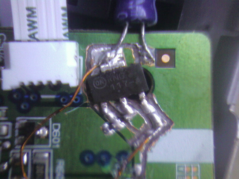

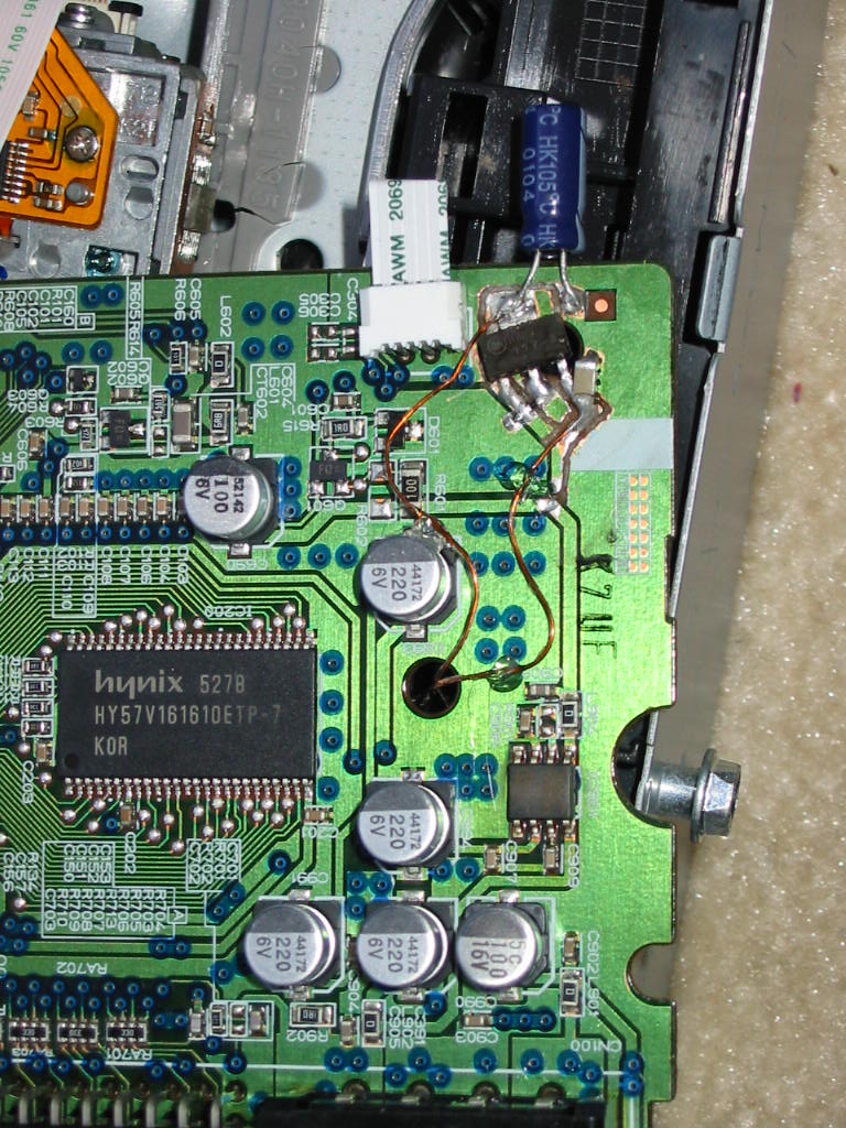

    With that said, I started to think how to generate the 2.5V rail inside the drive. Surely I could take a diode again and have it drop voltage from the 3.3V rail from IC901. But that didn’t look appealing to me, as I thought it might overload the 3.3V output on the regulator (and knowing that the regulator already wasn’t outputting 2.5V, that just screamed bad idea). I also knew I had a bunch of 3.3V, 1.7V, and adjustable 1117 regulators from the numerous Xbox 360 motherboards I had scrapped over the years. The adjustable regulator seemed like a better idea, as I needed around 200 mA of current and I could use the 5V rail to supply that.
    Some quick power dissipation calculations revealed that with a 5V input and a 2.5V output, the regulator would be dropping 2.5V. At 200 mA, the power dissipation would be 2.5V x 0.2A = 0.5 Watts – definitely something the regulator could dissipate if mounted on a small copper pad on the PCB.
    As such, I took a SOT-223 1117 adjustable regulator from my parts box and started thinking where I can place it on the board so that it could have its own small copper pad to dissipate heat while also being close to the 2.5V test point. Next day, I came up with an idea. I drew on the PCB where I needed to make cuts and decided to proceed.
    Probably not the cleanest job I’ve ever done, but at this point I just wanted to have the drive fixed.
    I scraped most of the mask off the pads I had just cut away and soldered everything into place. This is the result:
    As you can see, it is just a standard 1117 adjustable regulator design with two tiny SMD resistors of equal value used as the dividers to set the output voltage. I don’t remember what value I used for these, but I think it was 1.2 KOhms or something like that. Basically, I just started pulling resistors from a scrapped Xbox 360 motherboard, and these two were the first that had an equal resistance value that seemed reasonable for the circuit.
    Preliminary testing revealed that everything worked. But then I realized, the input of that regulator is probably too far away from any caps. So I did a small revision and added a 4.7 uF ceramic cap right by the input of the regulator.
    Unfortunately, I couldn’t add an electrolytic cap on the input anywhere nearby as I didn’t see any space. However, I was able to conveniently place an electrolytic cap at the regulator’s output – yes, that’s the blue cap sticking out of the board like that. I know I should be ashamed here – not because of the way I mounted that cap, but because that is a crappy Jun Fu HK cap It did test okay on ESR and capacitance, though. Speaking of which, I forgot what capacitance and voltage ratings it had (most likely 100 uF, 16V).
    I probably should have done this repair a little better. Not only could I have used a better cap, but I imagine some of you cringed when you saw the thin magnet/copper wires loosely running over the PCB (but patted down with hot glue ), connecting to the 5V rail and O2.5V output. (On the other hand, think of them as wires with built-in fuse protection! )
    In any case, even with the crappy cap and whatnot, this CD-RW/DVD combo drive has worked out alright. I did the repair back in January and have had the optical drive installed back in my PC since then. Still works, so I can’t complain.

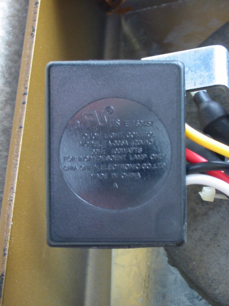

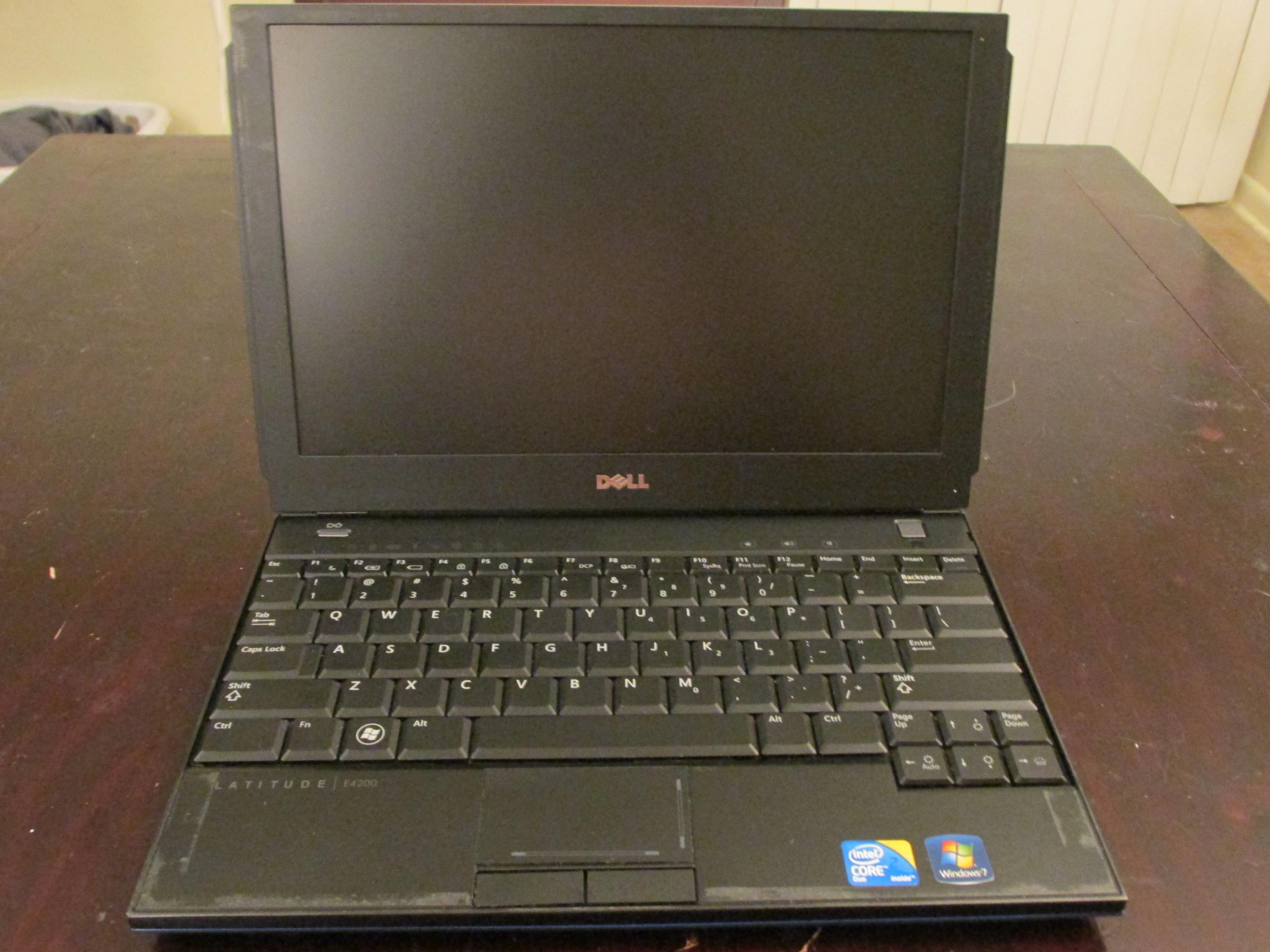

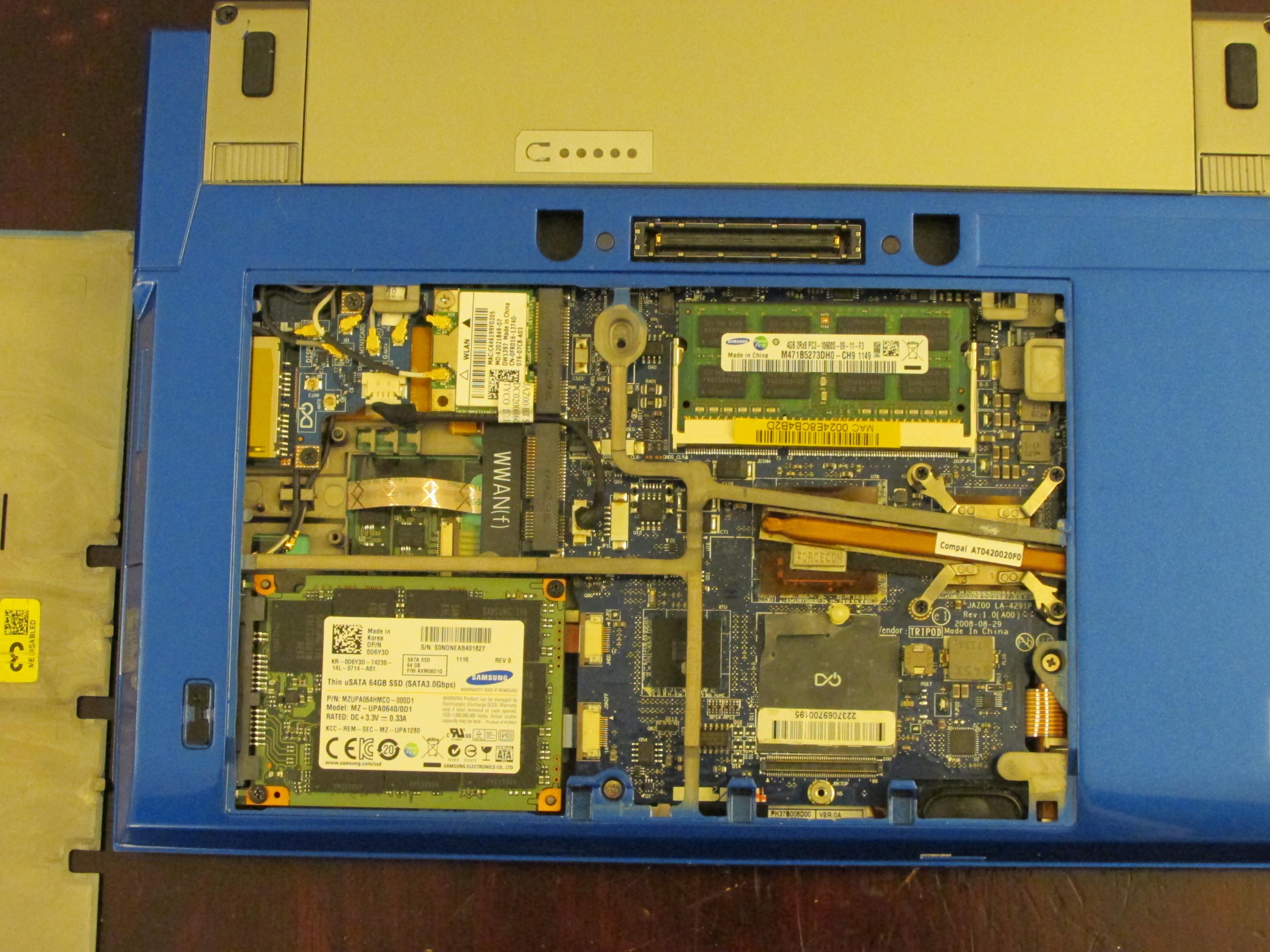

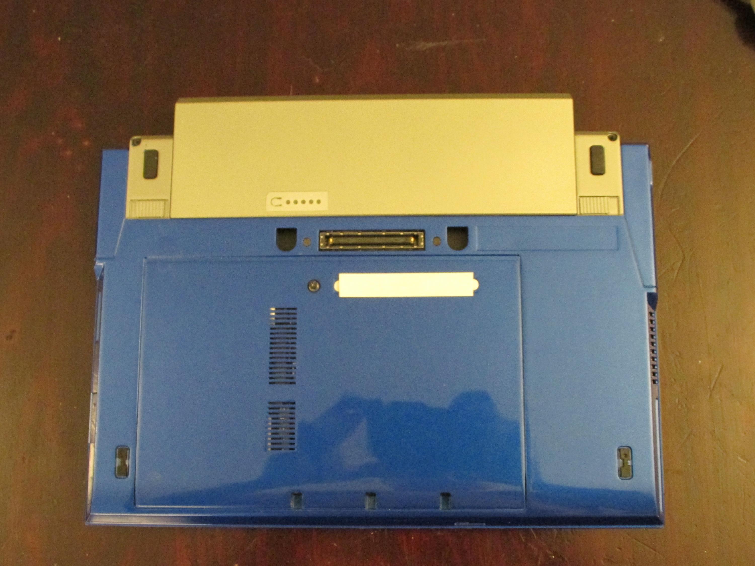

        I got this stripped (no SSD, RAM, Charger, dead batt) Latitude E4200 for $20, and proceeded to throw about $100 worth of parts at it (64Gb SSD - $30, SSD Cable - $5, batt. - $20, RAM - $20, Charger - $10) to get it working, you can pick up a working one for $50-$75 on e-bay these days (in silver or black), but I really wanted a blue one (somewhat rare color for these):
        And of course just about every power supply I've ever re-capped/rebuilt cost more in materials and time (if you calculate the value of that) than it was worth.

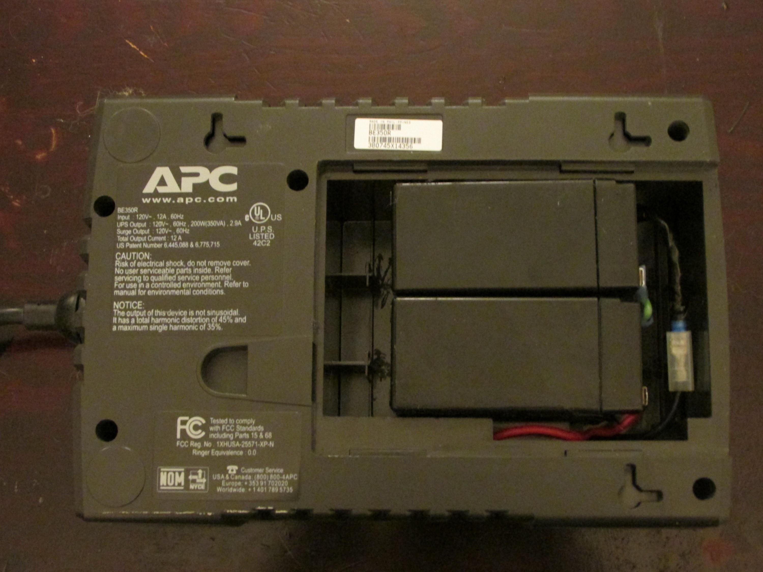

          ... And for a slightly more "ghetto" one. This APC Back-UPS ES350 with a dead battery, I didn't have the 12V 3.5Ah battery it took but I did have a couple 6V 4.5 Ah batteries, so I hacked up the case to make room and wired them together in series. On paper the batteries cost as much as the whole UPS making the repair "worthless", but I had them laying around (from a rechargeable lantern that died) so it made sense in this case:

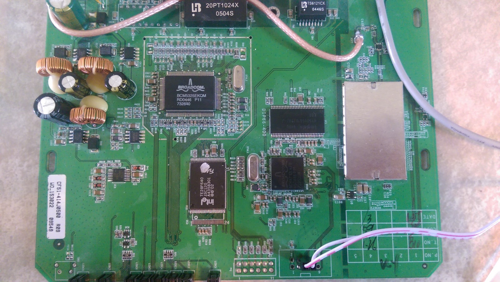

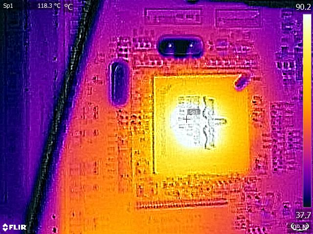

              This is a work in progress.
              I have many WRT54GS and WRT54GL routers installed at customers.
              Sometimes they take a lightning strike but don't outright die.
              That's when I take them over and try to resurrect them.
              I had three of them in my scrap pile now.
              One is 100% dead, it's from this thread: https://www.badcaps.net/forum/showpo...86&postcount=6

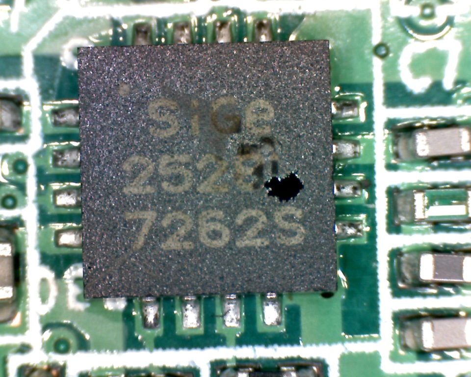

              As you can see the WiFi chip has a hole where the magic smoke has escaped, as does the amplifier!
              Oh, and the main processor is fried too, I guess this one is a bit beyond economic repair
              The second was a WRT54GL, as seen in this thread it was "repaired" by a simple nvram erase.
              It was just stuck at it's CFE but to do it I needed a serial console of course...
              Third is the "work in progress" WRT54GS router.

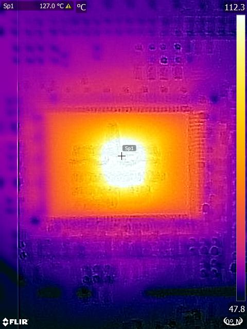

              I had discarded it earlier because it kernel panics when loading Linux.
              And the switch chip becomes hot enough to fry bacon on, not kidding:
              Well, I did some research and with the help of the nice guys on #lede-dev they suggested it's the WiFi that causes the kernel panic.
              So I built a version of LEDE with the sole difference of the Broadcom B43 driver not being loaded.
              With this change it loads LEDE right up and works great without WiFi!
              (Of course with a big heatsink on the BCM5325EKQM switch chip).
              So now I have ordered a new switch chip on Aliexpress, let's see if it arrives this year

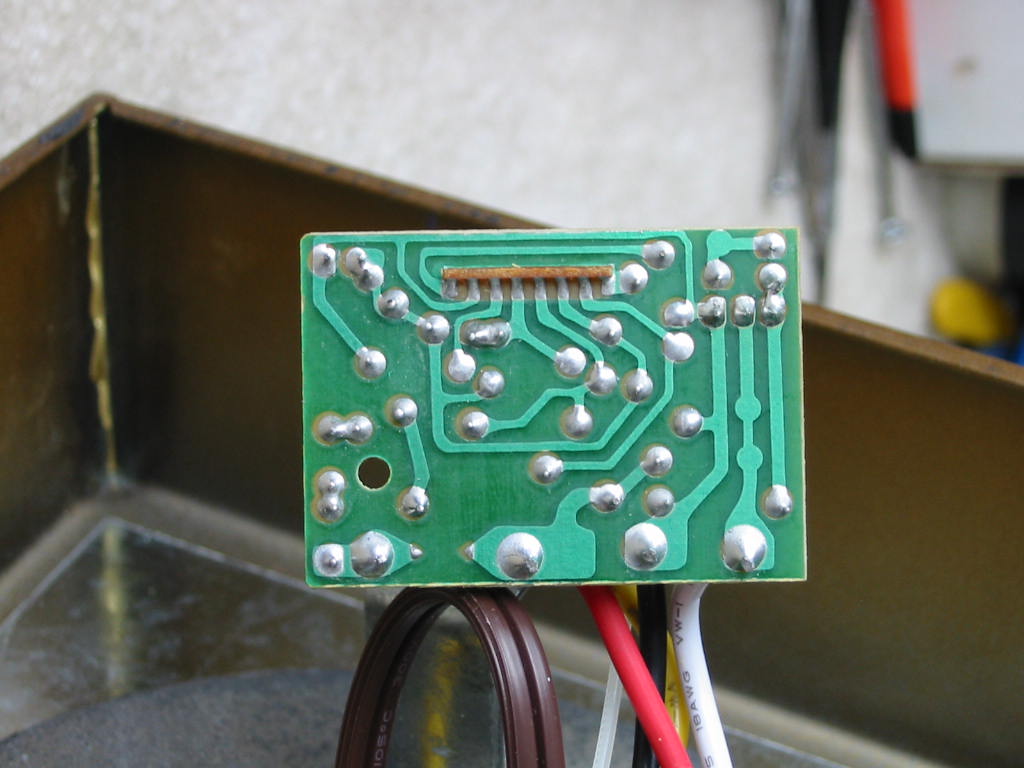

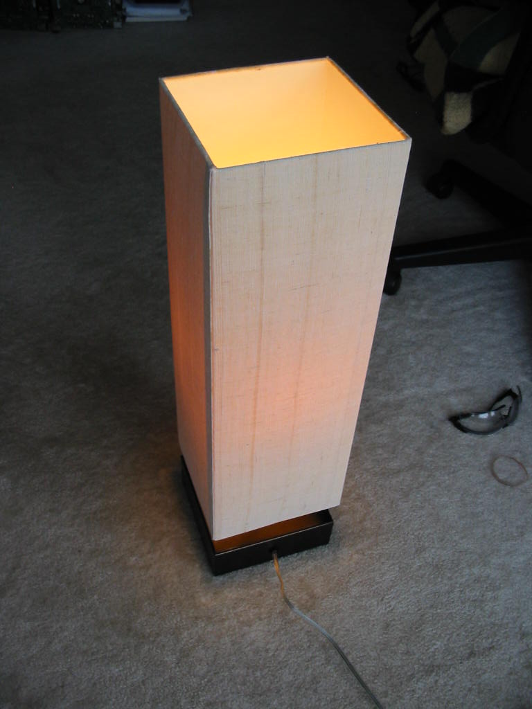

                                  Re: Post your worthless repair - touch-start lamp repair
                                  Okay, here is another one: a night-light / table lamp with touch-start control (i.e. you touch the metal body of the lamp to turn it ON and OFF). The repair was very simple: just had to replace a TRIAC in the lamp's control circuit. When the TRIAC goes bad in these lamps (typically short-circuit between T1 and T2), they stay full-ON all the time and cannot be shut off unless unplugged.
                                  Here's the lamp I had:
                                  https://www.badcaps.net/forum/attach...1&d=1501046004
                                  The control box:

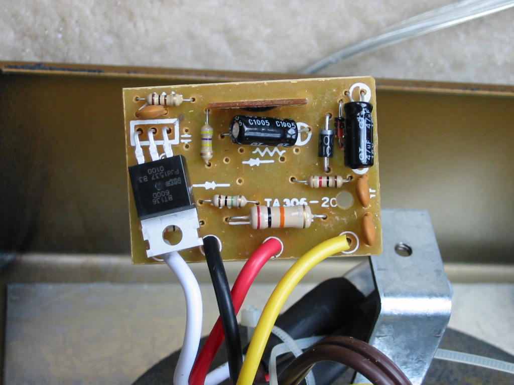

                                  And here is what's inside that box:
                                  As you can see, it is not very impressive. The controller is located on the small daughterboard – not sure what it is, as it's just a cheap COB. The TRIAC does not have any heatsink and the general layout is pretty poor, with the TRIAC's tab touching the wires (which is NOT GOOD, because if the tab gets hot enough, it can melt through those wires). Luckily, this regulator is a series device, with only the Live going through it (Neutral goes straight to the bulb). The red and yellow wires are for the touch sensor (sorry, forgot to take picture). The white and black wires are Live input and Live output (to light bulb).
                                  It is almost not worth the repair, as these lamps aren't that expensive. However, this one belongs to a friend of my parents and she just asked me one day what the problem could be (she tried replacing the bulb only). She said her grand daughter liked to play with it by stepping it through the dimmable presets when she was young (this lamp has three dimmable presets and one preset for full-ON). I almost immediately knew what the problem was, so I took it with me. As expected, it just needed a new TRIAC. The original was a BT136-600D, and shorted between terminals T1, T2, and Gate. With only a 100-Ohm resistor separating the TRIAC's Gate from the rest of the control board, I thought the COB would be dead. But a new TRIAC was less than $2, so I figured why not give it a try. Did that… and it worked!
                                  One less item taking space in a landfill.
