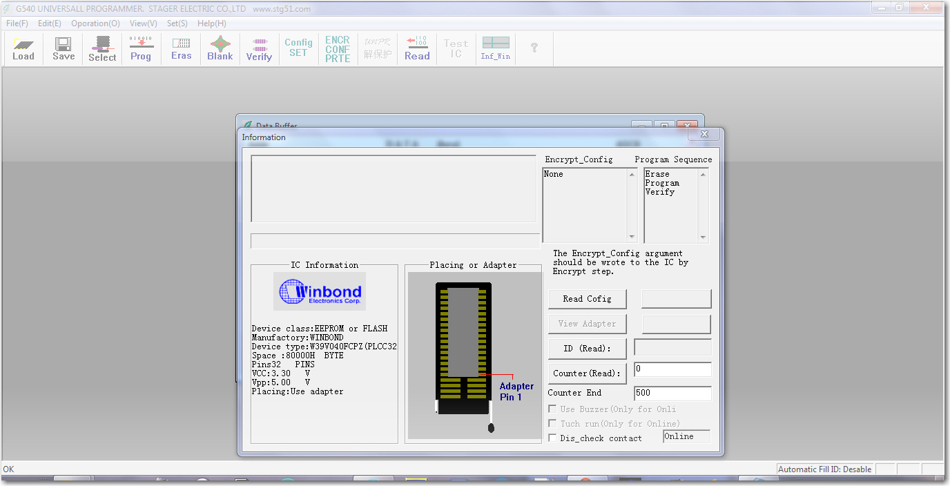

                    the chip :
                    W39V040FCPZ
                    • bianchi77
                      • Jun 2016
                      • 1121
                      Re: P5PE-VM question ?
                      Ready to burn but not sure if the file is right

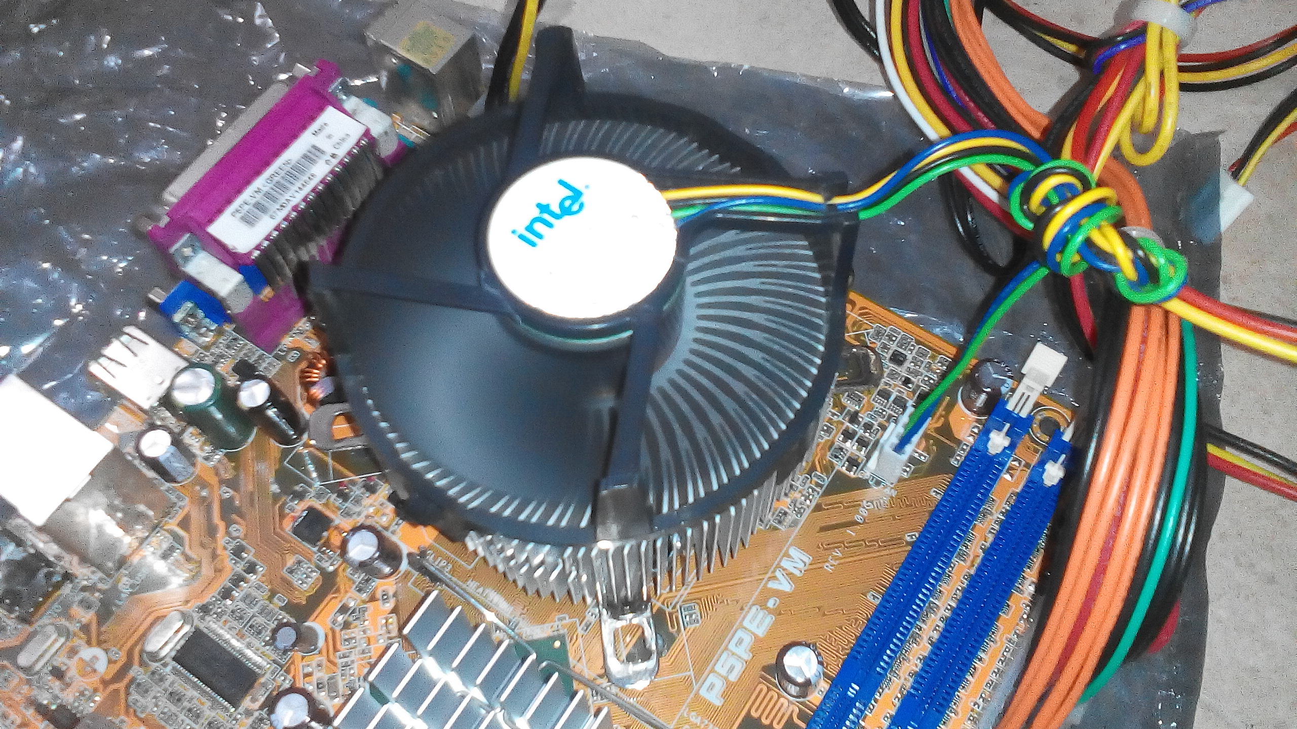

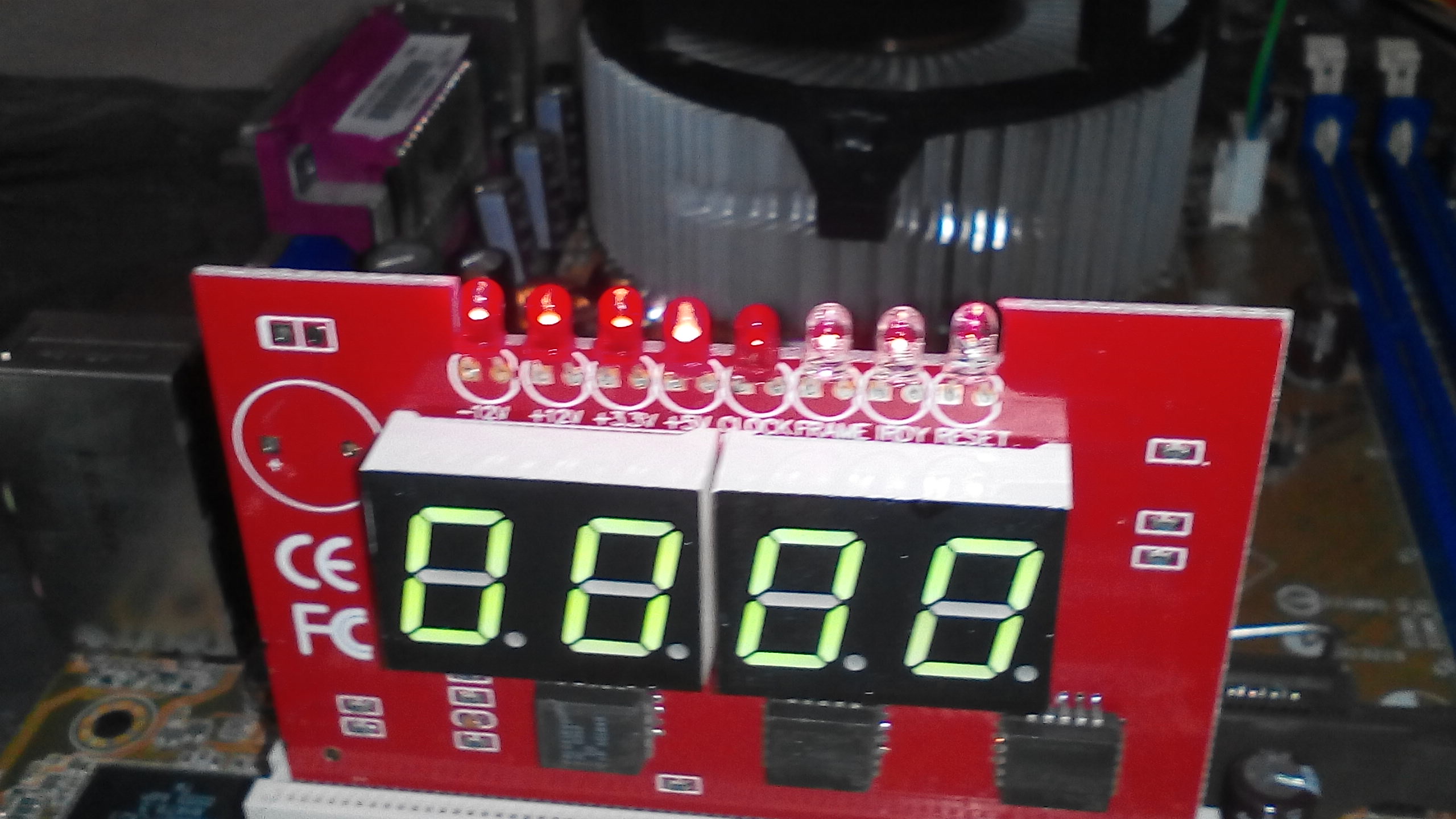

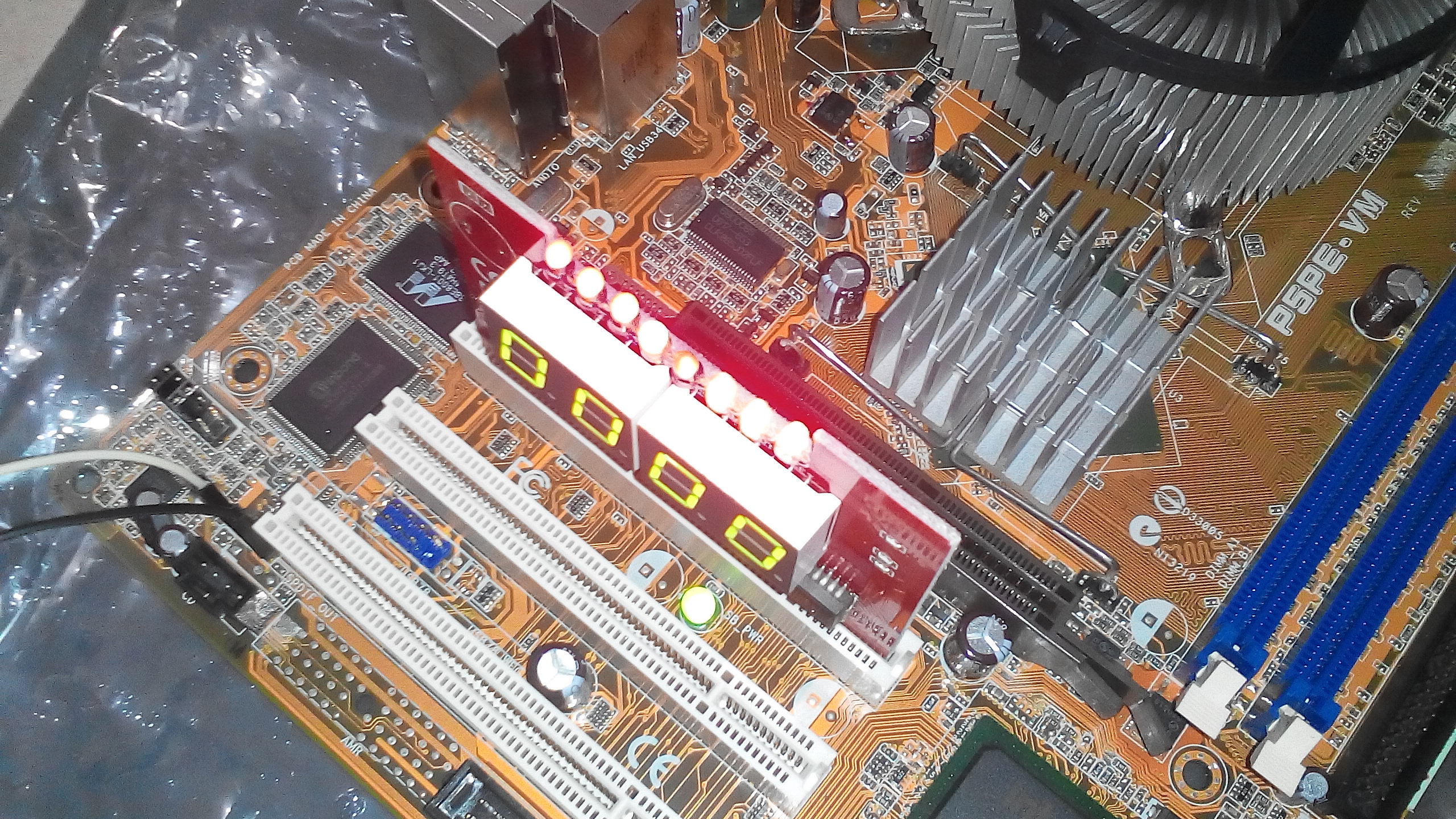

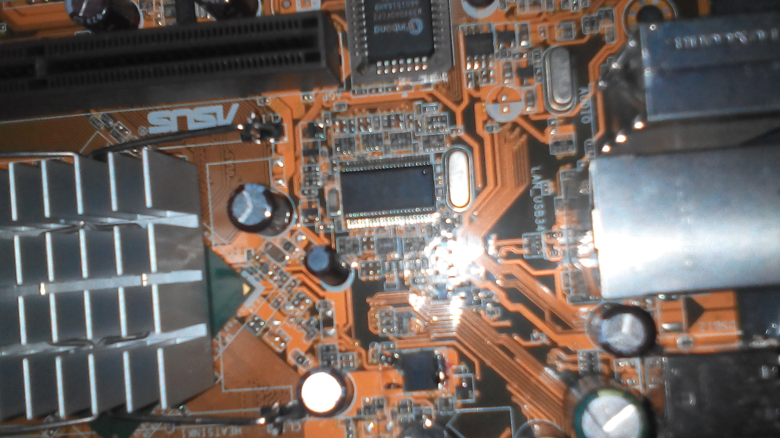

                                      Here are some photos....I can see CLK LED on POST diagnostic very dim....does it mean that this board has a CLK problem ?
