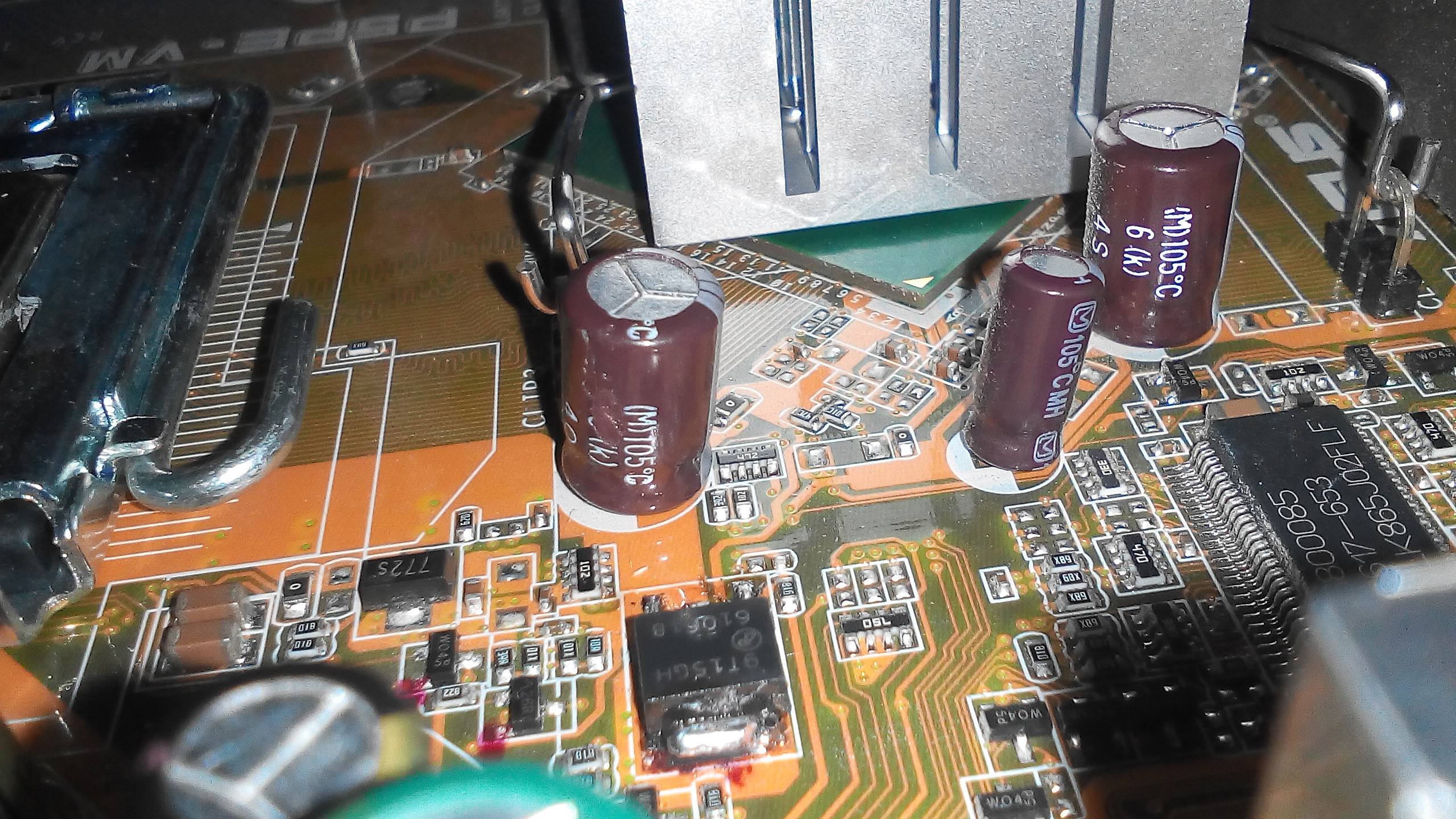

              I measured the voltage around CPU it's 1.37V for 3 pairs of FET...are they normal or one of them faulty ?
              The CPU is Celeron D 346 ...

                          3 FETs got 0.000V for diode test for DMM ?? faulty ? D - S test drain to negative probe , S to positive probe...in circuit test..

                            Do you think those tilting capacitors are bad ?

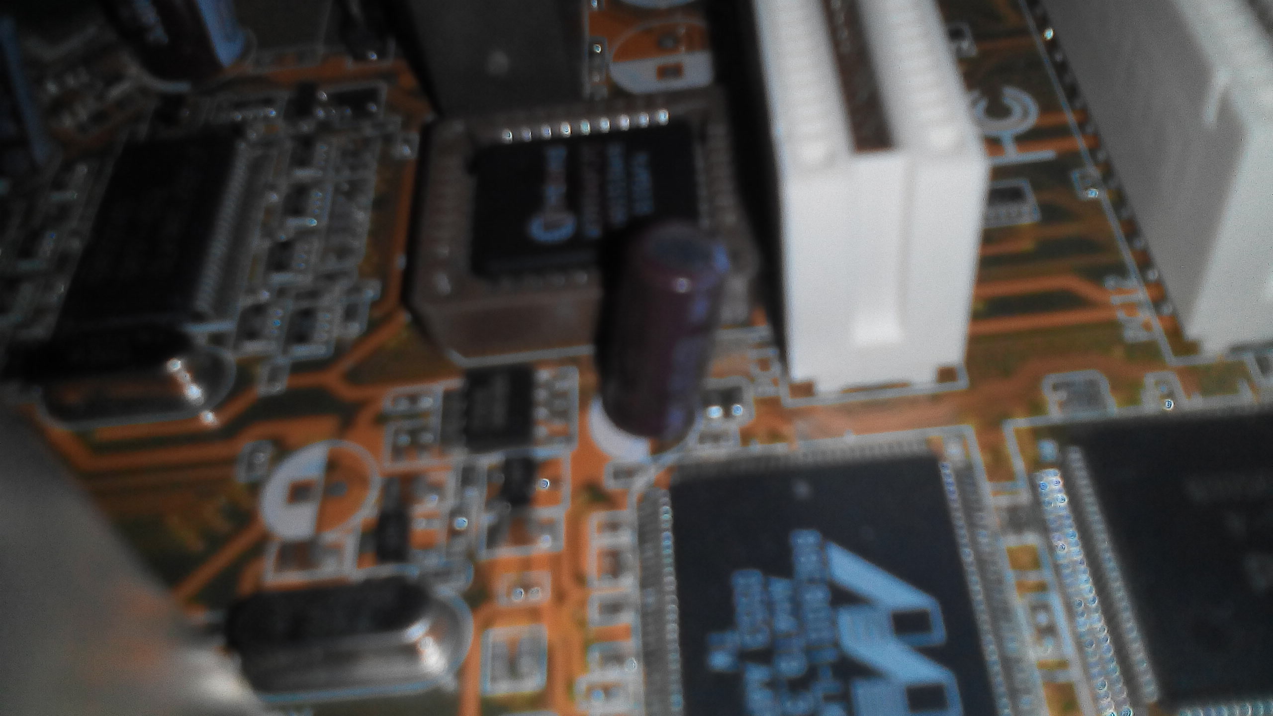

                              I'll check 32KHz crystal as well....may be it's faulty ?

                                It was long beep, short beep, short beep....time when I changed the crystal...but when I shut it off...it's showing 0000 again in POST diagnostic...
                                I tried pushing abit on southbridge chip and it's showing D3D3 on post diagnostic....
                                I guess I got bad join on southbridge...
                                Reflow do you reckon ?

                                    only one time working with new crystal, beep beep beep....I recycled the power....
                                    and it returned to 0000 again....
                                    and I can't see 32768 Hz on any pins of the crystal...is my crystal faulty again ?
                                    how can I test a crystal ?
