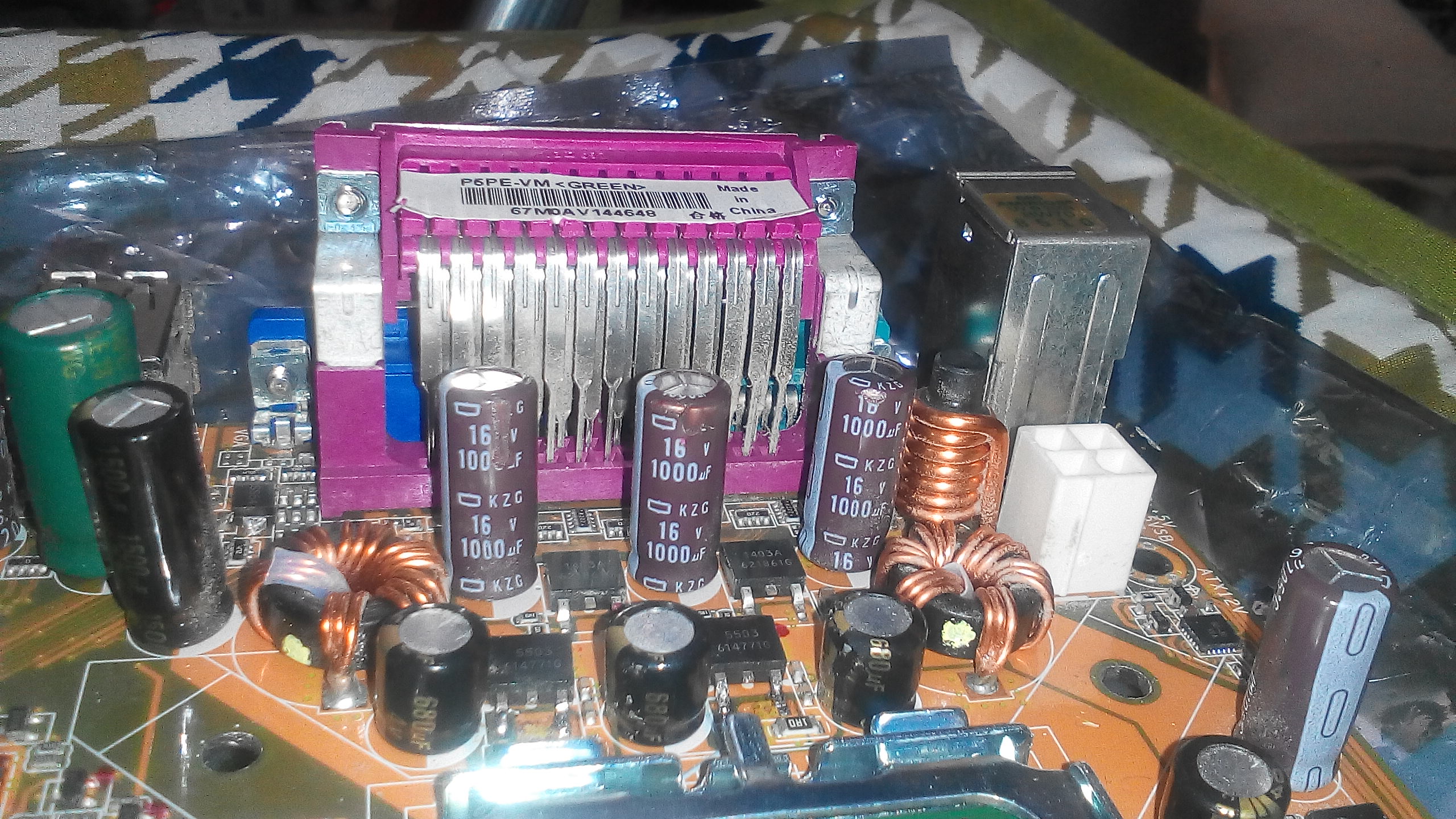

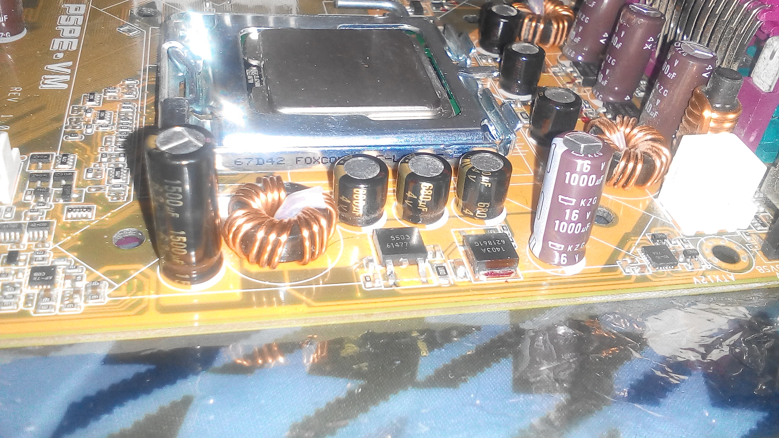

                Re: P5PE-VM question ?
                Are you talking about the capacitors on FET filter to Vcore ?
                • bianchi77
                  • Jun 2016
                  • 1121
                  #48
                  I can pull them out test and replace if needed...

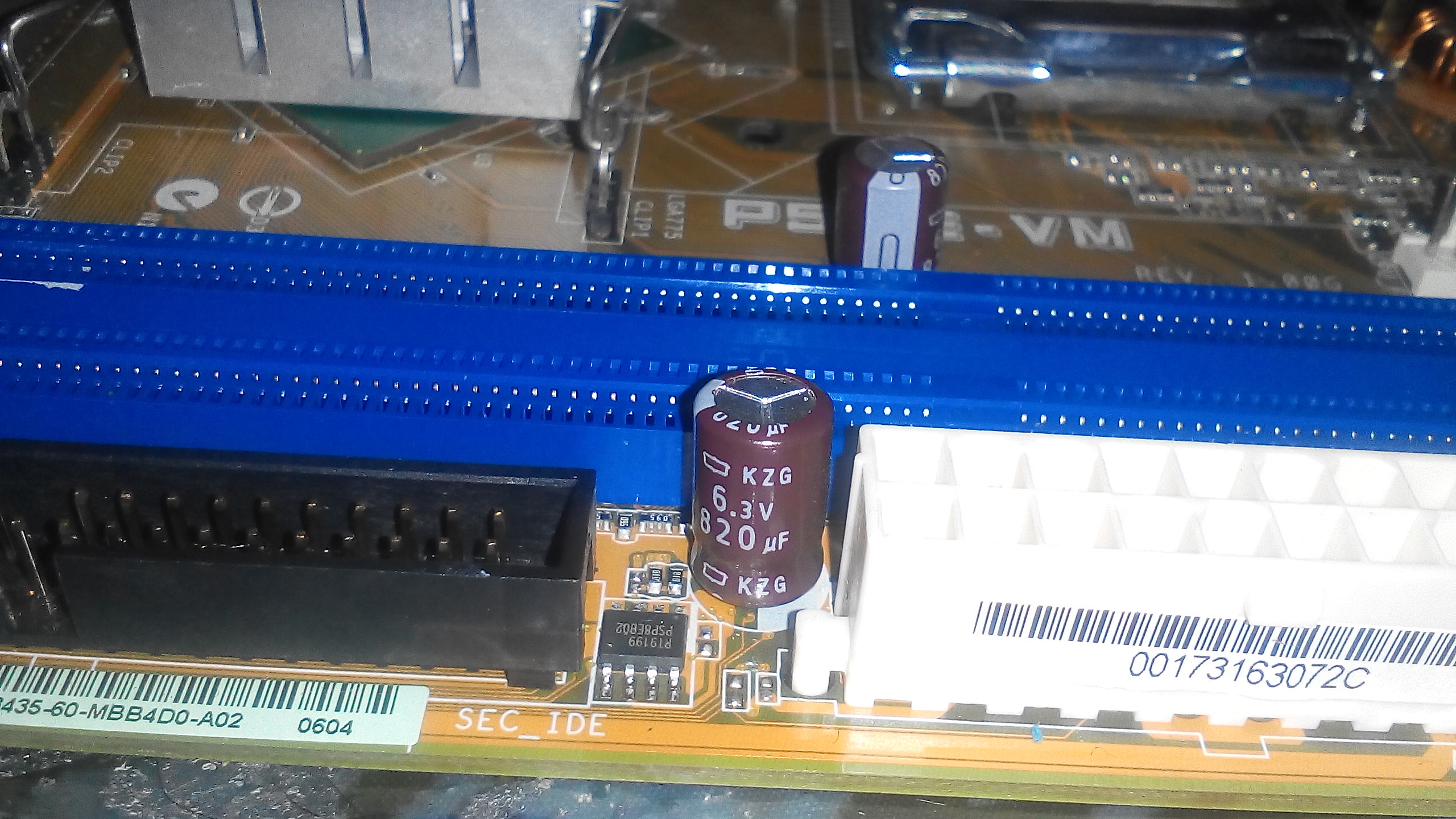

                  • RJARRRPCGP
                    • Jul 2004
                    • 6304
                    #49
                    Originally posted by bianchi77
                    It was long beep, short beep, short beep
                    That's an AMI BIOS RAM init failure code...

                        #51
                        are those KZG capacitors, you're talking about ?
                        Those are the ones! Almost always brown...

                            I've measured some of KZG caps you're talking about...
                            Measurement in circuit...they give me value...some of them 33K, some of them ..87K...
                            are they bad ones ?

                              #54
                              Are they most likely faulty ?
                              Well, I don't have X-ray vision so I can't give you a verdict from the comfy seat of my chair... but all I can tell you is that those Chemicon KZG capacitors do fail quite a bit, and sometimes without visual signs too.
                              I have a capacitance meter, it can read capacitance and impedance, but no ability for reading ESR...would it be good enough testing them ?
                              Impedance and ESR become close at relatively high frequeincies (around 100 KHz), so yes you can *probably* use the impedance on your meter. Speaking of which, what meter is it?
                              does it mean that I need to desolder them all ?
                              If you want to test them, YES.
                              In-circuit readings on motherboards are often inaccurate and/or total garbage. So remove the caps and test. Better yet, if you have good quality low-ESR replacements, just replace those KZG caps and at least be done with that part. Then you won't wonder if bad caps were the problem, at least.
                              Also, the black caps around the CPU appear to be Panasonic FL (4V 680 uF). Panasonic makes very good caps, but even these can go bad simply because of where they are placed - right under the CPU heatsink. If a hot-running CPU was used, they could be dried out. I recommend getting polymer caps for those positions.
