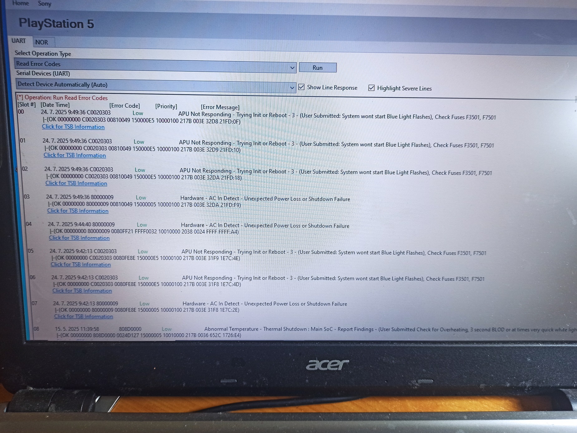

PS5 Slim - no video, butchered hdmi, after replace still no video, diagnostic said APU was overheating and now not responding
  • ktmmotocross
    Boardkiller
    • Feb 2014
    • 3613
    • slovakia
    Have this PS5 Slim with no video, HDMI connector was horribly butchered. but after replace i have no video. diagnostic said APU was overheating and now not responding,
    checked fuses and all are good
    any hint?
