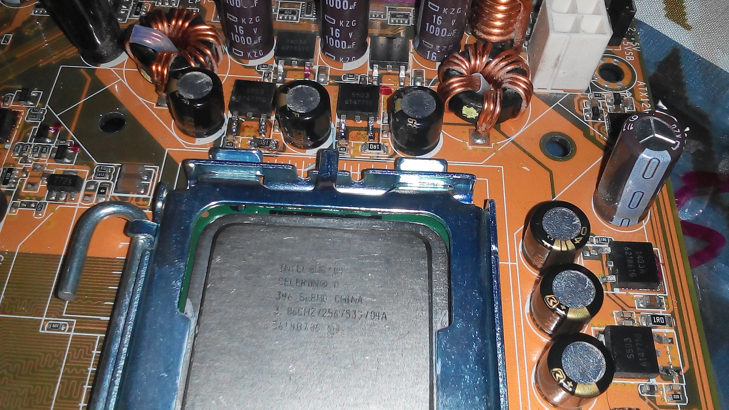

    always some cap(680 4v)have a problem(changing capacity) .it make effective to cpu CLK and u have not any code in debugger . other problems is as i said in past topic(disconnecting North bridge)

        I've taken out one of 1000uF / 16V on the Vcore area and the Z value is -189.8mOhm - j56.87 mOhm at 200KHz, and on DC the value is 1021 uF...

            #65
            Re: P5PE-VM question ?
            another question, if the caps are bad, how come I still get a good value Vcore voltage ?
            • bianchi77
              • Jun 2016
              • 1121
              #66
              I see what you mean...the small capacitors near CPU socket...the short ones...

                #67
                bad cap means : the cap is filter for Ac noise(come from power supply) and this noise mix with cpu CLK puls So motherboard dont boot.

                  #68
                  Originally posted by boyebaran
                  bad cap means : the cap is filter for Ac noise(come from power supply) and this noise mix with cpu CLK So motherboard dont boot.
                  sorry bad English.....you can hit a little (680micro)by hitter and see what happen.

                    #69
                    I can understand what you mean, that's ok for your english...
                    Yup bad caps will give a bad filtering and interfering CPU clock....make sense...
                    That's why I got no clock....I'll try with the caps I have for mobo...because currently I don't have this kind of caps on my hand....
                    I can do experiment with 1800uF/16V for mobo caps and see what's the response while I'm waiting for the proper caps coming after order..

                      #70
                      Those capacitors , please have a look on the photo, cheers
                      • bianchi77
                        • Jun 2016
                        • 1121
                        #71
                        I've changed all the 6 capacitors 820uF/4V with 1800uF/16V....still no response...0000...
                        I've tried push northbridge a little bit then turn on...no luck...
                        I reckon my clock generator chip is not working properly....no clock 0000....
