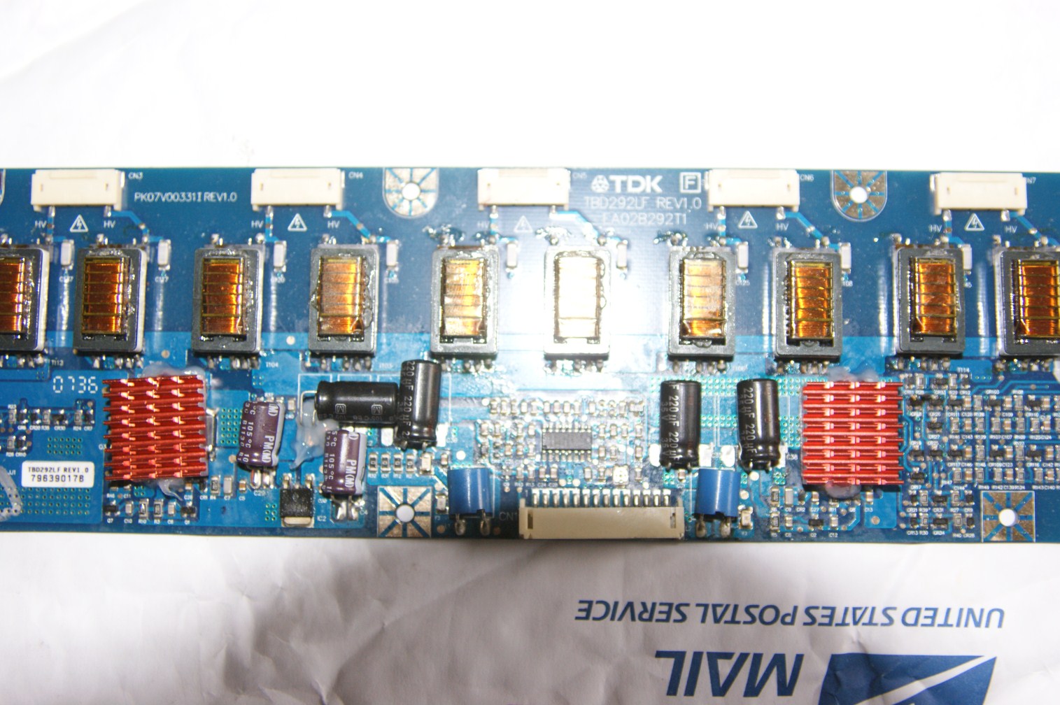

        Re: Acer AL2416 AL2416W 24" 1920x1280 LCD Monitor
        Reducing the number of caps and holding heatsinks on with hot melt glue?
        That looks anything but professional :O
            Hi all. Wow what a posting with these invertor boards...
            Here's my problem (I only came across this board - AFTER - where i am at now...
            Given the monitor "dark on the top left corner/side".
            I first decided to check connections all over checking for bad caps etc.
            When checking the resistance on the transformers invertor board i received a few good judder tingles!! and decided not test anymore with the power on
            I replaced all the caps on the driver board and got no picture. Usual Green power on, then to Orange, but no display.
            Replaced the caps on the invertor board and replaced the FETS with P550's and P280's (originals), Found fuse F2 gone (so have jumpered it with thin wire). F1 just gives a small 'beep' on the DMM speaker when set on continuity.
            Found the 4 rights side caps gone.
            When put back together, the screen fires up showing the XP desktop but flickers quickly and i hear a ticking/clicking (obviously in sync with the flicker), but i still have the dark top left corner/side.
            I don't mind getting a new invertor board off Ebay $40, if i have damaged the existing one. But i'm not sure if i have damaged something else, maybe when i received the jolts?
            I know jumping F2 is bad but if the screen worked ok, i would have replaced it of course.

                  I just wanted to thank everyone for posting their stories.
                  I saw smoke coming from the top left of my AL2416 a couple of days ago. The picture was fine for a few minutes, then the left side became dark and a buzzing noise could be heard.
                  After getting to the inverter board, I found
                  • One capacitor with bulged bottom
                  • All the neighbourg capacitors had their color changed to brownish
                  • At least one shorted FET (possibly another one as well)
                  • Single Blown fuse (same side as the shorted FET, close to the power connector)
                  I replaced all 10 capacitors and ordered the FETs & fuse. It wasn't clear if fuses needed to be 4A or 1.25A. Since many reported that 1.25A were working for them, and wanting to be on the safe side, this is what I will be trying.
                  After further reading, though, I found that these boards are now down to about $29 from Hong Kong on eBay. If changing all these parts don't work, I'll probably reverse the board (as suggested in a post) to see if I can see the left side light up ad possibly order a full replacement.
                  I'll try to post my findings when the repair is completed.
