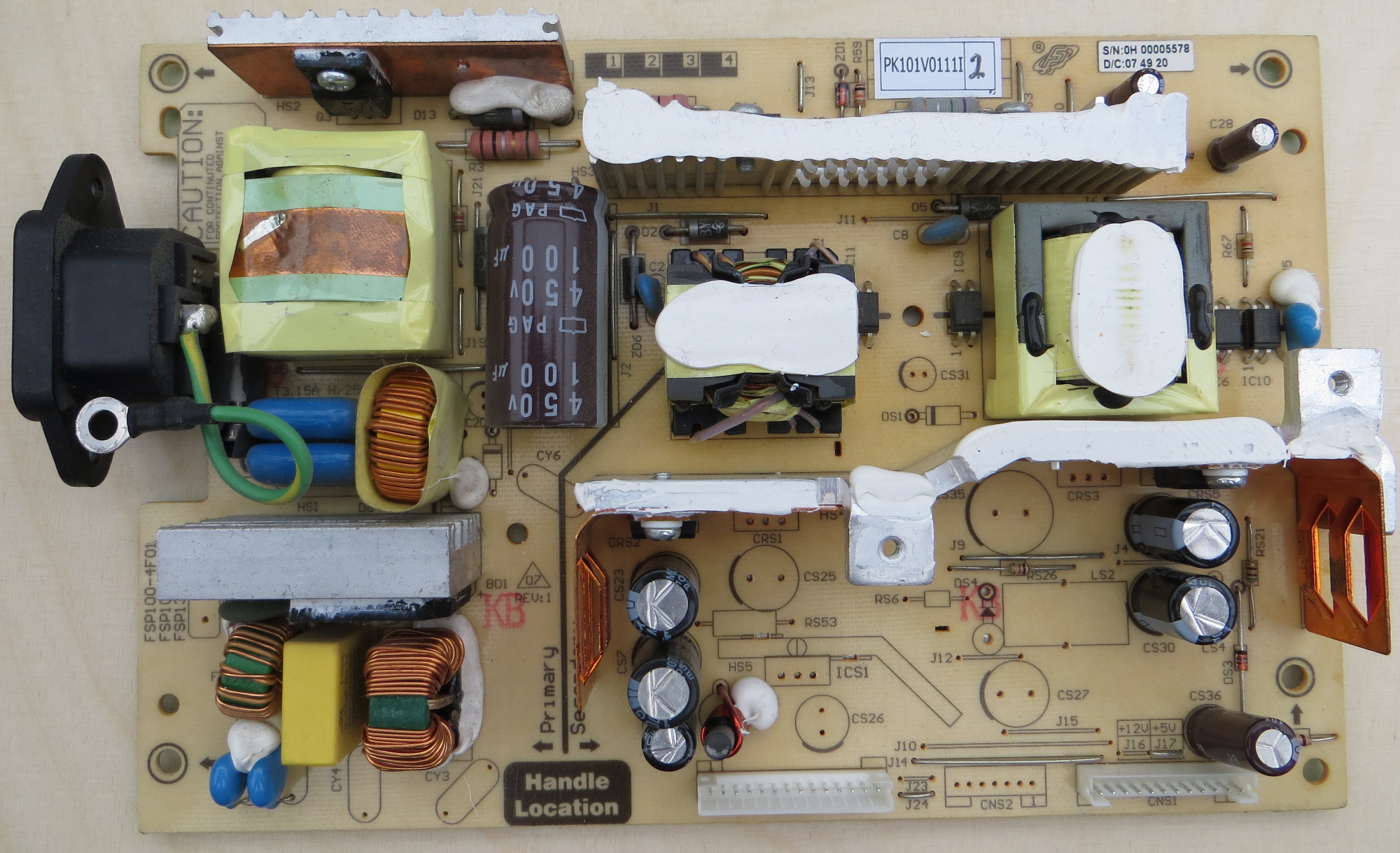

          #284
          Re: Acer AL2416 AL2416W 24" 1920x1280 LCD Monitor
          I was not sure if I should open a new thread or not, but I will try here.
          Two years ago I got this monitor working again (thanks to this thread) by replacing the 10 caps and a mosfet on the inverter board, but this time the symptoms are different.
          After running for a few hours it turned off and on again by itself, once. Now, if I connect the power cord, it turns on by itself, shows the logo for 2 seconds, then the logo highlights red or it shows a weird small menu item for a fraction of a second and the monitor turns off (no amber led light, no image under flashlight).
          As far as I can tell the mosfets on the inverter are not shorted and the fuses are fine.
          Testing the power board with everything disconnected I get the following:
          (post for reference: https://www.badcaps.net/forum/showpo...5&postcount=36)
          To inverter board:
          1 +24Vcc Inverter Vcc ====== 0V
          2 +24Vcc Inverter Vcc ====== 0V
          3 +24Vcc Inverter Vcc ====== 0V
          4 +24Vcc Inverter Vcc ====== 0V
          5 +24Vcc Inverter Vcc ======= 0V
          6 GND Inverter GND
          7 GND Inverter GND
          8 GND Inverter GND
          9 GND Inverter GND
          10 GND Inverter GND
          11 N.C N.C
          12 Backlight on/off ====== 1.8V
          13 Dimmer Brightness control ====== 0V
          14 N.C N.C
          To logic board:
          1 +5Vstb ======= 5.1V
          2 GND
          3 GND
          4 GND
          5 +5Vcc ======= 0.01V
          6 +5Vcc ======= 0.01V
          7 +5Vcc ======= 0V
          8 +12Vcc {audio power (n/a option)}
          9 GND
          10 Power on ======= 0V
          11 Backlight on/off ======= 2.1V
          12 Dimmer ======= 0V
          Since my cheap DMM only goes to 250V I can not test across the big cap. I`m at a loss at this point.
          Thank you.

                  #288
                  Ok, I think I misunderstood you the first time.
                  After it rested for a little over an hour I plugged everything in (the led turned on, no backlight, no picture, not able to turn it off) and measured again:
                  To inverter board:
                  1 +24Vcc Inverter Vcc ====== 23.8V
                  2 +24Vcc Inverter Vcc ====== 23.8V

                    #289
                    OK, the PS_ON is working because it does change state when monitor is turn on and off, but the BL_ON (Backlights on/off) is not working because it stays at 0V.
                    The BL_ON is generated by the main board, so that is where we have to look next.
                    Pictures of your main board?
