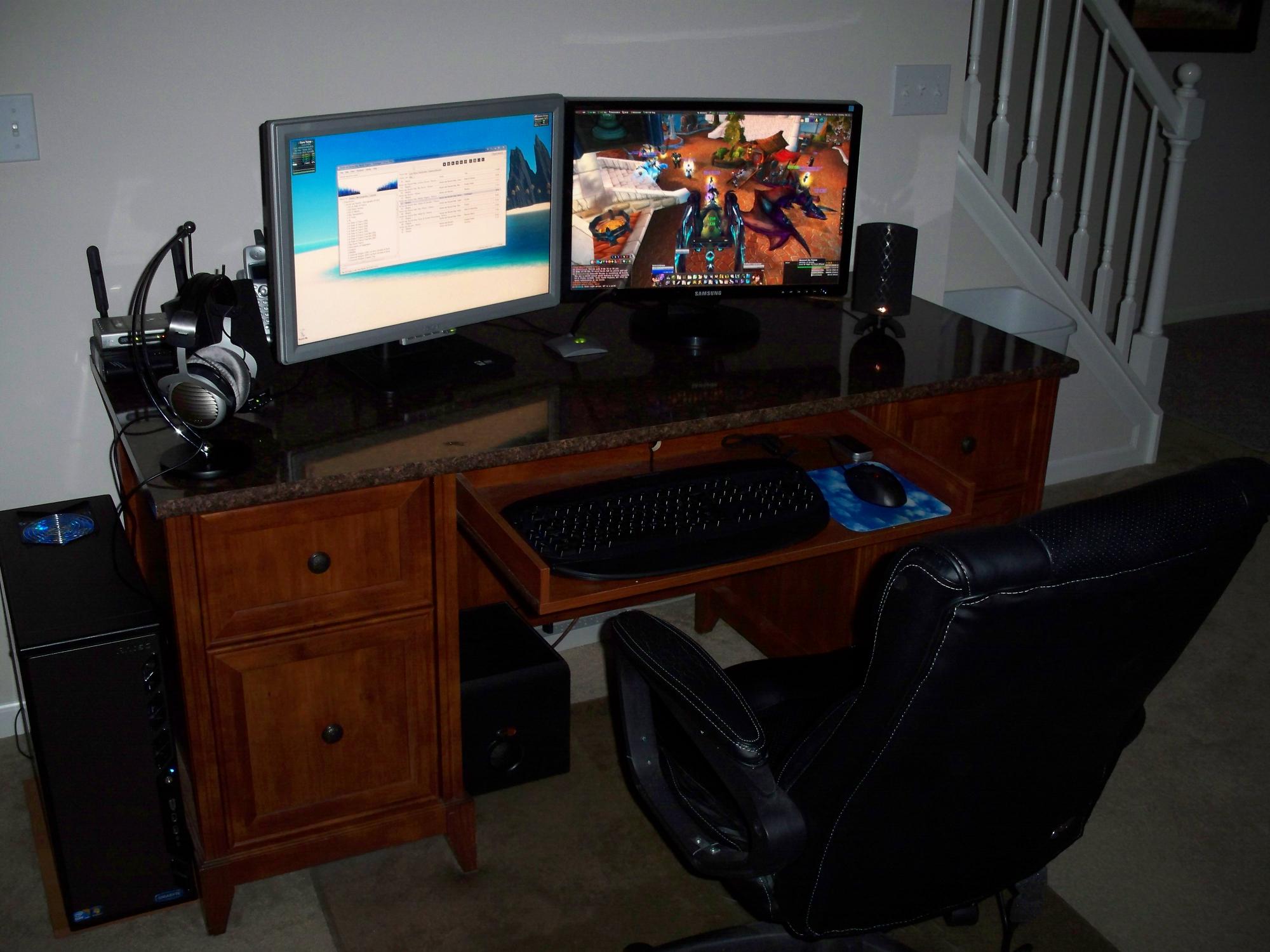

    Thought I would give an update, on March 16th I ordered 2x P5504EDG and 2x P2804BDG from a seller on ebay (Sisitronics).
    They arrived today, I replaced the 2 fets on the puffed cap side first, leaving the original ones on the upper portion of the board,
    and IT WORKS!! here's a pic, I'm hanging onto the other 2 replacements I ordered just incase.
    My worklog.
    1)Replaced 10x stock caps with 10x Low-ESR Caps.
    2)Replaced All 3 fuses.
    3)Replaced the 2 fets on the bottom half of the pcb(area with commonly burst caps)
    4)Functionality!
    (Repaired AL24216 on the left, Samsung 245bw on the right)

      That's disgraceful!!! A clean desk???
      Congratulations on your success.

        I'm OCD about my desk, CLEAN is goooooooood Thanks to this post for all the help, would have been lost without you guys.

          Good job! Seems like the caps and mosfets are a common problem on those TDK inverters.
