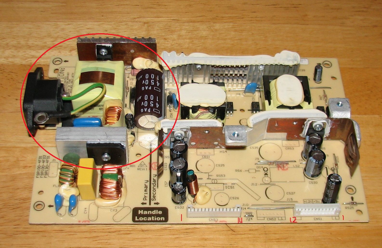

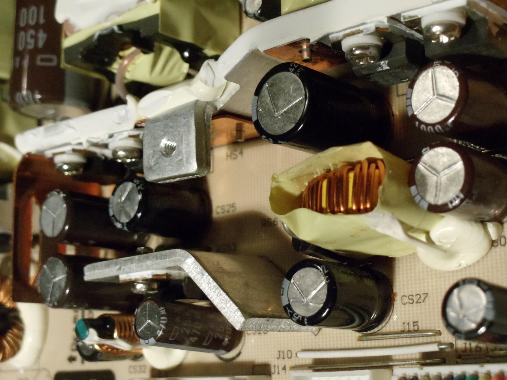

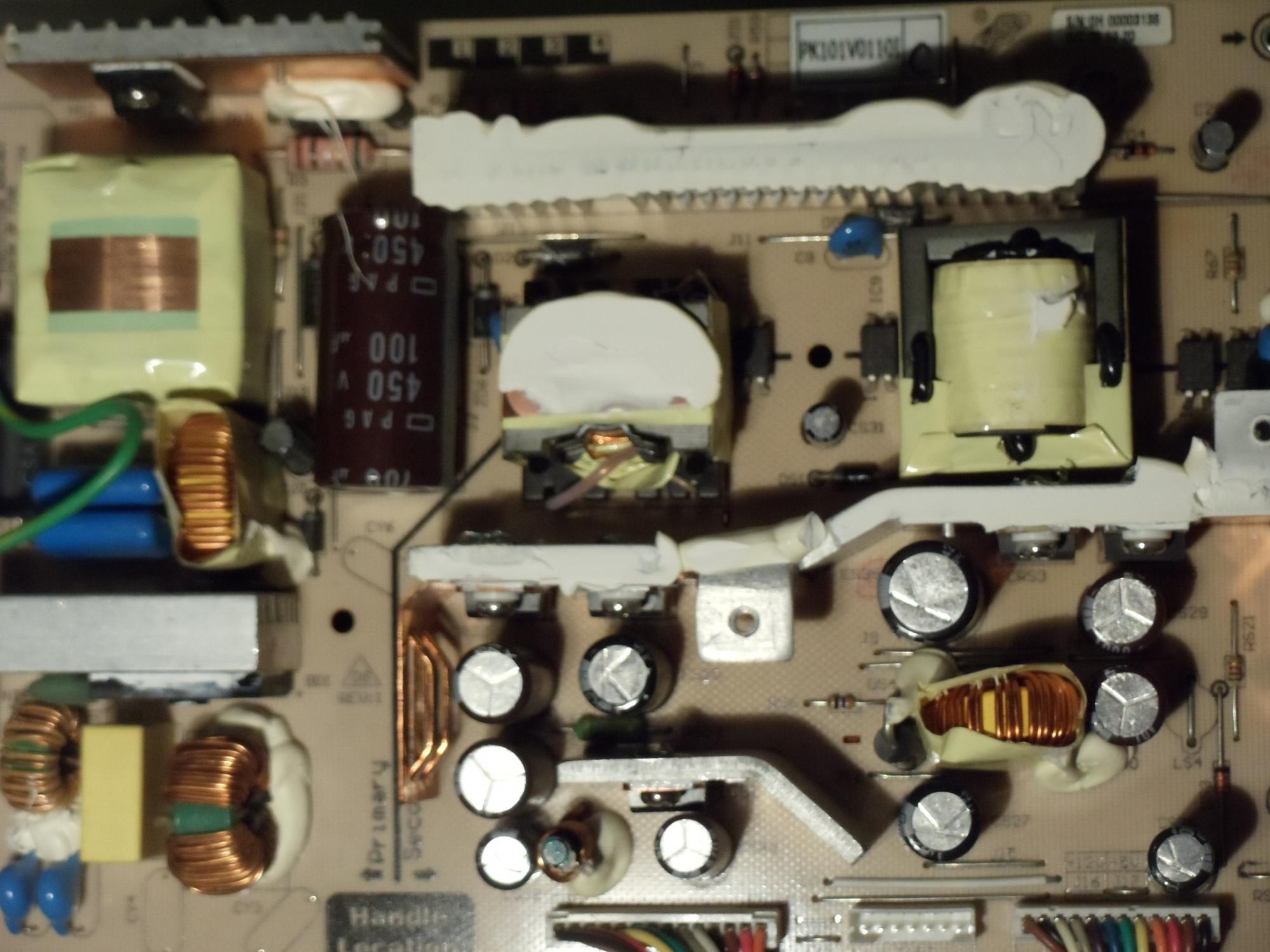

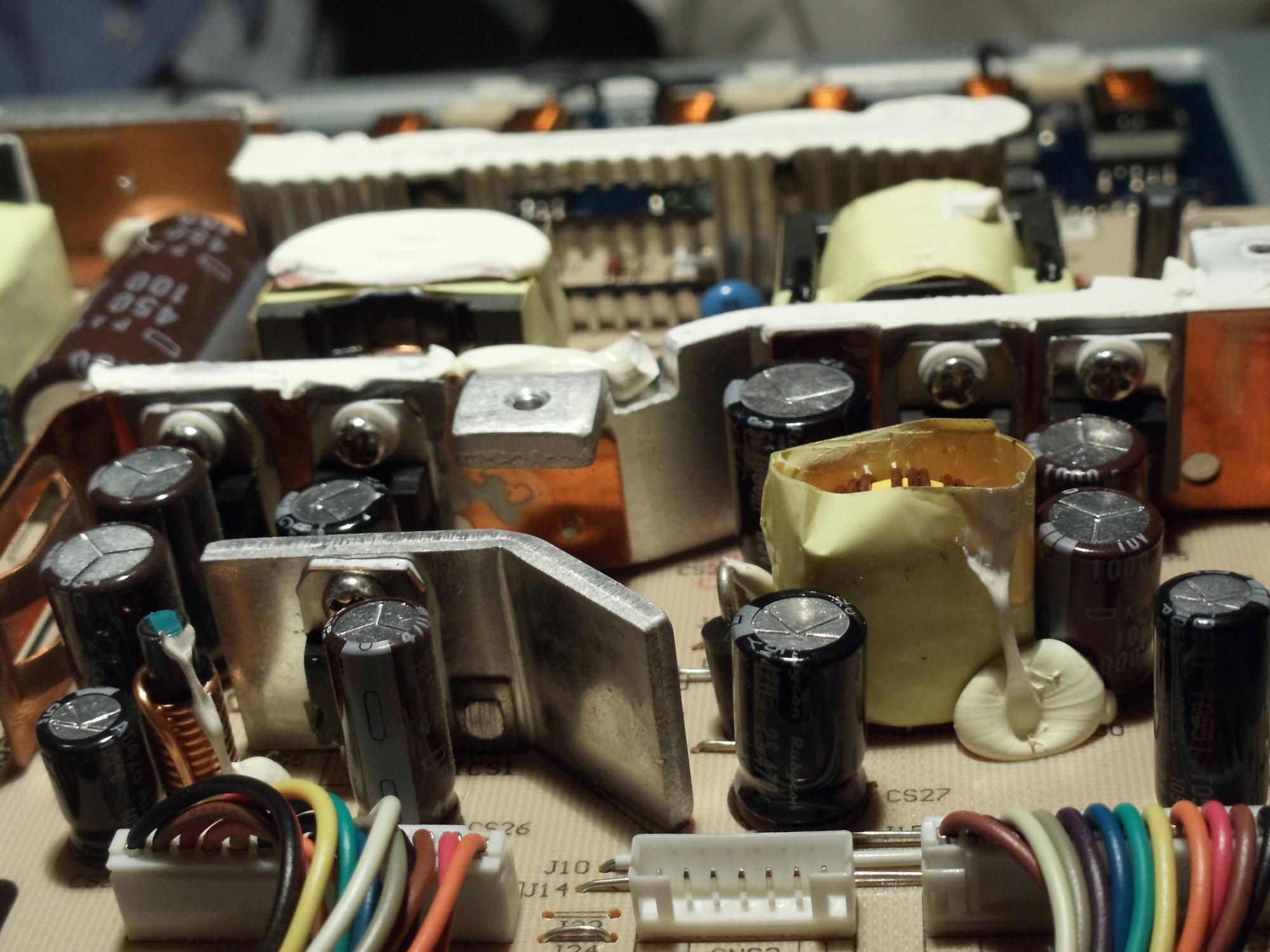

    Yes, that cap does look scorched. Opened it in pic program and brightened it up.
    Although the scorched cap would indicate another problem, the main course of action with these is to replace the 10 inverter board caps first. They are/can be non-bloat fails. With luck, they didn't take out the FETs.
    Don't get any fancier than the originals, spec wise. In other words, if PW or FC are close, use them. Don't go to an FM or KZE quality just because they are better specs. You'll may end up with the same problem or creating a new one. That chip seems to be -very- picky (sensitive). I'd like to find a way to "fool" it long enough to get good readings.
    Toast

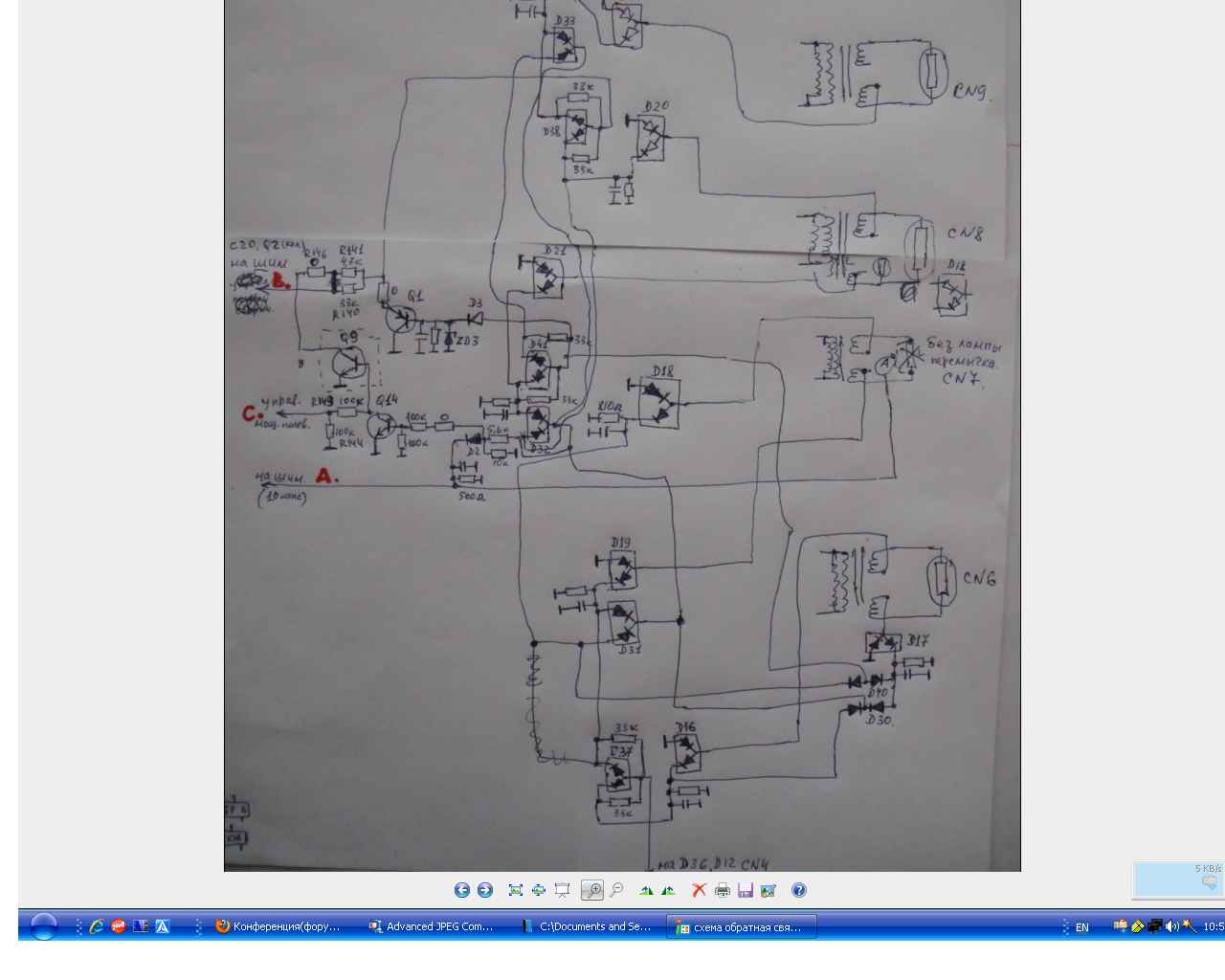

            Ah-ha. From other threads, OZ9925GN.
            I've requested datasheet from 02 Micro.
            Someone is selling them on eBay. I've asked them if they have a sheet.
            Found attached hand drawn circuit diagrams (not the same monitor) from a Russian site. Diagram of chip and circuitry around it.
            Also found an old catalog with this chip in it. Extracted the page and posted it here as a single PDF.

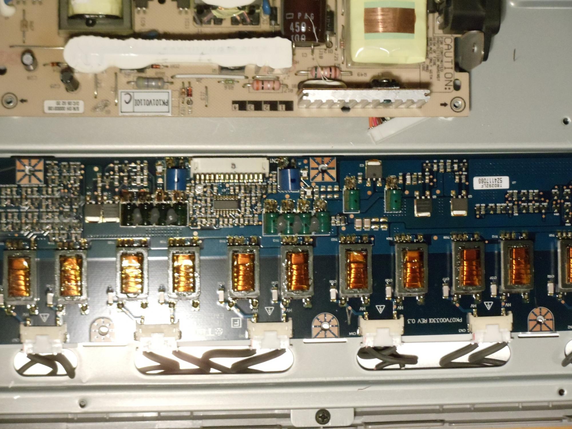

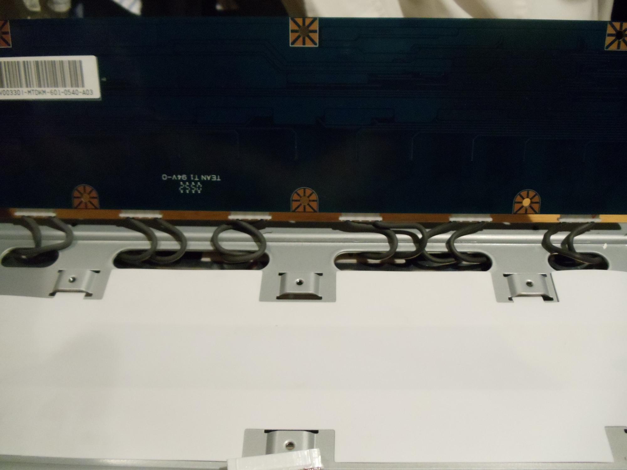

              I have checked all CCFL's one by one. The flash was about same intensity on all of them.
              Today I went to MarVac store (radio parts) and they found me some caps for inverter. I have replaced all of them, and nothing had changed.
              Monitor turns on, shows Logo for a second, and nothing on screen. Power LED remains green.
              Kids went to bed, so it was silent in the room and as I was turning it on and off I have noticed something.
              When I press power button there comes little buzzing sound from red circled area at the same time lamps are turning on. After a second I can here the click from the same area and lamps are turned off.
              Can it be the case, and not the inverter itself?

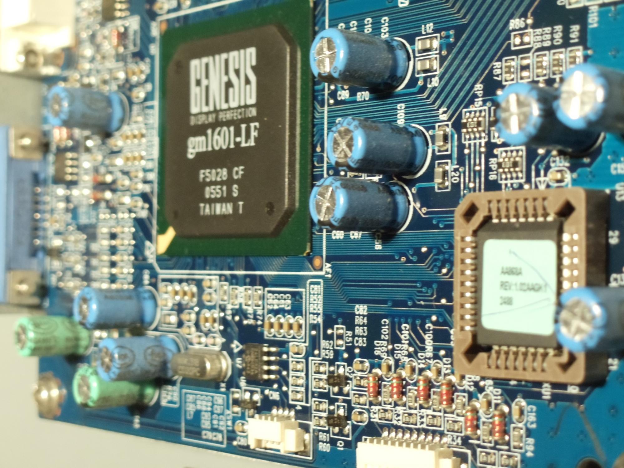

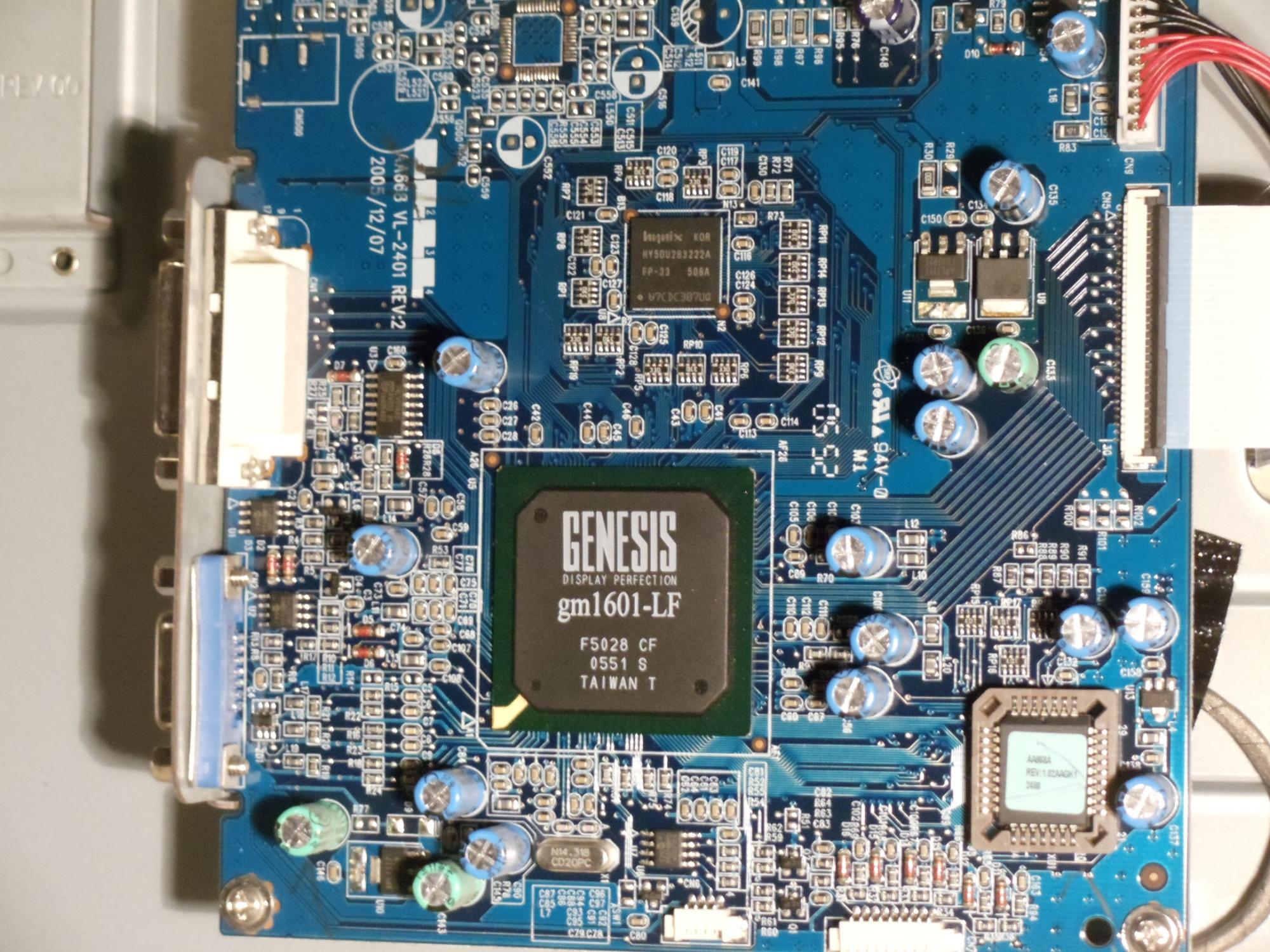

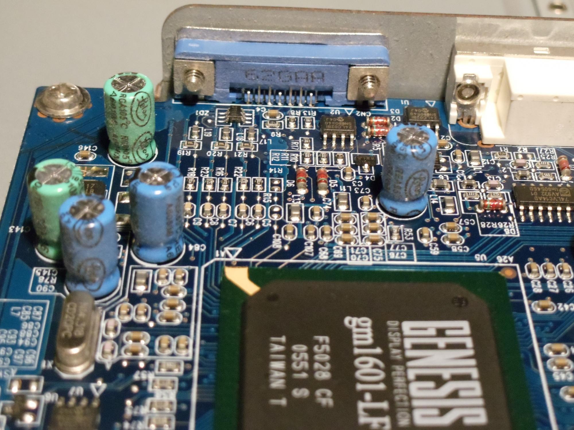

                  Sorry, I forgot to attach some pictures of the video board. Here you are:

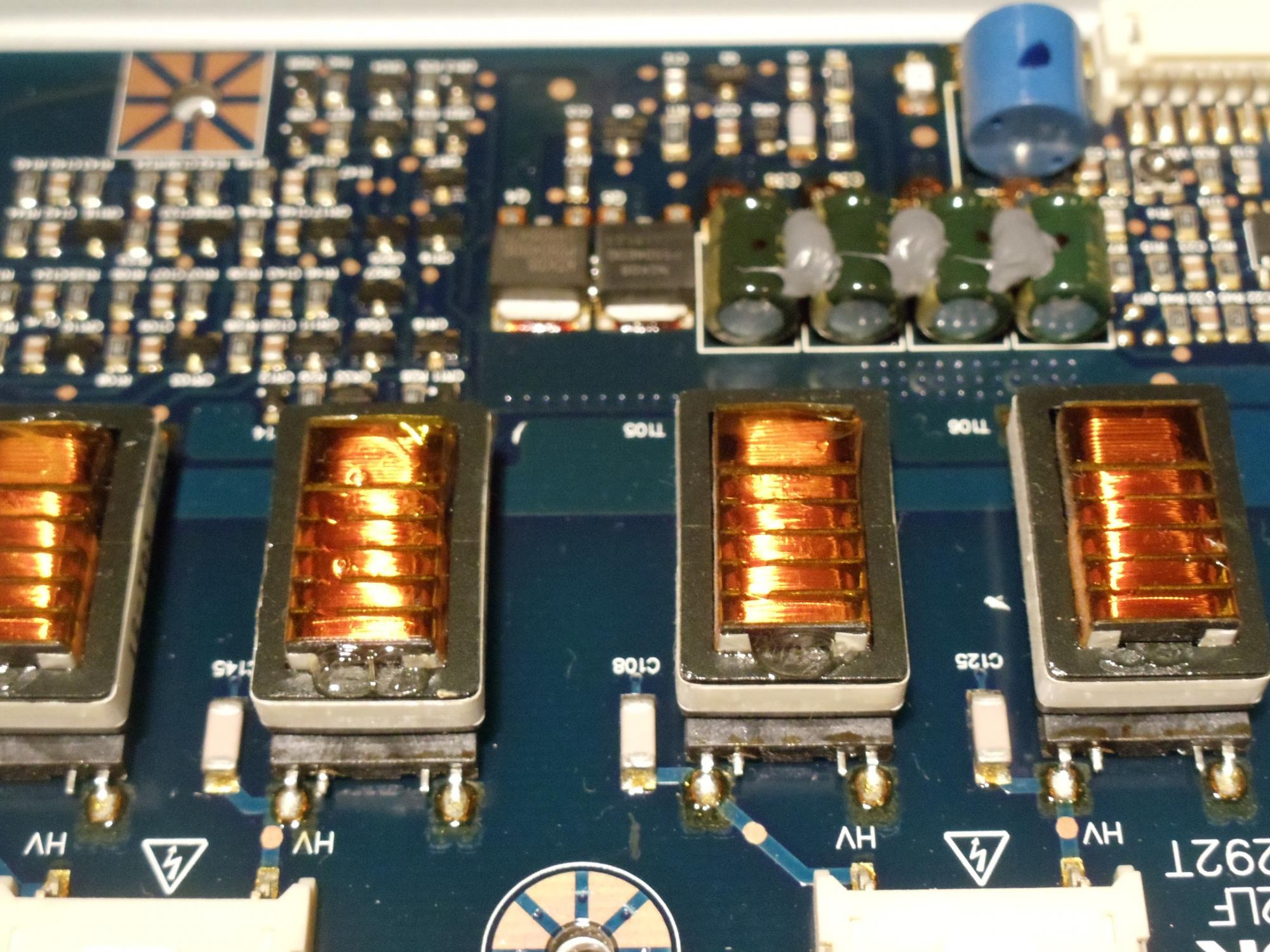

                        Re: Acer AL2416 AL2416W 24" 1920x1280 LCD Monitor
                        Originally posted by hernan_perez_br
                        Sorry for the photos, do you want me to delete them?.
                        Too late now. You can't edit the thread after 30 minutes after posting.
                        When I switch on the monitor, it shows the "acer" logo only for a second or half a second, and then the screen is black but
                        the power led is always Green, never amber.
                        The possible causes of "2 seconds to black" are in no particular order
                        1) bad caps
                        2) bad inverter transformers
                        3) bad ccfl
                        4) bad ccfl wiring
                        5) something wrong in the inverter sense circuitry
                        Causes 1 - 4 are all discussed in this very thread and the other AL2416 thread.
                        If you have a multimeter, you can rule out #2 by measuring the inverter transformers (see post #99).
                        For #1, as recent posts suggest, some have had success changing out the caps on the inverter board (10 of them) with high quality low ESR brands like Panasonic FM.

                              One set of caps on the inverter board is darker than the other set. They started the same color. Heat degrades the plastic and changes the color. Heat also degrades the insides. There's no vent on the top so look for the bungs to be pushed out.

                                severach's observation is why we always ask for pictures of your particular board. When people post "my board is identical to so and so", I just starting rolling my eyes.
