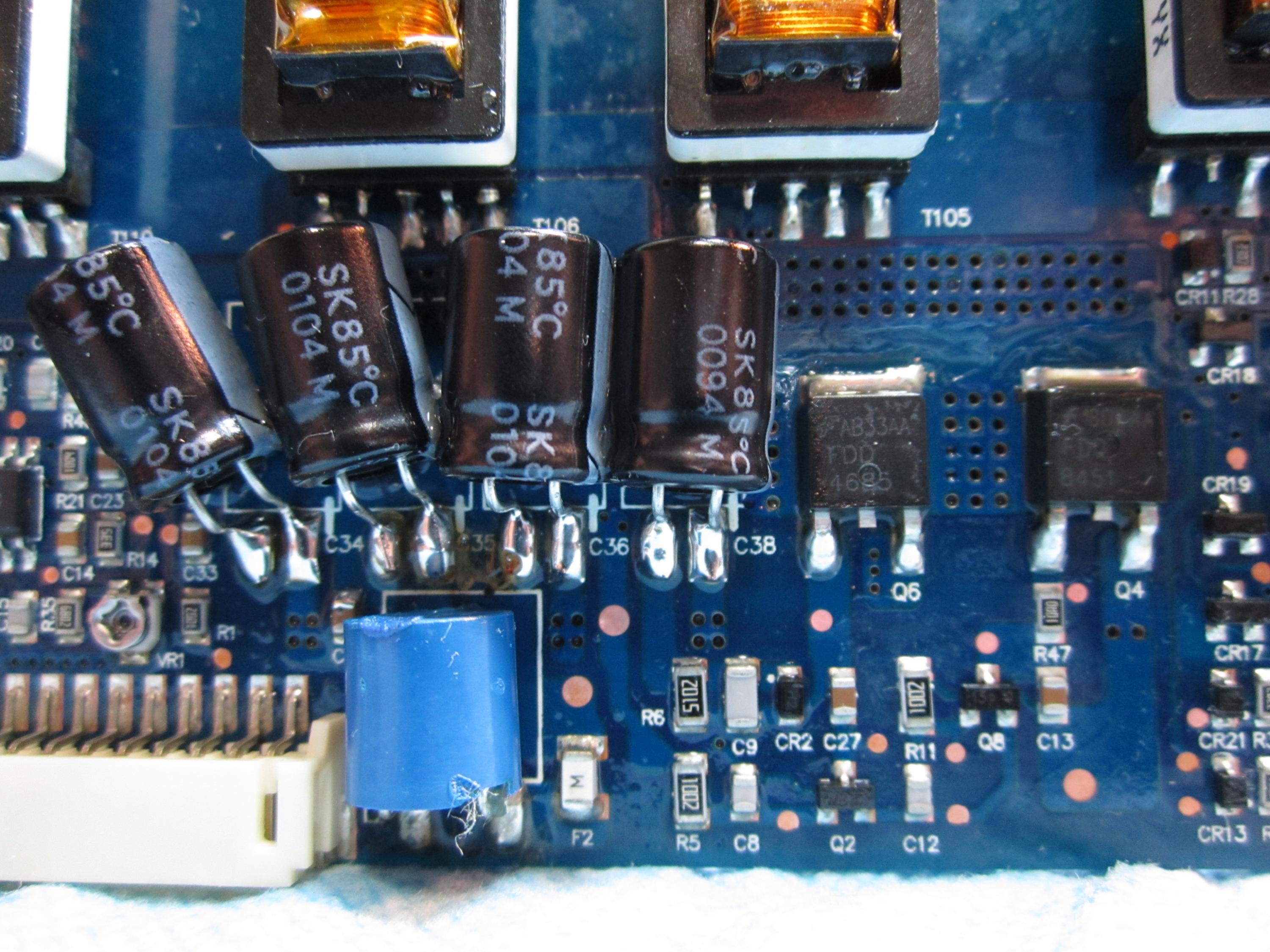

    That was very valuable information there. I think budm is onto the problem. I checked the caps you used and they are not low esr. You HAVE to use low esr caps in these units. That would explain why it worked, then shut down every 15 minutes. And after you replaced the 4 FETS. 2 1/2 hours.
    The inferior caps possibly took out at least 1 of the FETS, and possibly a fuse is blown.
    This is the way I would proceed with this repair....
    1. Replace those caps with the high esr caps you have on order.
    2. Now move on to testing the "M" smd fuses (should be 3 white ones)
    3. Also test the (2) FDD4685 and the (2) FDD8451
    Until that section is solid, there's no chance that it will work.
    And yes, we REALLY could use those pictures of the inverter board.
    Good luck! ~L-J-7~

      Ok,
      here are my pics. Do the caps have to be 105C, or can I get away with the 85C caps that were sent to me?
      In any case, I was not successful. I am getting the same result. Blank screen...
      No logo even this time.
      If I don't get new displays, I will try and get another inverter.

            Nice pics. Excellent soldering by the way. Once I fixed that inverter board and used substitute FETS that I thought were equal to the originals. The monitor lasted 2 weeks. If the fuses are good, I'm suspecting the high esr caps may have blown one of the fets. You need to test those 4 FETS. I'm going to bow out and let the diagnostic pros, budm and retiredcaps guide you with any diagnostics. Check what budm said. And also check those 4 FETS. Since it worked and then burned out after 2 1/2 hours. I'm suspecting the problem is in the area of the repair. Also check all the plugin connections to make sure they are connected solid. We'll get there ~L-J-7~

              LJ7 Thank you for the compliment on the photos and soldering. I'm a bit rusty in my 40's.
              I have more FETs, I can pull them off and try again.
              First how should I test the FETs? Am I looking for a value rating or continuity?

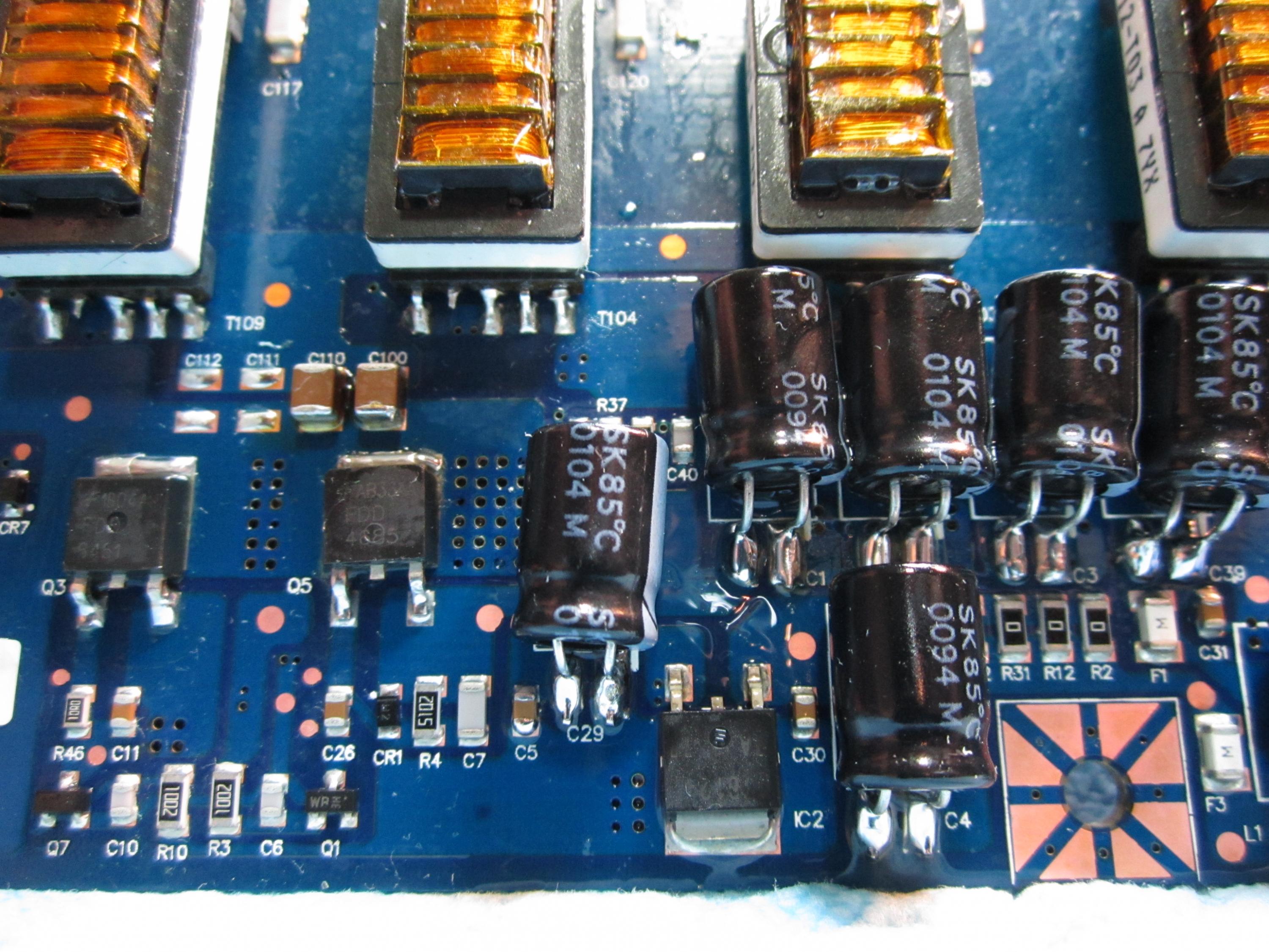

                                    Thanks everyone that contributed to this thread. I wanted to share my story here.
                                    After being purchased from Costco, my AL2416 had been used as my every day work monitor for several years, along with another 24" Dell.
                                    The problems started with fume coming from the upper left corner of the monitor, and shortly after the left side was completely dim.
                                    Measurements on the board revealed a shorted Q6, a blown F2 fuse and bulged C36, C38 caps.
                                    I replaced all capacitors as well as
                                    Fuse F2 (replaced with marking J)
                                    Q4 P2804BDG
                                    Q6 faulty P5504EDG
                                    Q3 P2804BDG
                                    Q5 P5504EDG
                                    And a quick test shows the monitor is back to life. I will now have it turned on for a little while to see if it will hold well.
                                    Otherwise, I saw some inverter board on eBay for $29 shipping included so I might just order one.

                                      sle118, I would replace ALL those caps (they are connected in parallel) on the inverter board.

                                        Thanks for the advice, but as stated in my post, ALL of these caps WERE changed. The pictures show the board before the repair.
                                          #260
                                          Re: Acer AL2416 AL2416W 24" 1920x1280 LCD Monitor
                                          Ok, I see, I just went by the pictures.
