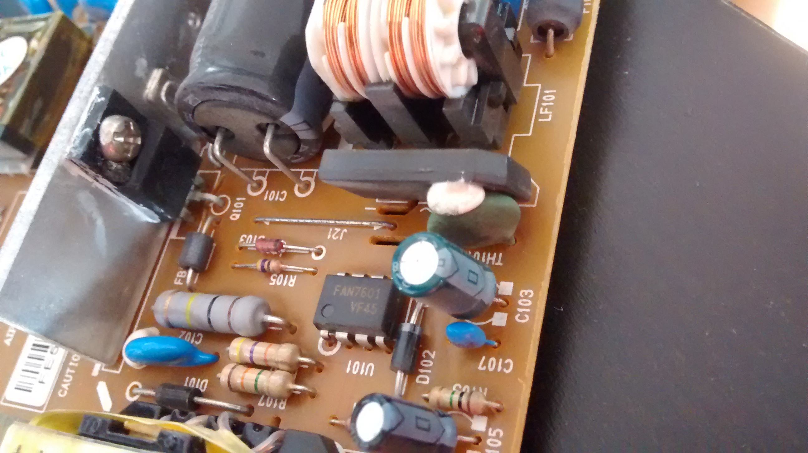

                                  Hi there, i also have a 1717s which is dead. when i plug it in, the green led shows up for a fraction of second, then dies. I read what you guys did on this forum and i managed to diassembly the thingie. Now thing is, im looking on the power supply and 2 components are foamy. one says c102 and the other is a th101 i guess. I am new in this and have no skills, i would like to know what would the replacements be, and where would i buy them in romania. I can solder, i did it before. Thank you, i feel like im blind and trying to put a nail into a wall. (i guess its kinda like that).

                                    Can you post pictures of your boards - a close up of C102 so we can establish what "foamy" means.

                                      Sadly no, i do not have a multimeter, i just moved in a new rent place. Also by foamy i mean leaked i guess. I did manage to take pics of the board, the c102 and another leaked one which says th101. i also took a pic of the whole board. im attaching them. Thx for your reply !
                                        Re: LG L1717 Monitor cap failure
                                        There is good news and bad news.
                                        Good news is "foamy" means nothing it is just glue to hold the parts in place.
                                        Bad news is there are very very few tests we can do without a multimeter.
