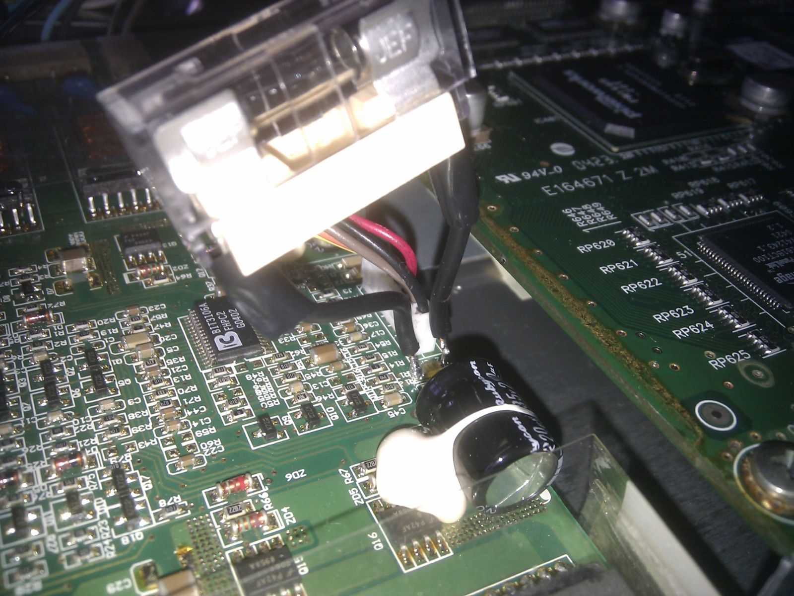

                      Just wanted to thank you all on this thread for your assistance diagnosing & fixing my problem.
                      My display cut out suddenly one evening - green LED, but no display. If I was lucky, on power on I'd get a slight flicker in the display.
                      I followed the service manual instructions for this, leading to an inverter failure diagnosis.
                      Testing inverter fuses, I found one had blown, which I replaced with a glass fuse and holder from Maplin (UK electronics store):
                      10x 20mm 2A Quick Blow glass fuses: GG26D
                      1x PCB fuse holder with cover: KU29G
                      Attached photo is of new fuse holder & fuse. At this point, I had progress; I'd get a display for about 1s on power on, then the display would cut out as before.
                      Though they looked absolutely fine, I replaced both 220uF capacitors on the inverter board, again with kit from Maplin:
                      2x 220uF 35V 105C radial capacitors: N86KF
                      The solder holding the old caps onto the board wouldn't melt with my 40W iron, so I clipped off the old caps and joined the new cap leads onto the old cap leads (and thus the PCB). No photos of this I'm afraid.
                      This fixed it - happy days.
                      All in all, about £5 to fix a £600 monitor. Thanks again.

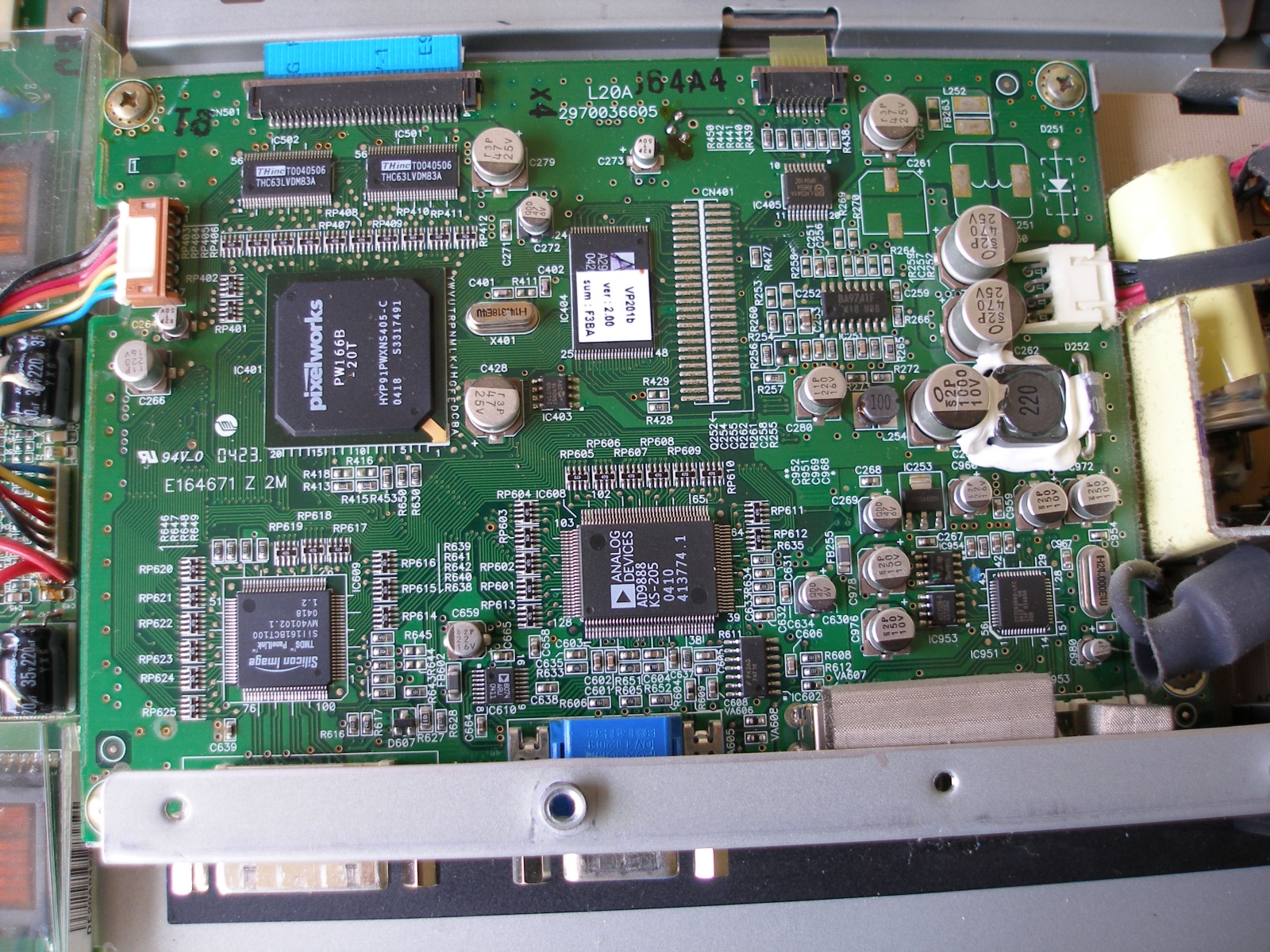

                        Four years since I visited this thread. I'm glad it's still here because I still have the VP201b but it has developed a problem. It flickers for 10 minutes before the lighting becomes even and even then it is prone to start flickering again at intervals.
                        I've taken some pictures of the innards and based on what I have read in this thread I have a notion what the problem is, but would like confirmation.

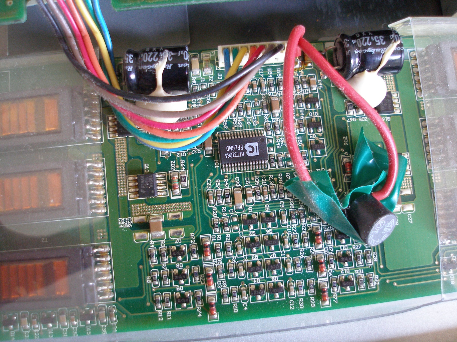

                        First, the inverter board:
                        The pic doesn't show the cap ends but they are flat [the monstrosity on red wires is a DIY fuse].
                        The centre board:
                        I can't see anything wrong there.

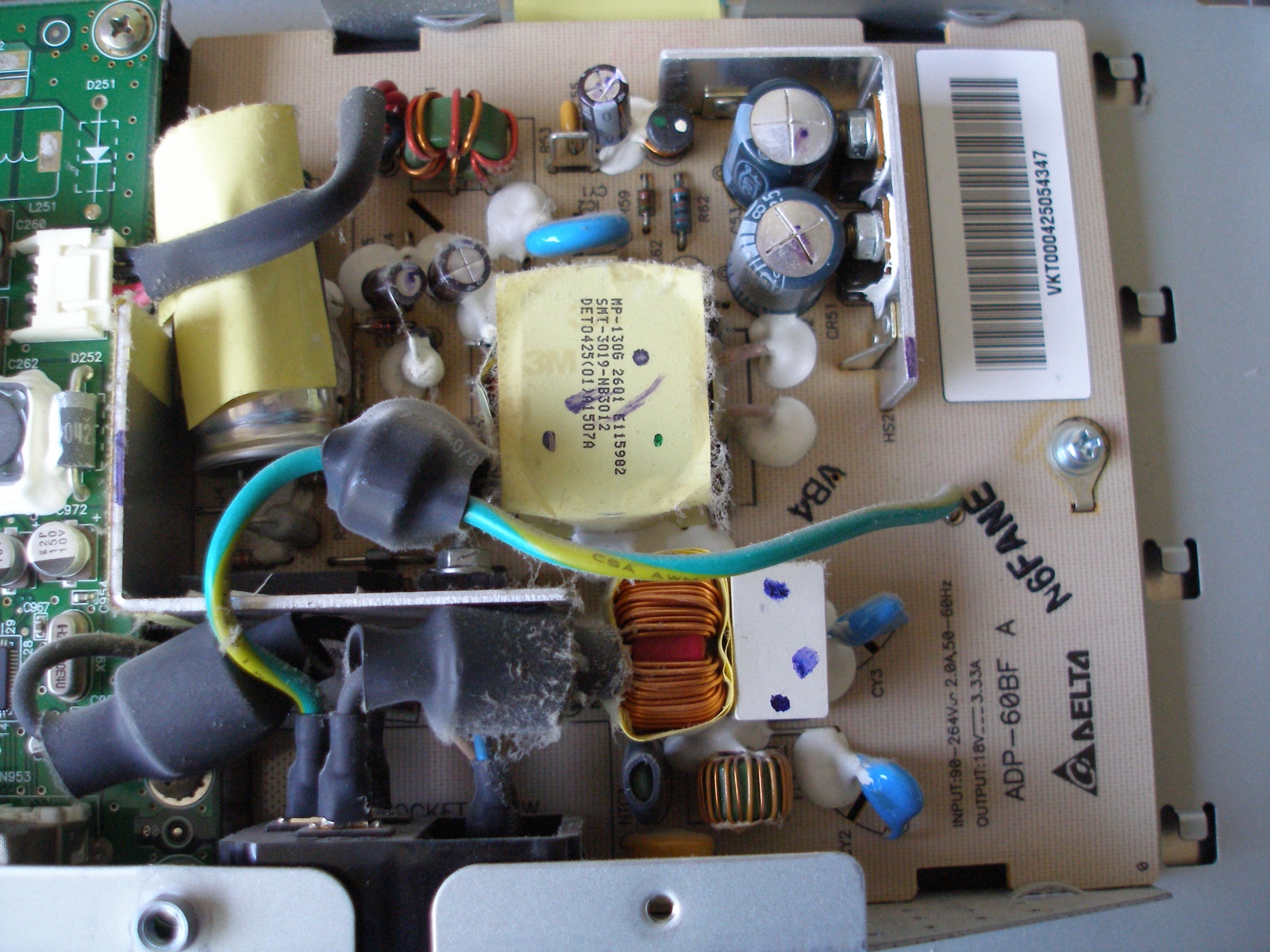

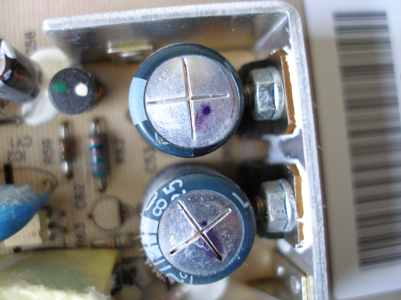

                        Finally, the power board:

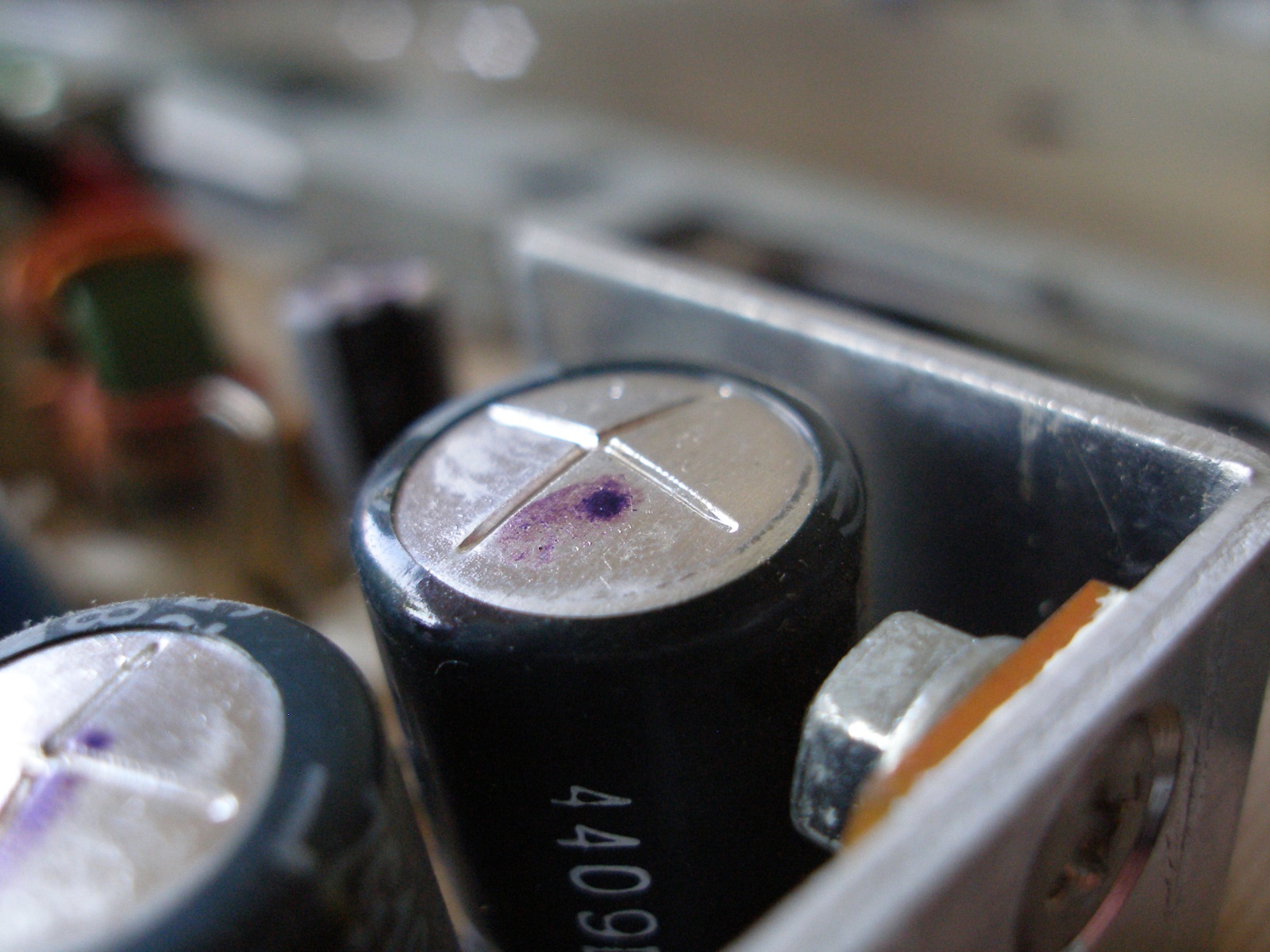

                        Of the six caps visible four have flat ends, but the two at the top right (680uF 25V) appear to be bulging:
                        Closer up:
                        I would grateful if someone would cast an eye on those pics, especially the last two, and say what they think.
                            The centre board:
                            Nice. They used Rubycons YXG capacitors, albeit the lower range for low ESR type. Kinda extremely rare to see quality capacitors on LCD monitors nowadays...
                            Closer up:
                            Those bulging and leaking Ltec capacitors has to be replaced. Looking at the proximity of the heatsinks, its not surprising to see those capacitors go bad easily. Try replacing them first.

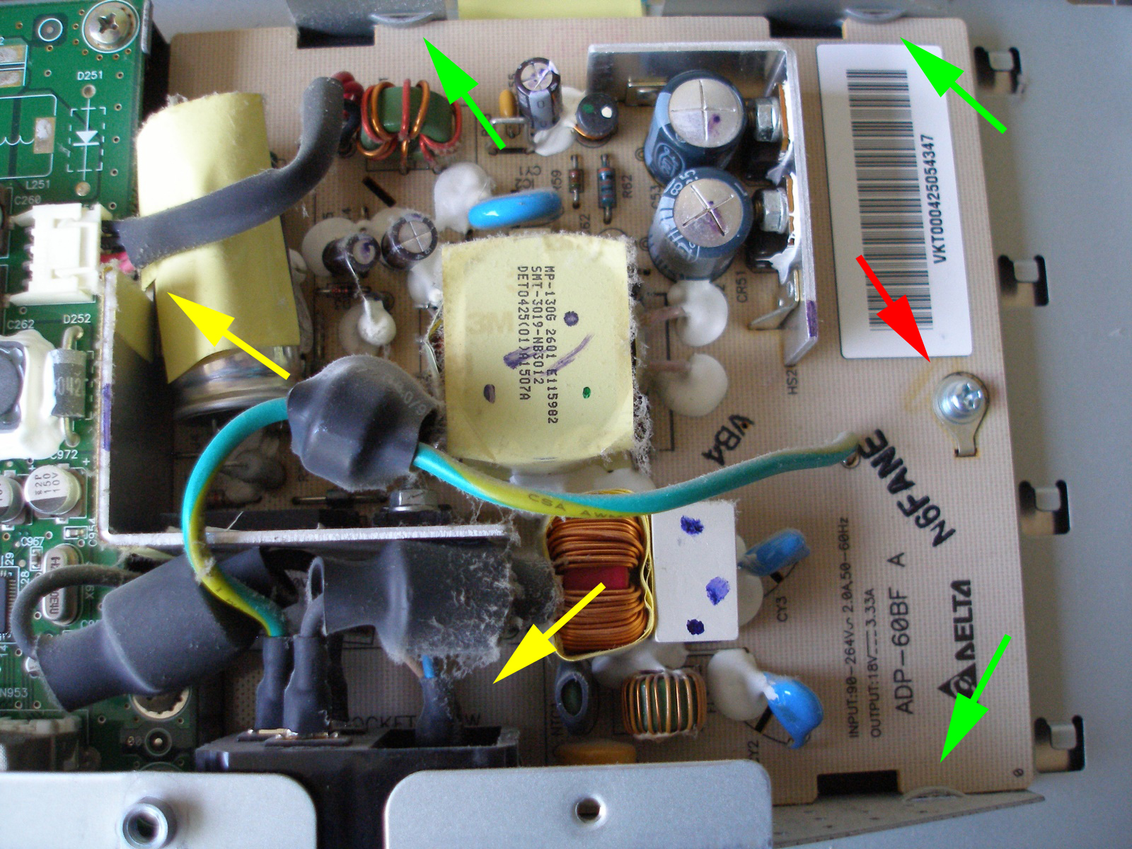

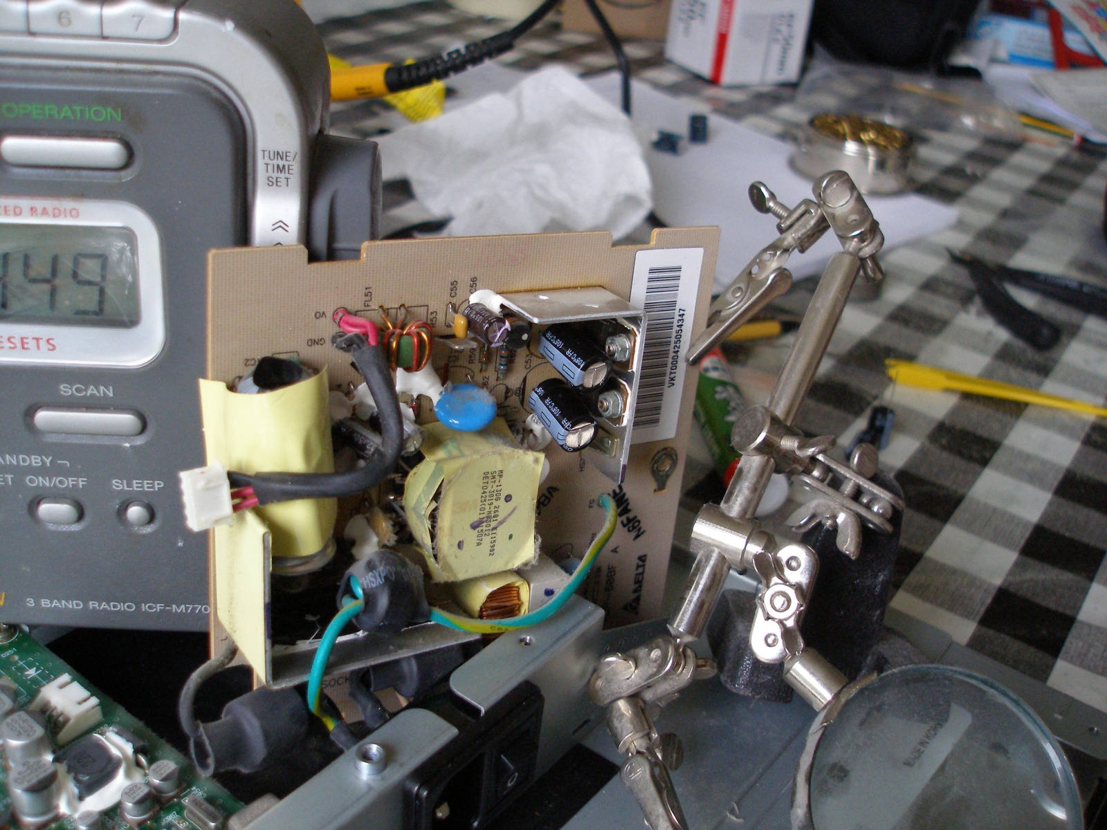

                              My next question is...how do I remove that board to change those two capacitors? I can see six disconnections that must be made, shown by the two yellow arrows:
                              The white plug is no problem. The five connections to the mains input socket are hopefully spade connectors and will come out with persuasion. But I can see a problem with the inflexible metal lugs (green arrows) holding the board down, and much worse, the curious tag thing marked by the red arrow. When I undo that screw I can't see any way I will be able to lift the board without cutting a slot in it to let the tag through. I can't even pivot the board upright (lifting the left hand side) because the mains socket will knock against the metal lugs immediately above and keep it down.
                              • Wrog
                                • Oct 2009
                                • 472
                                #95
                                Re: ViewSonic VP201b
                                Remove red arrow screw. Disconnect far left arrow connector. Slide PCB to the right so that the rectangular holes are positioned beneath the metal lugs. Lift board out.

                                        #99

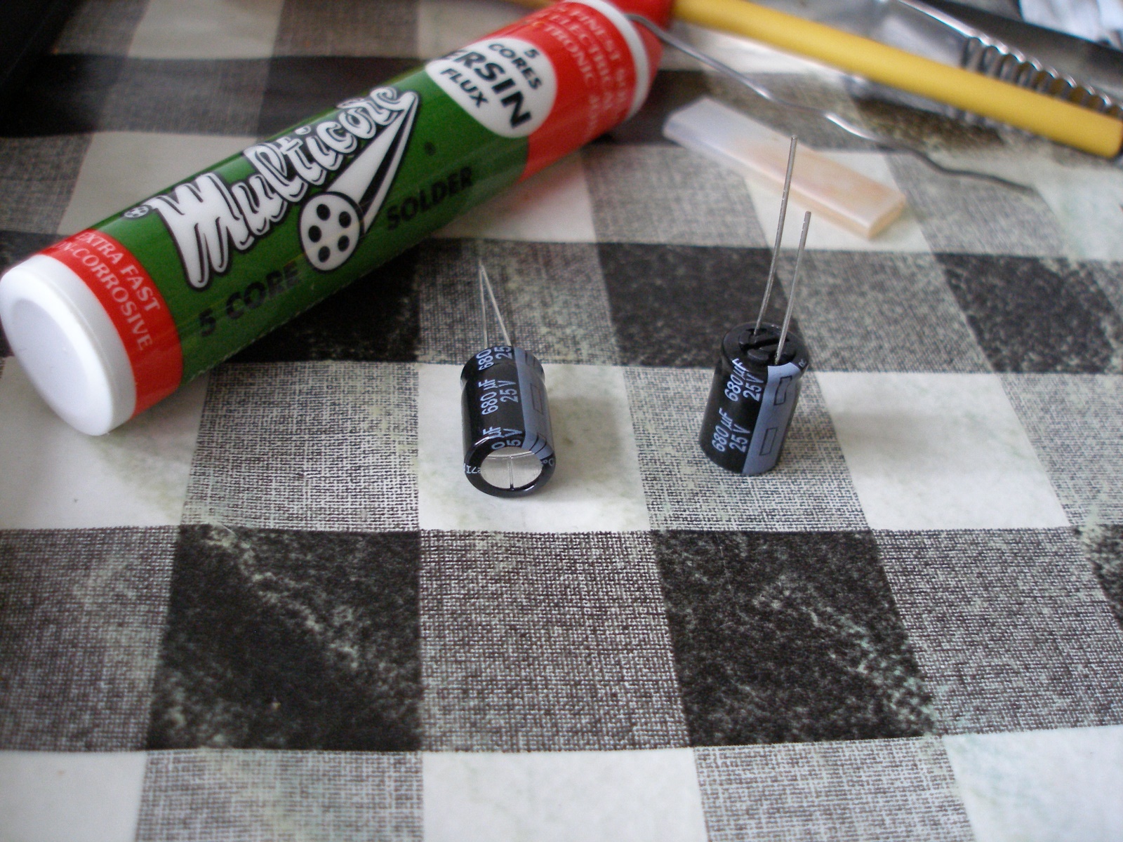

                                        Reporting back
                                        The replacement caps may have been unbranded...
                                        ...and the soldering job may have lacked finesse....
                                        ...but it worked!
                                        Thanks everyone

                                          Those are Panasonic FR. Panasonic changed the sleeve and design compared to the FM/FC series.
