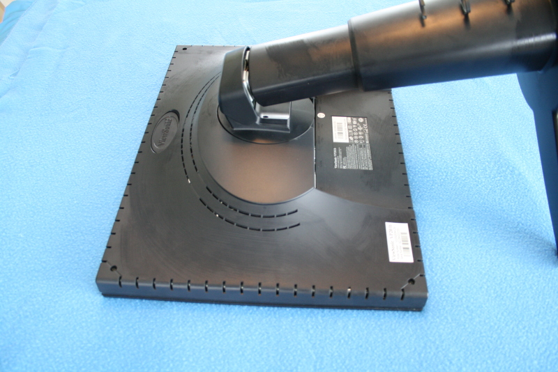

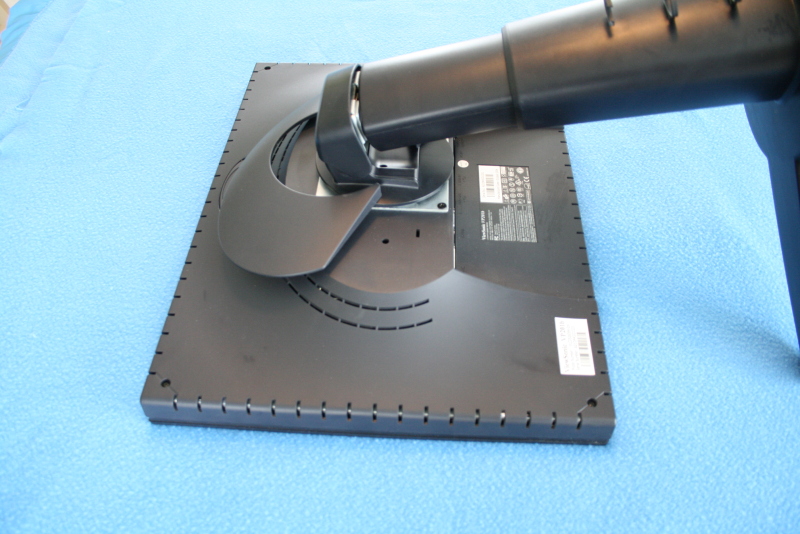

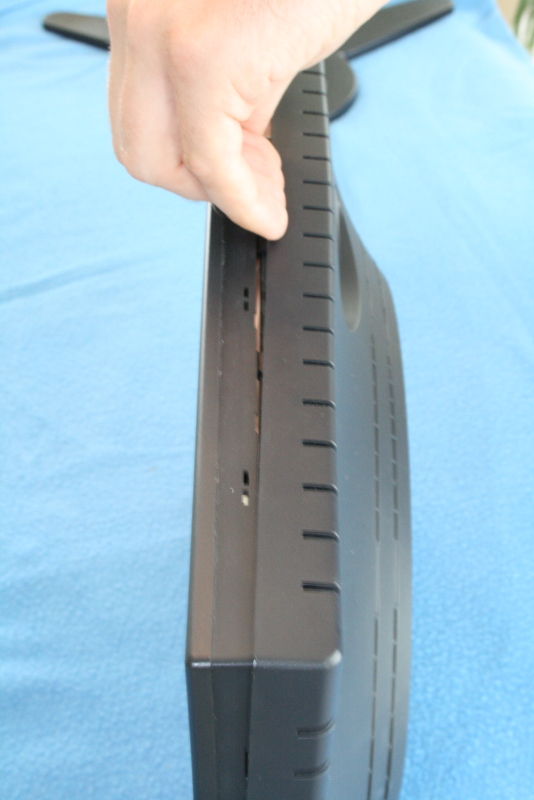

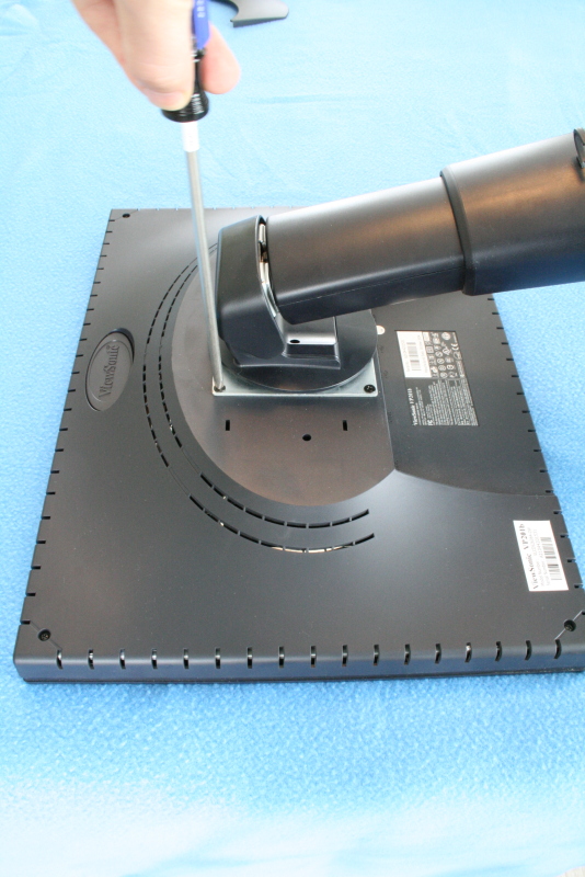

                                • PolishPaul
                                  • May 2009
                                  • 6
                                  #76
                                  Re: ViewSonic VP201b

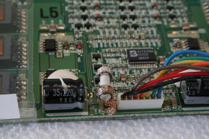

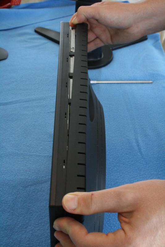

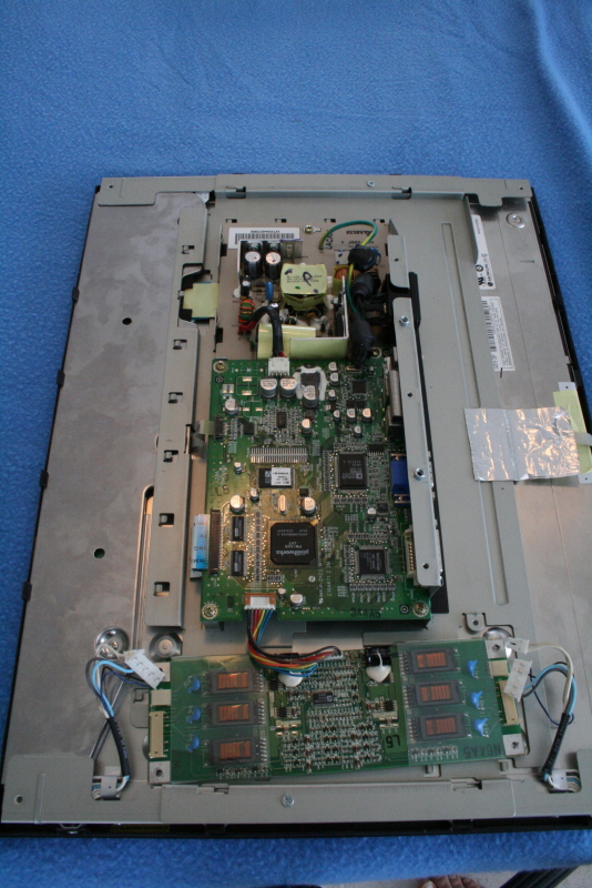

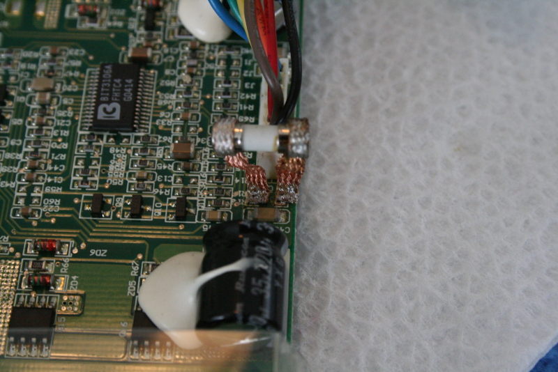

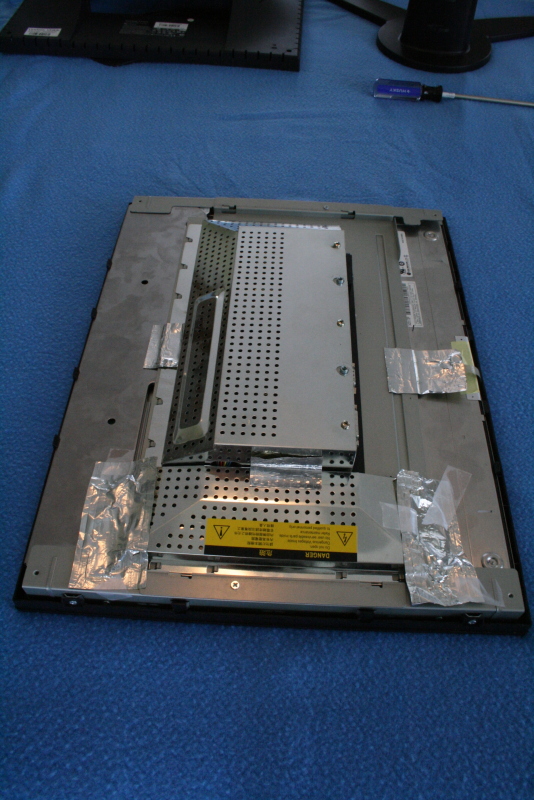

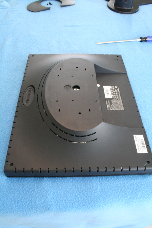

                                  Welp, a bit late but... I finally got around to posting the pictures of my repair job when replacing the fuse. Its not the prettiest thing but it works. The pics don't show the electric tape which secures the wire wick.
                                  The pics may not be in order... but should be able to help out someone trying to disassemble this thing

                                    In the last picture of the top row it looks as if there is clearly 2 domed caps on the p/supply board
                                    You will need to put up a top down picture of that board for better help
                                    As for the fuse I not saying nothing LOL

                                      what makes you say they're doomed? I'm nowhere near that monitor now so i won't be posting any new pics - the thing works fine however.
                                      As for the fuse... I had no other choice (no decent merchants) and I only had about a week or so before going overseas. Hey.. it works Using the wick for the surface solder worked better than i though.
                                        Domed not Doomed (not flat on top) a sign of failed or failing caps
