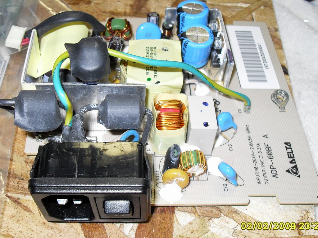

            Well, sorry for the delay, I kept forgetting the Digicam at home. I ended up taking these pics with the cell phone. So I guess the quality isn't that good.
            Here are things I've noticed:
            If you look at pic #1, J2 [Edit: Looking back at it, it may be F1 not J2] (South of the Major Connection Cable) does not conduct electricity through it. In other words, the fuse you told me to look at (thank you btw) doesn't work. That fuse, I believe is dead, so I'll need to get a replacement for it. Might you know what kind of replacement it should be?
            Other than that, @PCBONEZ, I'm not super savvy when it comes to this, I'm learning quick but still not savvy. I've enclosed pictures of the power supply from each direction. In all honestly it looks clean. I couldn't determine how to tell if there were "elite" caps though. What do they look like? Did you notice any? (See PIC 2-4)
            Finally you mentioned to check the backlight lamps. I have gotten down to the last two pictures and I'm not sure whether I should go further. Are the back lights behind this? Please look at PIC 6 as well. The board there seems to be pressure sealed to the monitor. If I pop it out, will it go back in again? (Focus on the gold area)
            PIC1
            PIC[2-4]
            [PIC 5-6]

              Re: ViewSonic VP201b
              It sounds pretty obvious, but... START FROM THE BEGINNING. First, see if you have voltage getting out from the PSU. The caps look good but they may be failing without visible indication. Look for something like "1000uf 35v" in one side, and in the other "Elite", "Teapo" or similar. The first is the capacitance and max V, and the later is the brand. If there is Elites, CapXons, or Teapos, better change them even if they are good.
              You should have 18v output from the PSU. You can check the cables that go from PSU to Main board (two red, two black - you should get V reading from (-) black and (+) red).
              If you do, you can check the fuses in the inverter. I marked their location.
              And you know what?
              Maybe is not your inverter.
              You said it is dead. Dead means no turn on, no green led on the front. if you have a green led but no image, maybe it's the backlight or the lamps. If you do not have the green light (just as my own VP201b when I received it), it is a PSU cap problem.
              And regarding the lamps, they can be removed/replaced. Just must be made very carefully. Hope the pics help.
                Sorry I may have not been too clear about that. Going by your picture (2) F1 or the one on the left of the image is dead. Using a volt meter I was not able to get any signal through it. Since it's a fuse, I suppose that means it's burned correct?
                Now if thats the case, and it is indeed burned doesn't that mean there's an issue elsewhere and the fuse just saved the board?
                I'll check the voltages on the other caps once I get home tonight.
                But -- there is a green light on the front of the monitor. It does stay on, but there is nothing shown in the display. With the fuse being dead would this be the cause? Let me check the things you've mentioned and get back to you.
                note: I really appreciate all the help you've given me. Thank you very much.
                -N
                  If you look at the pic (my inverter), you should notice that the inverter input is at the middle of a mirrored setup : same components on both sides of it.
                  I have a Totevision with a dead inverter (semi dead, in fact): Mirrored components, and just one side works. As just one side works, the whole inverter shuts down (even on a good working inverter, if you remove one of the lamps, it shuts off to prevent damage/overvoltage).
                  If one fuse is gone in your inverter, half of it would not work (no V input), which means that the inverter would be off.
                  It is more a theory based on previous experience than a technical explanation, but it is the only thing I can tell you now.
                  Your idea of the fuse protecting the board seems logic, but then again, if bad caps caused a surge/fault in the PSU output, that could have triggered the fuse. You can just replace the fuse and fire up the monitor.
                                        Looks like it is a fuse thats bad. I'll order a few.
                                        Thank You SOOO much
