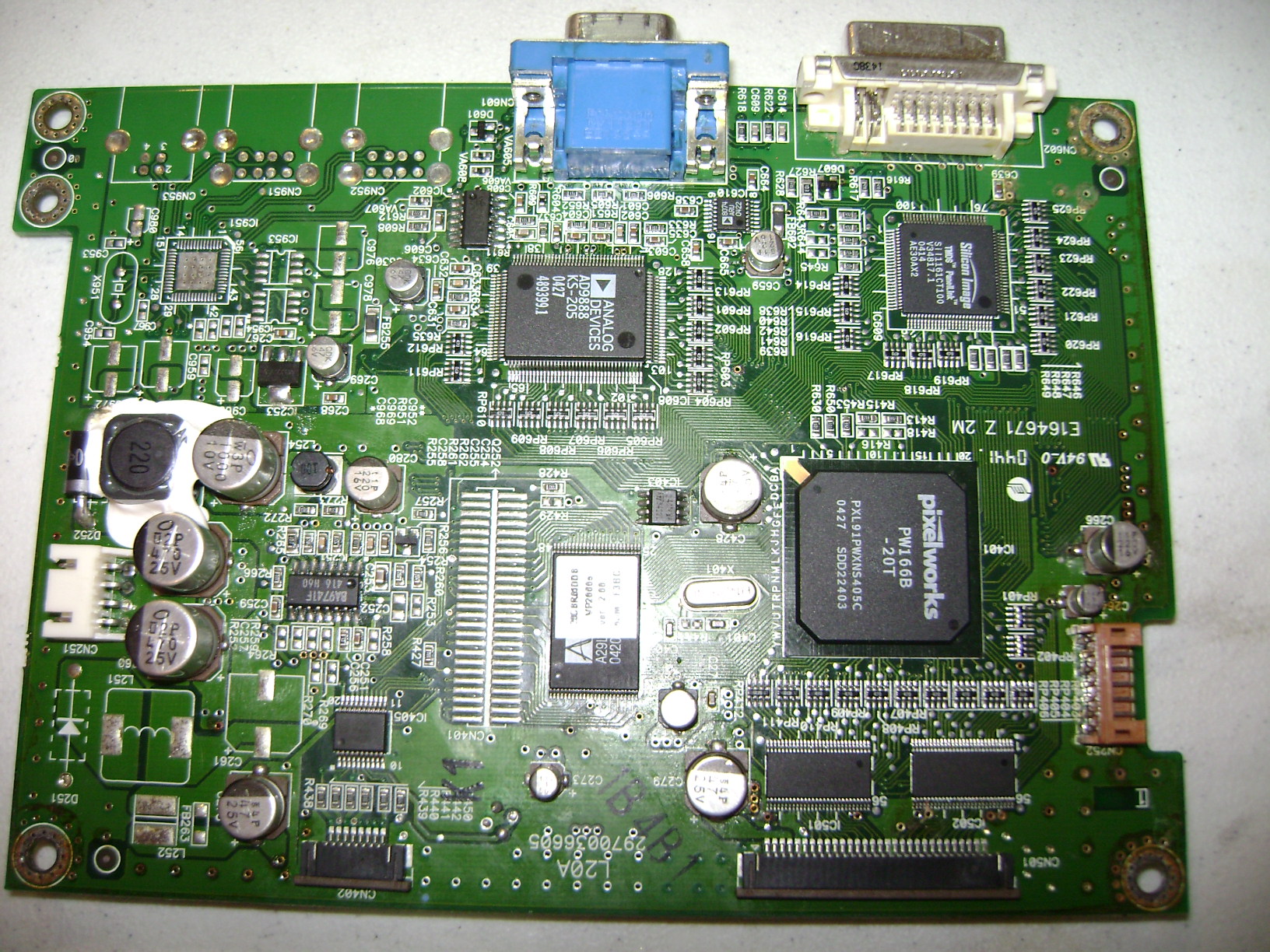

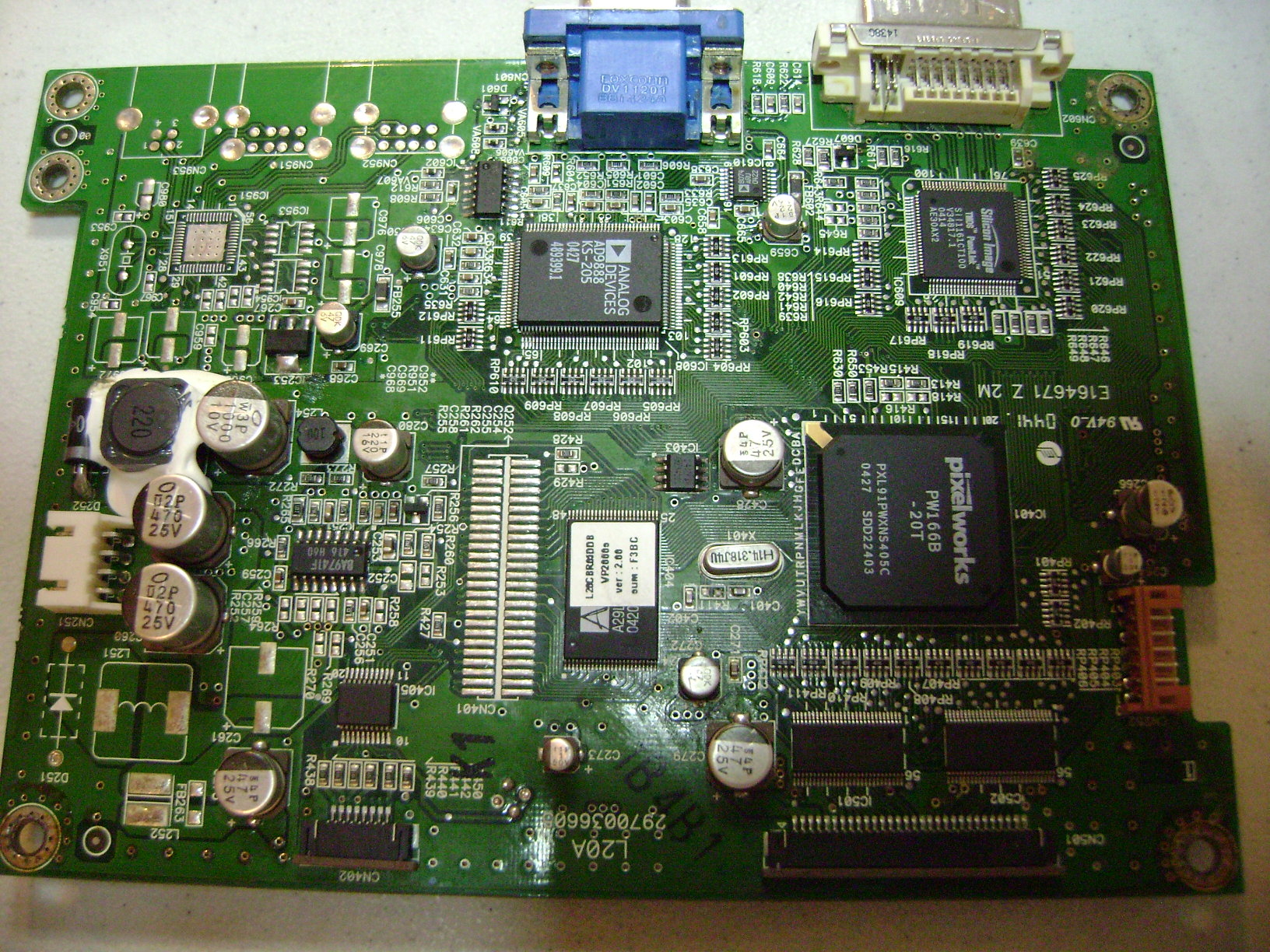

      Post a picture (clear one) of the signal/main/video board to see if I can get my hands on an exact one to try to help you.

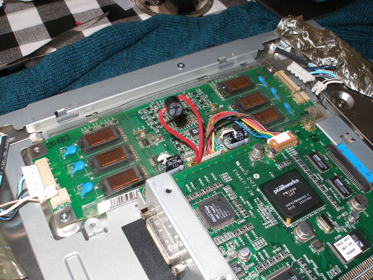

                    Thought I'd come back to post my VP201b success story.
                    I got some solderable fuses and replacement caps. I chickened out of replacing the caps as the new ones were quite a bit bigger than the existing caps. I soldered the one fuse that was definitely faulty. It's the thing weirdly suspended on red wires. I never said it was pretty...
                    https://www.badcaps.net/forum/attach...id=10099&stc=1
                    ...but it works!
                    https://www.badcaps.net/forum/attach...id=10100&stc=1
                    This LCD screen cost me about £550 three and a bit years ago, whatever that is or was in US Dollars. I'm not sure what is most gratifying, the £550 or the raspberry to Viewsonic who have failed to coerce me into buying another screen.
                    Thanks everyone for this moral victory!
