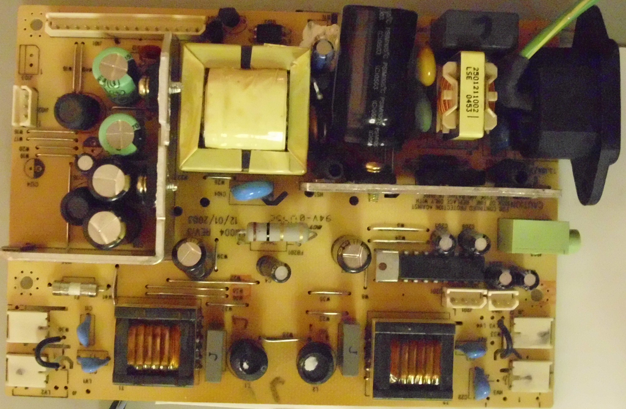

    Any help on where to start on this monitor. No visual signs of leaking or bulged caps. Power led flashes green and screen faintly flickers with it. I've attached some photos of the board where the power comes in if needed i can try and get some better ones and pics of the other boards if needed. Thanks

    Re: Sceptre X9G-Komodo II* blinking power light
    looks like a common board with samxon gl on it.
    replace any samxon caps then try it.gl is a known bad series which does not bulge when bad.they just go high esr.

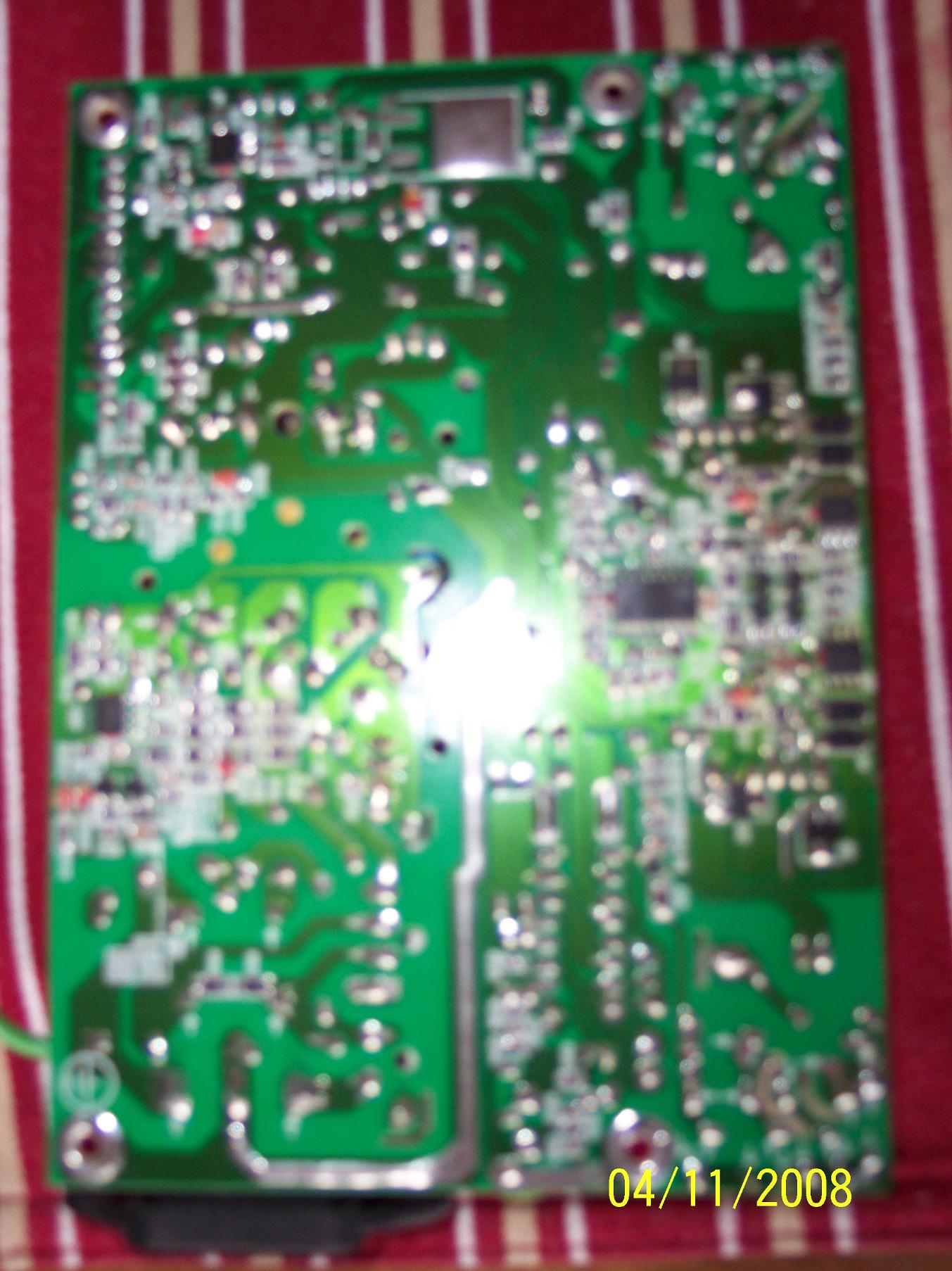

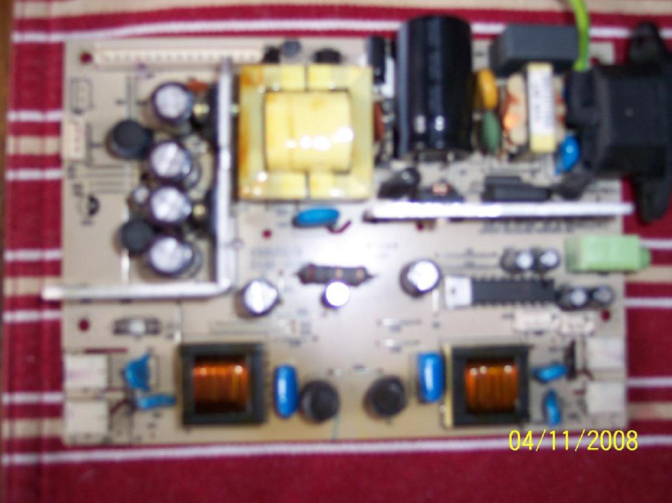

          I just opened today a Sceptre X9G-KomodoIV that does not power up. It has two boards: a main processing board and a LM004 board for both power supply and backlight inverters. Two caps were slightly bulged, but replacing these [see two brown caps on photo] did not solve the problem. I will have to investigate further.
            replace all the caps.thats what i see wrong in every one of the x9's
              Thanks kc8adu: I replaced all caps, but without success. The power light continues to flash 5 seconds ON, 2 seconds OFF. Probing the board shows that both +12VDC and +5VDC go though the same 7 seconds cycle: full voltage for 4 seconds, then going to 0VDC during the next 3 seconds. Power is steady though high [5.5VDC and 13VDC] when the power board is unplugged from the processing board, so I guess that the problem might be coming from that processing board: I will have to reconstruct the pinout of the connector between the boards.

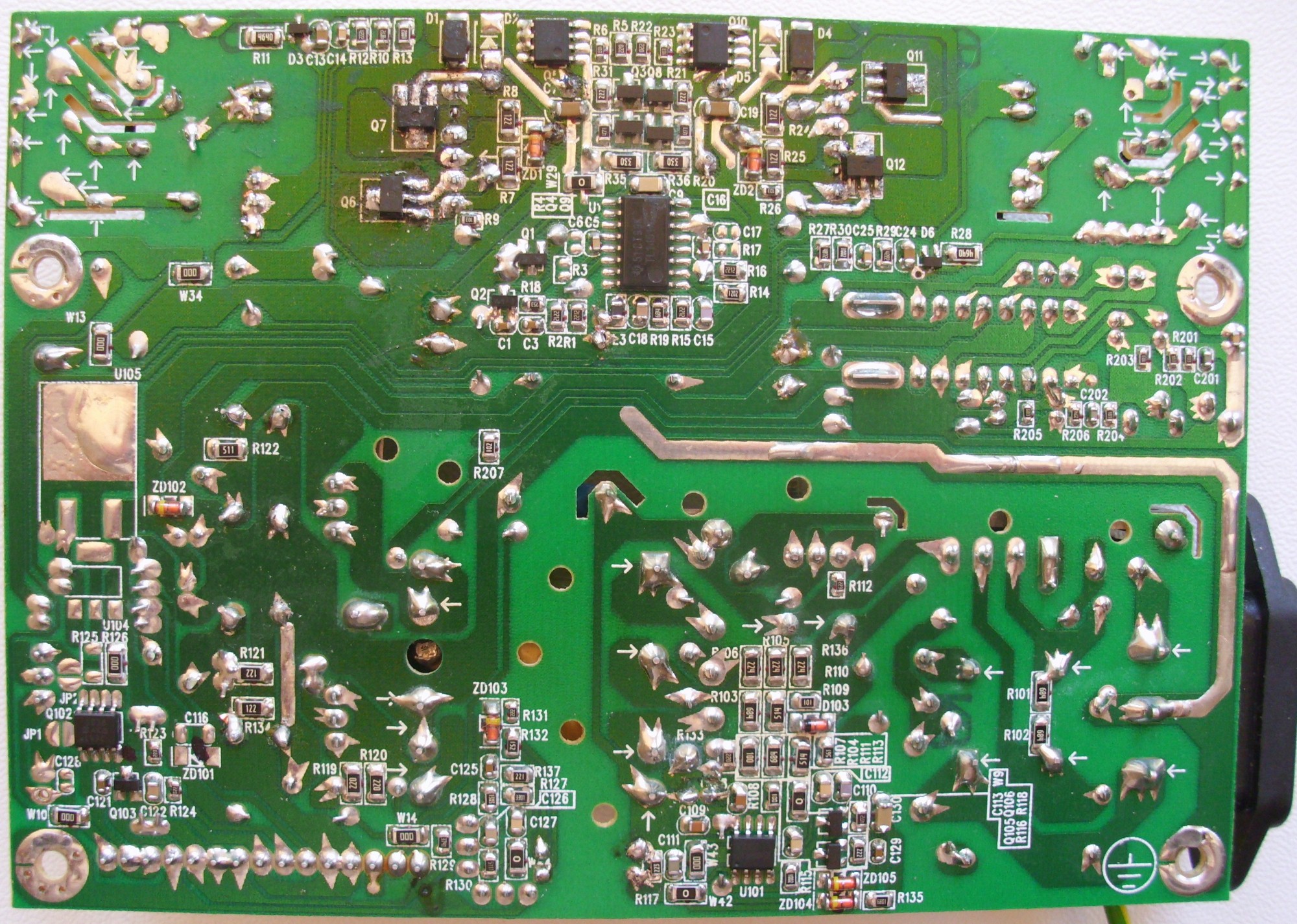

                  I have a Sceptre X9G-Komodo VII A monitor with similar symptoms. It has Elite caps, but no signs of bulging. Testing with an ESR meter showed all caps appeared to be good. Power supply output voltages were stable.
                  Examining the board carefully I found a bad solder joint on C21 in the inverter area. (C21 is not an electrolytic). Resoldering did not fix the problem. Eventually I started looking at the overall inverter circuit and realized it is similar to the design of the Dell E172FPb / E173FPb. And that lead me to Q11 and Q12, which appear to be shorted. Comparing them to Q6 and Q7 confirms this.
                  The transistor is in a SOT-223 package, and has the letters DK and QH. There is a - or _ above the H and what appears to be a tiny Xb in a circle in the center of the package.
                  The only cross reference I can find to the letters DK is a Siemens BCX42, but that is the wrong package. QH doesn't even come up in the cross references I have found. Any suggestions?
                    It was a tangled trail, but I have identified the transistors. They are Rohm 2SC4672. The Q indicates hfe in the 120-270 range.

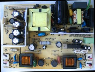

                          This monitor Gives a very brief flash of the back lamps on power up.the desktop is there after back lamps go out.
                          Q6 and 7 showed a short between pins.These have been replaced,
                          With a single ccfl hooked up one at a time there is a normal 2sec bright flash of the lamps on the two ccfl connectors at the bottom of the board near the A.C. plug.On the top of the board the conector near the edge of the board there is a very brief dim flash. And at that point q6 and 7 show shorted again
                          On my initial visual inspection of the board the area of C10, the grey polycap and L1 had bad solder joints,I have removed measured these, along with the T1 coil,And comparied the readings to the out of circuit readings of T2 L2 and C21 These readings are almost exactly the same.These have been resolderd back into the board.
                          I have replaced the two caps for the inverter section. c2 was replaced with a panisonic fm series.Due to a mix up [capacitors packaged wrong ]I had to use a nichion audio grade cap for testing proposes for c4.The correct part is on the way.
                          I need to have some help figuring out why Q6anQ7 are faling?
                            What are the part numbers for Q6 and Q7? I assume Q11 and Q12 are the same?
                            This may not be correct, but the Q6/Q7 and Q11/Q12 look symmetrical to me. Can you test D1, R8, R7, ZD1, C7, R35, R31, R5, R6, Q(the 8 leg FET) above C7? Record all values and compare them with the Q11/Q11 counterparts?
                            You already did something like this for the transformers and caps.
