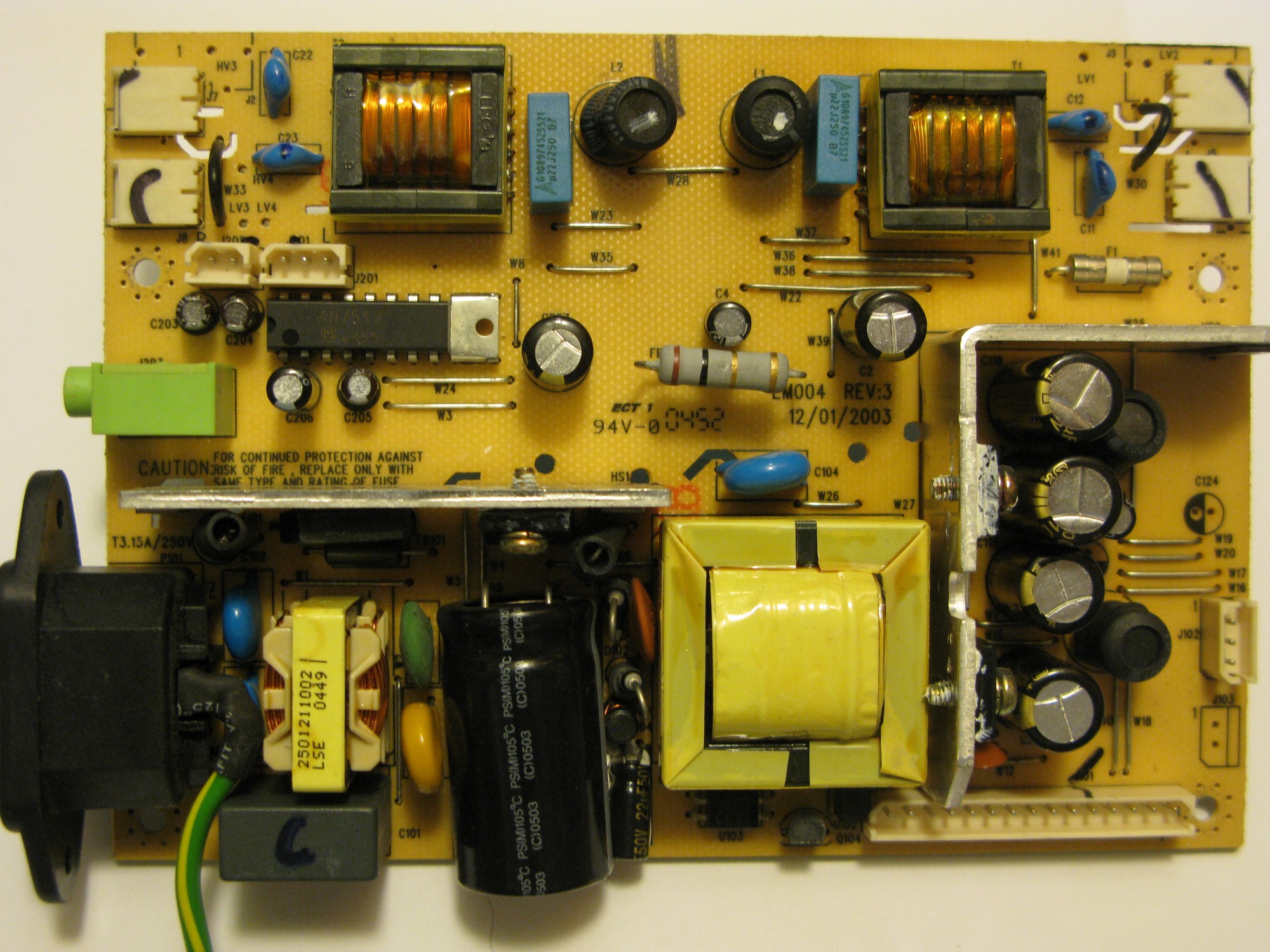

                Wow, wasn't expecting as many replies so quick! Thanks.
                I can get some pictures of my board tonight. In the meantime my board is the exact same as shown in Hennegan's post on 01-22-2011, 06:50 PM (same board part number and rev). All of the components look identical also. well, they did until I replaced the caps with new ones.
                alexanna, "by 2 seconds to black" what are you suggesting/asking? My monitor is not going black any longer now that I've replaced all the caps, but T1 is getting much hotter than T2 during operation (measured with finger and thermal gun...) I have not left it on much longer than 30-40 seconds to see how hot it would eventually get. I suspect a hot transformer is not normal?
                I did order 4 new transistors (Q6, Q7, Q11, and Q12) from Digikey, but have not installed them yet. I'm not sure what and where to try probing first with the meter. I can try comparing readings from the cool transformer to the hot one as a start. I have access to a really nice de-soldering/rework station so pulling components to check them is easy for me.
                If it is faulty windings, is there a source for a replacement, or am I out of luck? I don't think having them custom rewound is going to be cost efficient. Wouldn't even know what the specs are to rewind them anyway.

                  Couldn't edit my post above to add the pics, so here they are. IGNORE the third pic (the values) in this post, and see my next post instead. I measured on both T1 and T2 (T1 is the one running hot). I arbitrarily labeled the pins A through H similarly for both components as seen when looking at the bottom of the board. There seems to be some drastic differences when measuring from any of the pins in the row of A through E across to G or H. Much higher resistances on the properly working transformer (T2). Could these be due to faulty windings, or could my measurements be biased by other components on the board?

                      What is the part number for your inverter transformer?
                      PS. Those are excellent photos!

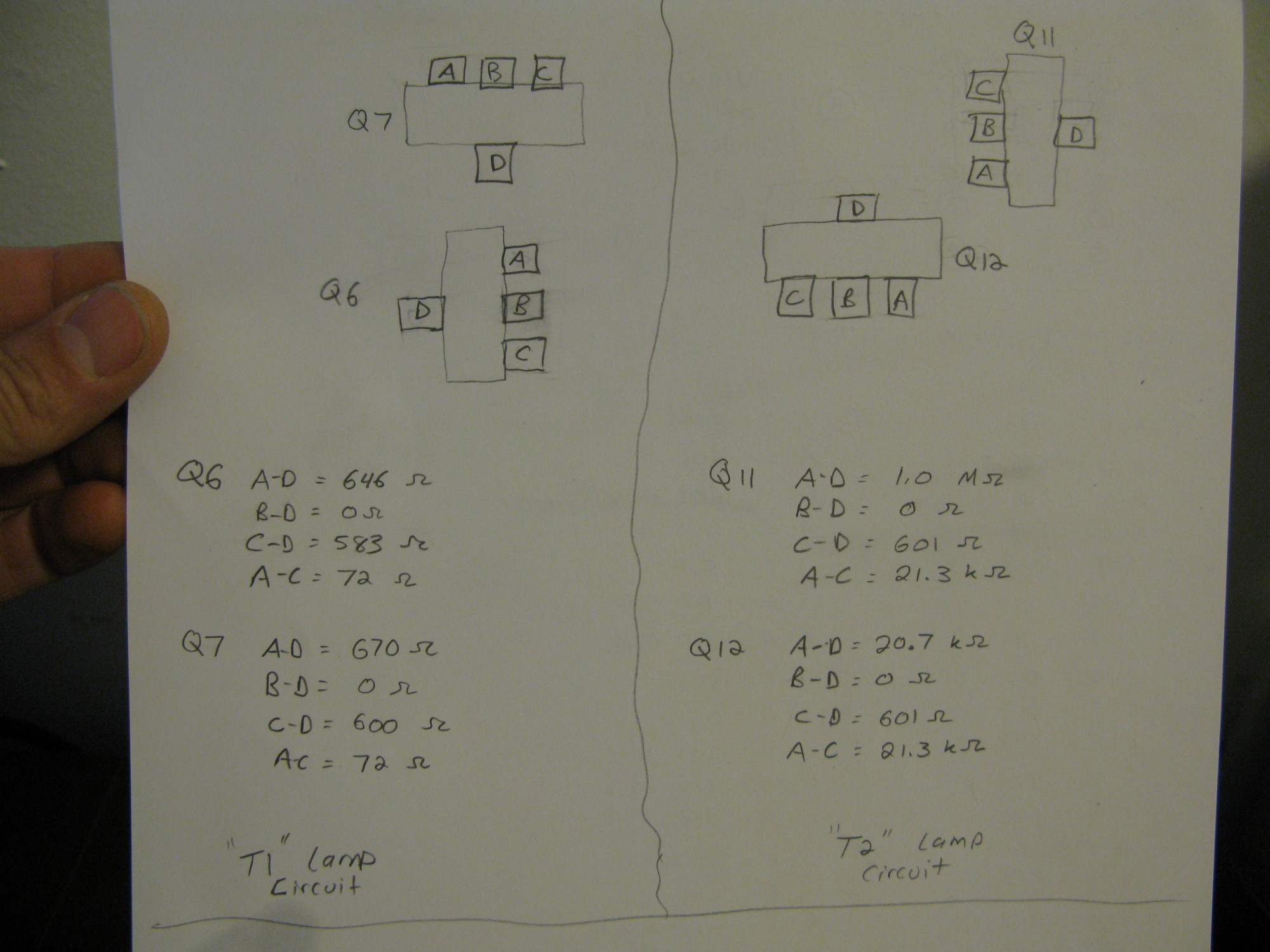

                        And I promise this is my last set of measurements for the night. Here are my resistance measurements across transistors Q6, Q7 and Q11, Q12. Diagrams are looking down at the transistors on the board as in my earlier picture.

                          The only numbers printed on my inverter transformers (assuming you mean T1 and T2) are:
                          2600059016
                          JER 0529
                          and
                          2600059016
                          JER 0520

                            Q6 and Q7 might be shorted between A-C at 72 ohms. I classify 72 ohms as in the "gray" area. It also might be reading low because the measurements are done in circuit.

                              2600059016
                              JER 0529
                              https://www.badcaps.net/forum/showthread.php?t=5552
