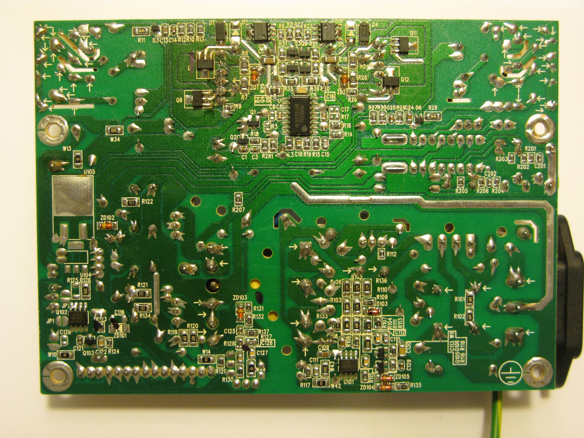

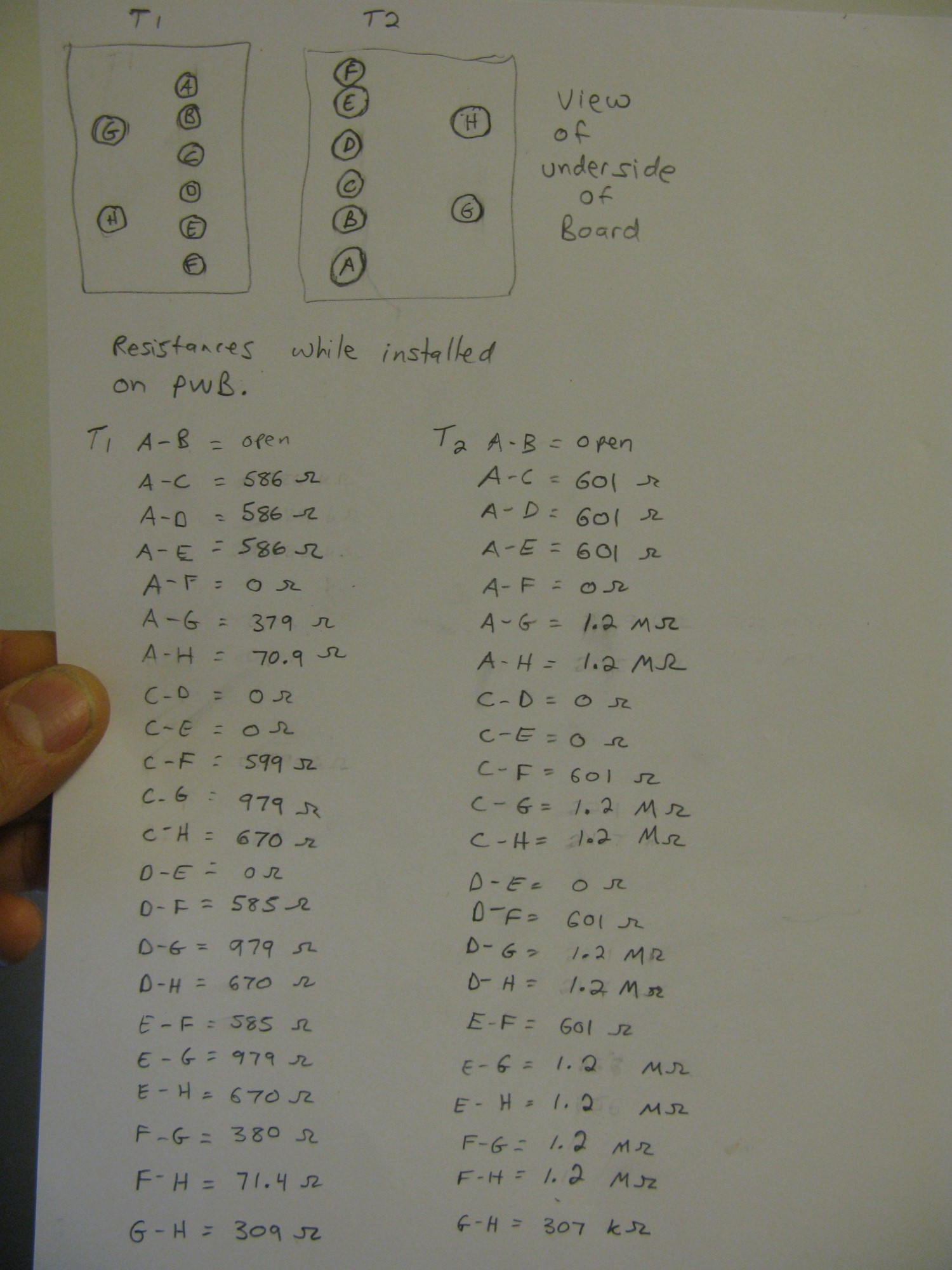

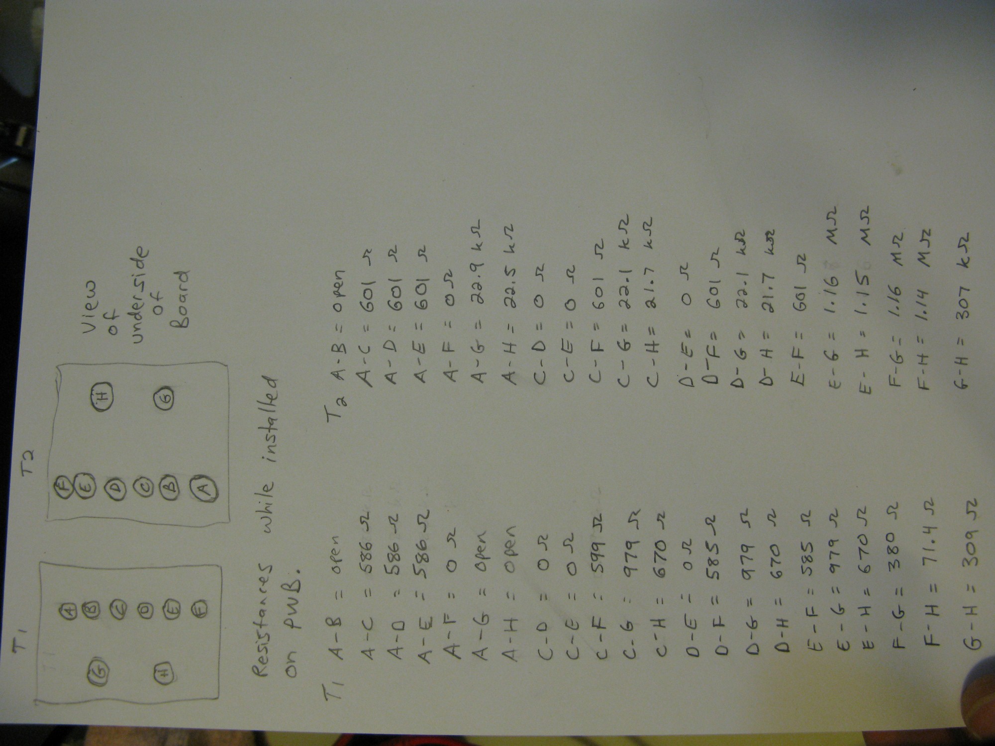

Sceptre X9G-Komodo II* blinking power light
+ More Options
Latest Activity
  • jagibbs
    replied
    Re: Sceptre X9G-Komodo II* blinking power light
    Yeah, I came across that thread yesterday. Don't think the guy ever figured it out. A few suggestions were given for places that can wind transformers to spec. Problem here is we don't know the exact specs.
    This place manufactures many that look similar to the ones on these boards, not that you can buy one from them. They supply to MFGR's in massive quantities. The 4th one in on the top row of the picture for CCFL inverter transformers looks suspiciously familiar and has the same number of windings.
    http://okerda.en.alibaba.com/product...ansformer.html
    Last edited by jagibbs; 02-27-2012, 09:01 PM.
    Leave a comment:
  • retiredcaps
    replied
    Re: Sceptre X9G-Komodo II* blinking power light
    Originally posted by jagibbs
    2600059016
    JER 0529
    https://www.badcaps.net/forum/showthread.php?t=5552
    Leave a comment:
  • retiredcaps
    replied
    Re: Sceptre X9G-Komodo II* blinking power light
    Originally posted by jagibbs
    Here are my resistance measurements across transistors Q6, Q7 and Q11, Q12.
    Q6 and Q7 might be shorted between A-C at 72 ohms. I classify 72 ohms as in the "gray" area. It also might be reading low because the measurements are done in circuit.
    Leave a comment:
  • jagibbs
    replied
    Re: Sceptre X9G-Komodo II* blinking power light
    The only numbers printed on my inverter transformers (assuming you mean T1 and T2) are:
    2600059016
    JER 0529
    and
    2600059016
    JER 0520
    Last edited by jagibbs; 02-27-2012, 08:21 PM.
    Leave a comment:
  • jagibbs
    replied
    Re: Sceptre X9G-Komodo II* blinking power light
    And I promise this is my last set of measurements for the night. Here are my resistance measurements across transistors Q6, Q7 and Q11, Q12. Diagrams are looking down at the transistors on the board as in my earlier picture.
    Leave a comment:
  • retiredcaps
    replied
    Re: Sceptre X9G-Komodo II* blinking power light
    What is the part number for your inverter transformer?
    PS. Those are excellent photos!
    Leave a comment:
  • jagibbs
    replied
    Re: Sceptre X9G-Komodo II* blinking power light
    Ignore IMG_3677 in my previous post and use this instead. I rechecked the board and all measurements across T2 (good component) measure at least 1 Megaohm, not 21kOhm as my earlier table indicated. New table shown below. Note the very last value should read 307 ohms, not 307 kOhms.
    Also I measure 648 Ohms across D1 and 20.7 kOhms across D4.
    I also see differences in resistance measurements across my transistors. Se my post below for values.
    Last edited by jagibbs; 02-27-2012, 08:34 PM.
    Leave a comment:
  • jagibbs
    replied
    Re: Sceptre X9G-Komodo II* blinking power light
    Couldn't edit my post above to add the pics, so here they are. IGNORE the third pic (the values) in this post, and see my next post instead. I measured on both T1 and T2 (T1 is the one running hot). I arbitrarily labeled the pins A through H similarly for both components as seen when looking at the bottom of the board. There seems to be some drastic differences when measuring from any of the pins in the row of A through E across to G or H. Much higher resistances on the properly working transformer (T2). Could these be due to faulty windings, or could my measurements be biased by other components on the board?
    Last edited by jagibbs; 02-27-2012, 07:55 PM.
    Leave a comment:
  • jagibbs
    replied
    Re: Sceptre X9G-Komodo II* blinking power light
    Wow, wasn't expecting as many replies so quick! Thanks.
    I can get some pictures of my board tonight. In the meantime my board is the exact same as shown in Hennegan's post on 01-22-2011, 06:50 PM (same board part number and rev). All of the components look identical also. well, they did until I replaced the caps with new ones.
    alexanna, "by 2 seconds to black" what are you suggesting/asking? My monitor is not going black any longer now that I've replaced all the caps, but T1 is getting much hotter than T2 during operation (measured with finger and thermal gun...) I have not left it on much longer than 30-40 seconds to see how hot it would eventually get. I suspect a hot transformer is not normal?
    I did order 4 new transistors (Q6, Q7, Q11, and Q12) from Digikey, but have not installed them yet. I'm not sure what and where to try probing first with the meter. I can try comparing readings from the cool transformer to the hot one as a start. I have access to a really nice de-soldering/rework station so pulling components to check them is easy for me.
    If it is faulty windings, is there a source for a replacement, or am I out of luck? I don't think having them custom rewound is going to be cost efficient. Wouldn't even know what the specs are to rewind them anyway.
    Last edited by jagibbs; 02-27-2012, 04:39 PM.
    Leave a comment:
  • PlainBill
    replied
    Re: Sceptre X9G-Komodo II* blinking power light
    Originally posted by jagibbs
    I know months have gone by since the last post in this thread, but my slightly different issue with the same board could potentially help someone in the future (if I can get it fixed).
    Like others, my monitor was turning on, then going black after 1-2 seconds. I found a cracked C10 film resistor and some board discoloration (from excessive heat) near T1. I replaced ALL of the electrolytic caps with Panasonic FM series and also the two film caps (C10 and C21). Now my monitor stays on, however I may still have a problem.
    I find that component T1 is getting very hot very quick, whereas component T2 is staying cool. I think these are some sort of inverters/transformers. My thought is that the overly hot T1 is what caused my C10 cap to fail. If I do nothing else, it will just fail again. Any ideas of what I should probe or check next? I'm not sure what to probe to begin troubleshooting.
    I only have basic electronic experience.
    I see several possible reasons for this.
    1. A shorted secondary winding in the transformer.
    2. A bad coupling cap between the driver transistor and the primary winding.
    3. A bad cap on the output.
    4. A bad CCFL.
    As jetadm has suggested, pictures will really help.
    PlainBill
    Leave a comment:
  • alexanna
    replied
    Re: Sceptre X9G-Komodo II* blinking power light
    Originally posted by jagibbs
    I know months have gone by since the last post in this thread, but my slightly different issue with the same board could potentially help someone in the future (if I can get it fixed).
    Like others, my monitor was turning on, then going black after 1-2 seconds. I found a cracked C10 film resistor and some board discoloration (from excessive heat) near T1. I replaced ALL of the electrolytic caps with Panasonic FM series and also the two film caps (C10 and C21). Now my monitor stays on, however I may still have a problem.
    I find that component T1 is getting very hot very quick, whereas component T2 is staying cool. I think these are some sort of inverters/transformers. My thought is that the overly hot T1 is what caused my C10 cap to fail. If I do nothing else, it will just fail again. Any ideas of what I should probe or check next? I'm not sure what to probe to begin troubleshooting.
    I only have basic electronic experience.
    If you disconnect the CCFLs on the coil that's getting hot do you experience 2 sec to black?
    If you get 2 sec to black with the CCFLs disconnected, I would suspect a wiring problem on the hot side of the CCFLs.
    Photos would be nice.
    Leave a comment:
  • jetadm123
    replied
    Re: Sceptre X9G-Komodo II* blinking power light
    Originally posted by jagibbs
    I know months have gone by since the last post in this thread, but my slightly different issue with the same board could potentially help someone in the future (if I can get it fixed).
    Like others, my monitor was turning on, then going black after 1-2 seconds. I found a cracked C10 film resistor and some board discoloration (from excessive heat) near T1. I replaced ALL of the electrolytic caps with Panasonic FM series and also the two film caps (C10 and C21). Now my monitor stays on, however I may still have a problem.
    I find that component T1 is getting very hot very quick, whereas component T2 is staying cool. I think these are some sort of inverters/transformers. My thought is that the overly hot T1 is what caused my C10 cap to fail. If I do nothing else, it will just fail again. Any ideas of what I should probe or check next? I'm not sure what to probe to begin troubleshooting.
    I only have basic electronic experience.
    A good focused photo of the top and bottom of YOUR power board would be helpful as there are different revisions of your board. It's hard to point out things for you to check if members have nothing to look at. Use the "manage attachments" button when posting photos.
    Leave a comment:
  • jagibbs
    replied
    Re: Sceptre X9G-Komodo II* blinking power light
    I know months have gone by since the last post in this thread, but my slightly different issue with the same board could potentially help someone in the future (if I can get it fixed).
    Like others, my monitor was turning on, then going black after 1-2 seconds. I found a cracked C10 film resistor and some board discoloration (from excessive heat) near T1. I replaced ALL of the electrolytic caps with Panasonic FM series and also the two film caps (C10 and C21). Now my monitor stays on, however I may still have a problem.
    I find that component T1 is getting very hot very quick, whereas component T2 is staying cool. I think these are some sort of inverters/transformers. My thought is that the overly hot T1 is what caused my C10 cap to fail. If I do nothing else, it will just fail again. Any ideas of what I should probe or check next? I'm not sure what to probe to begin troubleshooting.
    I only have basic electronic experience.
    Leave a comment:
  • PlainBill
    replied
    Re: Sceptre X9G-Komodo II* blinking power light
    Originally posted by alexanna
    I think you miss understood my post the 2SC4672T100QCT had been replaced along with A bunch of soldering redone, And the DK transistors continued to short.
    They quit failing after I replaced the two SOT346 transistors I circled in the picture
    You are right, I certainly did misunderstand you. And I now suspect I know what was happening. If those are tied into the two FETs above them, they probably handle level shifting of the drive signal. Now to see if that is related to a problem I have been having on another monitor...
    Thanks for the correction.
    PlainBill
    Leave a comment:
  • alexanna
    replied
    Re: Sceptre X9G-Komodo II* blinking power light
    The proper transistors are Rohm 2SC4672. Digikey has them as 2SC4672T100QCT-ND. There are a number of reasons they can short. You have already identified one - the tuning capacitor. Another is a bad solder joint on the transformers, and there is a zener diode that has been blamed.
    The 2PD602A isn't a good substitute. It's rated at 500 ma vs 3A for the 2SC4672.
    PlainBill
    I think you miss understood my post the 2SC4672T100QCT had been replaced along with A bunch of soldering redone, And the DK transistors continued to short.
    They quit failing after I replaced the two SOT346 transistors I circled in the picture
    Leave a comment:
  • PlainBill
    replied
    Re: Sceptre X9G-Komodo II* blinking power light
    Originally posted by alexanna
    I have had 5 of these monitors that always have had the DK transistors shorted; these have always been the ones controlling the CCFLs on the opposite side of the power plug. I have checked and could not find anything else showing short. These have always had poor soldering on the large gray capacitors that are between the DK transistors which was reflowed.
    Out of desperation not knowing what else to try I borrowed two transistors from the good side of another board I had. This appears to have fixed the problem of the DK transistors shorting.
    The marking on these are, If I search in the SMD code book I come up with these numbers
    XS which I think might be a 2PD602,I can find a data sheet on this one http://pdf1.alldatasheet.com/datashe...S/2PD602A.html
    And DS That I think may be this one 2P710AS, I am unable to locate a data sheet on this one.
    I am fairly confidant if the DK transistors continue to short these will fix the problem
    I am hoping someone could help verify that these part numbers look like there correct for the circuit there being used in.
    The proper transistors are Rohm 2SC4672. Digikey has them as 2SC4672T100QCT-ND. There are a number of reasons they can short. You have already identified one - the tuning capacitor. Another is a bad solder joint on the transformers, and there is a zener diode that has been blamed.
    The 2PD602A isn't a good substitute. It's rated at 500 ma vs 3A for the 2SC4672.
    PlainBill
    Leave a comment:
  • alexanna
    replied
    Re: Sceptre X9G-Komodo II* blinking power light
    Originally posted by alexanna
    This monitor Gives a very brief flash of the back lamps on power up.the desktop is there after back lamps go out.
    Q6 and 7 showed a short between pins.These have been replaced,
    With a single ccfl hooked up one at a time there is a normal 2sec bright flash of the lamps on the two ccfl connectors at the bottom of the board near the A.C. plug.On the top of the board the conector near the edge of the board there is a very brief dim flash. And at that point q6 and 7 show shorted again
    On my initial visual inspection of the board the area of C10, the grey polycap and L1 had bad solder joints,I have removed measured these, along with the T1 coil,And comparied the readings to the out of circuit readings of T2 L2 and C21 These readings are almost exactly the same.These have been resolderd back into the board.
    I have replaced the two caps for the inverter section. c2 was replaced with a panisonic fm series.Due to a mix up [capacitors packaged wrong ]I had to use a nichion audio grade cap for testing proposes for c4.The correct part is on the way.
    I need to have some help figuring out why Q6anQ7 are faling?
    Al.
    I have had 5 of these monitors that always have had the DK transistors shorted; these have always been the ones controlling the CCFLs on the opposite side of the power plug. I have checked and could not find anything else showing short. These have always had poor soldering on the large gray capacitors that are between the DK transistors which was reflowed.
    Out of desperation not knowing what else to try I borrowed two transistors from the good side of another board I had. This appears to have fixed the problem of the DK transistors shorting.
    The marking on these are, If I search in the SMD code book I come up with these numbers
    XS which I think might be a 2PD602,I can find a data sheet on this one http://pdf1.alldatasheet.com/datashe...S/2PD602A.html
    And DS That I think may be this one 2P710AS, I am unable to locate a data sheet on this one.
    I am fairly confidant if the DK transistors continue to short these will fix the problem
    I am hoping someone could help verify that these part numbers look like there correct for the circuit there being used in.
    Leave a comment:
  • pedro
    replied
    Re: Sceptre X9G-Komodo II* blinking power light
    Originally posted by hennegan
    I replaced all the power secondary caps, MOSFETs and the rectifier, and while doing so, found a blown resistor (pic attached).
    It's 15mm long body with a 5 mm diameter. .29 Ohms ±5% I believe.
    I cannot find an exact replacement for this anywhere. So the question becomes: Can I replace this with something of a slightly different rating with little/no risk to other components? Say, a resistor rated for .27 or .3 Ohms? Or, should I install some in series/parallel?
    As I see it, it is 0.39 ohms. That first band is orange not red. Also, 0.39 is a standard E12 value, whereas 0.29 isn't even in the E24 range.
    Leave a comment:
  • hennegan
    replied
    Re: Sceptre X9G-Komodo II* blinking power light
    Another month goes by, but I finally found some time to get back to this!
    I replaced all the power secondary caps, MOSFETs and the rectifier, and while doing so, found a blown resistor (pic attached).
    It's 15mm long body with a 5 mm diameter. .29 Ohms ±5% I believe.
    I cannot find an exact replacement for this anywhere. So the question becomes: Can I replace this with something of a slightly different rating with little/no risk to other components? Say, a resistor rated for .27 or .3 Ohms? Or, should I install some in series/parallel?
    Leave a comment:
  • PlainBill
    replied
    Re: Sceptre X9G-Komodo II* blinking power light
    Originally posted by hennegan
    They are mostly Elite caps from what I can tell.
    Spot-on! Amazing. I wish I had tested rectifiers/FET before removing. At this point, I'd rather put in new ones while I have them out.
    Correction on D104: Identifier is actually FCQ10U06 I believe.
    Given the attached datasheets, would these be correct?
    D104: http://search.digikey.com/scripts/Dk...e=RB215T-60-ND
    D105: http://search.digikey.com/scripts/Dk...R20100CTGOS-ND
    This is good to hear, as it's relatively expensive where I can find it!
    Elite caps are anything but. Garbage is a term that comes to mind.
    I'd replace the three components you already removed, then do the test I suggested.
    If you order any parts, replace ALL of the electrolytic caps with Panasonic FM or equivalent low ESR caps. If it hasn't been said yet, the symptoms match those expected if the caps are bad.
    PlainBill
    Leave a comment:
  • PantherDave
    by PantherDave
    Hi all!
    05-29-2024, 02:01 PM
  • huzo
    HP 470 G5 blinking amber light no power
    by huzo
    The board is daox8cmb6eo and i can't find no boardview or schematics on the forum or anywhere...
    So i plug in the charger, amber light starts blinking ,there is 3.3V and 5V present, and 2.4V on the power button,board doesn't turn on, no shorts...
    I've tried flashing the bios...
    interesting thing is the battery was around 7,8V, and it's 11.1V battery, the mosfet near the battery is open, but not charging,i desoldered it,tested it and it's fine ,but the amber light kept going on the charger so i charged the battery with power supply and got it to about 10.5V...
    06-08-2023, 04:08 PM
  • ipatch
    troubleshooting microsoft surface pro 4 no power no led charge light
    by ipatch
    hello, �� i have been sitting on some microsoft surface pro 4 tablets for a while now. i was originally tasked with replacing the battery in one of the tablets, and ended breaking the screen and logic board in the process. decided to buy another tablet with the same specs. got that screen off successfully of the second tablet. the logic board appeared good, but i guess i shorted something out in the installation process of the logic which i've read is a common issue if there is no barrier between the logic board and battery pins. all that said, i ate costs of the repair and have...
    10-05-2023, 11:59 AM
  • russpall
    LG 39ln540v - red light flashes twice, no power to LED driver?
    by russpall
    Hi there,
    I've got a 39" LG 39LN540V that's just spontaneously stopped working! The symptoms are - when I plug it in, the red light will flash on twice, then go out, there's no visible picture, and I couldn't see anything using a torch on the panel either. If I press the power button (either remote or on TV), the red light comes on continuously. If I press power again, the red light flashes twice.
    The TV is using a power board EAX64905301. I've attached a diagram of the power output, I've tested the voltages with a multimeter and I'm getting the following:
    08-27-2024, 01:07 PM
  • What?
    Vizio SV422XVT blinking amber/white power light
    by What?
    Good day, hope all are healthy and cozy. I could use some help with my malfunctioning Vizio with a blinking power light. I have narrowed the problem to the main board but not sure what to do next. I guess it would be good to start with what I have done.
    Problem:
    I have no image, no sound, blinking power light. (left it plugged in overnight and it was still blinking the following morning). I tried the Vizio recommendations (hold power button for 30 seconds, press reset button, check the outlet is live)
    Power Board:
    I am getting 5v only. I have unplugged...
    04-27-2020, 06:21 PM
