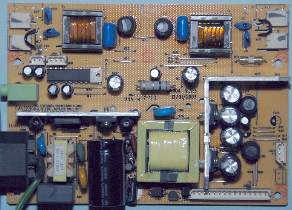

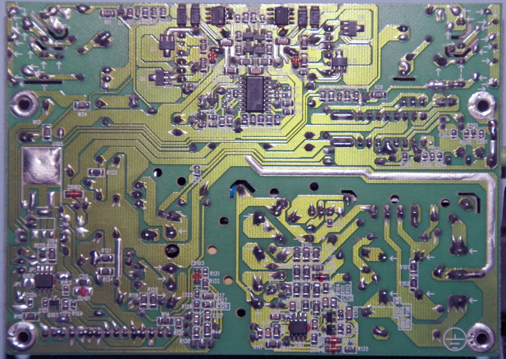

                            Re: Sceptre X9G-Komodo II* blinking power light
                            Thank you RetiredCaps. My apologies for hastily jumping in with nothing to work from.
                            Some starter pics attached. These were re-sized from 3000x2000 (Nikon D80), so please let me know if larger samples would help.
                            The large cap has some leakage around one post. It reads "PS(M)105°C (C)04052"
                            On a side note, I thought it would be worth a shot to e-mail Sceptre directly to inquire about a replacement part. The replied "...we will need a serial number off the power board. It should start with 3404...or 3405.... It is printed on a barcode sticker." I can see no such thing.
                            Also, I have an identical working model of this LCD. I'm tempted to dismantle it to see if it has any identifications this one does not. Lastly, for full disclosure's sake, I believe I have sent both of these screens in for repair once during their lifetime (I didn't investigate much, but probably for the same problem here). Almost as frustrating as the few dozen Dell Optiplex GX270s I had to fix after their capacitor fiasco. I don't think I'll ever go Sceptre again, but if this can be fixed for less than their steep repair price, it's worth the adventure.

                              Welcome to the forum! Can you please give us a description of what the trouble is? Is the power led flashing? No picture? Flash of light, then black screen?
                              One of the first things to do is check for output voltages. Assuming you're in the USA, the voltage across the main filter cap should be approx: 165VDC
                              Generally, you have outputs of 5V for the logic card and LCD panel and 12V for the inverter circuit. Hard to tell from the photos if the circuit board connectors are silk screened with the voltage values. Make sure everything is hooked up before you measure for these values. Also check fuse F1.

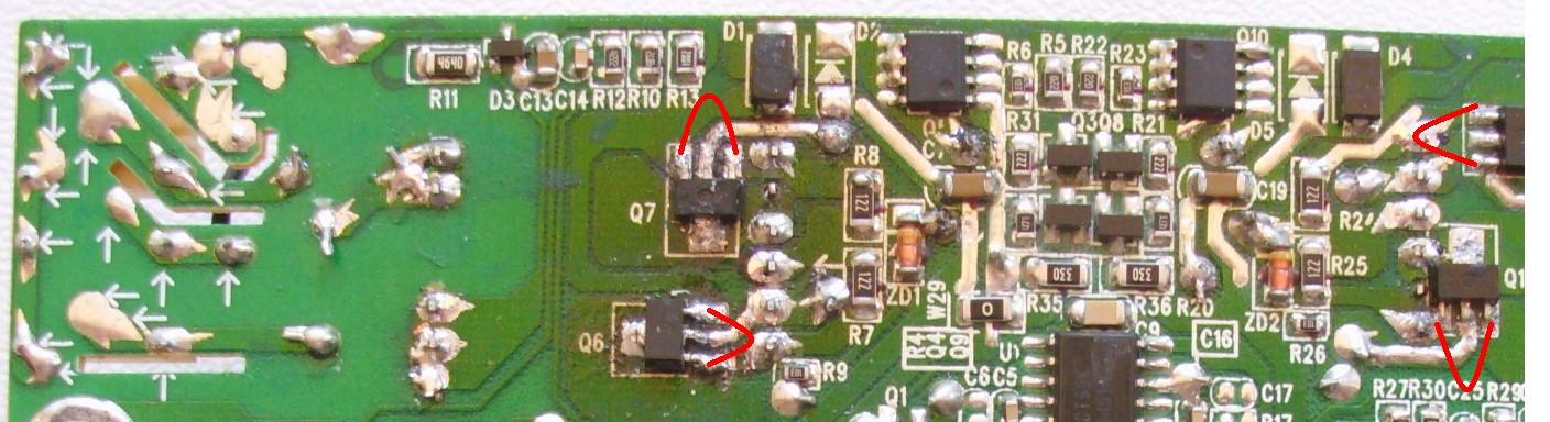

                                    The same problem was with mine monitor.
                                    Can you try first disconnect upper lamps from board, and then start monitor, and if you see picture for the second the problem is on the lower side of the board, you can disconect lower lamps and comfirm this. Or oposite. When you find the side you shoud remove transistors and check oposite legs for shorts. If one is short this one is bad.
                                    Is one is short replace boath. Do not try with ony one becouse is will kill the good one.
                                    Also sou shoud check
                                    D1, D2, D3, D4 (It shoud have same mesures),
                                    ZD1, ZD2 (also shoud be the same.)
                                    Those pins I have shorten with red shoud not be shorten.

                                        Originally posted by mistery View Post
                                        Those pins I have shorten with red should not be shorten.
                                        Thank you Mistery--that is a very helpful image.
