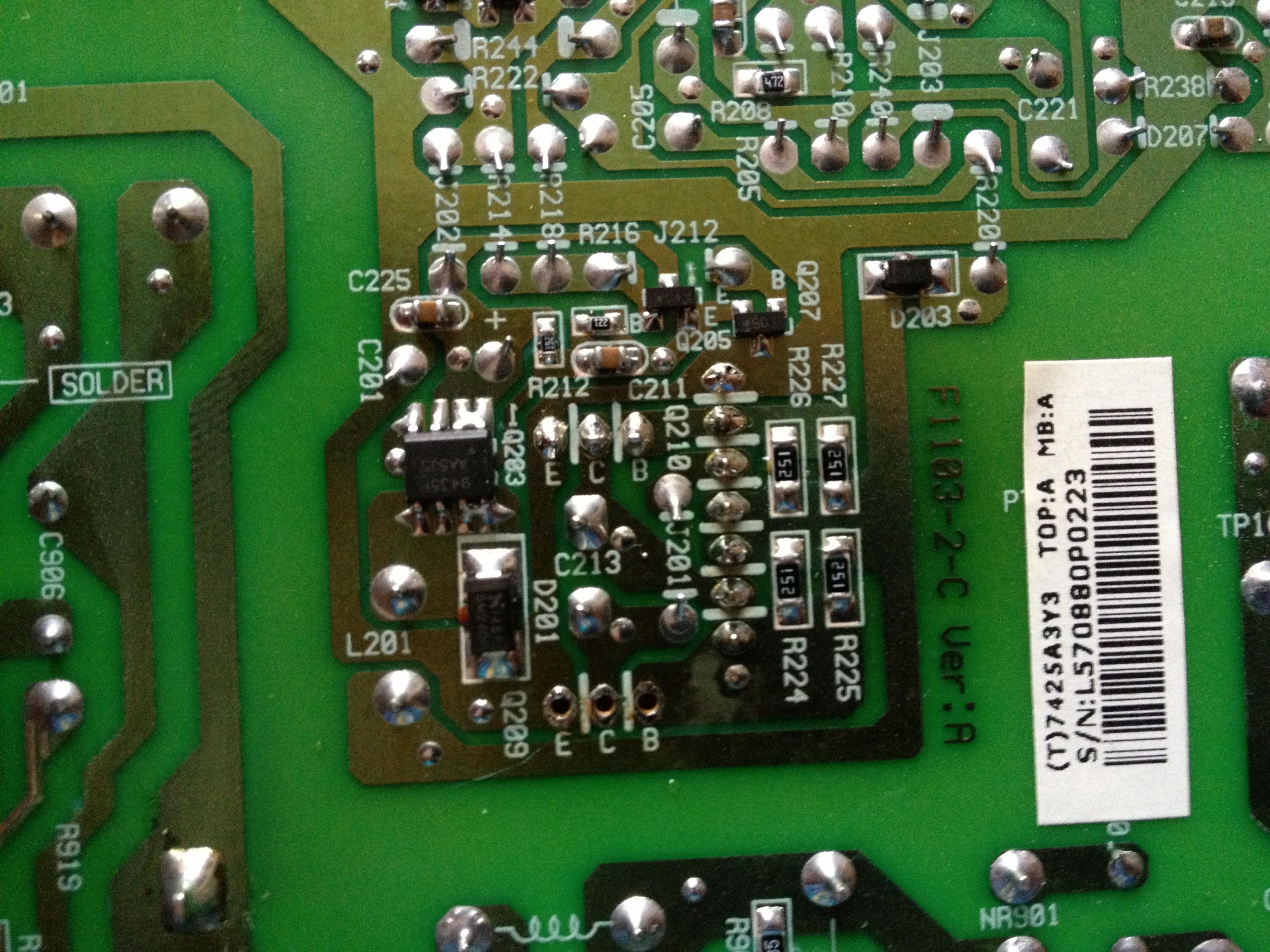

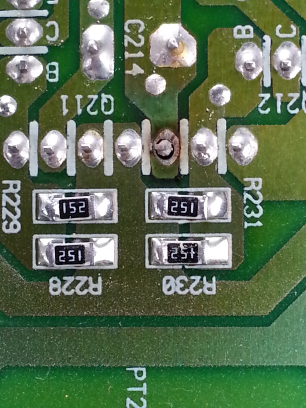

    Morning Guys,
    Finally having got my monitor apart i find absolutely no sign whatsoever of capacitor degradation or any cooked transistors - However one of the contacts to transformer PT202 seems a tad cooked and on close inspection there is next to no solder on the printed side of the board presumably it has been cooked away.
    Any ideas or help much appreciated
    Pozzouk.
    PS. My monitor illuminates for about 2 seconds - screen goes to black and the blue light stays on constant but does not flash.

      typical symptoms.Maybe over time it got like that.Re-solder and see what happens.
        #63
        Re: Iiyama Prolite E431S Turns off
        Wow, that is the worst solder crack I have seen in a long time.
        --- begin sig file ---
        --- end sig file ---
          #64
          You can also see the crack ring forming on the pins to the right and the left, I have seen this problem when the profiles and the temperature of the wvae soldering machine is not properly set, we used to have wave soldering machine that I have to set up evry morning to get it to sodler properly, it can take hours to get right. Once the poor connection started, the heat and the resistance will cause it to get worst, you can see heated area at that bad pin also.

            Cheers for your opinions guys. I guess the message is, carefully clean around the pin and re-solder. When i first saw the damage and all that is written on here, re bad caps and resistors, i had wondered if it were likely that the overheating had been caused by another component further down the line. As it is, other than the obvious problem on the transformer pin there is nothing else obviously wrong.
            So will give it a go and report back.

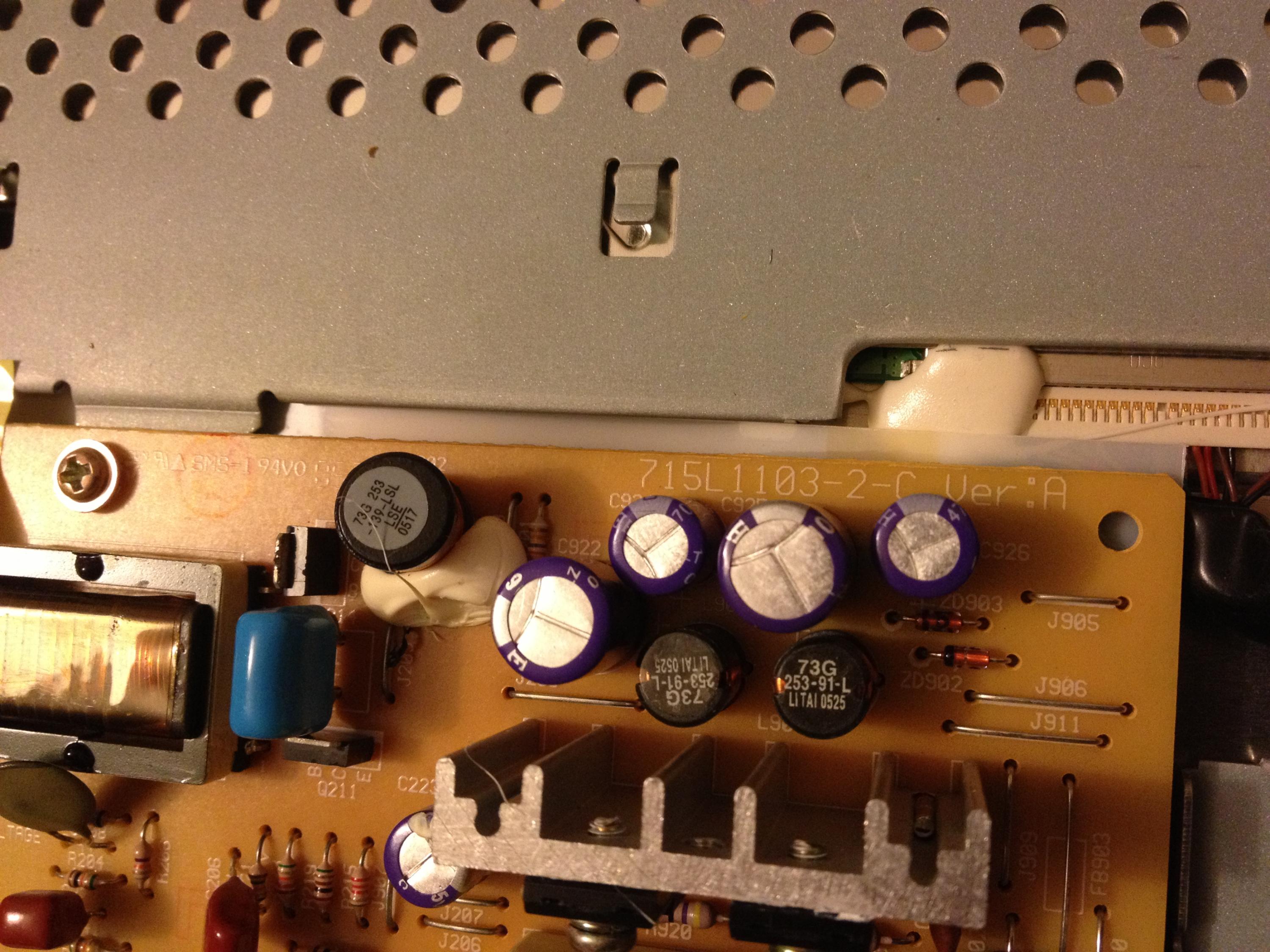

                                    Thanks everybody. I used this thread to repair an E431S.
                                    What was wrong : the screen goes blank after a couple of seconds and works again if you push the auto button then goes blank again, and so on.
                                    I had some old PC motherboards, I was lucky to find 4 x 1000uF 16V on one and 2 x 470uF 16V on another.
                                    The most difficult part was the desoldering of the caps on the motherboads as they are multilayers and my old Weller isn't very powerfull. Once done (I broke one pin on a 1000uF, but I don't care as I had enough), I replace the caps in my E431S.
                                    I also checked the 4 x C5706 and the TP solders. But all seems good.
                                    Note : I had no voltage drop (in diode mode) with B+E then E+B measures.
                                    Then, the E431S is now working fine.
                                    Again, thanks a lot. You are doing a very good job.

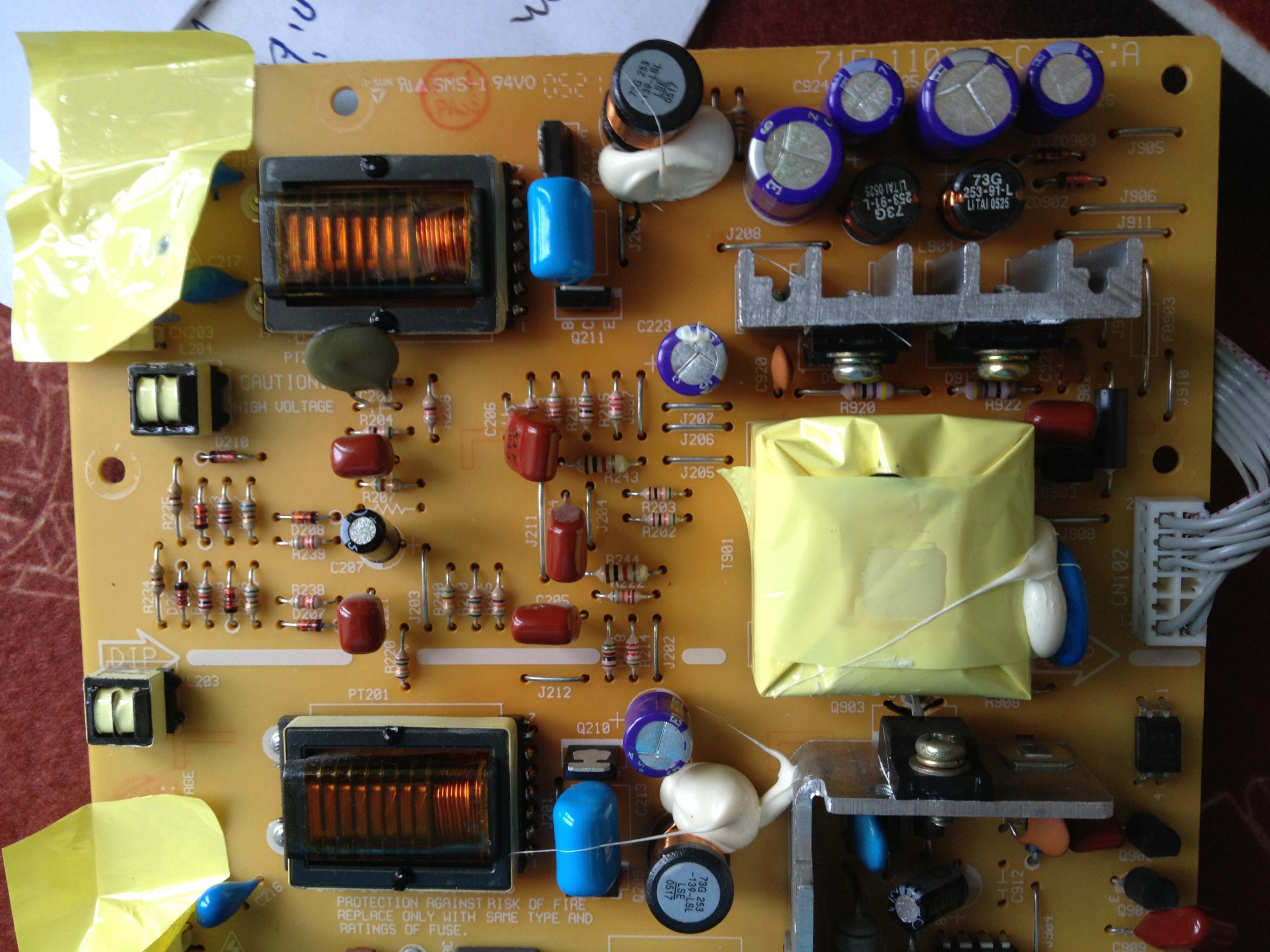

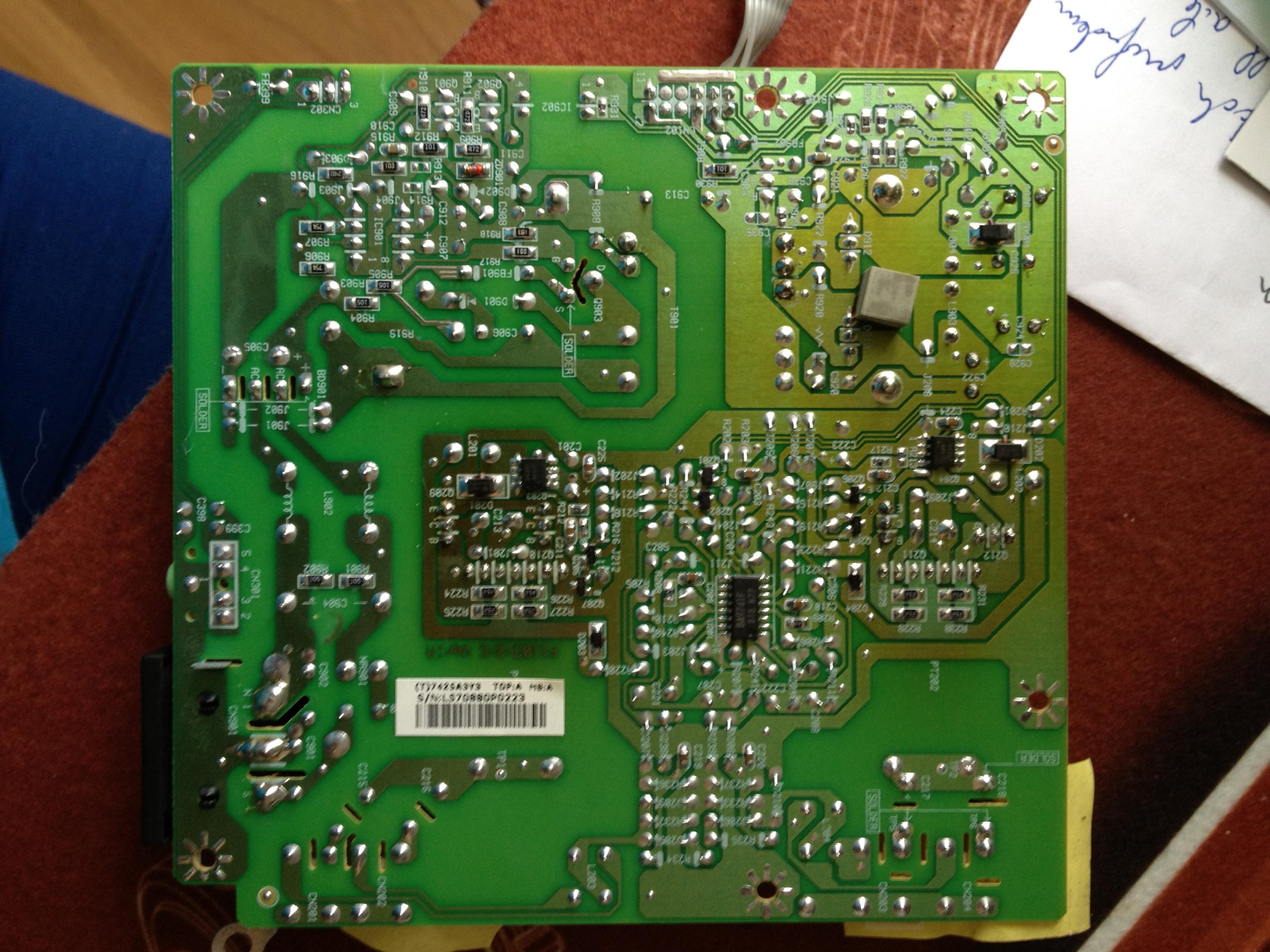

                                      I just stumbled upon this thread and my Iiyama E431S is experiencing the same problems described here by the OP. It turns on briefly for a second and then goes blank. The blue light on the power button remains on.
                                      I have opened up my monitor to inspect the board inside.
                                      My Prolite does not have the same board that everyone else has and I am unable to see any of the same capacitors that could have gone bad.
                                      Is anyone able to help and advice? I am wondering why the inside of my monitor is different to everyone else and if you are able to help me troubleshoot to know what the issue is?
                                      I will try and share a link to a photo I took. I am not sure how to do photos on this site and photobucket no longer works for me so I have tried to add the photo to my google photos sections.
                                      https://photos.app.goo.gl/VHxVMGKTm5HGni8y7
