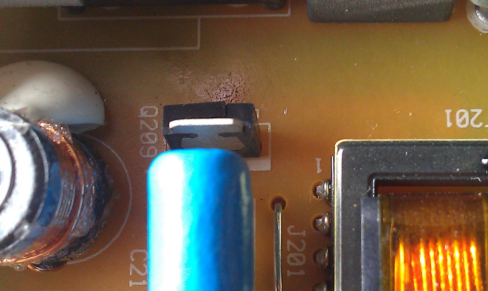

            I will start by admitting I do not have much electronic knowledge. My E431S has displayed the symptoms described in this forum, i.e. flashing blue power light before final extinction. I consider I have nothing to lose by giving it a go.
            My first query concerns what I assume is a transistor, Q209. There is residue on the board so I assume it's kaput? I understand this is a caps forum but can anyone help me identify this so I can replace.
            Secondly, there do not appear to be any bulging caps. C922's sleeve appears to have slipped, I don't know if this is indicative of failure. I have no means of testing. C924 appears to be going the same way. My thoughts would be to replace the transistor first and see how that goes and if no good try the caps. I would be grateful for any advise on the way forward.
              So far you are batting about 500. Let's see if you can hit one out of the park. Q209 is definitely bad. The inverter design is our old friend the Royer oscillator. Replace Q209 and it's friend on the other side of the blue poly cap. Resolder the leads on the transformer next to them.
              I'm not sure, but it may be a good idea to replace all of the electrolytic caps (with the exception of the large 100 uF, 450 volt one). Check the brand (Hermei?) against the list of bad cap manufacturers in the FAQ.

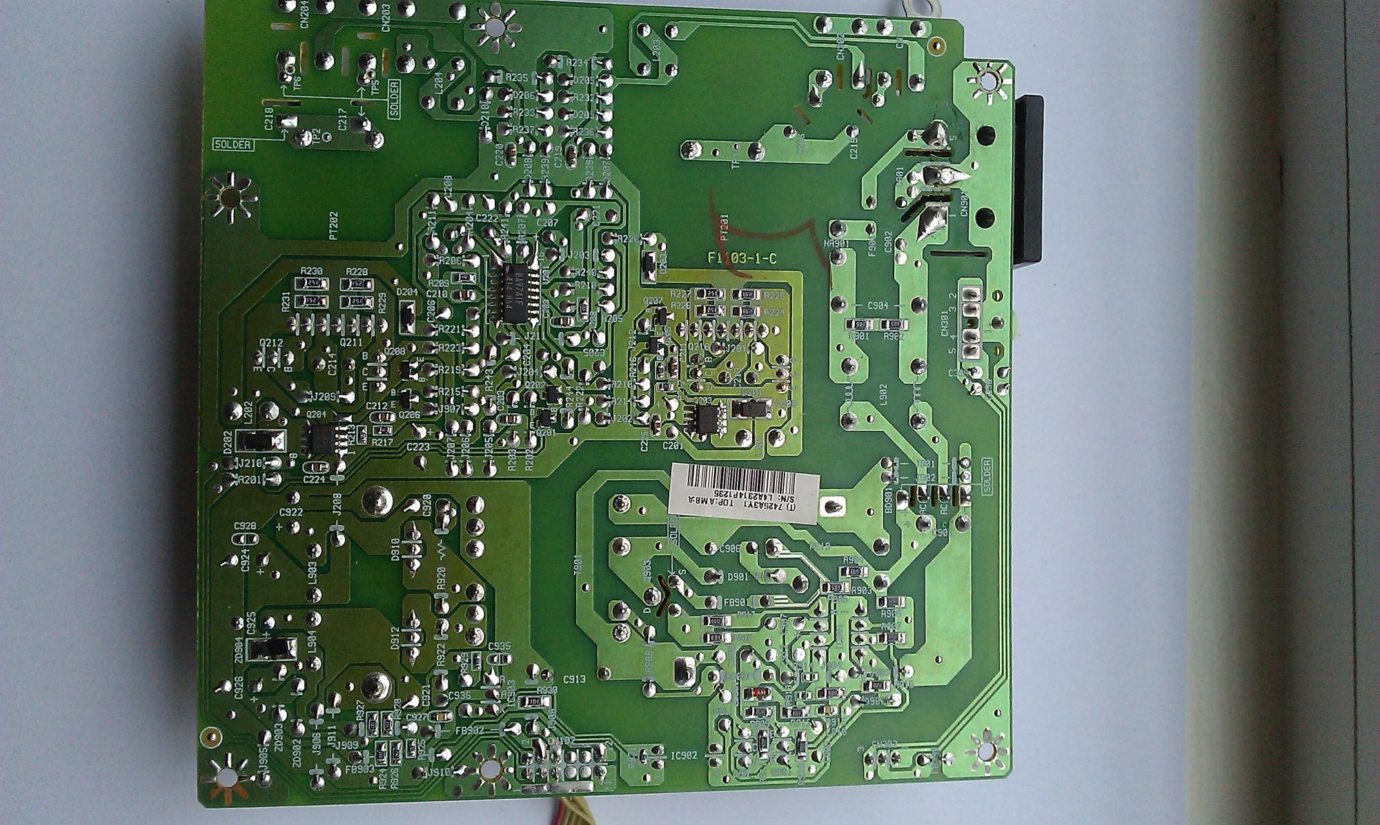

              Also, please post a picture of the bottom of the board. There are components that are also candidates for failure that don't appear on the top of the board.

                PlainBill, many thanks. Royer Oscillator, well there's a thing! Checked out another of your posts on the subject with a Viewsonic. They are 2SC5706's so I can order them. Just to confirm my ignorance, which is the transformer I should be re-soldering? Firstly there's a PT201, then possibly the round winding with a white blob of something at it's base or what I think most likely, L902. I will report back when I have repaired, maybe sometime, lot going on. Once again, many thanks.

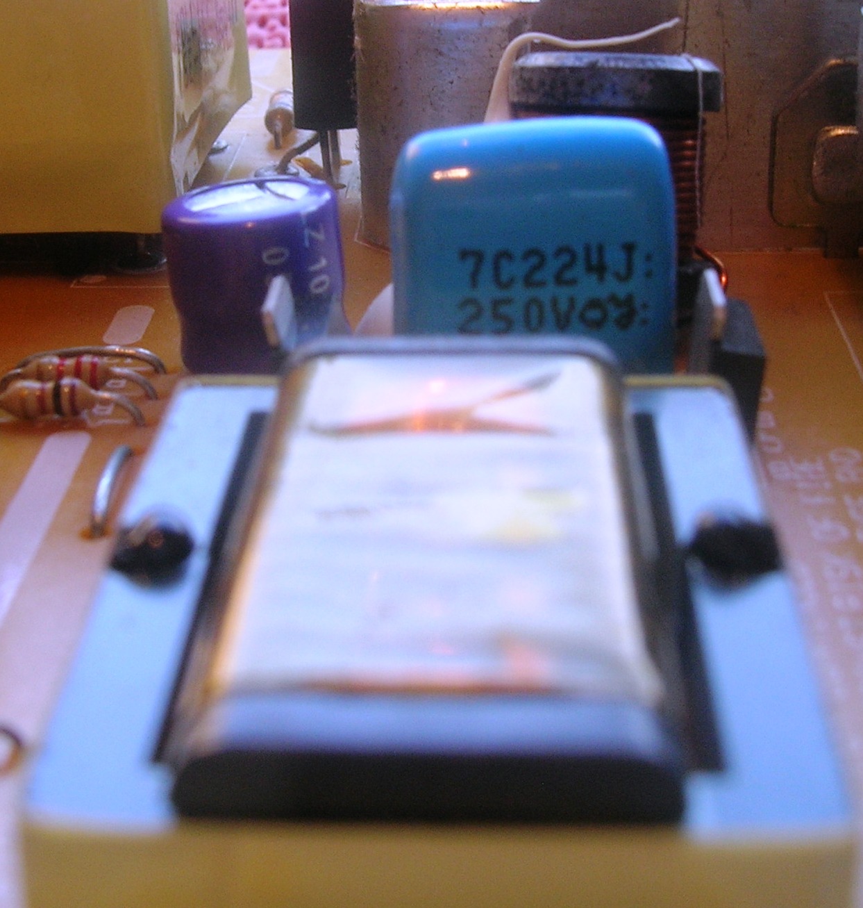

                          • sabre504
                            • May 2010
                            • 449
                            • United Kingdom
                            #53
                            Re: Iiyama Prolite E431S Turns off
                            Top line -: 7C224J:
                            Bot line -: 250Voj (oy) last 2 letters could be either (strangely printed)
                            • PlainBill
                              • Feb 2009
                              • 7034
                              #54
                              Thanks, sabre504.
                              224J indicates it's a .22uF, 5% cap. The second line indicates it is rated for 250 Volts. A suitable replacement would be Panasonic ECW-F2224JB; available from Digikey as PF2224-ND.
