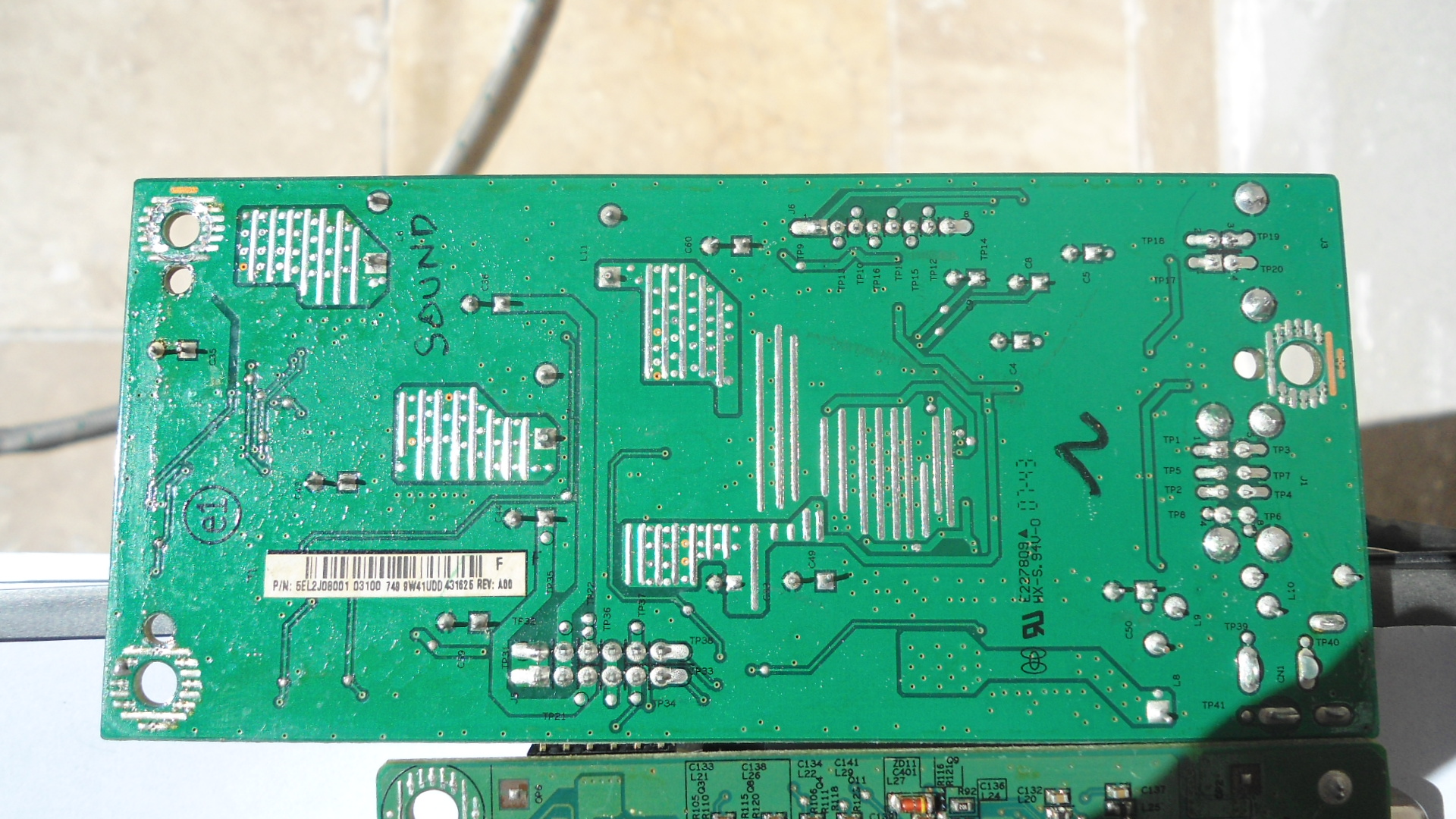

      let me try your suggestions ,do i have to screw all the boards back into the frame of the monitor? ,or i can try to somehow do it with the boards out, the way they are now?
      everybody's suggestions are welcome and appreciated by me ,it gives me an opportunity to learn something else at my old age,and i thank everybody and ask you to keep posting them.
      Hmm that is a difficult one to answer When there are so many boards its a major task to keep putting them in and taking them out of the frame BUT
      the boards interact and they all need to be grounded - If you look at the boards you should see metal tags or raised solder like a "sun" around some of the screw holes where they attach to the frame and that is how they ground
      (we have had occasions where after many days of troubleshooting the OP
      (original poster) gave up and put the set back together gave it one last go befor chucking it and it worked !!! )
      If you leave the boards out can you connect them ALL up and plug in the lights.- Sometimes the boards have to be turned over and layers of cardboard put between. Do not work on a metal surface!! or on an antistatic bag.
      I think for a first test put it all back together in the frame - you only need use screws to hold it in place and only need really tighten one earth screw on each board.
      That test that Davi P suggested is a good next one. When its all together
      unplug the lvds cable (Its the bottom socket in your last picture in post3) ( that stops the image signal going to the screen so should let us know for certain if the back light is on or not)
      After that some test may need the boards removing again.

        Re: dell 2007 WFPb monitor ,no lights
        "so who is troubleshooting for a bad backlight?" Ok i dont had read well, i saw a desoldered transformer i tought it had been suggested, (to Ortiz) anyway arrived to the 20th post we still dont have done the "pointed lamp" test (read the past msg if you don't remember)..
        "is this what the backlight on the dell 2007 monitor should look like?" No, when you have an almost black screen can be noticeable a surrounding light when backlight is on so the real color is not really full black but a very dark grey.
        "do i have to screw all the boards back " yes it's not an huge job it's enough to screw 2 screws per board..

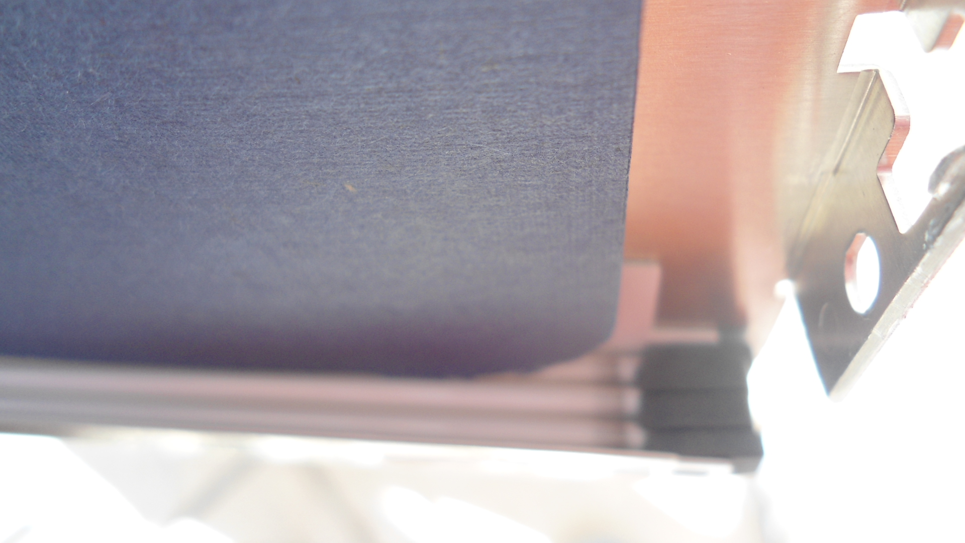

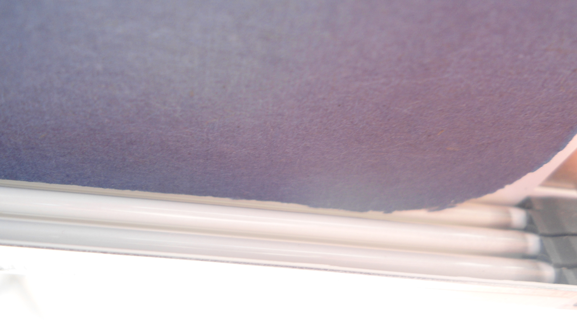

          thank you selldoor and all that replied,
          here its something i tried,since is the first time i take a monitor apart,i venture into finding out what a backlight is and how it looks like.mind you i may have done a nono because i probably wont be able to put it back together,but i kept the parts in the order i took them out,i just will reverse that process and hopefully will turn out looking and working the same.
          any way here is what i found: there are 6 skinny flourescent lamps(look alike) 3 on top of the metal assy and other 3 on the bottom of the same ,assy from the back of the screen unit.
          3 of them look darkened on both edges and the other 3 on one edge only.
          i dont know if this can be a problem ,but somebody said that bad lamps cause this dark screen problem.
          i am enclosing pictures of them,a did not get a really good picture of them because the metal enclosure kept shining and reflecting in the camara,i tried with a flash,out in sun,put some dark sheets on the metal and this is the best i could do.
          i am retired in mexico and i forgot the difference in time zone in other parts of the world,its 11 pm and i have been trouble getting my modem to work properly,it has been going on for a week or so,just today i have been trying to connect since 6 pm and i am just now connected.i dont know what time its now in UK but if i wake you up ,i am sorry,i dont mean to be rude.
          thanks.
            good morning,if you read the post to selldoor ,i post 3 pictures of the lamps on the screen assembly that i ventured into taking apart to see what they look like and where they are.
            they look dark on the ends,but i dont know if this is bad enought to cause a problem.i did post the pictures but because i am having trouble with my modem for about a week,sometimes i can not connect and when it does it takes a long long time to send,i have a very weak signal.i am going to post the pictures again and see if they show this time.i will have to try to post those pictures tomorrow,the page has been uploading those pictures for the last 15 minutes,i lost connection once and i tried again,same results.

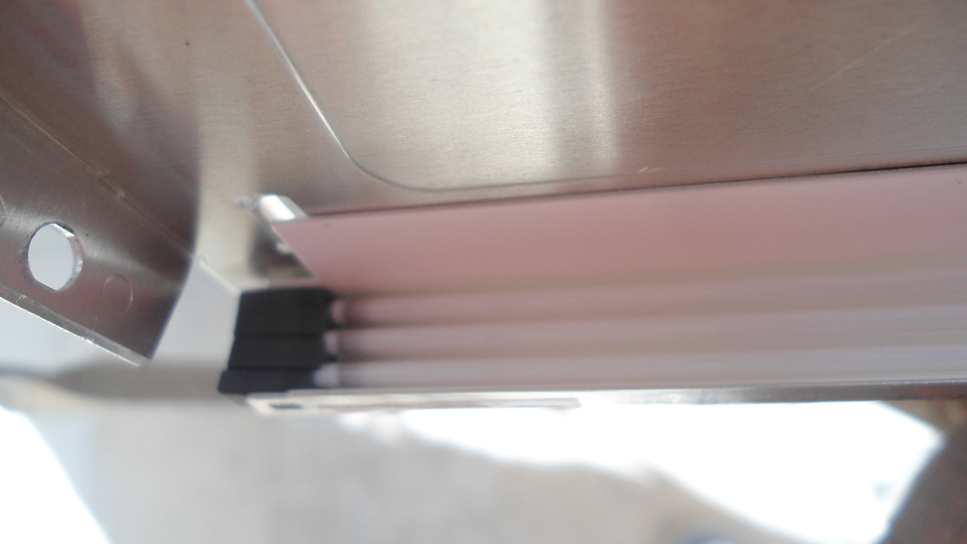

              new pictures of lamps
                Yes i think your problem is the lamps, but 26 posts and you have still not done the "pointed lamp" test, that is the one that says 100% if the backlight is faulty. Oddly the lamps don't look so bad to let the screen never visible in the first seconds, anyway if i propose you to disable the protection for test or trim it to let you use the same lamps further we don't exit more so i think you have to do the "pointed lamp" and eventually change lamps and hope. changing lamps may involve to solder new ones to the old cables and is not so an easy job..
