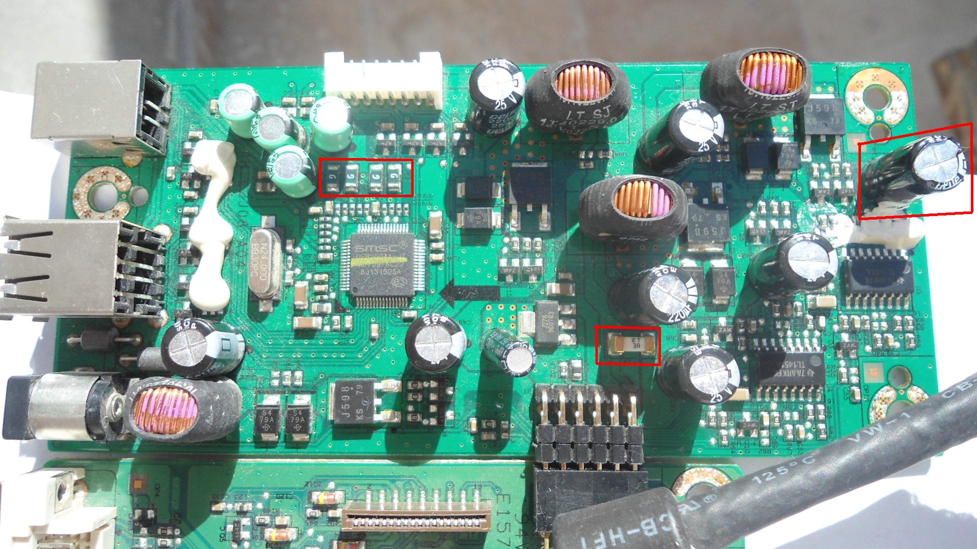

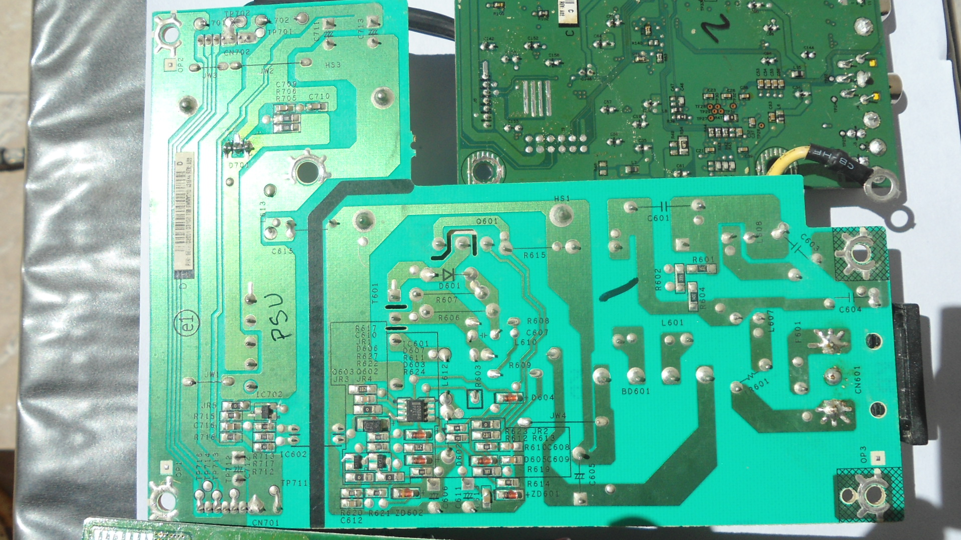

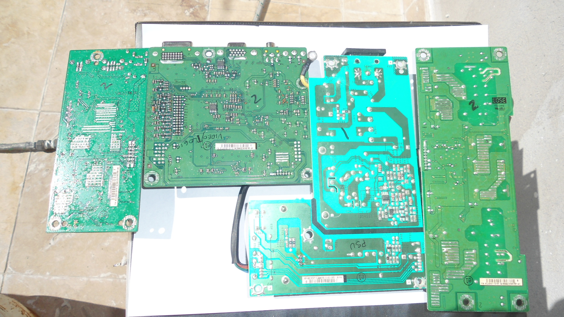

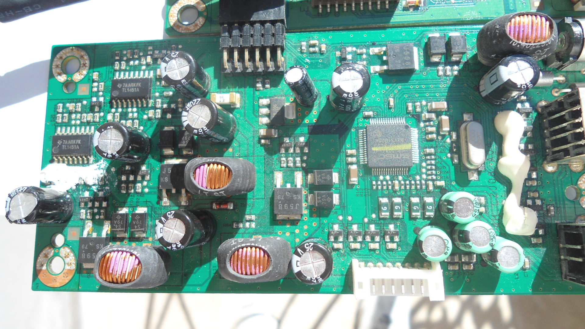

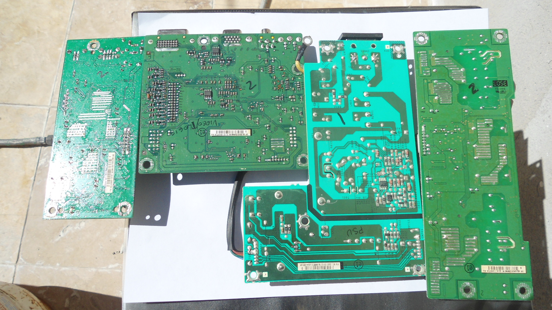

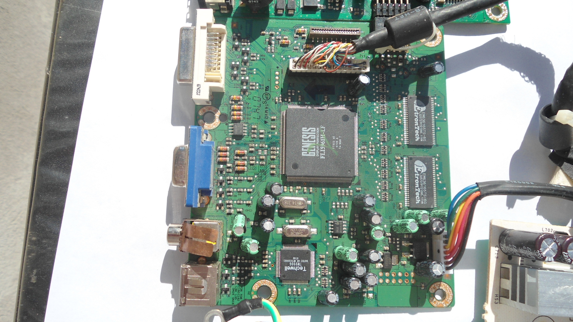

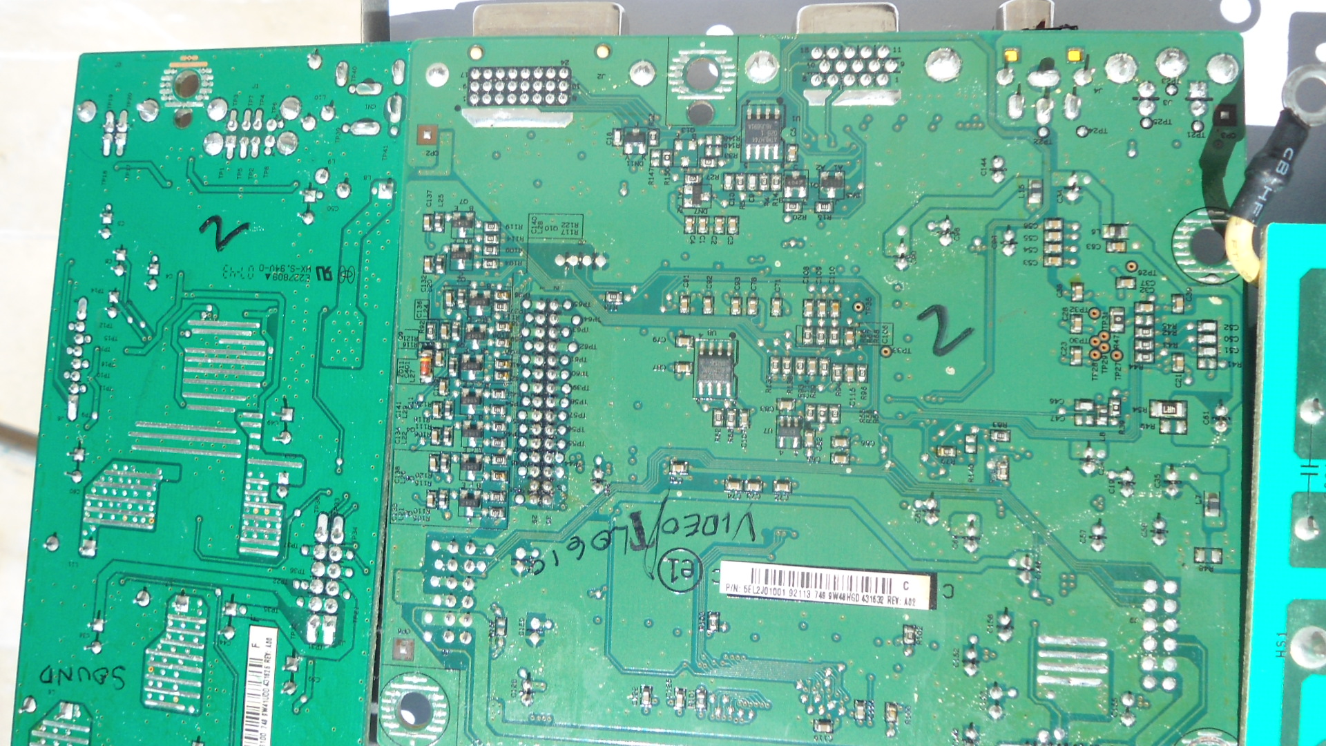

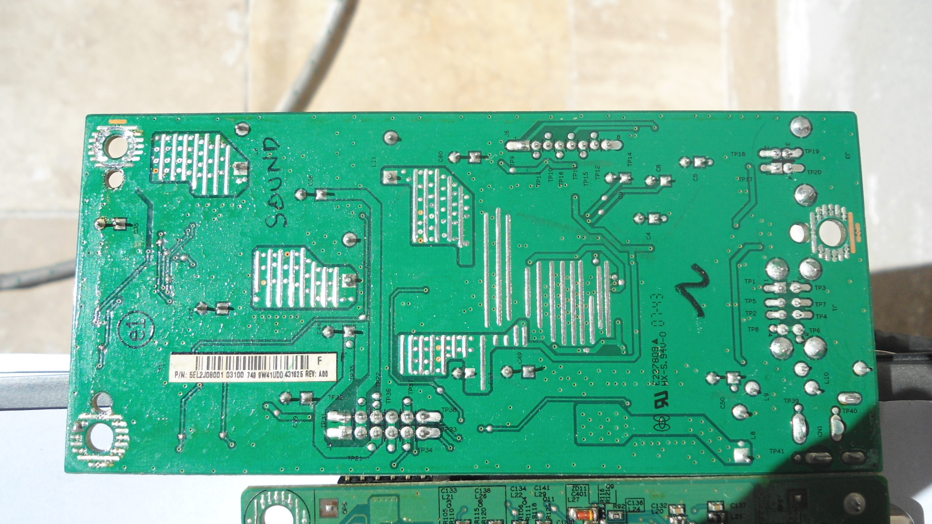

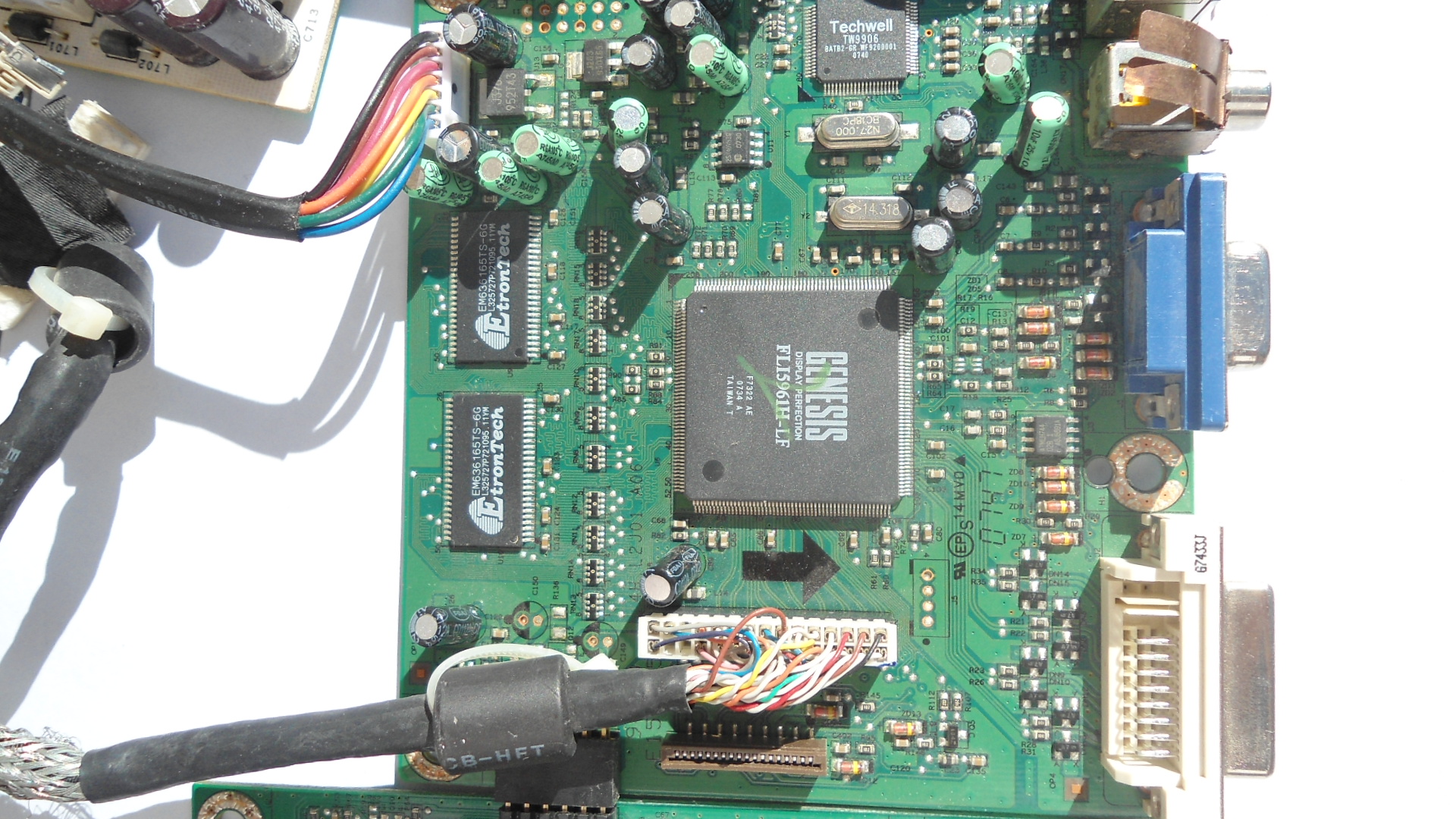

    i have this dell 2007 WFPb monitor that has a blue power on light,what it seems a dim backlight,i have to turn the lights off in my room and bench to see it,is kind of reddish color (i think,then again i know nothing about monitors, except for what i have been reading on the posts from other people)
    i took it apart ,the boards are out and i am enclosing pictures of it,which i hope are good enough to see a possible problem.i have a FLUKE 79 series 2 multimeter,solder sucker,solder wick,and a 35 watt soldering iron.
    the problem is since i dont know about monitors i dont know where to start.
    thanks top those that have replied to my post which i havent replied with their request ,but being new to this i had not been able to start a new thread,but,it looks like i finally did.i am going to have to post the pictures in a little while my camera has a ead battery,it will take a little while to charge.
    meanwhile ,what can you guys recommendi start checking.?
    thank you

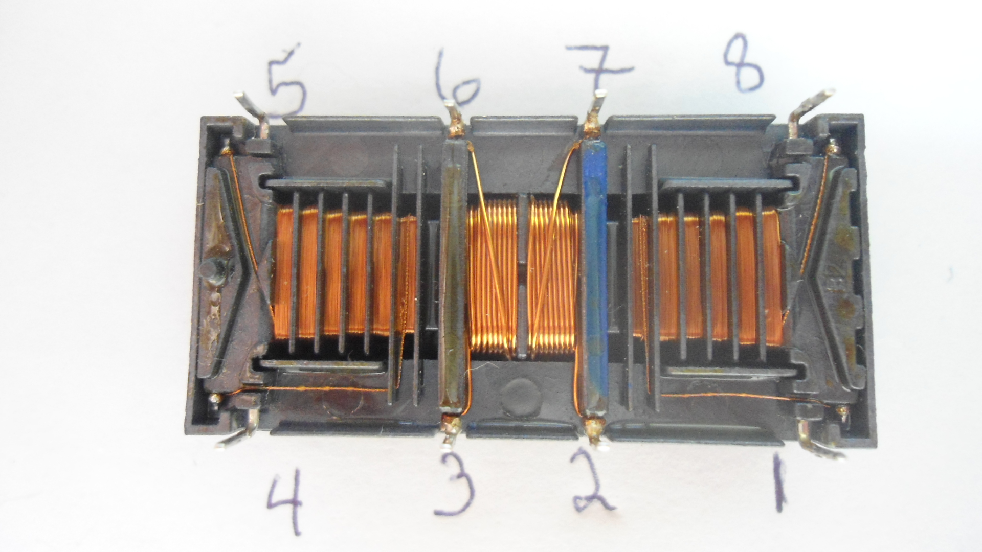

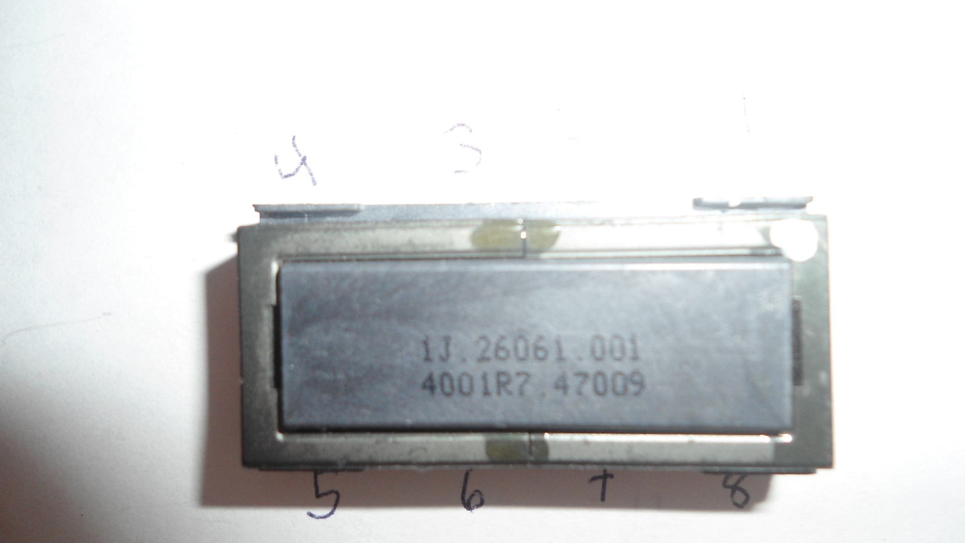

    While you have the inverter board out for pictures you can test the 3 inverter transformers
    Measure the resistance between pins 1-8 and 4-5 for all 3 transformers. You should have 6 readings. Post your results. They should be within 3% of each other. I expect readings in the 1023 ohm range.

      thank you selldoor,here are the readings;
      T801 pins 1to 8 =1060 pins 4 to 5 =1067
      T802 pins 1 to 8=1076 pins 4 to 5 =1081
      T803 pins 1 to 8=1065 pins 4 to 5 =1068

        They look good. Do you get any bright flash from the screen at all when you turn it on or is it dark all the time.
        Does the power led stay the same color all the time?
        You say you can see a reddish light but when connected to a pc can you see an image of what the pc is producing.

          the screen its dark all the time,the led its blue always,that redish light its there when connected to a pc,it does go out after maybe 3 seconds ,kind of acts like if it didnt have a signal,by the way did you see the pictures i posted ,i attached them to the same post with the ohms reading,i edit it.

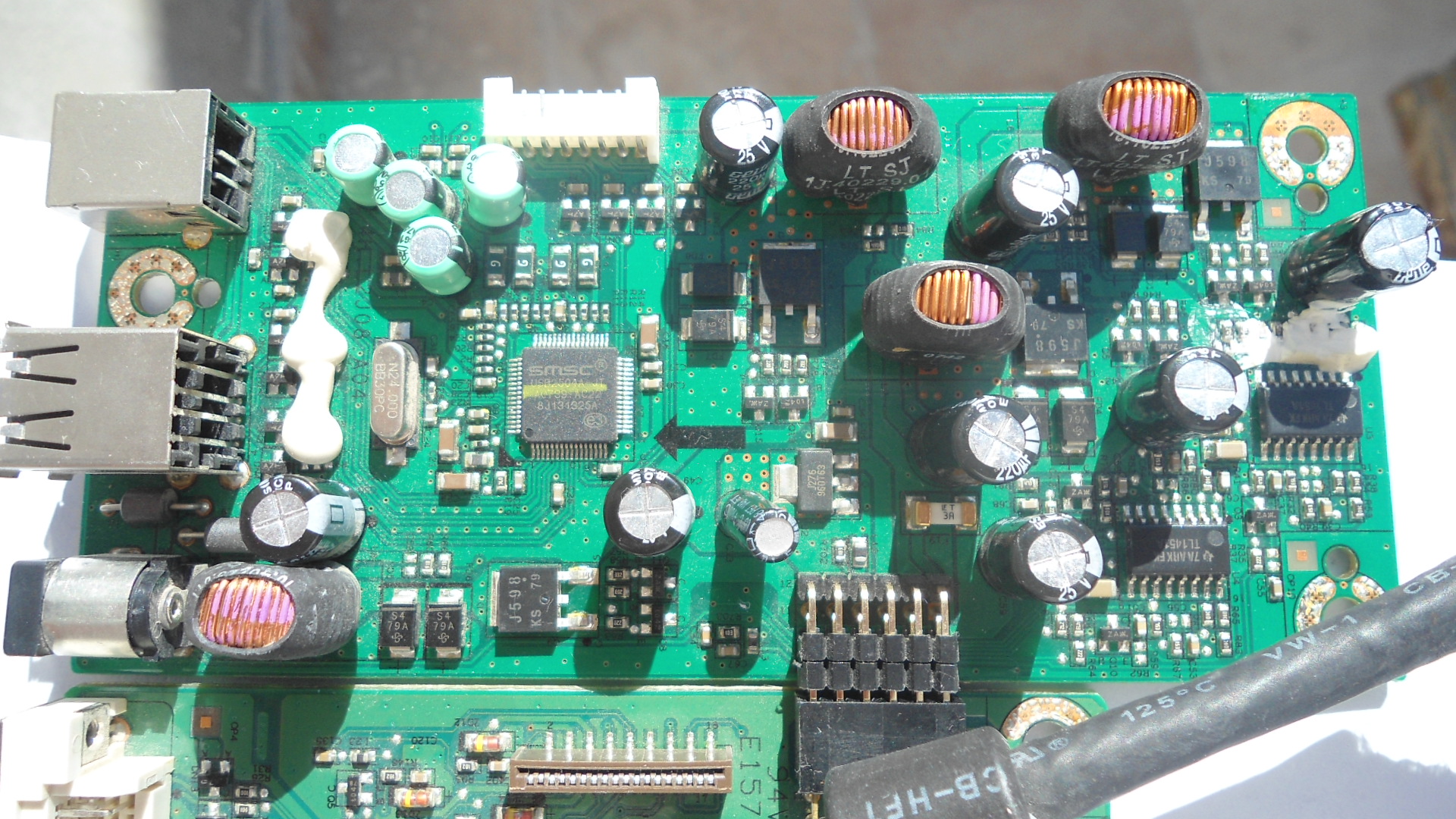

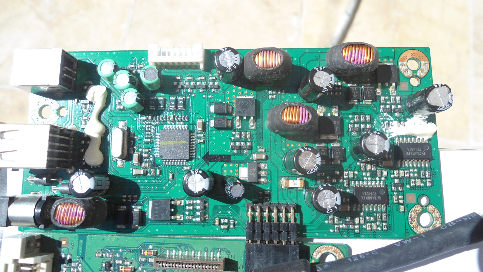

            I have seen the pictures now - thank-you. Its getting late here so just a couple of quick tests on the power supply - BUT not powered can you test the fuses.
            Meter on ohms 200 should read the same as touching the probes together.
            There is a white one and four small perhaps green ones with a G on.
            Also one cap looks crushed - is it just the casing or is it damaged?

                the fuses check ok,the cap its just the plastic casing ,i checked with the multimeter in ohms anyway and it seems to be charging and discharging ok.
                still trying to unsolder the transformer t801 ,its harder than i thought would be.

                  the screen does not show anything with a pc connected to it .its black
                  the reddish background screen (that i can see only if the room lights are off) comes on right away with a pc connected ,but it turns black after the few seconds.
                  with a pc disconected it does the same thing,in both cases the blue square that says "no analog signal" never shows.and the screen is reddish,after few seconds it goes black
                  maybe tomorrow you can show me how to modify the protection and see if thats it.

                        thank you budm,i am not sure if FP801 ,next to a white ,9 pin connector ,is a fuse, and if its the one you are talking about ,but its good=.1 ohms.
                        i do get .5 ohms readings on pins 3 to 6 and 2 to 7 on all the transformers on the inverter? board,tha one that has the connectors for the lamps,i took T803 out to measure it ,just to make sure it wasnt something else causing that reading and yes its reading .5 ohms on the 2 windings ,which i presume are primary windings,just guessing.
                        anyway,are this readings correct,somewhere i read that the primary windings are mostly around 1.5 ohms,can all 3 transformers be shorted?

                            here is a picture of the transformer with pin outs

                              Not sure what you are doing here or why ??
                              We know the pin out of the transformer - its written on the board.
                              and I already said the transformers look good and I cant see that anyone
                              has said otherwise?
                              If you get it all put back together we can do other tests.
                              EDIT I see now - PLEASE stop posting in the other thread it is meant to be for reference purposes only and is now being cluttered up. Davi P should have known that.
                              Dont think you need worry about the other pins appearing short the primary will be very low ohms when off the board - I have just tested similar one here and get 1ohm. hope you havent damaged it removing it.
