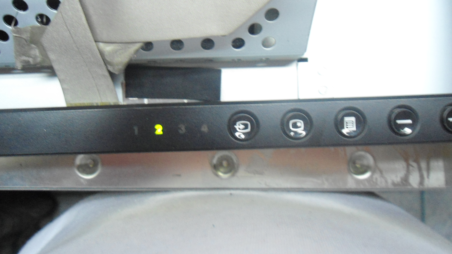

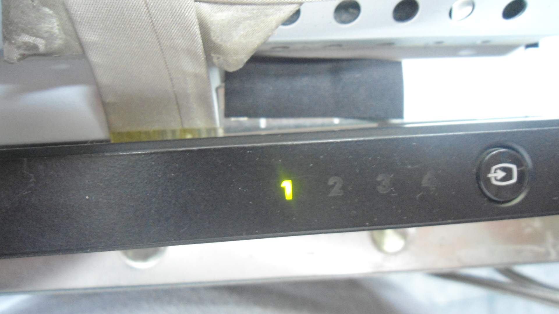

                #87
                Re: dell 2007 WFPb monitor ,no lights
                ok bud,
                i am back ,and i did not find the fuse for the board nor the ones for my meter.so i can not use the current mode on it
                .the meter needs them for the 40 ma and 10 amp scale.
                so,i jumped the fuse on the t.con board and i got no picture yet.just the backlight.
                i did notice that now the numbers on the plastic bezel for the on/off button go to #1 first ,stay on for a second ,then goes to #2 and goes back to 1 and remain there.
                it didnt do that before ,it stayed on 1 all the time.is this some kind of self test ?and what does it check?
                  #88
                  T-CON board may have shorts circuit that is why it blew the fuse, if you disconnect the LVDS cable, then the problem you are see with ON/OFF button will go away that will indicate the T-CON board is loading down the circuit.

                        #91
                        I am not sure about the problem of the LEDS on the front panel. If you do have the 12V at the T-CON but still no pictures on the sceen, then it can be one of the two: the main board is not sending the signals to the T-CON, or the T-CON is dead that was why the fuse blown.

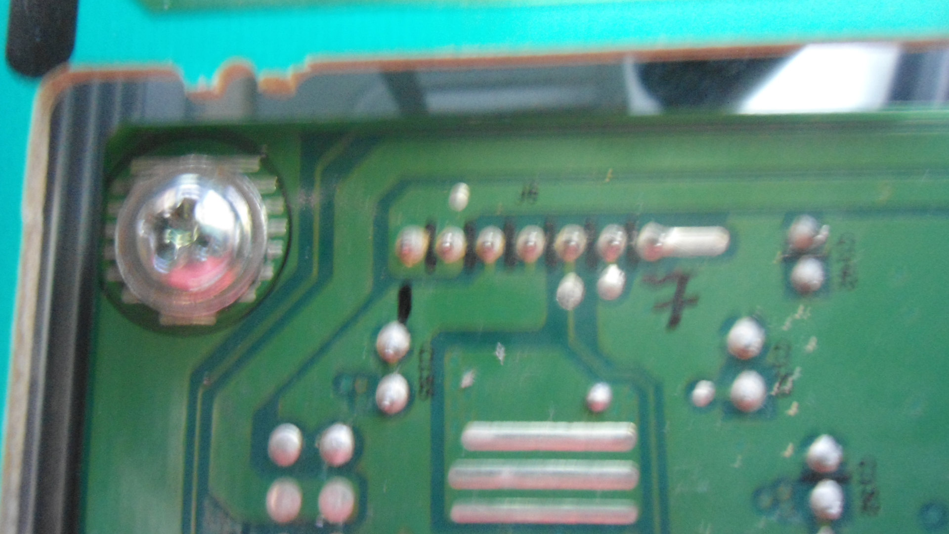

                                      #98
                                      here are the readings and a picture of the board.
                                      readings where taken at the j6 connector ,i labeled them 1 to 7 from left to right ,with the components facing down.
                                      j6-1=19vdc with power off, 19vdc with power on.
                                      j6-2=19vdc with power off, 19vdc with power on
                                      j6-3=0vdc with power off .008vdc with power on
                                      j6-4=0vdc with power off .008vdc with power on
                                      j6-5=0vdc with power off, 3.29vdc with power on
                                      j6-6=2.77vdc with power off,2.77 with power on
                                      j6-7=0vdc with power off, .006 with power on.
                                      • selldoor
                                        Slow Learner
                                        • Dec 2010
                                        • 7870
                                        #99
                                        Sorry whilst that is always useful to know it has little bearing on your problem. I thought you meant signals to the power board but you meant to the tcon.
                                        I dont think you can without an oscilloscope. You can test voltages on the tcon
                                        but that will have to wait until you get a fuse.
