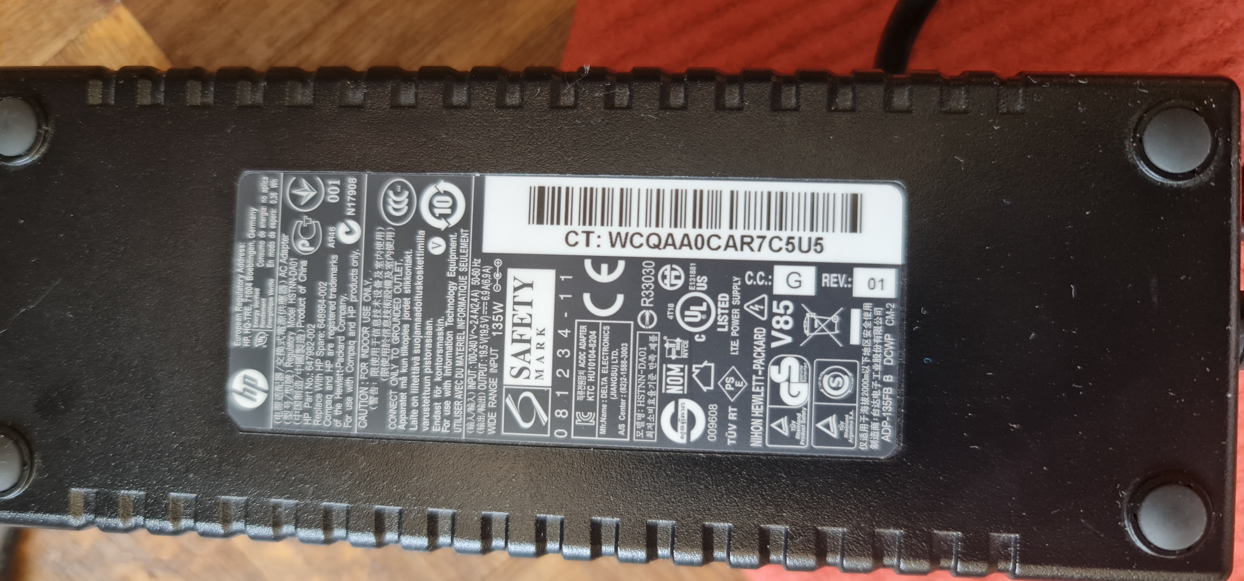

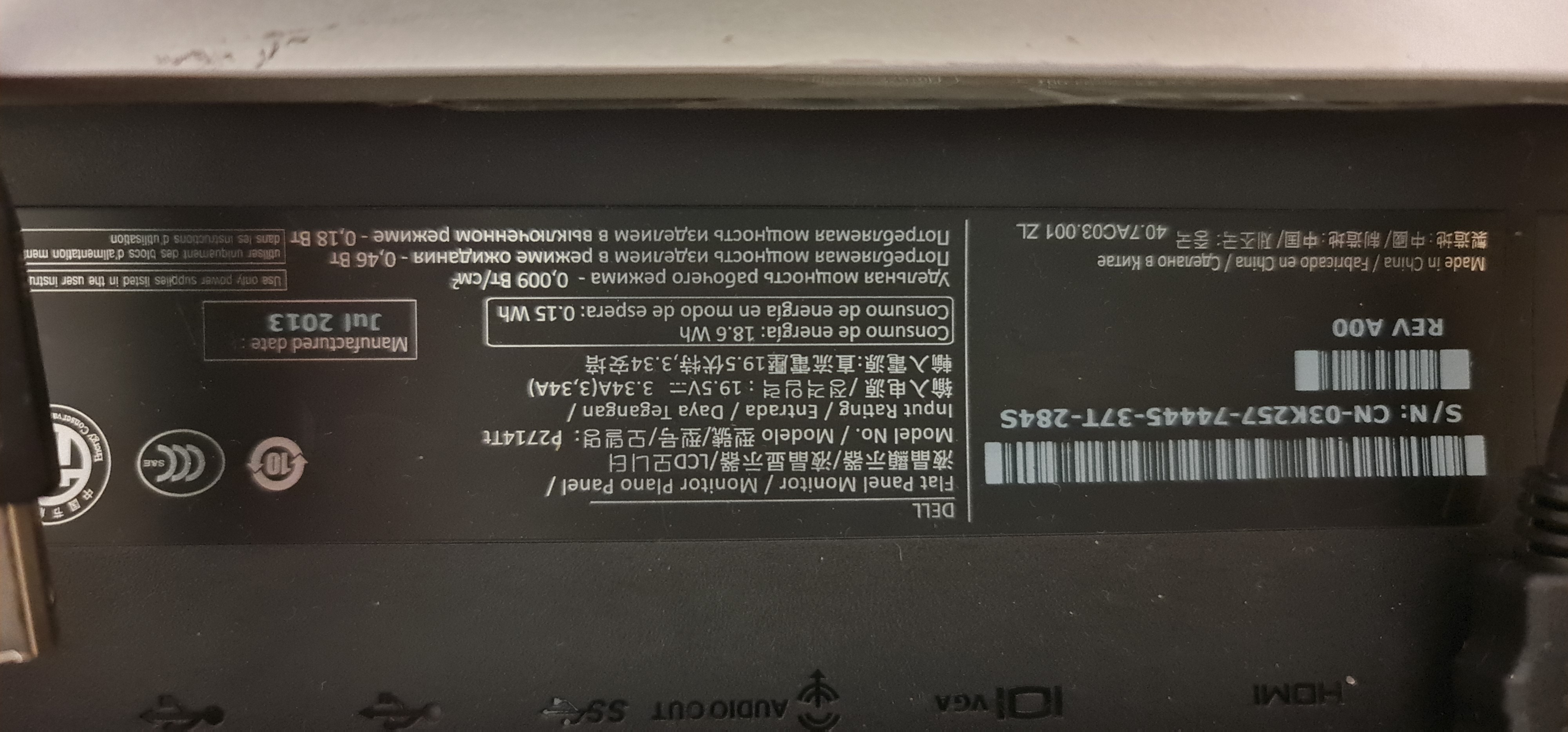

    Hi guys.
    I got myself used Dell 27" touch monitor but I got scammed again, seller sent HP adapter.
    Though voltages are the same, I suppose power supply design is not the same.
    So may I use it without any harm to the monitor?

    That power supply will work ok for that monitor, the power supply can actually supply more current than the original liklely could so I suspect it will out last the monitor.

      The voltage is not the same on the middle pin HP vs Dell.
      • R_J
        • Jun 2012
        • 9560
        Yes it is. The picture you provided of the Dell, input voltage 19.5 vdc, the picture of the HP adaptor, output voltage 19.5 vdc
