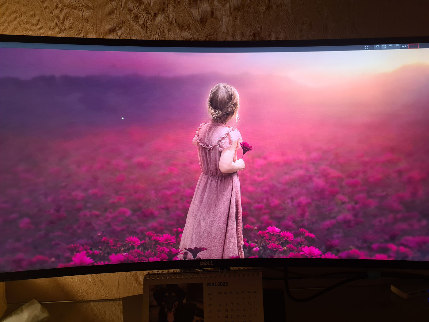

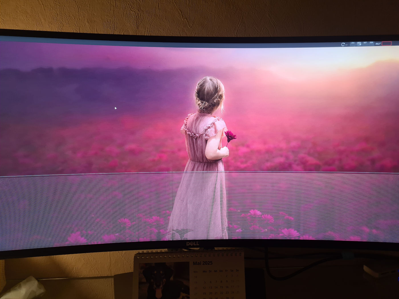

    I have a Dell U3419W Monitor that has some thin stripes on a part of the screen since Tuesday.
    This lines cover about a third of the screen and appear for 2 seconds before disappear for another 2 seconds.
    This repeats the whole time. I have not opened the case yet cause I had no time, but will try to fix it on this weekend. For me, it looks like a problem on the TCon... Am I right?
    Does someone have seen this before?

    Weird for the stripes to appear and disappear every 2 seconds.

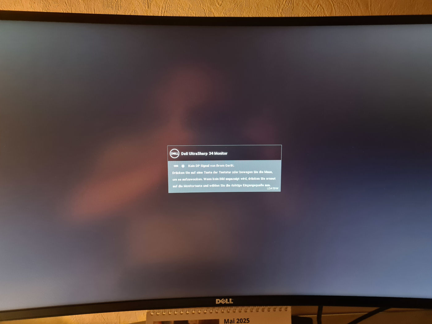

      What I already tried is go through Dells suggestions on their website to solve the problem but no changes.
      I've changed the ports from DP to HDMI and replaced the cables but no changes.
      Tried to reset the Monitor through OSD, change the frequency in Linux and Windows a couple of times with the same result.
      Disconnected the Desktop and used my Laptop as Video Source... everything stayed this same. But if you look at the picture,
      you'll see that the lines appear as soon as the the panel has to display a picture on screen, even if it's a OSD without a connected video source thru HDMI or DP.
      As soon as the screen has a picture to show, the lines appear and disappear in a 2 second cycle.
