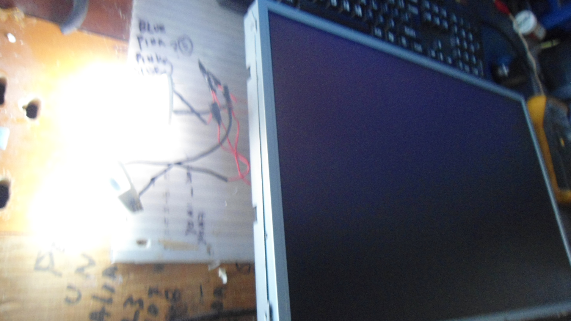

    thank you selldoor,
    yes i made sure there was an image from the cpu,looking at it in the good monitor and then hooking it up to the bad monitor.
    i did an extra test ,just to make sure i had a good working backlight,=.
    i followed a test shown on one of you guys thread and it worked like a charm.
    i am attaching pictures of it.
    i tried it the same way before and i got nothing,zero,zip.

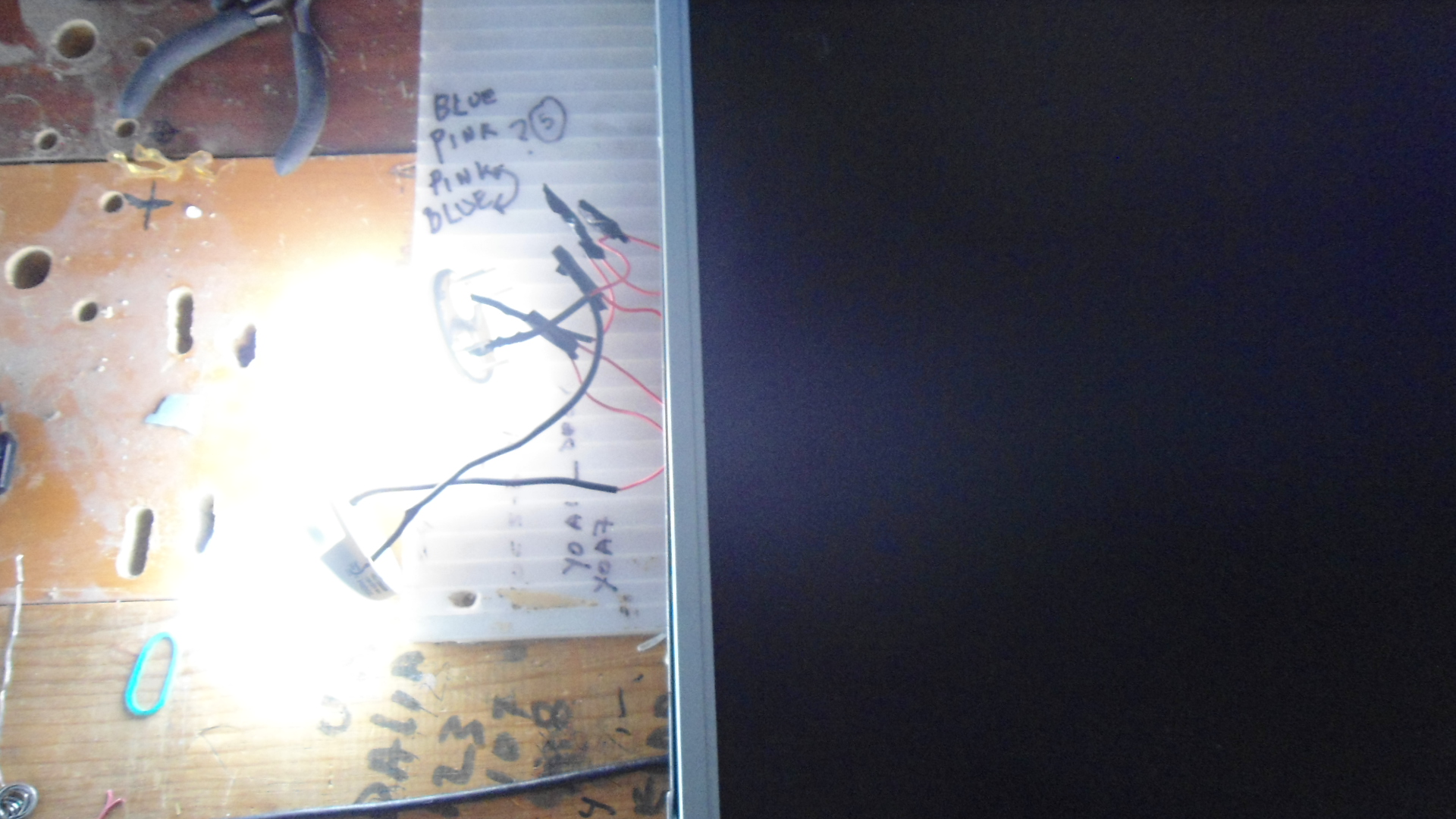

      Re: dell 2007 WFPb monitor ,no lights
      thank you davi
      yes ,i hooked up a cpu with an image and got the same thing.
      i did an extra test ,to make sure the backlight its good.
      and it worked.
      its from one of you guy's thread.
      its 2 lamps connected in place of the lamps from the screen,a 13 watt and a 14 watt,they look bright.

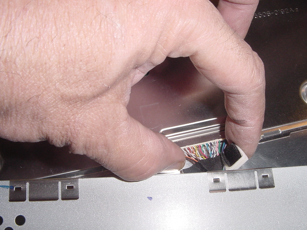

        pardon my ignorance selldoor ,but,what does "lvds"
        mean?
        • aortiz
          • Feb 2014
          • 120
          • mexico
          #64
          and what cables are you talking about?
            #65
            The cable between the main board and the LCD panel.

                    the lamps i use to test the backlight are bright ,and that is why you can not see them.
                    but that does not matter right now.
                    i am sure now that we have the voltages we need to have a good backlight.i didnt have them before .
                    in one of the test points i had 0v,and after i did the replacement of the cap then i had 3.3 volts there and that is when i had a steady backlight.
                    i soldered 2 outside lamps to confirm and make sure the backlight voltages were all there and the lights are bright ,the tape is so i can connect and remove the lamps quickly,and so i dont touch the wires and they dont short out to the chassis or any part of the unit.
