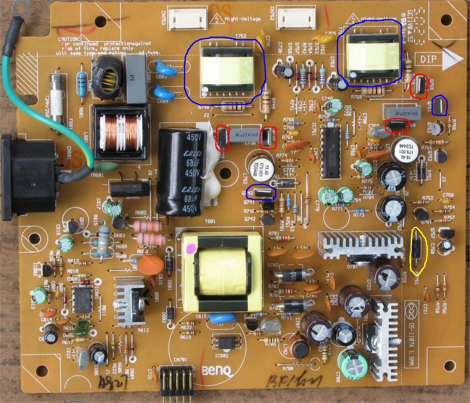

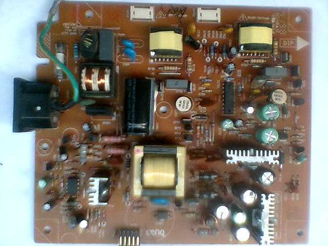

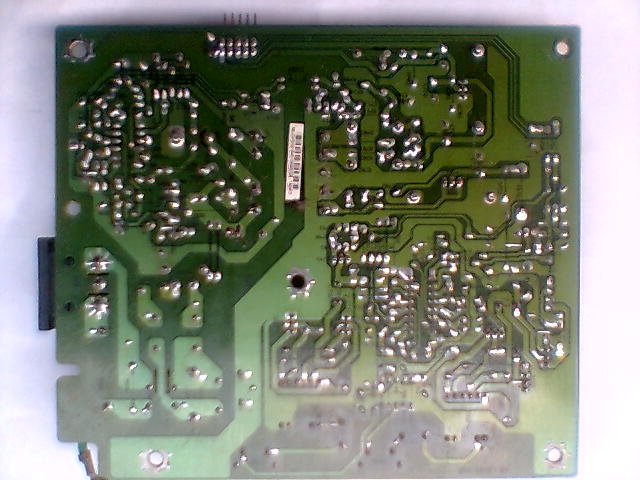

              Here is the board picture
                Re: Dell E153FPB Back Light problem
                Seems obvious to me, between reading the rest of this thread, the fact that if you whack the monitor it comes on, and from that (not terribly good) picture.
                BAD SOLDER JOINTS
                36 Monitors, 3 TVs, 4 Laptops, 1 motherboard, 1 Printer, 1 iMac, 2 hard drive docks and one IP Phone repaired so far....
                  Good grief, couldn't you make it smaller? Fortunately I was able to match it to a real picture.
                  Large blue circles - transformers with bad solder joints. Remove as much solder as possible from the pins and resolder
                  Red circles - bipolar transistors (2SC5706 or 5707). Test and replace both if either transistor in a pair is shorted.
                  Small blue circles - FET transistors, one for each pair of bipolar transistors. Sometimes fail when the bipolar transistors fail. Test and replace if shorted.
                  Yellow circle. Picofuse. Test and replace if open.
                  PlainBill

                        Hello, thanks i solved the problem by just entirety de-soldering the two transformers you mentioned and re-soldering them again.
