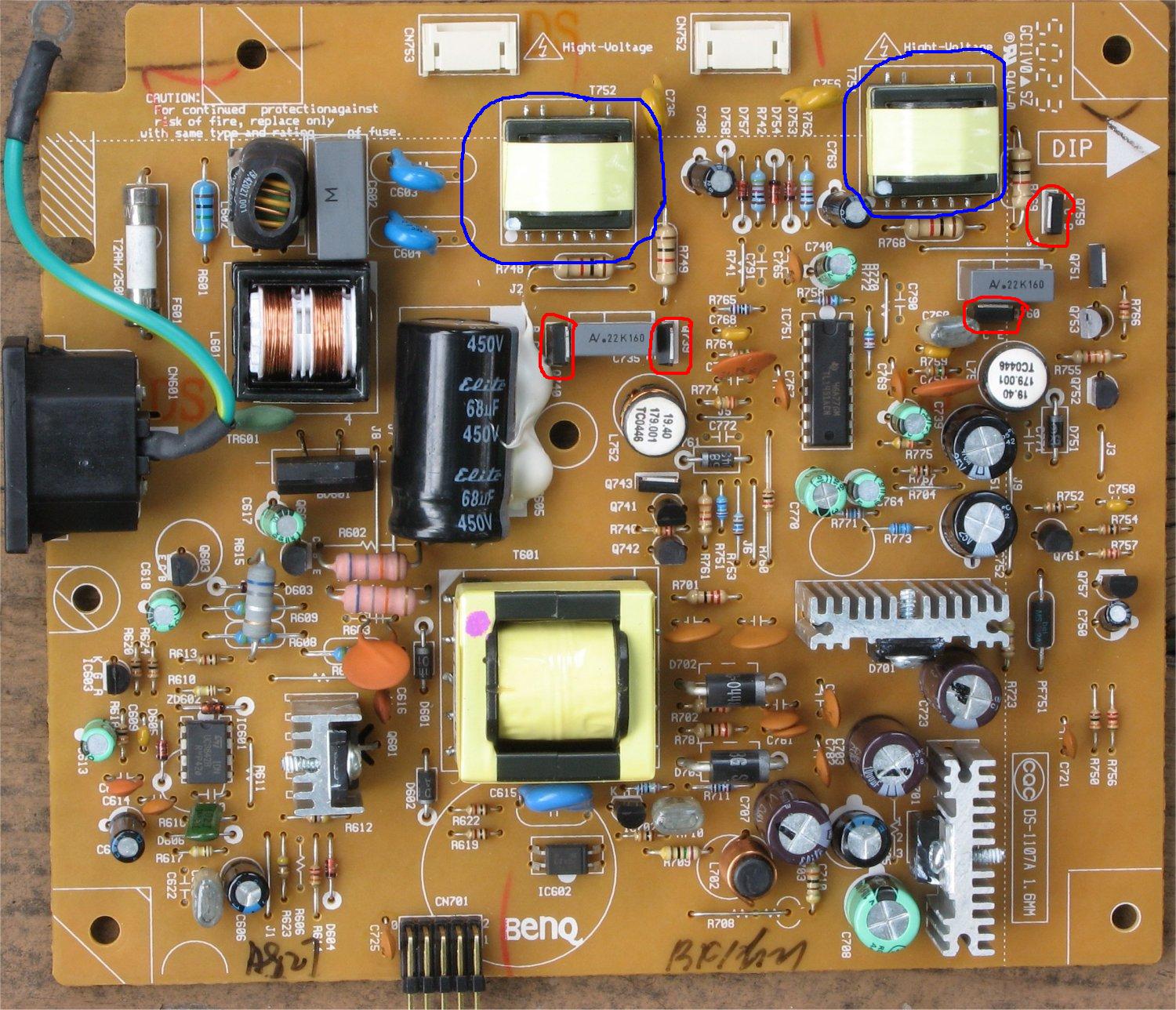

                      I justy replaced the Pico Fuse again and its working again. What would cause the Pico Fuse to keep burning out? Please be very descriptive about location and part description as Im just a beginner board level repair newbie.
                        Probably a leaky transistor. Provide GOOD pictures of the inverter board and we can identify twhat to test.

                          ok will do, the picture is attached of the Inverter Board.
                            Great picture!! I've marked it up. The four transistors circled in red should be checked with an ohmmeter. We are looking for differences between one pair and the other.
                            Also, two transformers were circled in blue. Resolder the leads on all of them.

                                If I want to order the 4 transistors on Inverter = Q739, Q740, Q759, Q760
                                for replacement, what would I ask for?
                                  They are either C5707s or 6s
                                  Read the front of one, (you may need magnifying glass)
                                  You can replace 7s with 6s if doing all four, but there are plenty of both on ebay (type in search box 2SC5607)
                                  You can get kits with 4 transistors + 2 fets fu9024n and a 2 or 3 amp p/fuse
