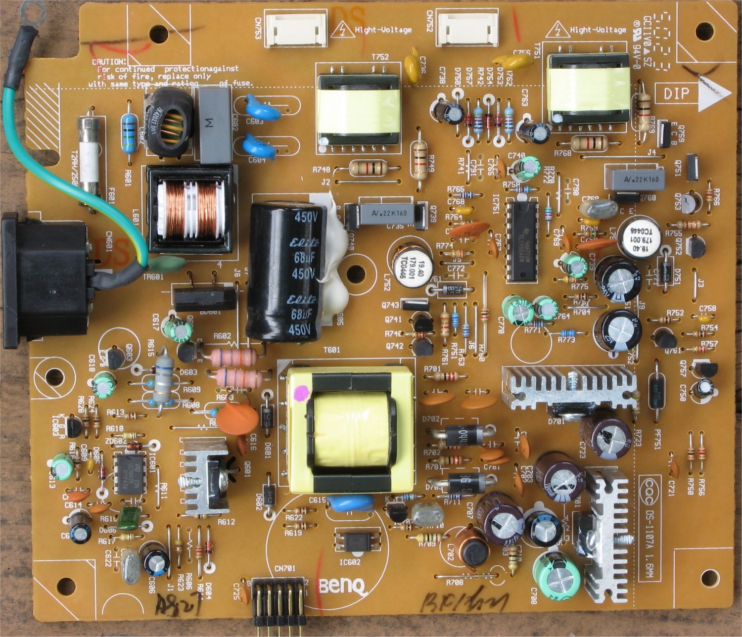

                            So I read pretty much the entire thread and im afraid im still not sure where to start. I have the Dell E153FPB. When i turn on the LCD screen it flashes white for a second and then goes black. I cannot see any image on the screen but the LED power light stays on.
                            I tested the fuse PF751 with an ohm meter and it has resistance, so im thinking its not that.
                            I also flipped the board over and didnt see any cold solder joints, fixed a couple that were debatable.
                            Sorry if this is a double post. I couldnt look any longer lol

                              Used a flashlight to see if the panel is on and image is displayed (you would not see it clearly if the CCFLs are off but if you don't have an image, it's not the inverter or tubes.
                              Post series/brand/capacitance of caps, and test each of the four c5707s in there.

                                    Start with post 31 of this thread and follow the same advice.
