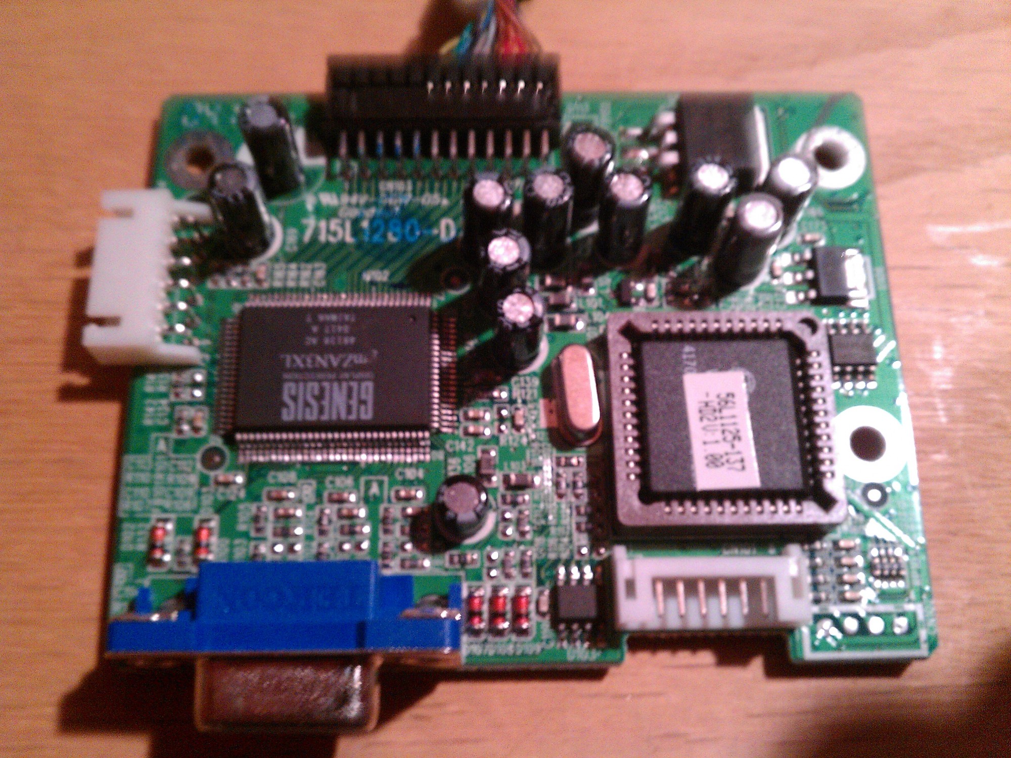

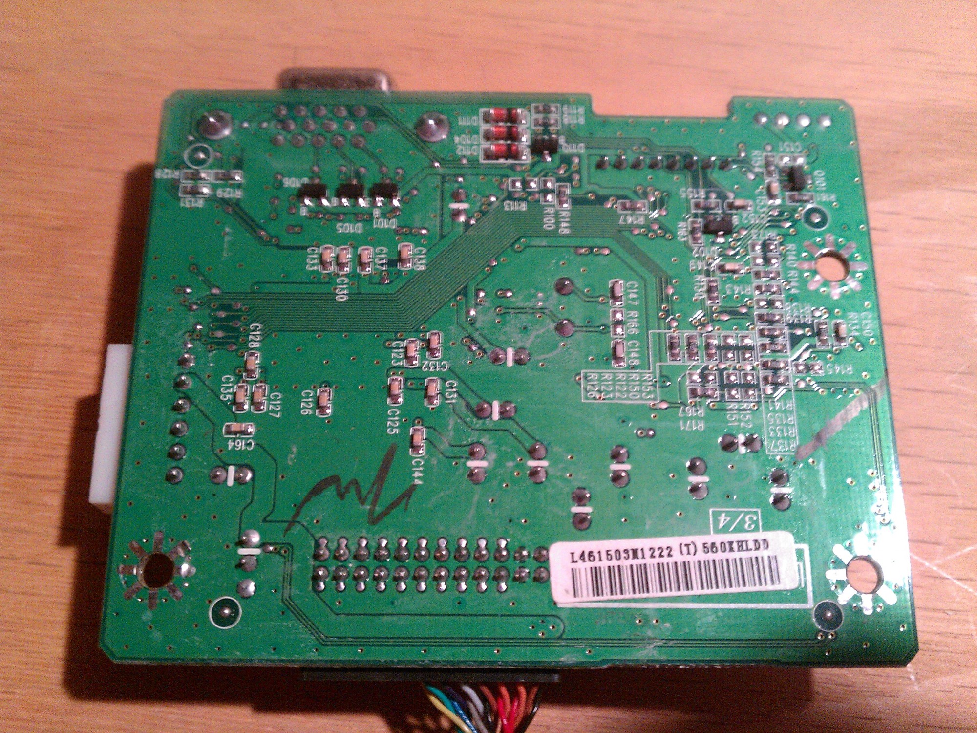

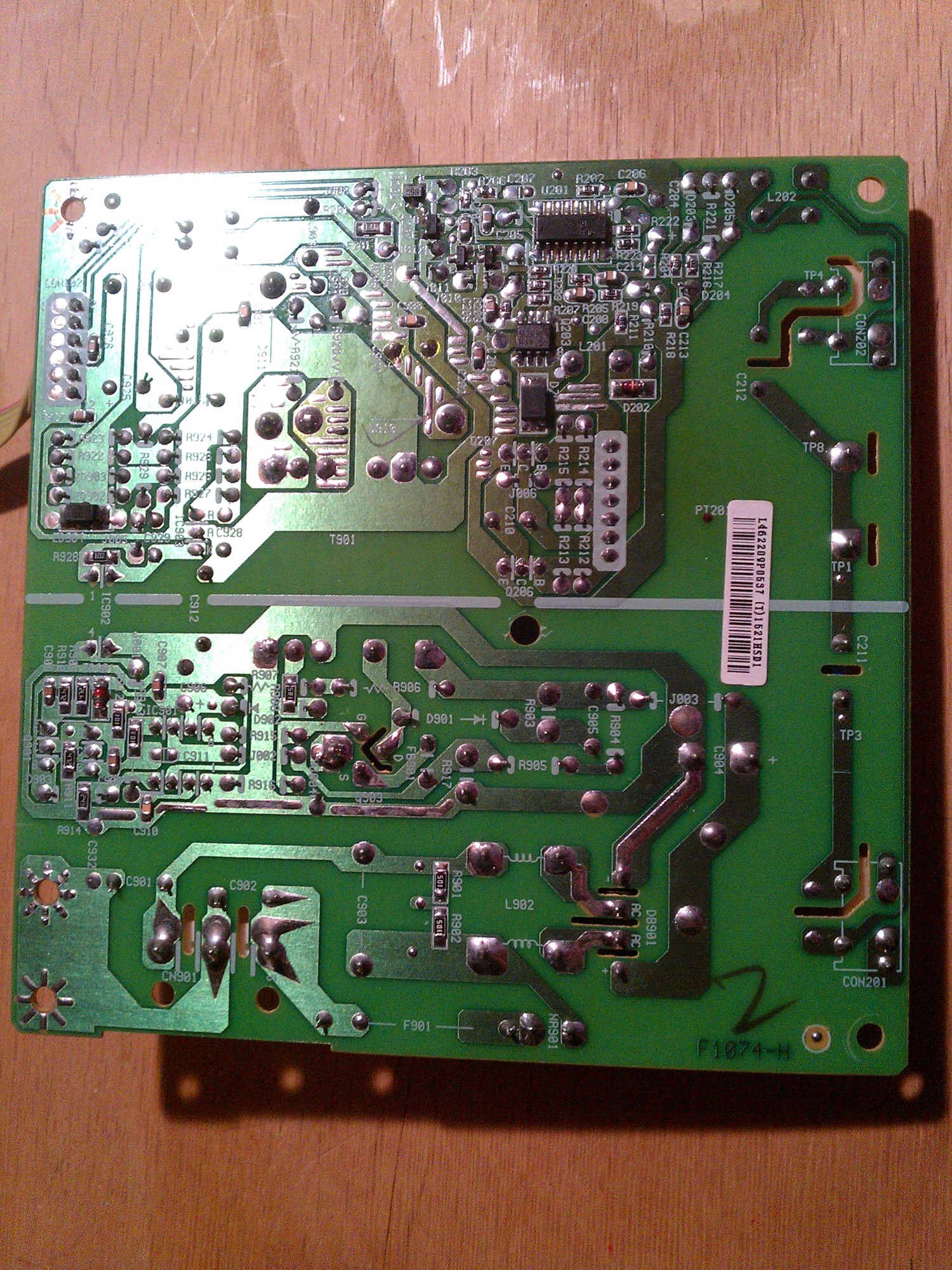

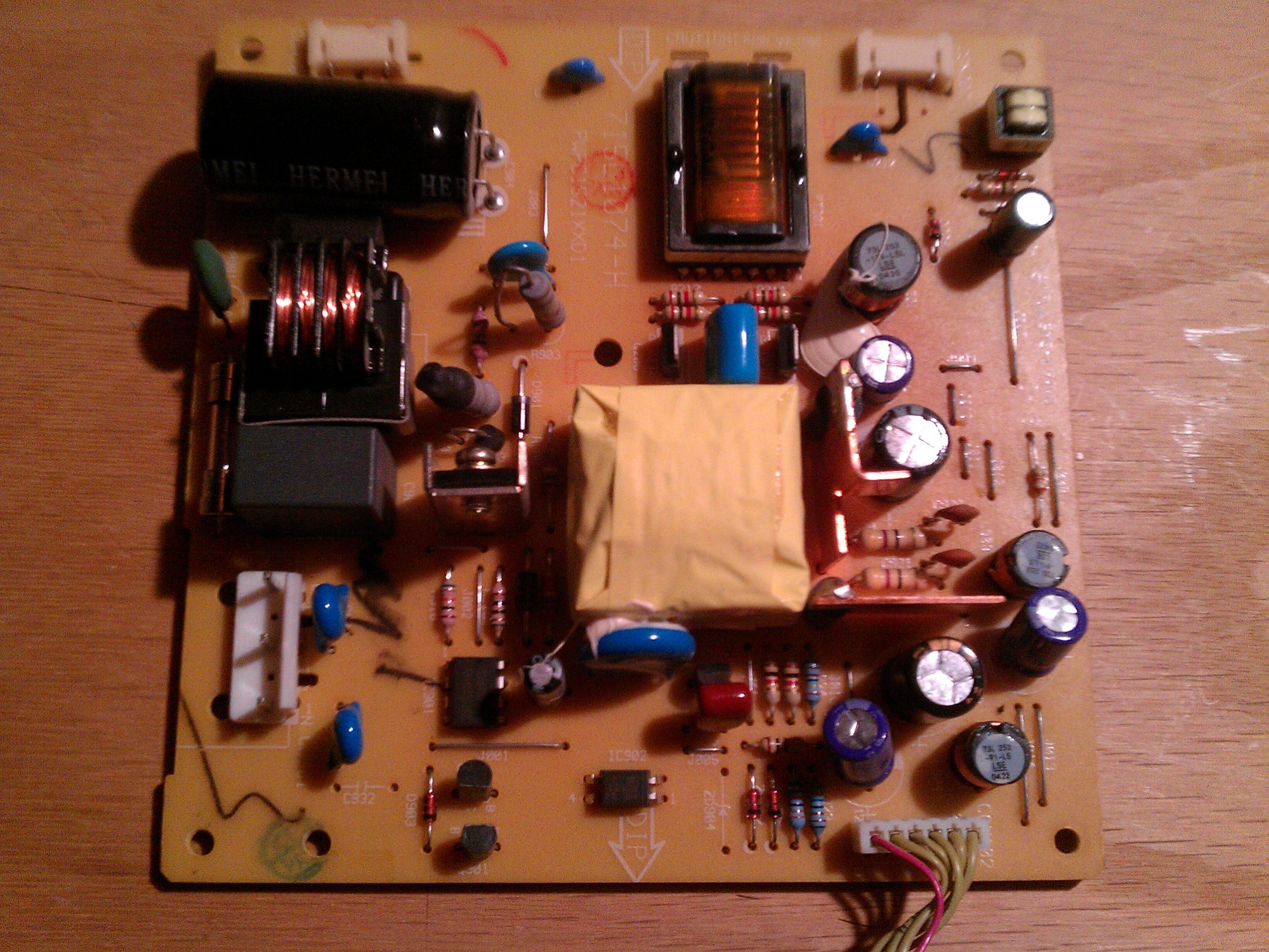

                                    Re: Dell E153FPB Back Light problem
                                    Okay, Here are some pictures. I took a bunch and these are the best. Hope they work. I had to resize them, I hope I didn't lose too much quality.
                                      There are 2 voltage regulators on the main/logic board.
                                      1) List the part numbers off the chip.
                                      2) With your multimeter, measure the DC voltage of each pin with respect to ground.
                                      3) When the problem occurs, re-measure the DC voltage on each pin.
                                      4) When the problem occurs, also measure the DC voltage of each connector pin between the power and logic board (yellow/red cable).
                                      We are looking for any fluctuation in DC voltage to see if this is causing the monitor to flicker.
                                        Okay, I got the measurements. I apologize. I didn't mean for it to that long, something came up.
                                        Anyways the numbers on the chips are:
                                        AIC 1084-33CM 584G3 (larger one) PDF Datasheet
                                        BS18532G3 (smaller one) Maybe the end is 63? I couldn't find any information on this chip.
                                        The first chip, (1084-33CM)
                                        0v --- GND
                                        3.26v --- Vout
                                        4.69 --- Vin
                                        The second, (BS18532G3)
                                        0v ---
                                        1.77v ---
                                        3.24v ---
                                        I think these are okay after looking at the datasheet.
