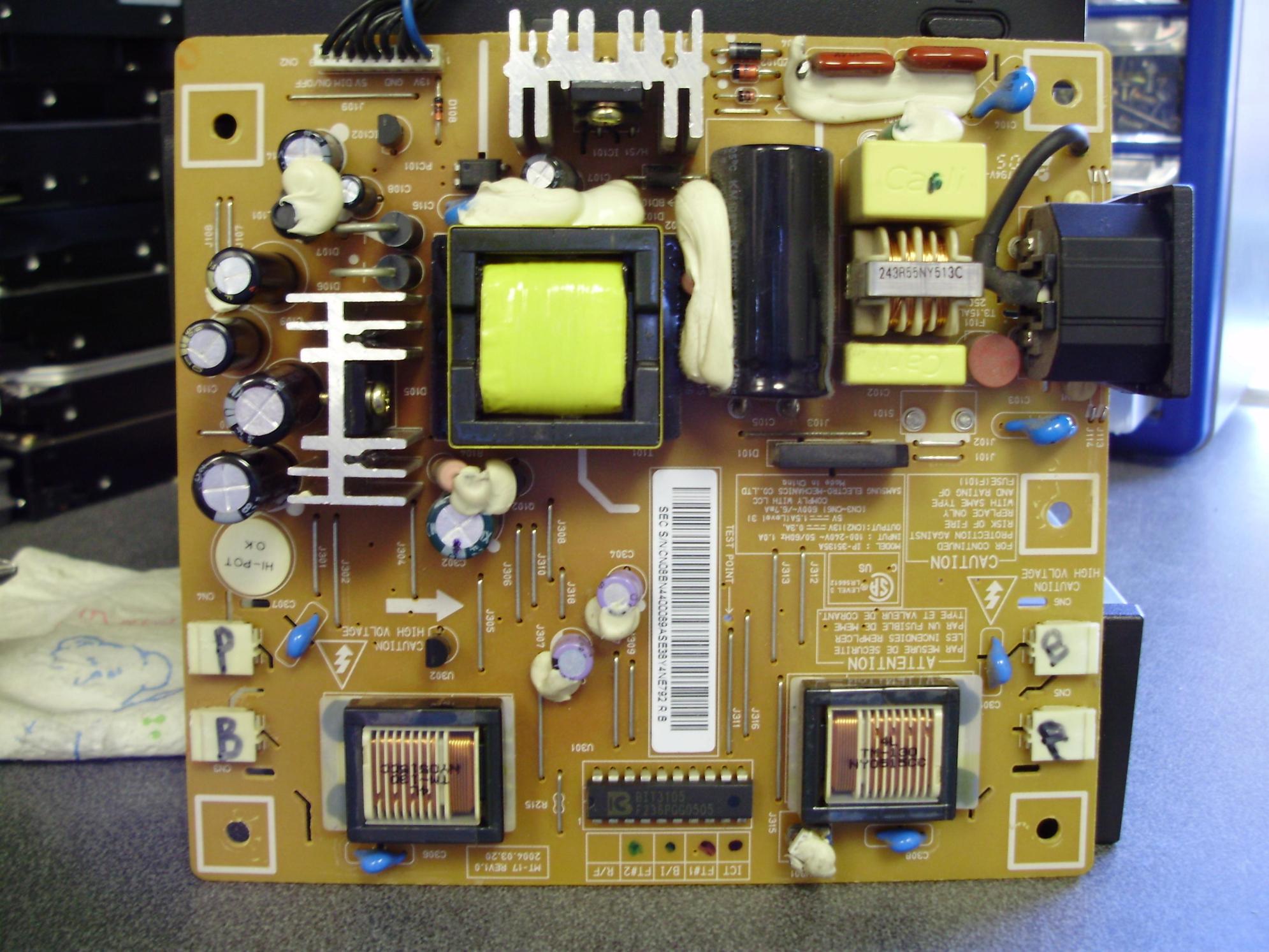

                  I have a Dell E173FPs. Symptoms: Green power light just flashes quickly. No picture at all. I found 2 swollen caps and replaced them, still same thing. Green light just flashes quickly. The Power and Inverter board is model # IP-35135A (photo attached.) Anyone have any ideas what may cause this? I am looking for cold solder joints in the meantime. I have found it a good idea to just go ahead and resolder the transformers anyway as cold solder joints are so common. Srry if this is considered hijacking the thread.
                    #49
                    Re: Dell E153FPB Back Light problem
                    Suspect shorted transistors in the inverter. A picture (larger if possible) of the bottom of the board will help us identify them. I'm curious, please post the picture even if you locate them yourself.

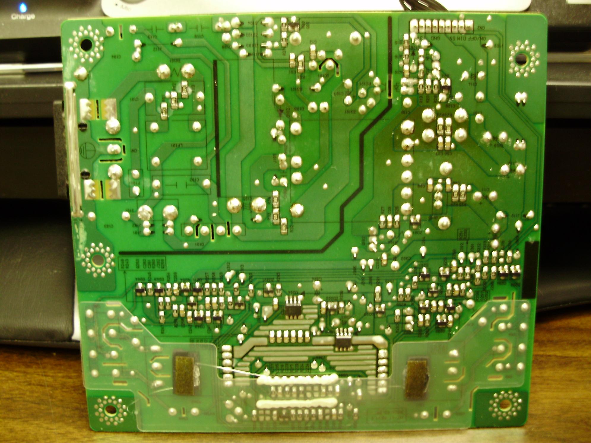

                                  I've edited the picture of the bottom of the power supply. The first step is to measure the output voltage. The red lead of your meter goes to the pins at the upper right I've circled in red, the black to the pins circled in black. This should be done with the power supply hooked to the logic board of the monitor. It may be easier to probe from the top.
                                  I also circled two ICs in blue. If these were shorted it could cause the problem. What is the part number of the ICs?
                                  PlainBill
                                    #57
                                    Voltages are solid 10 volts testing each pos with all 3 neg. Same 10 volts on all.
                                    Numbers on IC's are the same. Each has 4501GM and S05034 (might be 505034, hard to tell they are so small)
                                      #58
                                      I did not have the bulbs hooked up when testing voltage incase that makes a difference but it was hooked to the logic board.
                                        #59
                                        10 volts is a problem. It should be 5 volts. If you were using an analog meter it might be on the wrong range (user error), but if it's a digital meter and set on the 20 volt range, that's an accurate reading. 10 volts may have fried the logic board. BIG trouble.
