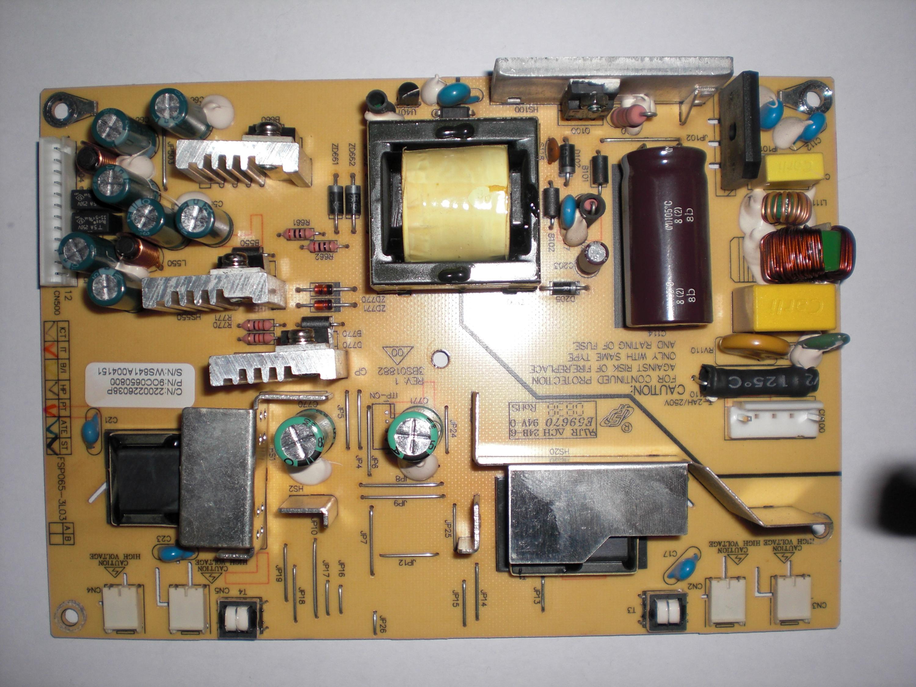

    Hi guys,

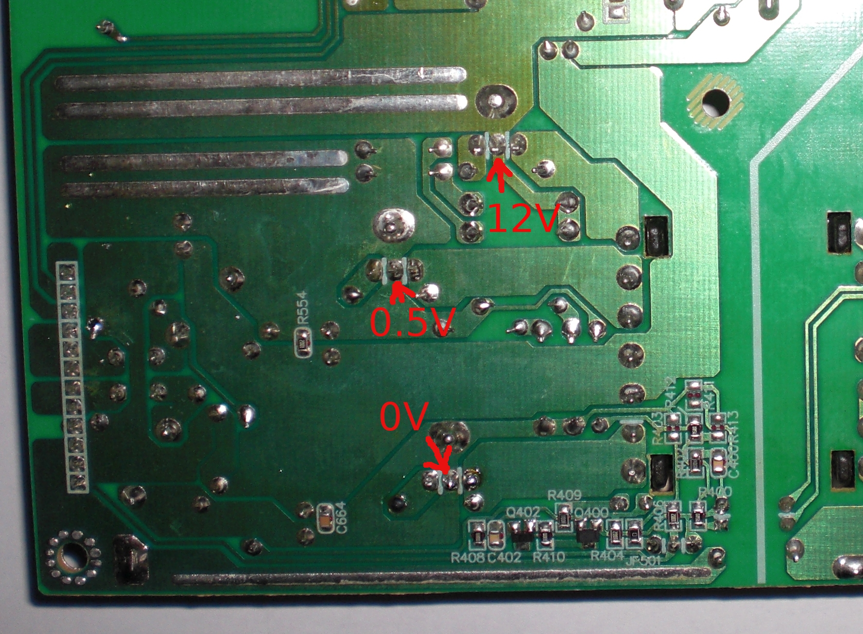

    yesterday my screen suddenly turned off. Tried to bring it up again, no chance. Power LED stayed off. Today I disassembled the screen and measured some voltages without load.
    Fuse is ok, AC line is ok. No burned parts, no cold solder joints. But I can only measure 0.5V at the output to the controller board.
    Any suggestions which part could be broken?

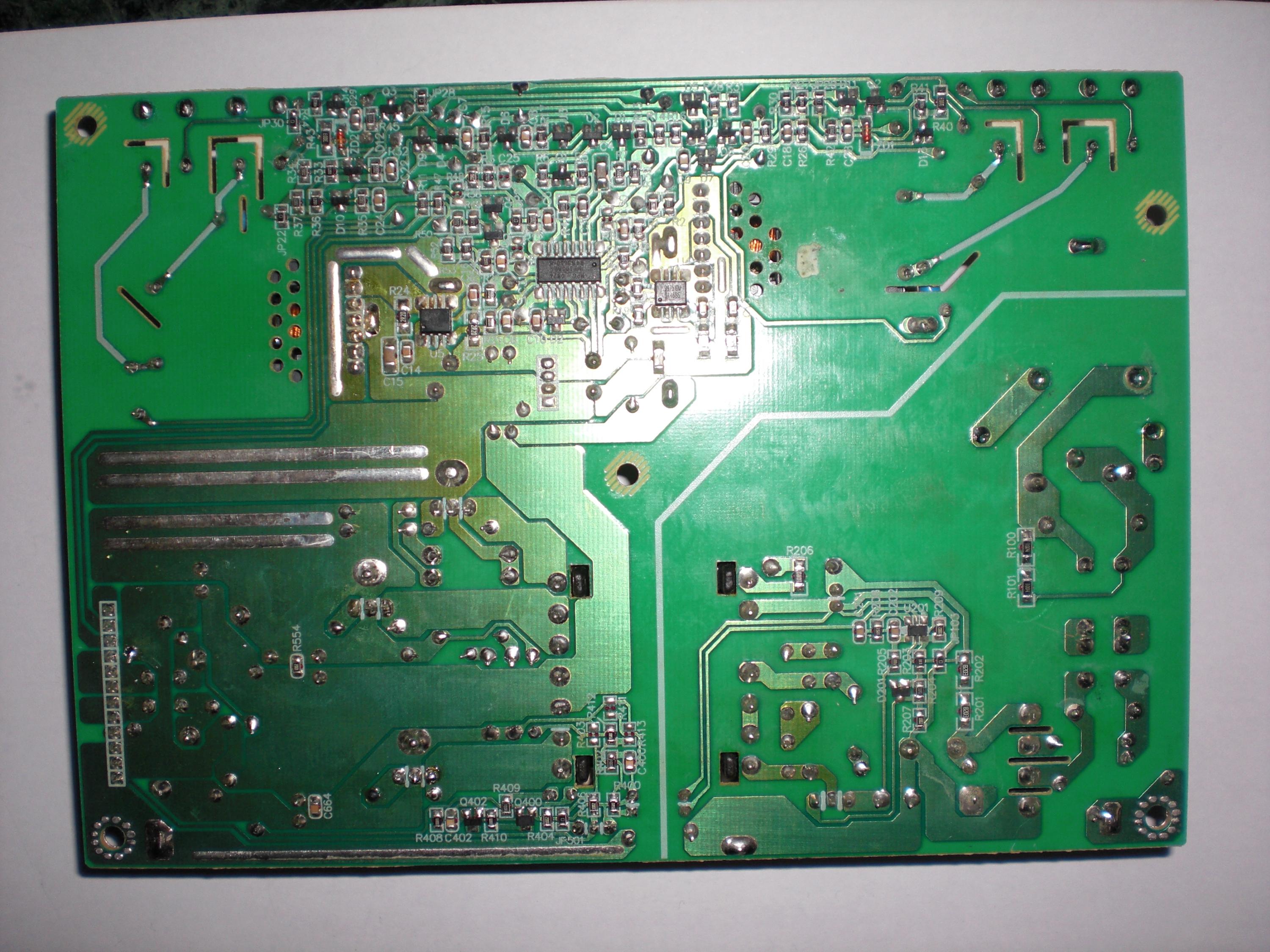

      pictures of each board, front and back (in the same orientation) and close up of connectors, (max resolution 2000x2000 and 2MB) using the manage attachments button, which is found by clicking "go advanced" under quick reply.

            On the upper left of your first photo, next to the white connector, there are two 5A fuses. Check them for continuity.
            • formatthias
              • Dec 2012
              • 23
              Re: Iiyama 2607WS suddenly dead
              Both are ok.
                OK, do you see the diodes on the heatsinks, near the fuses?
                Check if any have shorts between the pins -- check pins 1-2, 2-3, and 1-3.

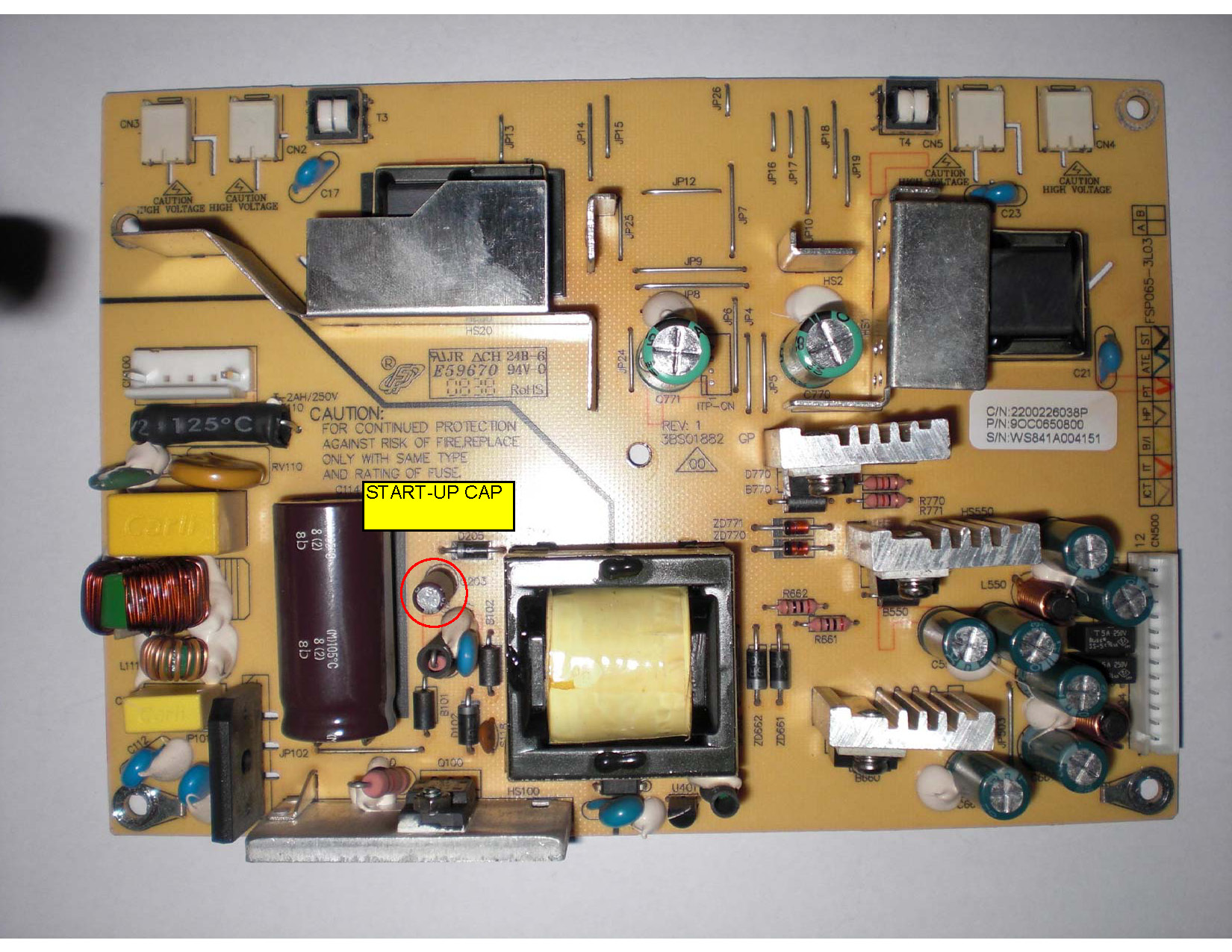

                    What DC voltage do you get on that large brown cap measuring right at the two legs?

                      Thanks. Ok, now I measured the diodes on the heatsinks. The upper two have continuity in both directions.
                        The large brown cap holds 320V DC.

                          At this point, I suggest measuring the voltage of each pin at the white connector. If you continue to see 0V, then I'd conentrate on Q100. It appears to be a PWM controller and switching mosfet all in one package.

                                    OK, let see if you actuall has shorted circuits at the Cathode of the secondary side power supply rectifier Diodes. Also try heating up the startup cap to see if it will startup if there is no shortes found on the secondary side.
                                    • formatthias
                                      • Dec 2012
                                      • 23

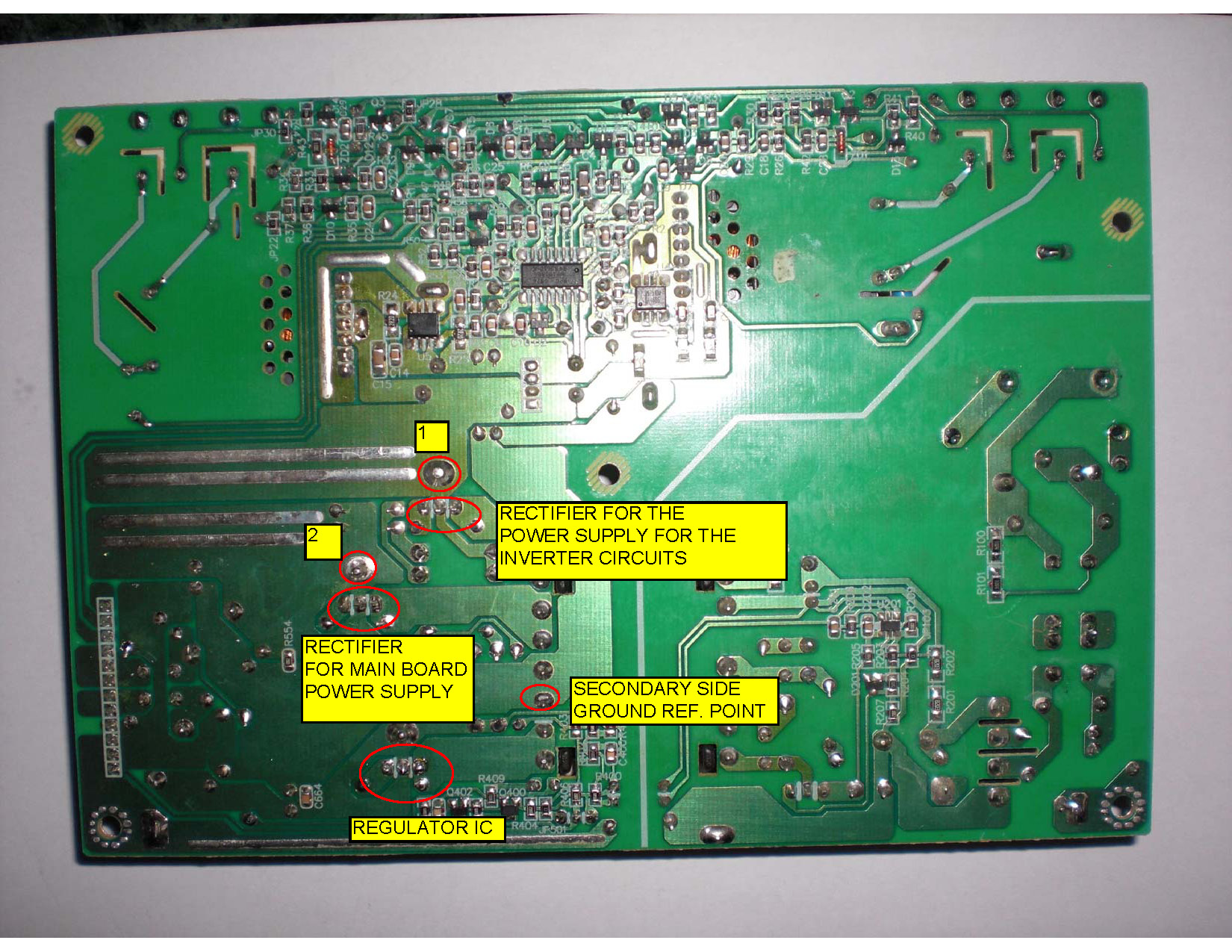

                                      How can I heat up the cap? Here is a picture of the measured diodes. It is not a regulator. It is a MBR20100CT.
                                      Mosfet seems to be ok.
                                        Are you actually getting the 12v. The one that show 0V that's a regulator which takes the output of the diode that you show 0.5v, that is what it looks like from the traces.
                                        Correction1, I look at the traces again, there is another winding feed that Diode not the regulator, you are right. There are three secondarywindings on this transformer. If you are getting 12v, then the primary side drive circuits muat be working otherwise there will be no any out puts.
                                        What are the resistnace reading between the Ground and all 3 center pins of the 3 diodes?
