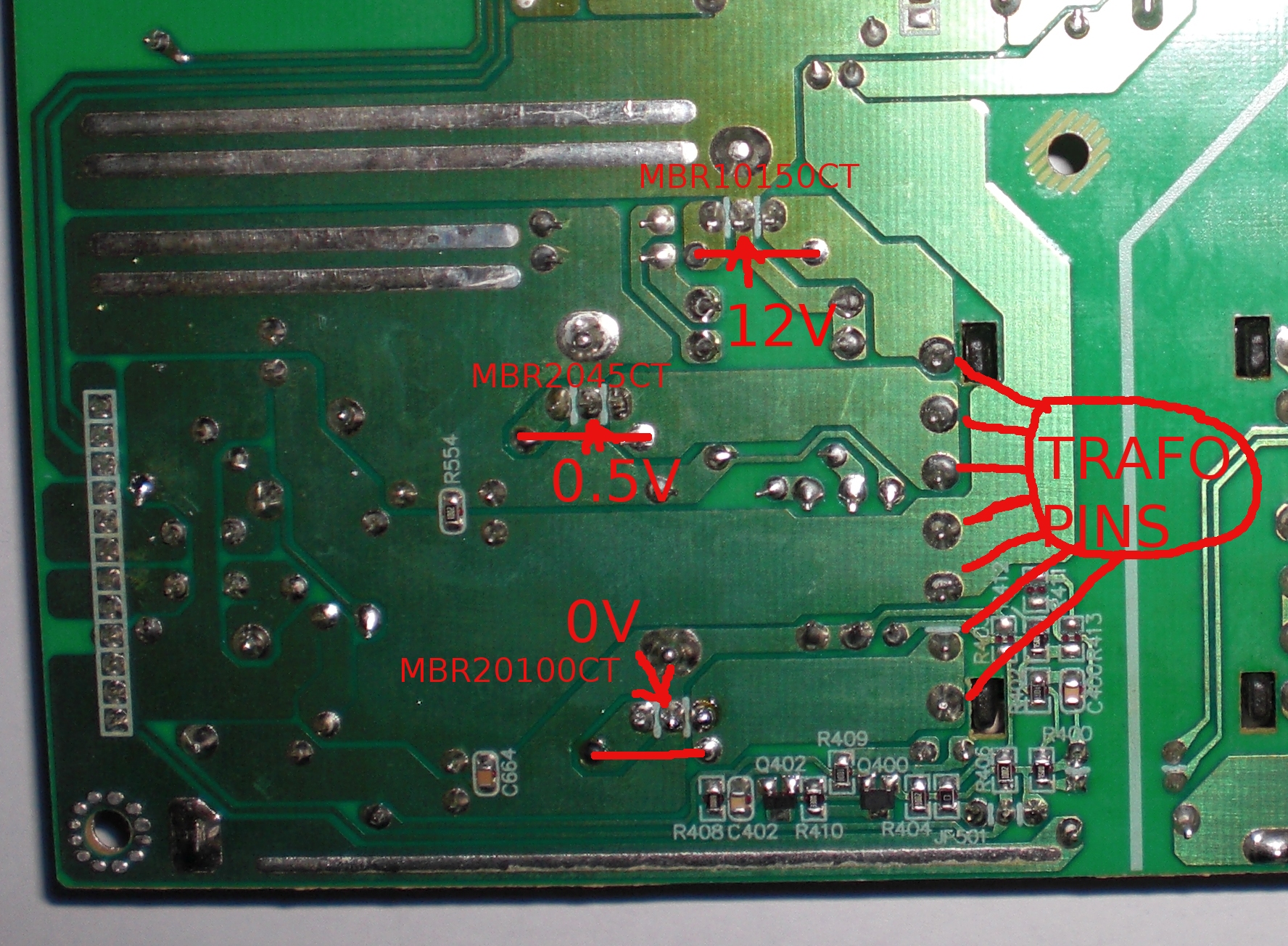

    The measurements are exact. It is not a regulator. It is a MBR20100CT.

      I know it is not regulator but I still need the Ohm readings using Ohm scale, not voltage readings.

        Hi Bud,
        the resistance measurements from center pins to ground:
        MBR20100CT
        0.6 Ohms
        MBR2045CT
        1.7 kOhms
        MBR10150CT
        infinite
        Thanks!

          Looks like something at the output of MBR20100CT is shorted to ground. Which one is the MBR20100CT on your photo?

            Re: Iiyama 2607WS suddenly dead
            It's the one on the edge of the board.
            What about MBR2045CT? Should be infinite too.

              Guess I should have looked at post #21 concerning the location of MBR20100CT. Anyways, it looks like the center pin of it is connected to two zener diodes, ZD661 and ZD662. Check these two diodes for shorts.
                will check it
                  1.4kohms on both
                    There are a cluster of filter caps to the left of the MBR20100CT. Check to see which of these caps have their "+" lead connected to the center pin of the MBR20100CT. Once you have identified the caps, try measuring across each cap for a short.
                      Did that already. 0.6 Ohms across each of the two caps.
                        Suggest you remove those two caps from the board and check them again for shorts.

                          MBR20100CT remove this from the baord and it checks OK? And this diode has Isolated TAB or it has isolation pad so it not short to the heatsink which is grounded.
                            Soldered them out. Still 0.6 Ohms from center pin of 20100 to ground.
                              will solder 20100 out now
                                ok, measured 60kohms between pins 1 and 2 and 0.6 Ohms between 2 and 3.
                                  OK with the Diode out ,measure that center pad on the board, what do you get?
                                  Since it is dual diode with center pin the common Cathode, then you have one diode shorted out.
                                    If you reverse the leads of your meter and measure pins 2 and 3 do you still see 0.6 ohms. If yes, then you found your short. Also, since you removed the MBR20100CT, measure the middle empty hole to ground.
                                      Measured infinite without 20100 from center to ground. 0.6 Ohms in both directions, yes.
                                      One of the two is broken.
                                      What about MBR2045?
                                        I think the MBR2045 is fine, since the resistance of that center pin can be affected by external components connected to it. What is the manufacturer of the caps you removed? Capxon?
                                          Suggestion when test the component, always remove it from the board to get the true readings.
