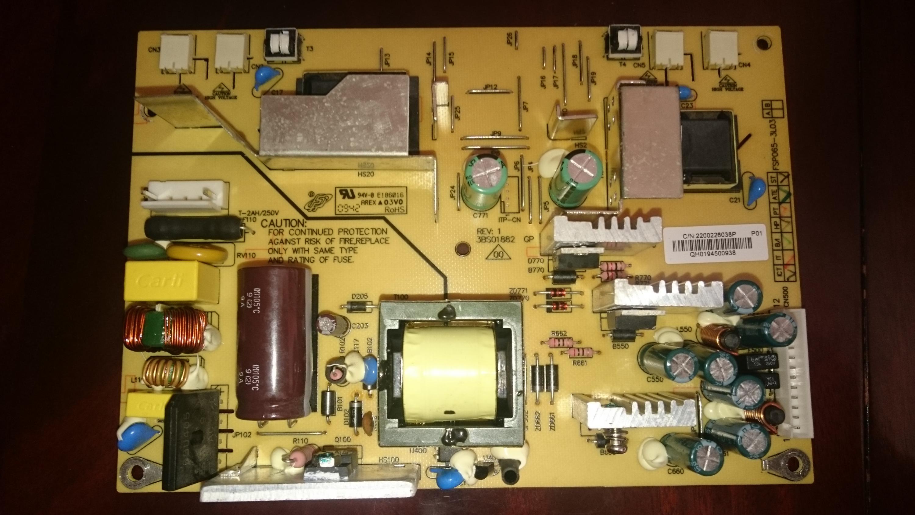

    Re: Iiyama 2607WS suddenly dead
    The infinite reading for the MBR10150CT seems a little odd. Sounds like the middle pin is connected to nothing. Check it again. If you get the same result, remove it and check it out of circuit.
    • formatthias
      • Dec 2012
      • 23
      #42
      I just ordered two 20100 and two 2045.
      Will solder out 2045 today and check it.
      The Caps are Taicon 25V 470uF. Seem to be ok.
      On center pin of 10150 I read +12V. Pin is connected to ZD770/1.
        After another resistance measurement of 2045, I think it is intact.
        I will solder the new 20100 in and check again.
          Ok guys, I soldered the caps back in, put silver grease on the new MBR20100CT, soldered it in, plugged the PS into the wall and measured perfect ~5V and ~12V on the connector to the controller board.
          The screen is working like a charm for hours now. I am so happy. Thank you very very much for your help and patience budm and jetadm123. Cost me a buck.
          Merry christmas to you and the Badcaps Forums!!!
              Excellent work! Since you were able to get the replacement part so quickly, can you share your source, since so many people in europe seem to have trouble locating parts.
                The parts are from ju-tec.de. A few kilometres away from me.
