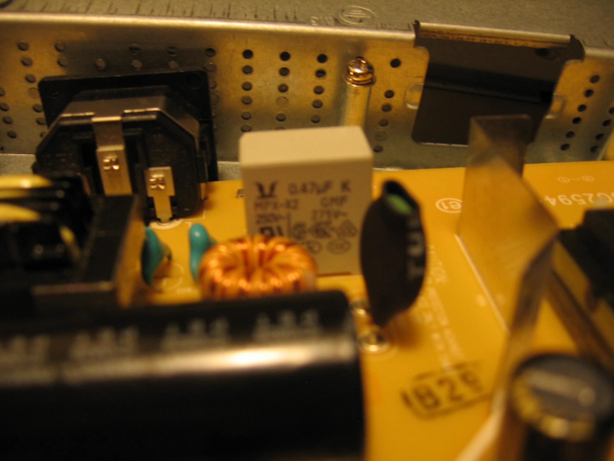

    Help,
    I am not sure what it is, but I accidentally melted the plastic on this piece and I need to order another.
    It has on it: MPX-X2 GMF
    250v~ / 275~
    It's a Dell E228WFPC power board, number: 715G2594-1-4
    Thank you for any and all help.
      #62
      Re: Dell E228WFPC goes dim after 10 minutes, not 2 seconds
      It is just X2 (across the line and Neutral for noise filter), the monitor will function without it. You can get it from Digikey: Panasonic ECQUL series, there should be more numbers on it for the Value.

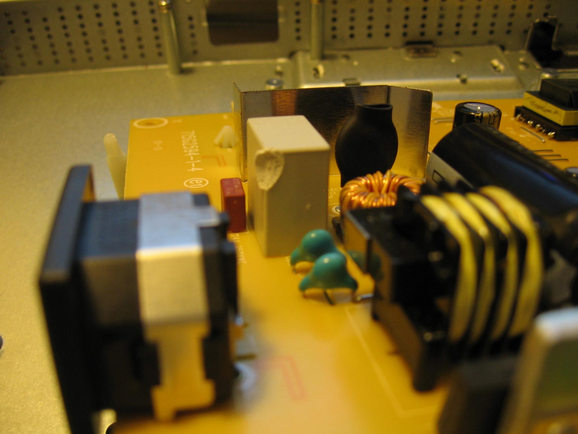

          Ok, soldered new caps on power board, still doesn't work.
          I used the same values as old caps, Panasonic brand, made sure negative lead to negative side, made sure the lead and board had a good solder joint. Picture comes on for a few seconds, and right off again.
          Any thoughts?
            #65
            We need more details such as which caps, all the caps are replaced? Good pictures of the board will helps a lot, make sure to use 'GO ADVANCED' and upload the pictures.
            You may have bad lamp assembly, bad transformer, power supply, inverter circuits problem.
