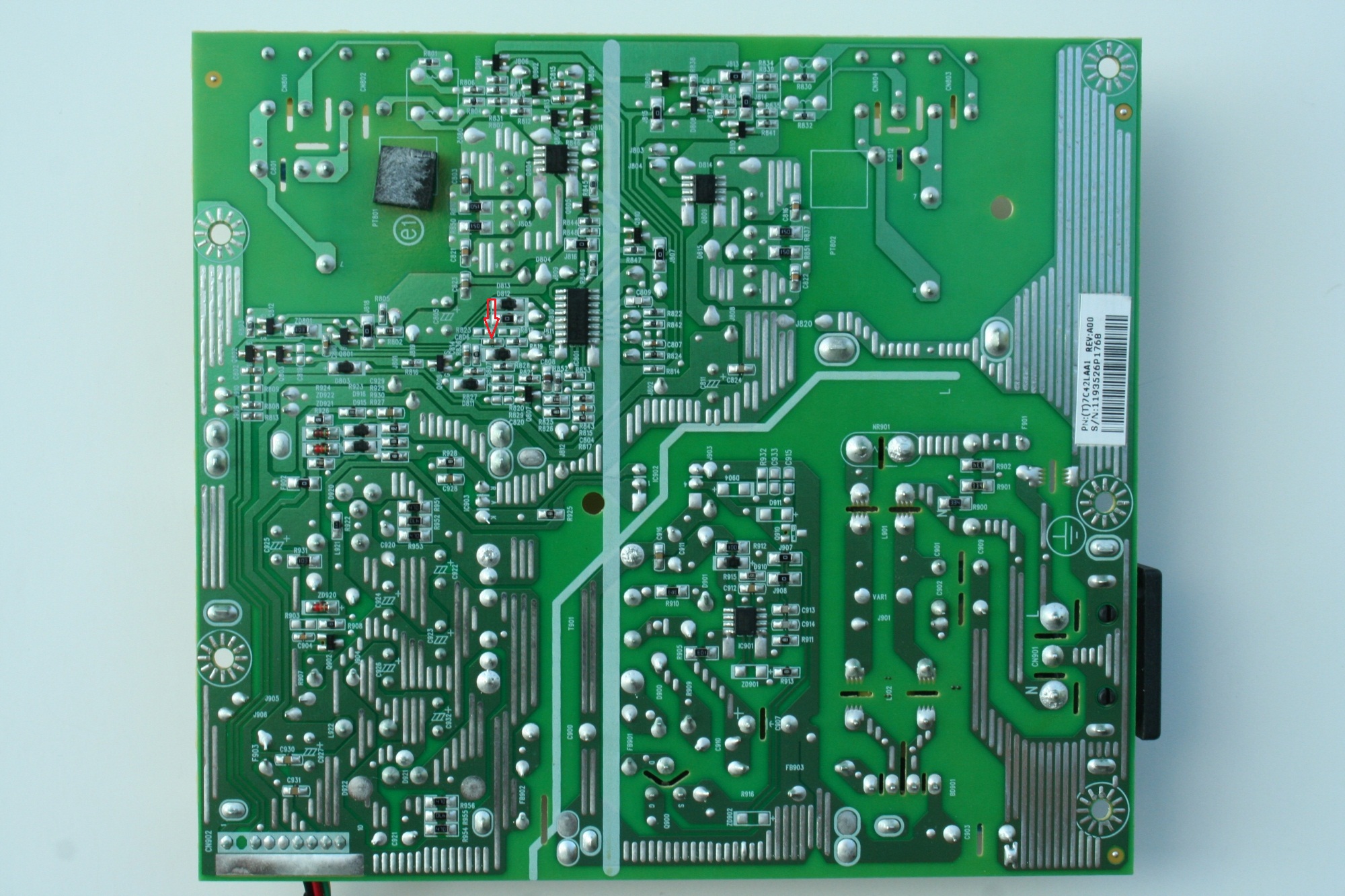

Dell E228WFPC goes dim after 10 minutes, not 2 seconds
  • POM_MJ
    • Aug 2009
    • 228
    Re: Dell E228WFPC goes dim after 10 minutes, not 2 seconds
    pictures uploaded for reference.
    | AMD Phenom II X2 550BE | GIGABYTE GA-MA790FXT-UD5P | GeIL DDR3 Ultra 2x2GB 1600C7 |
    | XFX GTS250 DDR3 512MB | Dell H525EF-00 | Lancool PC-K62 Black | Samsung 2232GW |
    | 2xWD7500AYYS | 2xHD322GJ Raid0 |
      Edited: Thanks for in pictures, POM MJ.

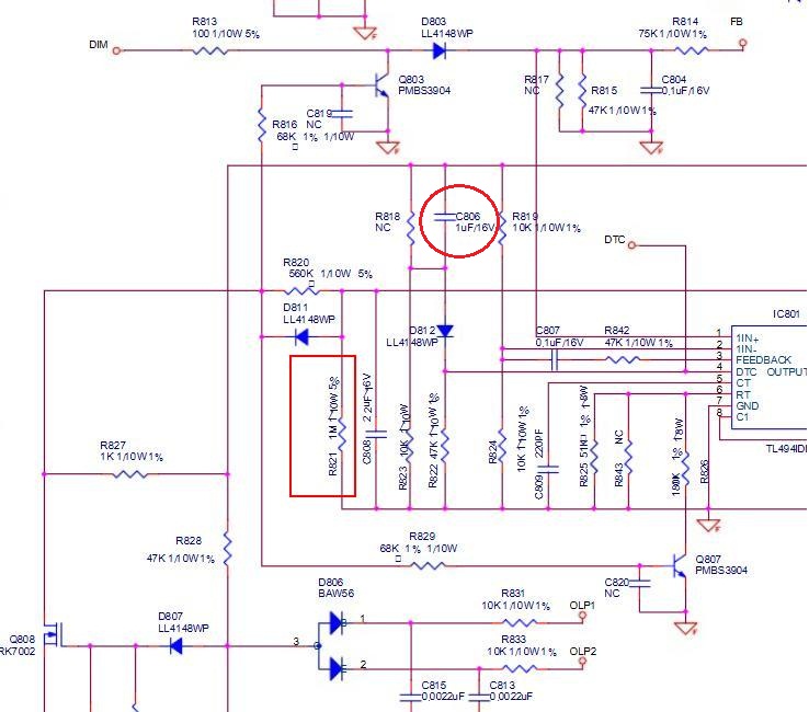

        I look at the SCH, PIN 4 is the Dead time controller pin, per SCH, it is setup as SOFT-START mode since R818 is not used. It is interestin that C806 caused the lamps to go dim, it must have change the ON time of the lamps.
        • POM_MJ
          • Aug 2009
          • 228
          When BAD C806 (in my case) warmed-up, it has leakage current flow through it then cause the voltage at PIN4 goes higher than normal and pulse duty cycle goes wrong, that make lamps current incorrect, then protection scheme shutdown the oscillator, I thought.
          edit: IPboard 715G2594-1-4 (HUDSON8) schematic uploaded for reference.
            That makes sense since it is hooked up as softstart, but with resistor in place (leaky cap), then it is setup as Deadtime control.

                            I think he he is talking about C806 in post 21, 1uF 16V MLCC. But I think he should try heating up the cap as suggested in the post by POM_MJ, that was how he found out that he has leakey cap.
                            • smalltownguy
                              • 127
                              • US
                              #34
                              Yeah, I'll heat the cap first before ordering it.
                                #35
                                @smalltownguy, do you have any through hole type caps? Anything like 0.47uf or so?
                                • smalltownguy
                                  • 127
                                  • US
                                  #36
                                  Sure I do - what are you thinking?
                                    #37
                                    If the C806 is bad after heat test, then you can use just one 0.47uF or two in parallel to see if that will work, you just have to find solder pads that are connected to the C806 and solder in the through hole caps in place.
                                    • smalltownguy
                                      • 127
                                      • US
                                      #38
                                      I rigged up the monitor with clear access to the back of the inverter board and turned it on. I hit it with the hair dryer and within seconds, it shut off.
                                      So...heat is definitely causing a problem.
                                      I'll see if I can get a better look at the board to find a suitable location to add a .047 cap to it, unless someone else thinks it's a better idea to just wait and order the surface mount cap?
                                        #39
                                        You will will have to remove bad cap from the board, then install a new cap in place, like I said, try using the cap in place of the bad one you find just to verify that the cap will fix your problem.
                                        • jetadm123
                                          • 2169
                                          #40
                                          I think I see a few things that should be clarified:
                                          1) I think when POM_MJ mentioned "0805" back in post #19, it might have been interpreted as "C805". 0805 defines the case style of the smd cap he used. It defines a specific length and width.
                                          2) Since the original cap is 1uf 16V, budm specified connecting two .47uf caps (not the 0.047uf that you mentioned above) in parallel, which gives a total of 0.94uf (close enough to the desired 1 uf). Also, pre-bend the leads of the caps before you solder them in, as bending them afterwards will lift the pads off the circuit board.
                                          3) To remove C806, if you have access to a second soldering iron, hold an iron in each hand and heat both ends of C806 at the same time.
                                          4) If you opt to order a surface mount cap for C806, then the proper value is: 1uf 16V, case style 0603.
